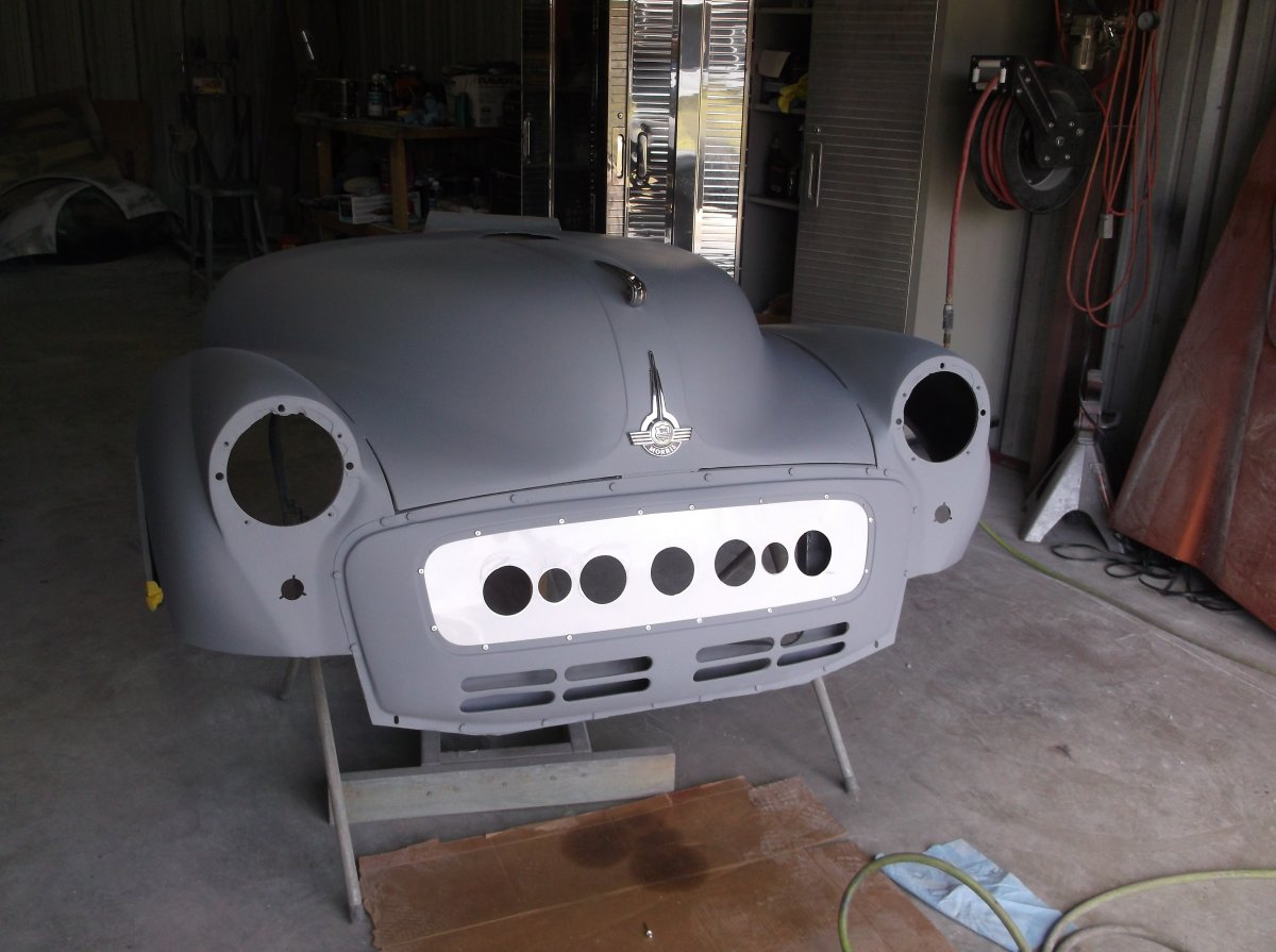

    My old blue coupe had an expanded metal grill. I am doing this on My Morris Minor g***er project. DSCF3382 (1).JPG

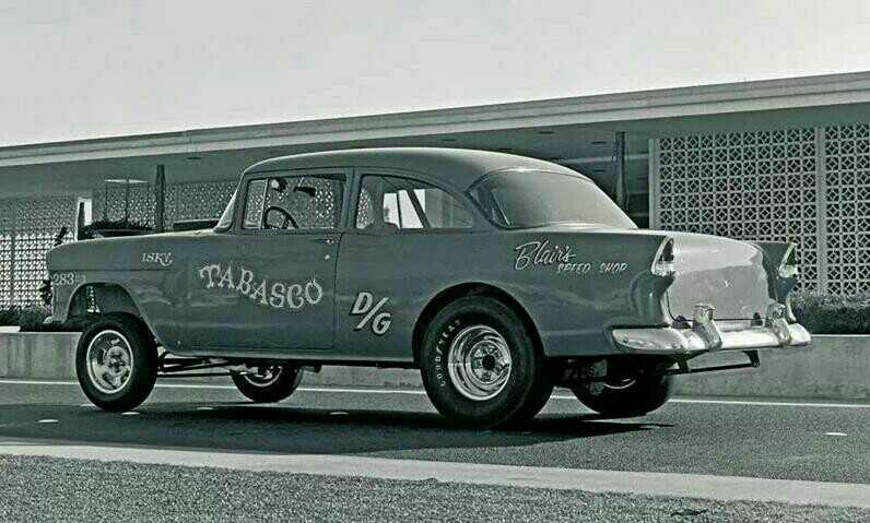

  28. By the way the real "TABASCO" is being restored in Temple City, Ca. Just a note so you don't head off in the wrong direction with paint and lettering.
    loudbang, joel and 31hotrodguy like this.
  29. 31hotrodguy
    Joined: Oct 29, 2013
    Posts: 2,699
    31hotrodguy
    That will be exciting to see. A lot people I know have been wondering what ever happened to the real car. Making a clone of Tabasco was the previous owners plan from almost 35yrs ago and was never my plan so we are safe. Although; as far as stance and overall appearance I wouldn't rule it out for inspiration and theme. [emoji3]
