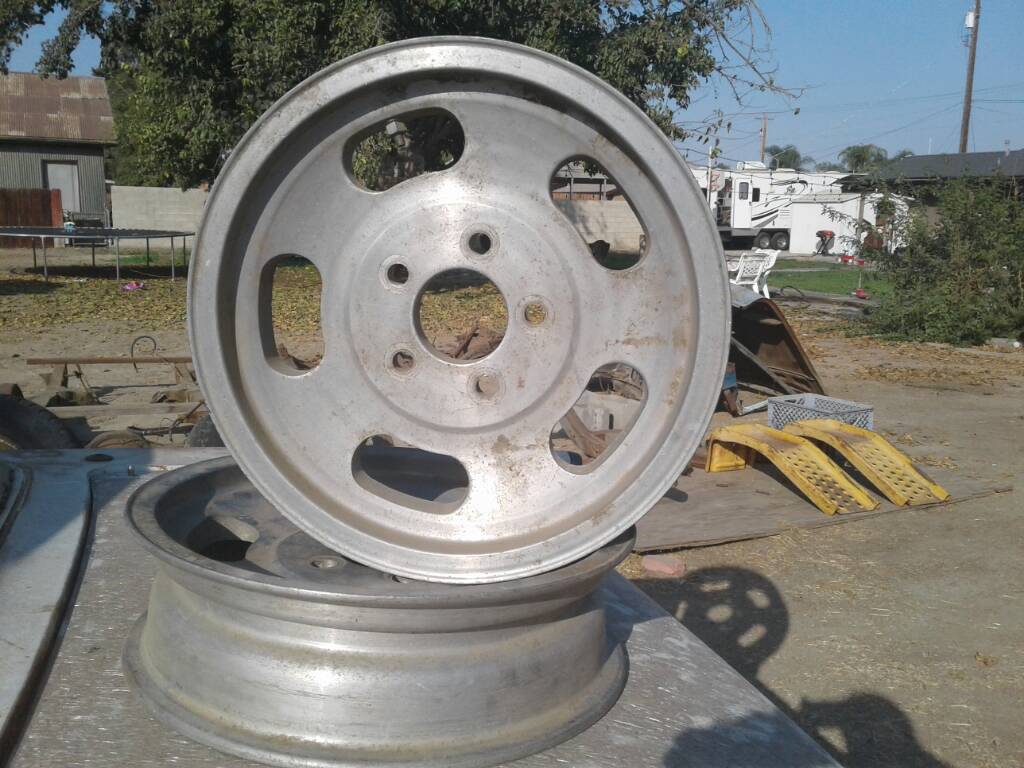

    I would normally consider myself more of a 5 spoke kinda guy but I was able to get this pair of 4 inch Ansens. [emoji3] 20171101_151932.jpg

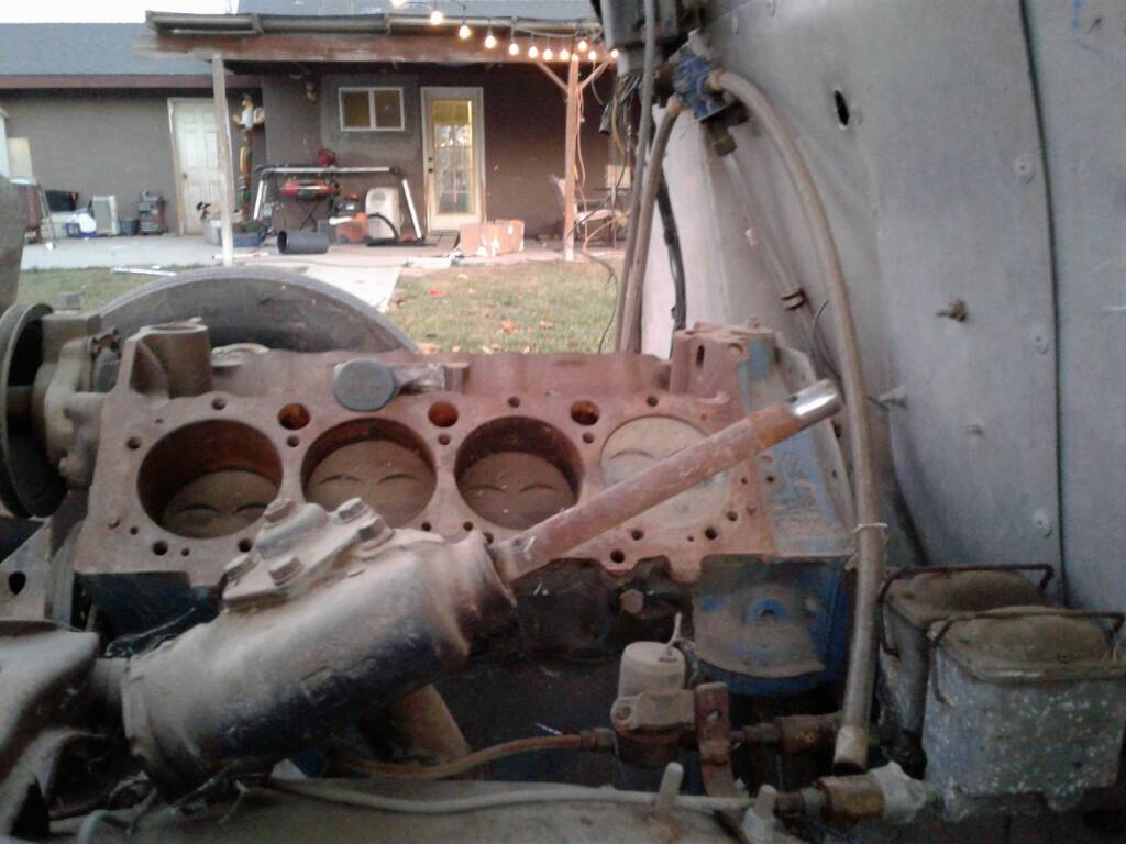

    Just curious, is that a quick change rear end in Tabasco? As far as your #852 283 block goes, you said you put a 350 crank in it? Mains and rods cut down, and counterweights also? Just curious how that was done. Rather than swap your pistons, why not just put the heads on upside down (NOT!)?

    Then I could just run the exhaust out the top like an old Cadillac engine! [emoji3] Yes the mains and rod journals were cut down to small journal. Although, I don't think you have to grind the rod journals down to small journal. I think the later rods will clear but I have not tried that. As for the counter weights, they do not have to be machined down in the later 283 blocks. It all sounds like a lot of trouble but IMO it really isn't. The block cost a little more for the extra bore and sonic test. The pistons are as cheap as they get being 350 and a buggered up forged 350 crank is usually free. When it is all said and done it is the difference of running an early breather motor with the right valve covers opposed to a sbc looking like a crate motor. Then again there are ways to even make a crate motor look semi right of you take the time. [emoji3]

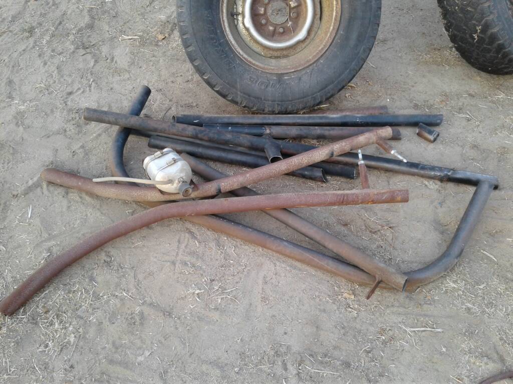

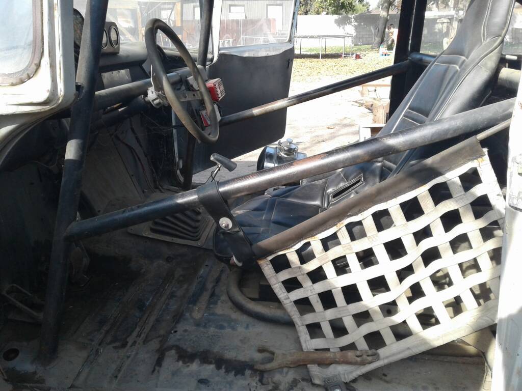

    After much debate in my brain I decided to cut up the cage. I had been putting it off because 1, it was a legit cage and 2, when I tend to take things apart they tend to stay that way. [emoji3]

    After and technically only about half way there (the cage does not come out easy!)[​IMG][​IMG][​IMG][​IMG]

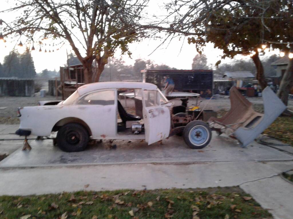

    With thanksgiving over and Christmas officially behind us it's time to get started on the gasser again!!!! Not a whole lot of progress today but at least we got the 55 in a place where we could really work on it........on the back patio of course!

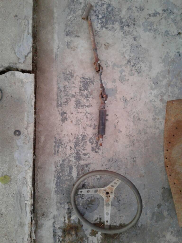

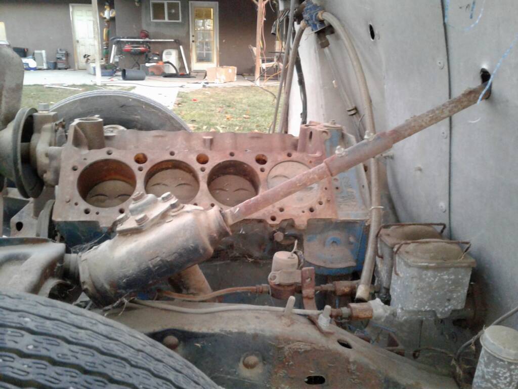

    Started removing the steering set up. It had a few too many u joints for me plus it was off center. The plan is to put it back to the stock location.
    Before
    After
    Sent from my SM-G550T using The H.A.M.B. mobile app

    Someday I'll have a shop but until then a mulberry tree and a smooth concrete pad will have to Do! [emoji3]

    What little I know about gassers I think you are doing the right thing by returning the steering to stock configuration and removing all the joints. At the same time making it more drivable for yourself. Cool project.
    loudbang and 31hotrodguy like this.
  24. loudbang
    Posts: 40,342
    For sure that steering was a MESS. :eek:

    Did you leave the main hoop and rear bars on the cage? The steering looked ''busy''.

    Yeah, start fresh with steering! Something that will pass tech inspection.
    At least you have a slab. Possibly, you can dig/pour a footing around it and retain the slab for the garage floor. Maybe keep your eyes open for a building/garage being demo'd and salvage a set of prefab trusses.

    I tried to salvage parts of the cage but in the end I think it was going to be more trouble than it is worth so no. I am going to start fresh and give myself some extra leg room. Short story long cage is coming out in pieces.
