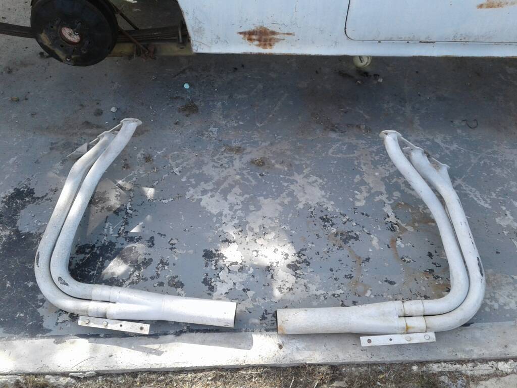

    Traded some 57' Chevy parts for a set of Stahl headers. I know, technically they are better suited for a Jr stock car rather than for a g***er but...... i mean common, they are a nice pair of Stahls. [emoji3][​IMG][​IMG]

  15. southcross2631
    Joined: Jan 20, 2013
    Posts: 4,412
    southcross2631
    Good trade .
    31hotrodguy likes this.
