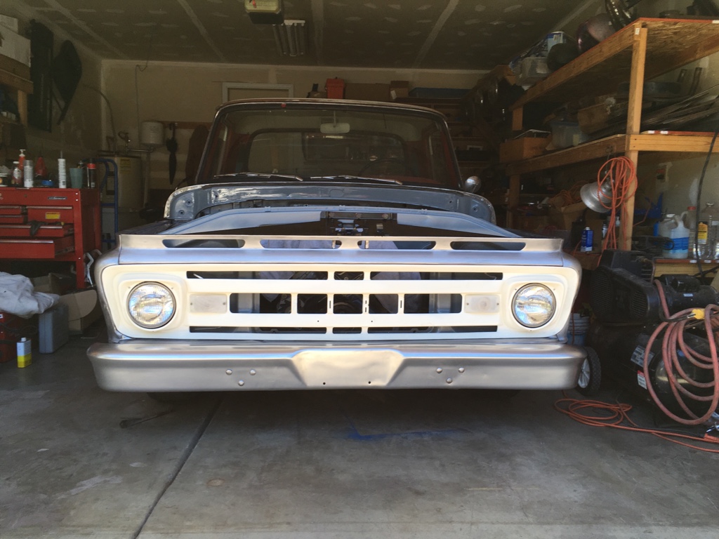

    Hmm...I just don't think this is the stock bumper...at first I thought it was tweeked an twisted but now I think it's a later bumper any thoughts?...same gap on both sides
  30. junkers72
    Joined: Sep 21, 2014
    Posts: 51
    junkers72
    Just my 2 cents. That looks like the bumper that was on a 1977 f150 I used to drive
