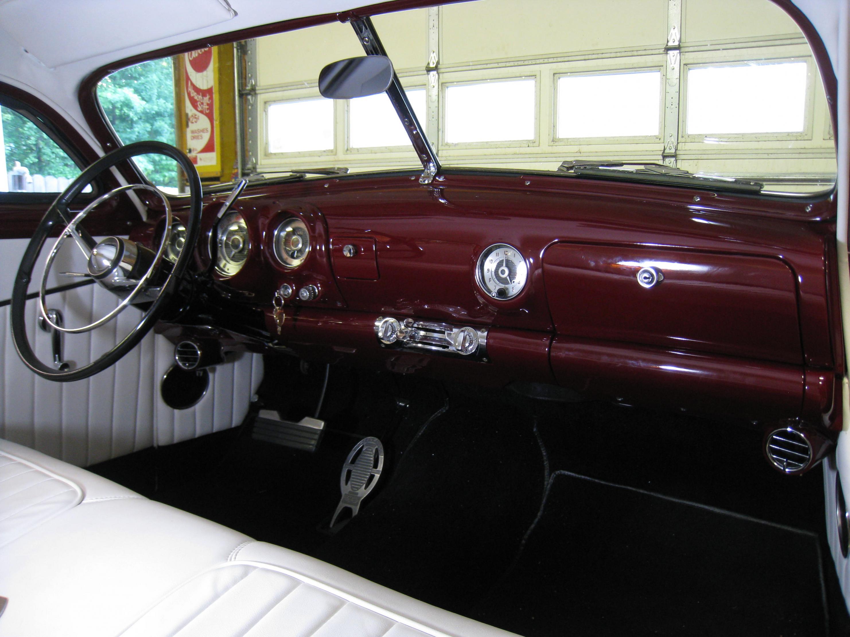

    Thats one of the coolest dash ideas ive ever seen in a merc!
    -LUKEY-
  3. Lukey, It really compliments the lines on a Merc much better than the 50-51 dash in my mind. I was hesitant at first but now Im really glad I did! I have a little more in store for under the dash to hide the A/C and a few other things, stay tooned for that little hat trick.

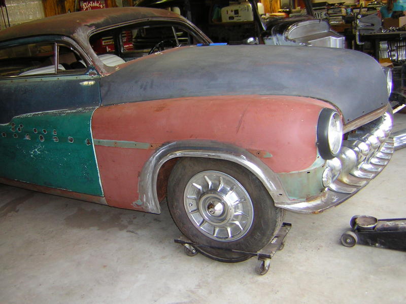

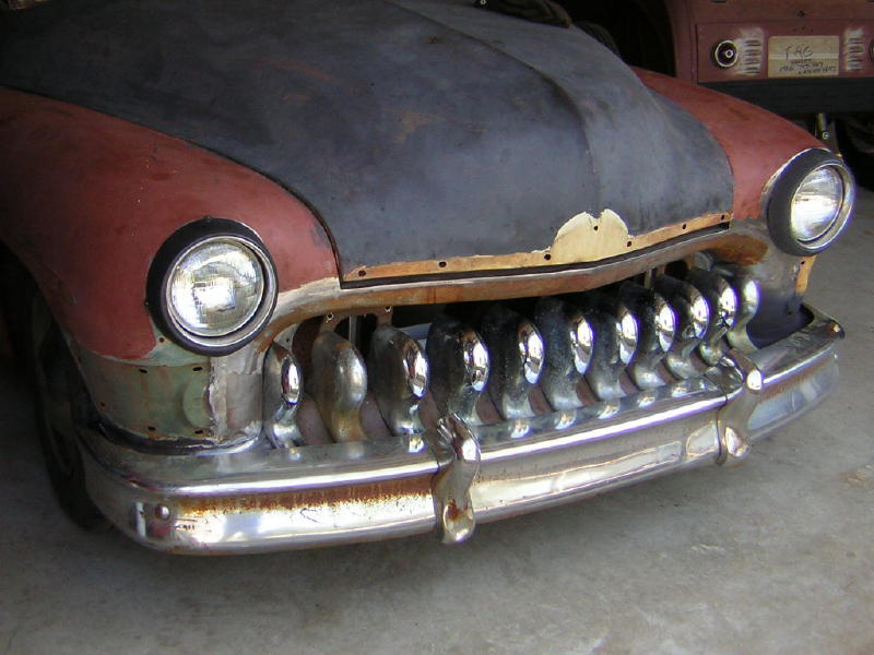

    1) What is the best way to trim/alter the desoto pan to fit the merc front? I planned on pie cutting and welding the ends to fit the tighter curve of the merc and trim the pan where it rises to fit the inside curve of the fenders and extend the pan deeper to approach the merc radiator. looking for suggestions.

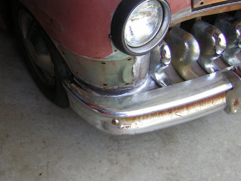

    2) What is the best way to attach the desoto bumper? I have the desoto bumper backets. Widened the desoto brackets to 35" to fit merc frame rails but then discovered brackets hit sway bar. Brackets are hardened steal so tough to work with. Is it easier to use merc bumper bracket? looking for suggestions.
    Any advice is welcome and pictures sure would help.
    There were only some teaser photos in this thread on the desoto pan. Any more photos in this area eth?
    Thks,
    Doug
  14. Guys, thanks for the comments!!
    Doug, I attached the Desoto bumper to the Merc using the Merc and the Desoto arms. Kinda married them together in a way that they looked factory. Took some work but turned out nice. I wish I still had them for ya but anouther HAMBer got them. As for the Desoto pan, first thing is to take the teeth off to make it easier to work with. I trimmed and tucked the pan ends to fit up into the front fenders till the end tails attached to the bottoms. A little trim and fab all at the same time. Ill post a few pics I didnt post for ya. Hope they help. Let me know if ya need anything.

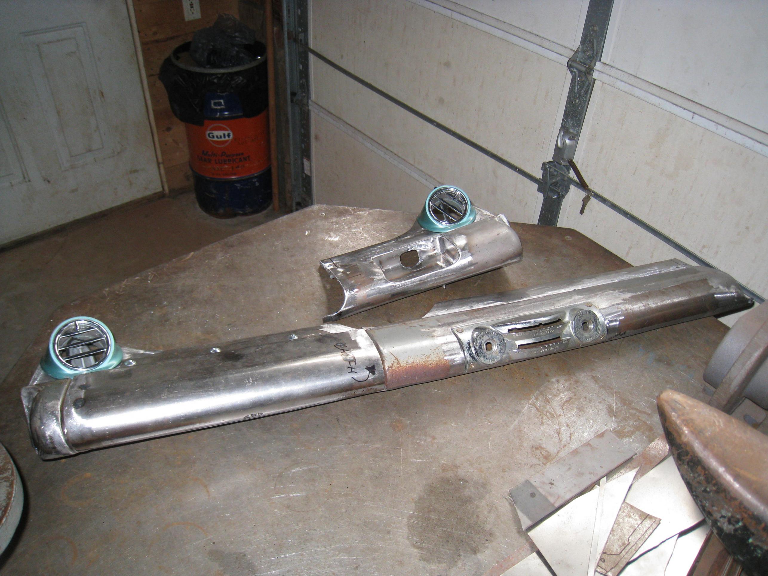

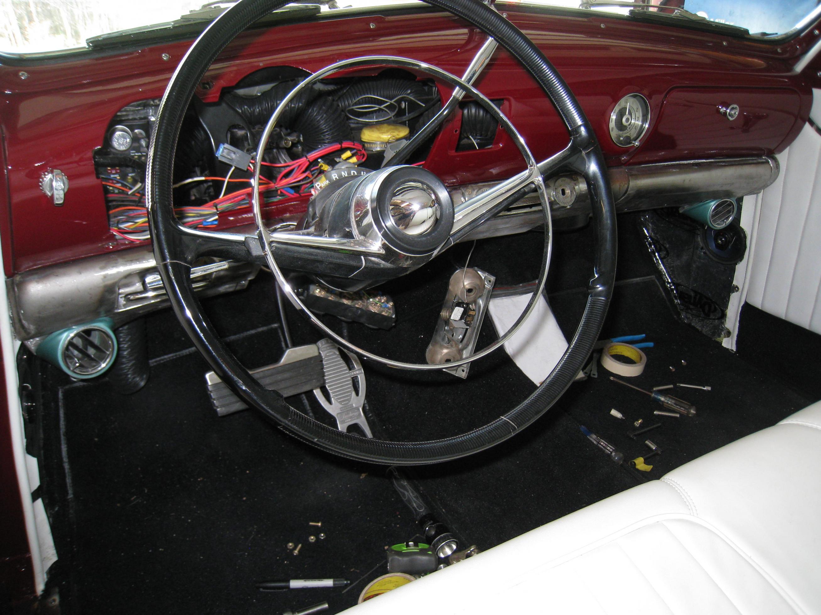

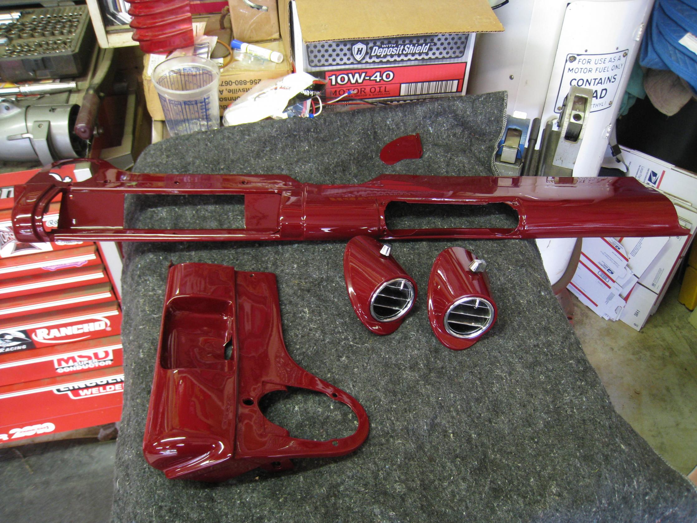

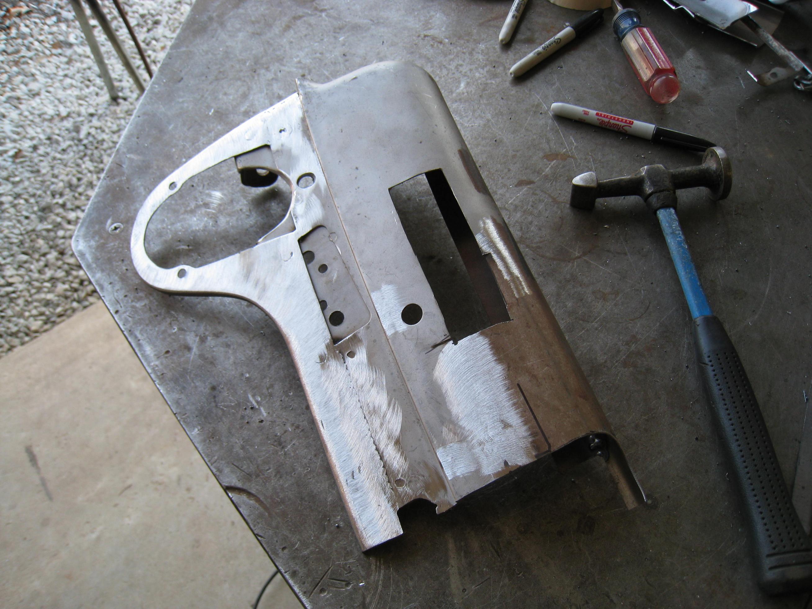

  15. Yep, Im still around!! I had been busy working on a customers 41 Willys and now that it is out of the shop, I can consintrate on finishing up my stuff. I am trying to get the 49 up and running for daily driver statis and working on the lower dash as well as odds and ends on the 51. Here are some pics of the lower dash to hide a bunch of non-traditional stuff from the regular Joe!!! I started with a 53 Chrysler dash, It has the same contour as the Desoto. I only used the lower portion and with HOURS of fabrication, cutting, and welding its ready for paint and body. Added a pair of 60 Cadillac vents and WALLA!!!! Definately not a direct fit deal!!! Man working around a painted car suxs!!!

    Looks great Ether. Hard to make A/C look traditional but you nailed it! Worth all the hours indeed.

    finally somebody useing there creative skills to hide a\c.i can't believe someone does so much work and money to a car and settles for the ****py plastic vents that come with the unit.the panel you fab looks fantastic as well,great job.take note plastic air vent guys,lots of 60's cars have great chrome steel vents.
  20. Thanks, It was really hard to walk the line between tradition and street rod with what I was trying to accomplish!!! Finding the right vents is as hard as picking a color!!! The plastic vents were definatelly not cutting it and the two compound curves of the dashes was a chore to say the least!!!

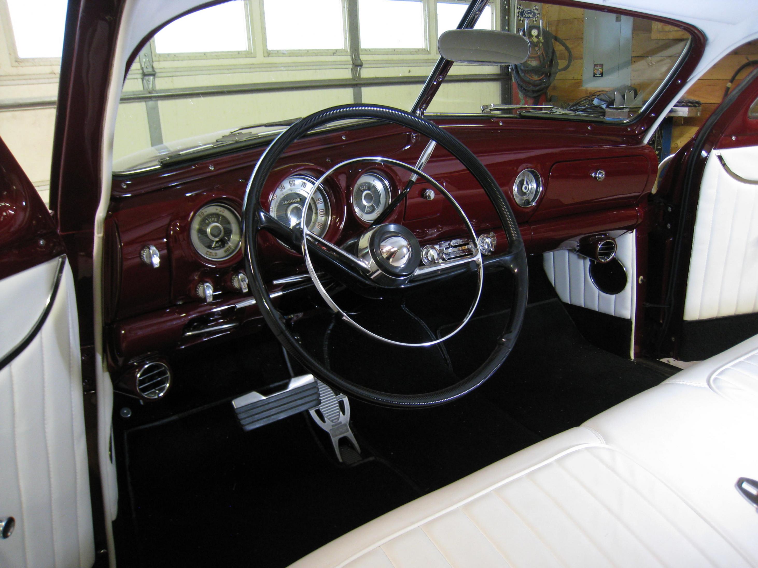

  22. Well the lower dash is painted ( Big thanks to Kelly Puckett SR. and Jr.) and installed, new a/c controls, and my better steering wheel. I had Mark Clawson Instrumentation clean and lube the speedo and convert my mechanical TEMP to electric as well as the AMP to VOLT guage. Awesome work and great guy to deal with. ******s out right now, trying to clean up a few drivability issues, David Eason of Lake City Trans is handling the slush box and hopefully on the road soon.

    that Chrysler lower dash portion makes the DeSoto dash look even better...I really like the original approach you took with your Merc's interior. Does the glove box portion of the lower Chrysler dash open as well? Everything looks nice and cl***y
