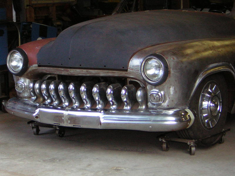

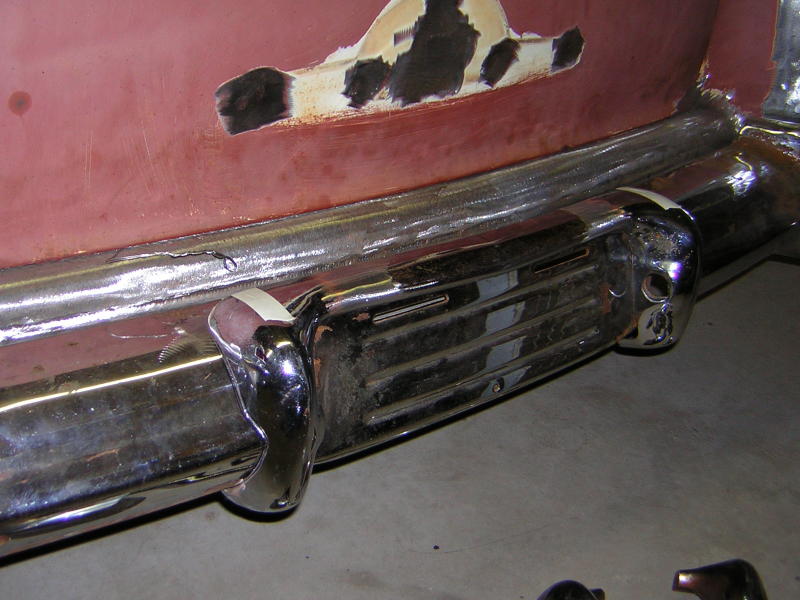

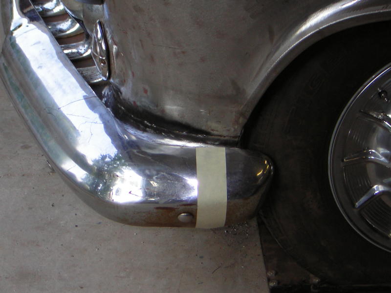

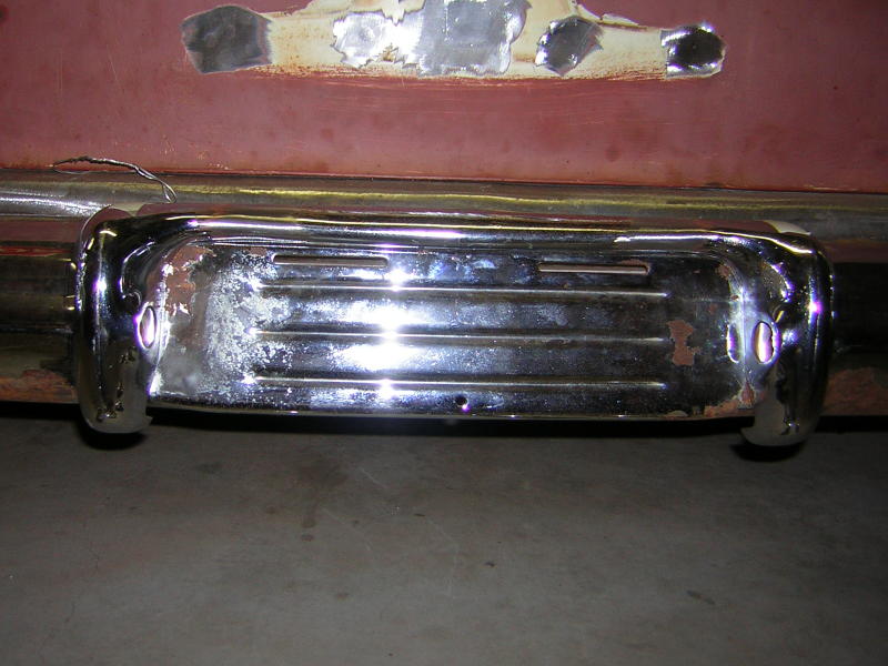

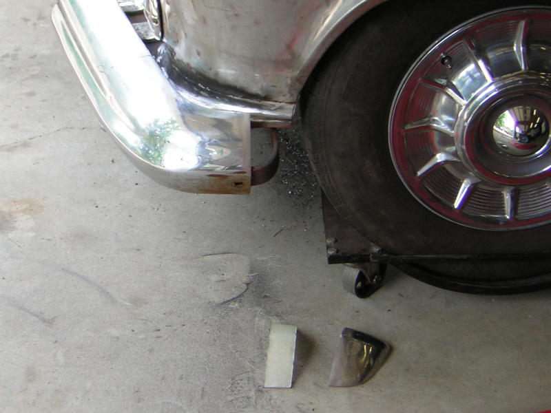

  5. UPDATE! UPDATE! UPDATE! Started hacking at the bumpers. Ive decided to go with the 51 Merc front bumper for sure but it still needed some work. I cut an inch out of the middle and trimmed the ends 2 inches. There is still a little finish work to do and Im going to radius the top to better fit the fenders and grill later.

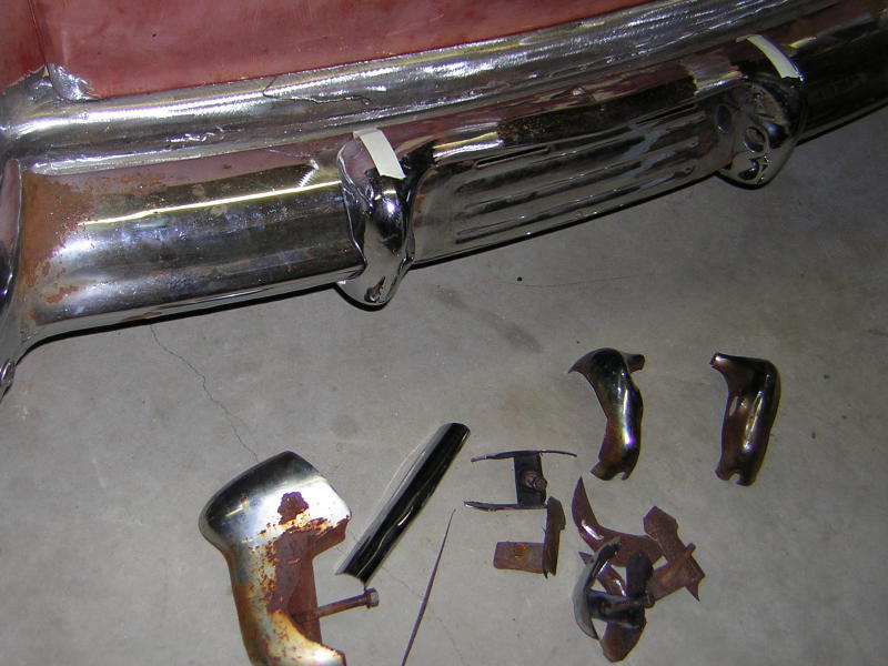

    I also started the rear license guard surround. I had to cut up two 53 studebaker guards to get it right, you can see the left over carnage from them on the shop floor. Still got a few things Ive got to do to it, not sure if im going to bolt it on or weld it permanant before plating.
    Amazing how much work goes into the little things most people wouldnt notice!!!!! ETHER

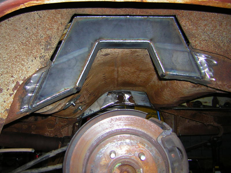

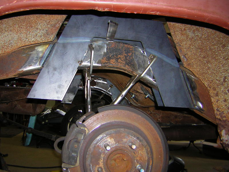

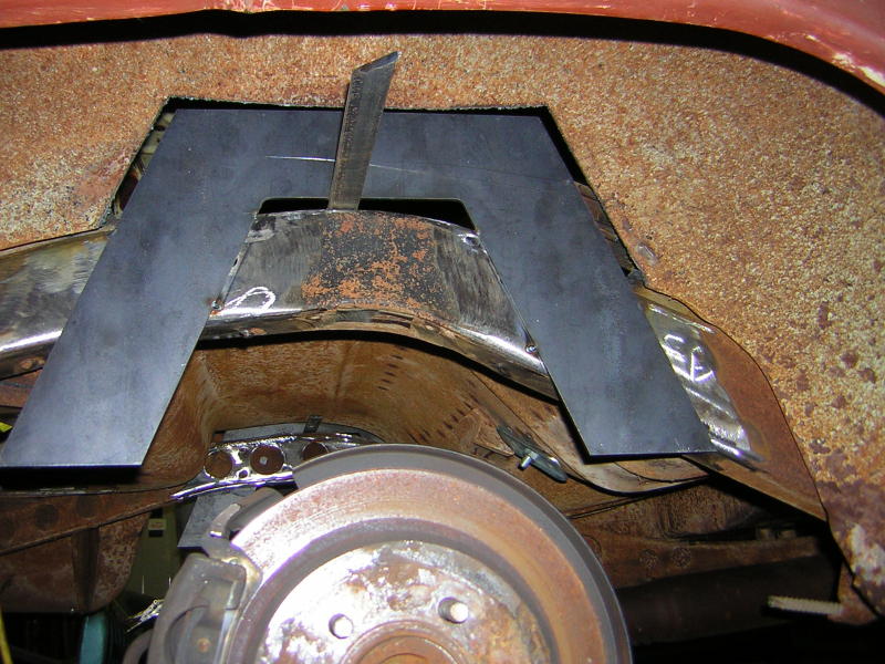

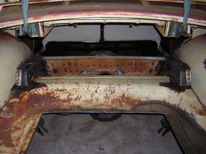

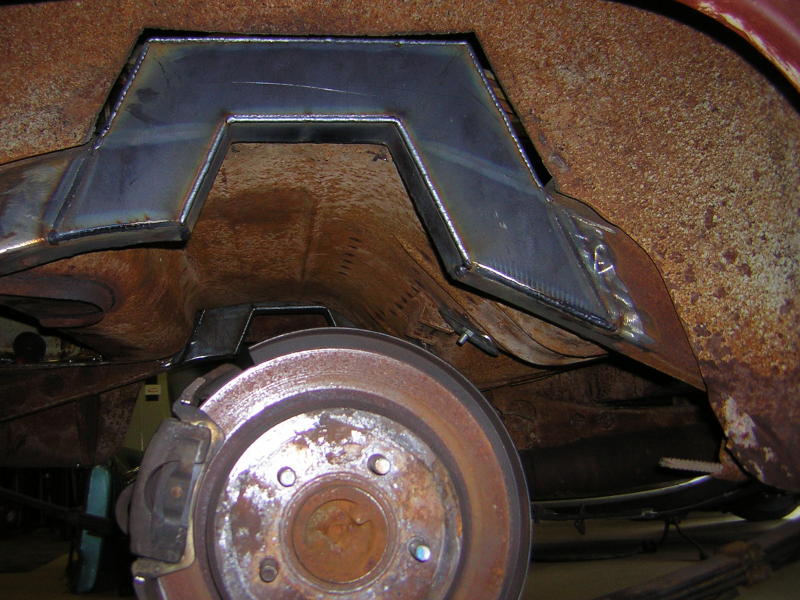

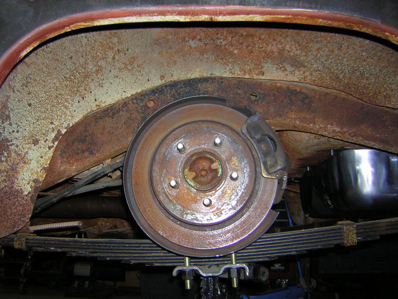

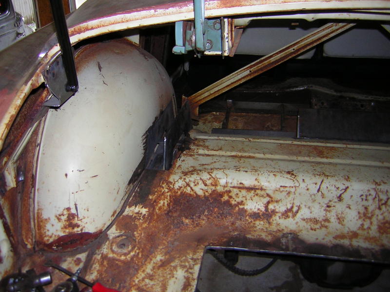

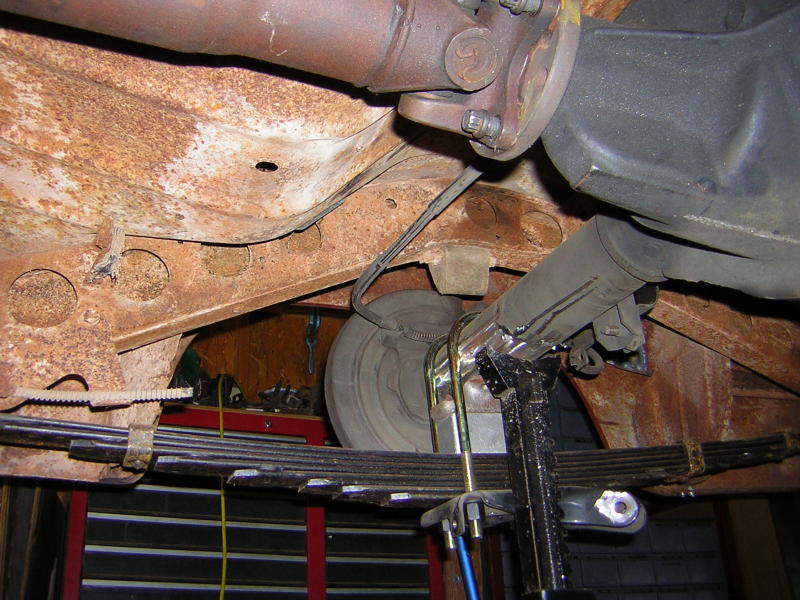

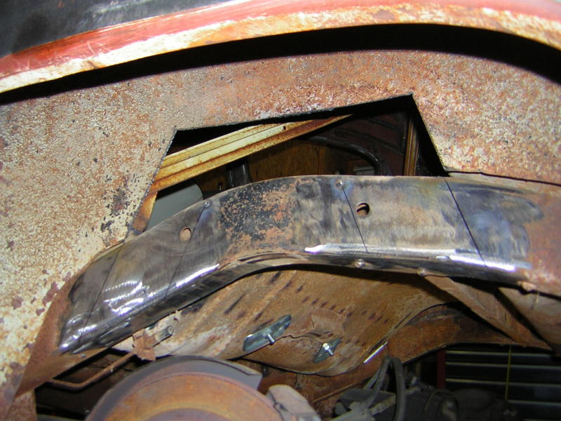

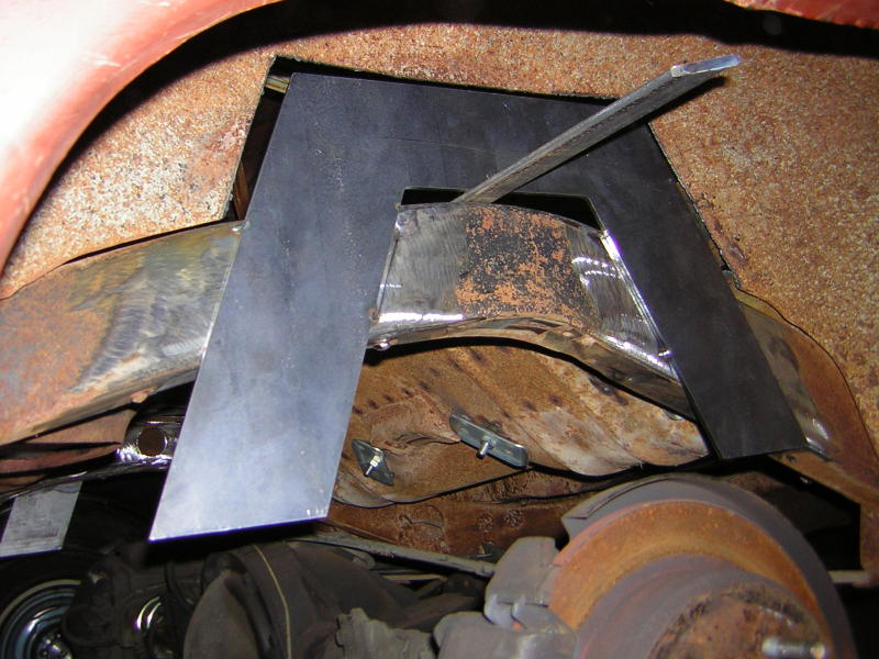

  26. Im running Jamco leafs in the rear with 2 inch blocks so the 3 inch 8.8 tubes are pretty close to the frame rails and I needed to do something for clearence. I may bag the Merc later down the road so notching the frame was in order. I bought a frame notch kit from a buddy of mine at Steadfast Customs in Huntington Beach Calif. Notching a frame is not rocket science but there are easier ways than others. First I trimmed the area around the notch for installation.
  27. With the Merc level, I removed the Merc shock crossmember mount, located and leveled the frame notch side plates, tacked, and final welded. I then trimmed the top cap of the notch of its excess and had to trim it front to back since a Merc frame is thicker in the front than the back. Once the top cap was final welded, I trimmed the excess off the side plates, cut out the frame, trimmed the bottom cap to fit and final welded everthing that was left. I then modified the shock crossmember mount to bolt back in its stock location to the frame notch. I also located the axle snubbers into the frame notch.

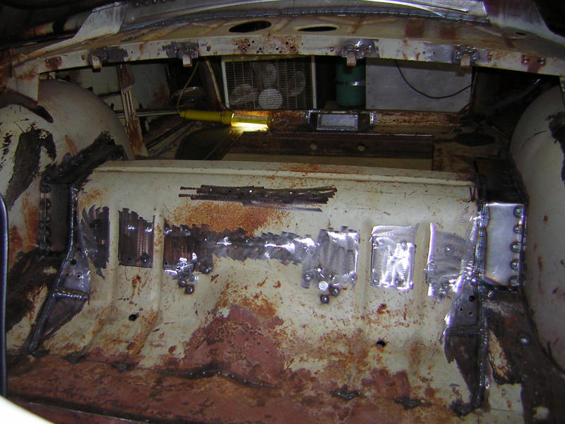

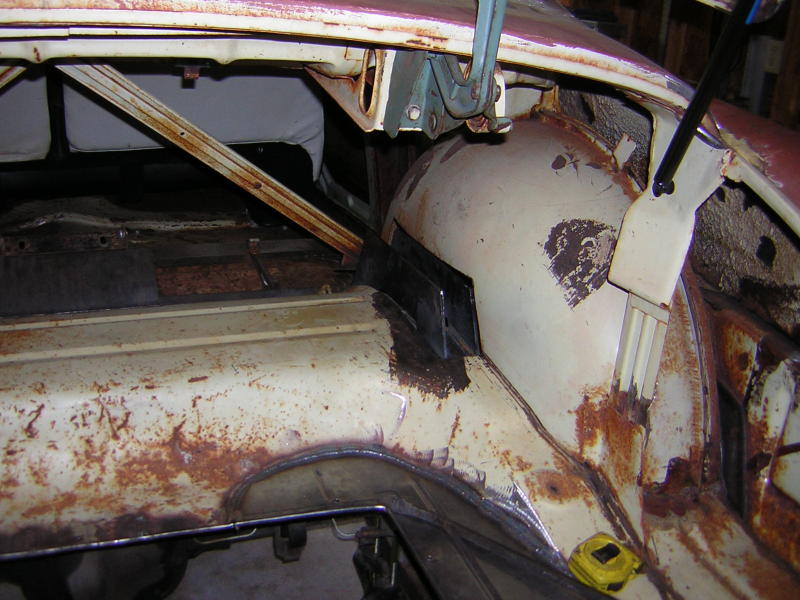

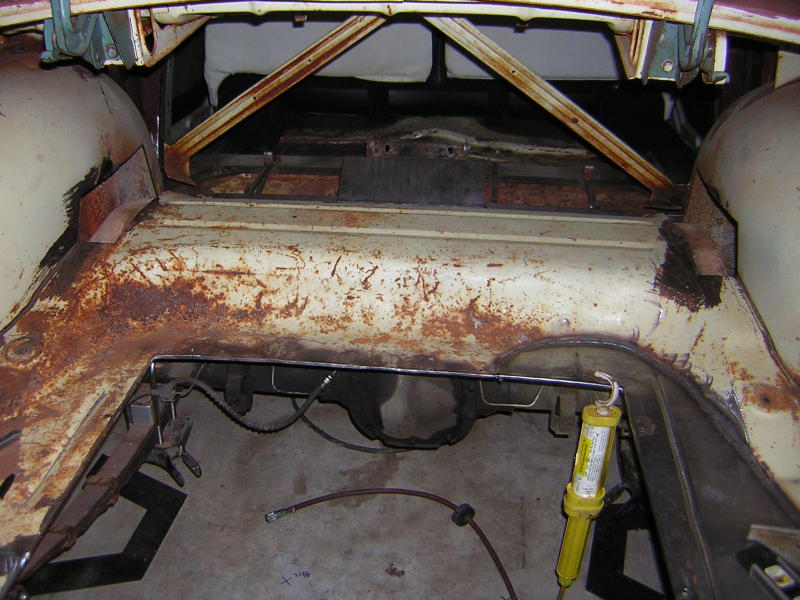

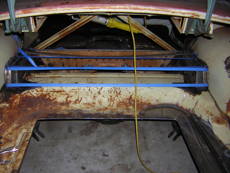

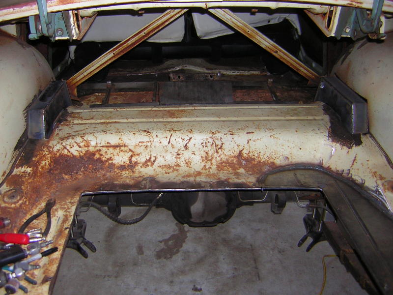

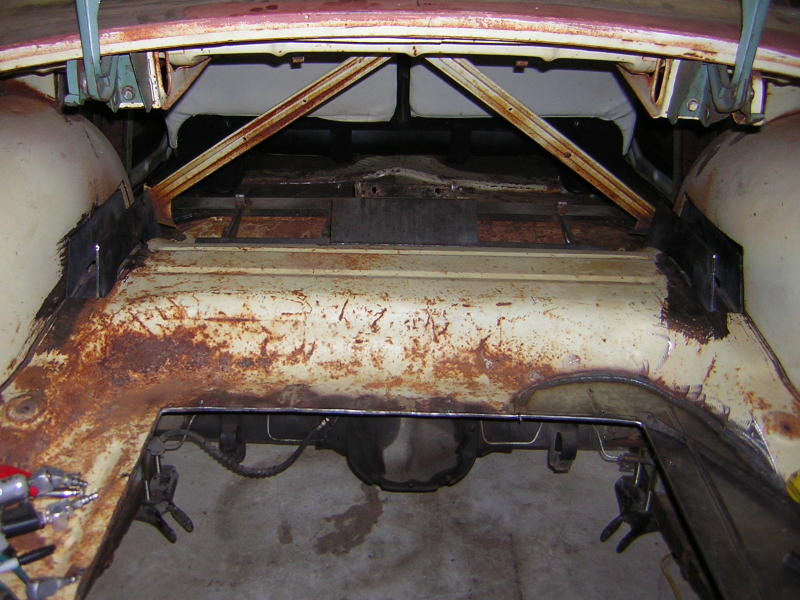

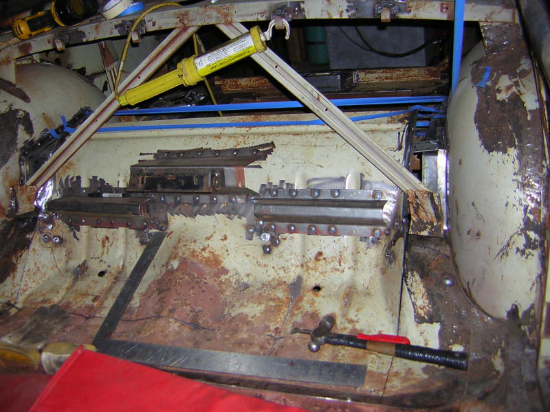

  28. Now the sheetmetal area that goes over the rear end has to be raisedto allow room for the differential. This area can be removed in the beginning of this process to ease accessability for the frame notch but I went a different route. I had done a bit of work in this area a while ago when I put the 65 T-Bird rear seat in the Merc, and all this work is lost. The outcome will be better and cleaner since the rear seat will rest on the sheetmetal tunnel rather than the mounts I fabricated. I used the front sheetmetal of the Merc by t******* it loose and lifting it up and and fabricating fillers that I welded to attach angles I welded to the outer wheelwells. The front is done, other than a bit of grinding and touch up. I will post the rear and top hopefully finished this weekend. ETHER
