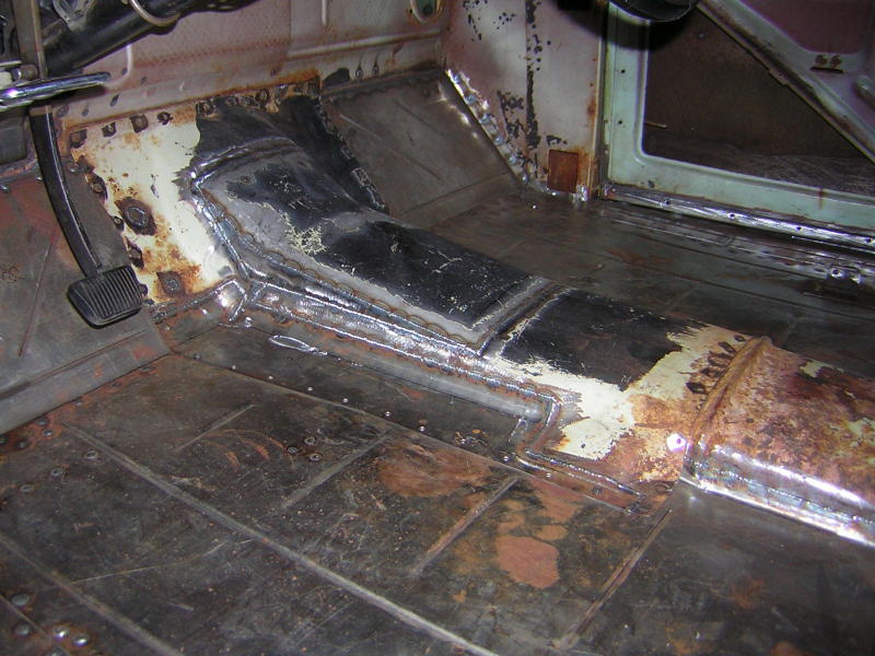

    Thanks. Always good to see pics of the hidden, fiddly work that goes into a car done right.

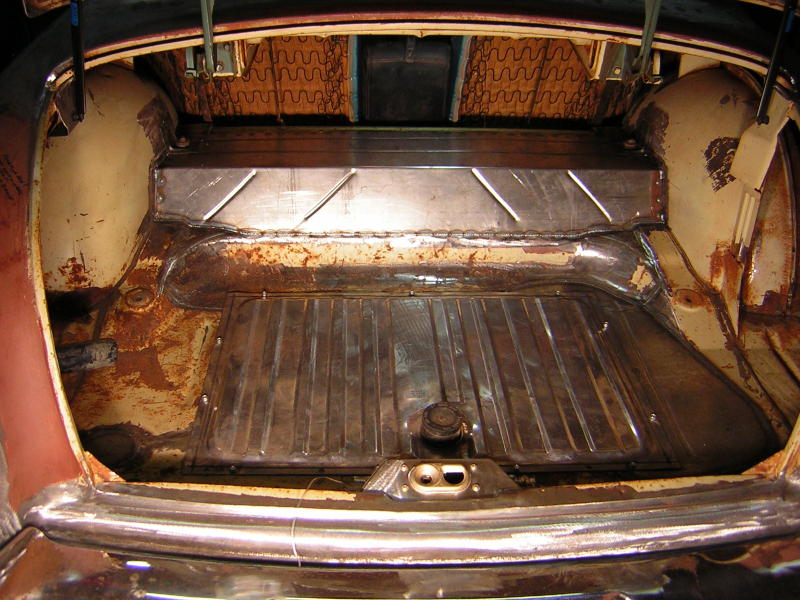

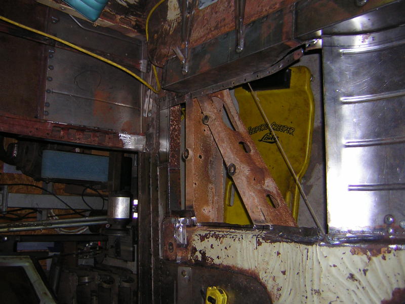

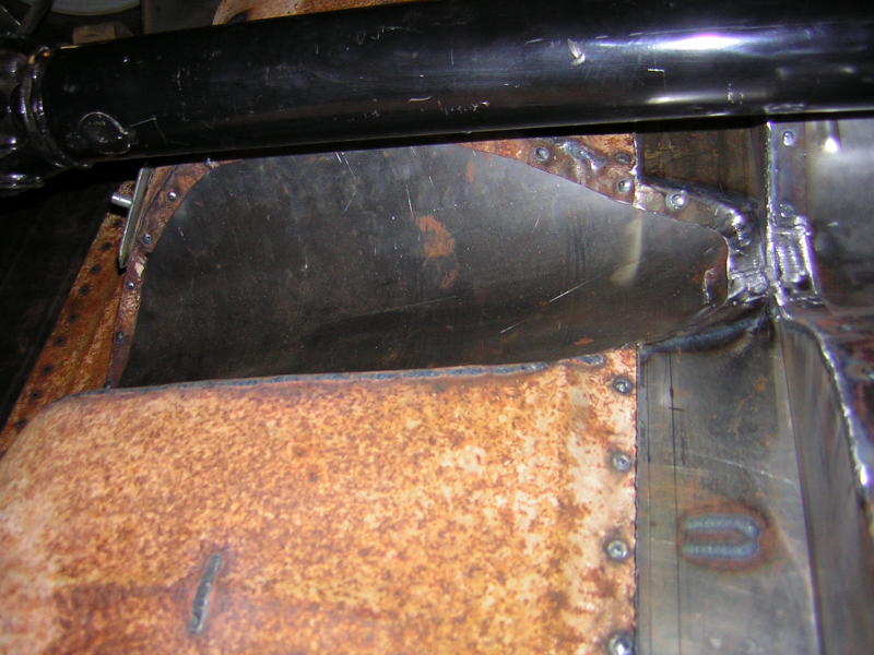

    Wow, that enlightens me greatly. I want to notch and bag my shoebox, but my biggest gripe was cutting up all of my solid trunk floor and having to remake it all. Extra work that kind of erases the fact that I paid for a more solid car to start with.

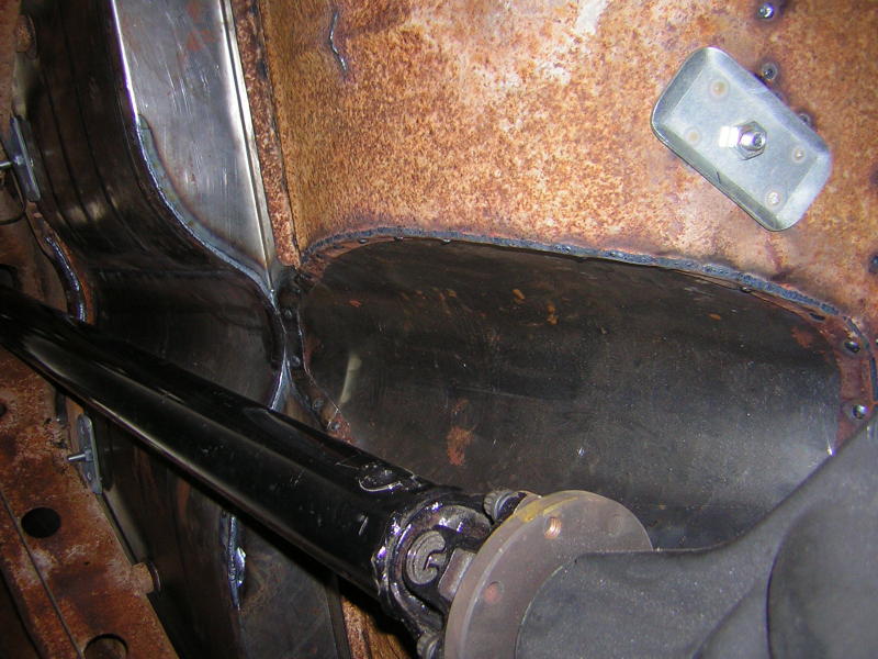

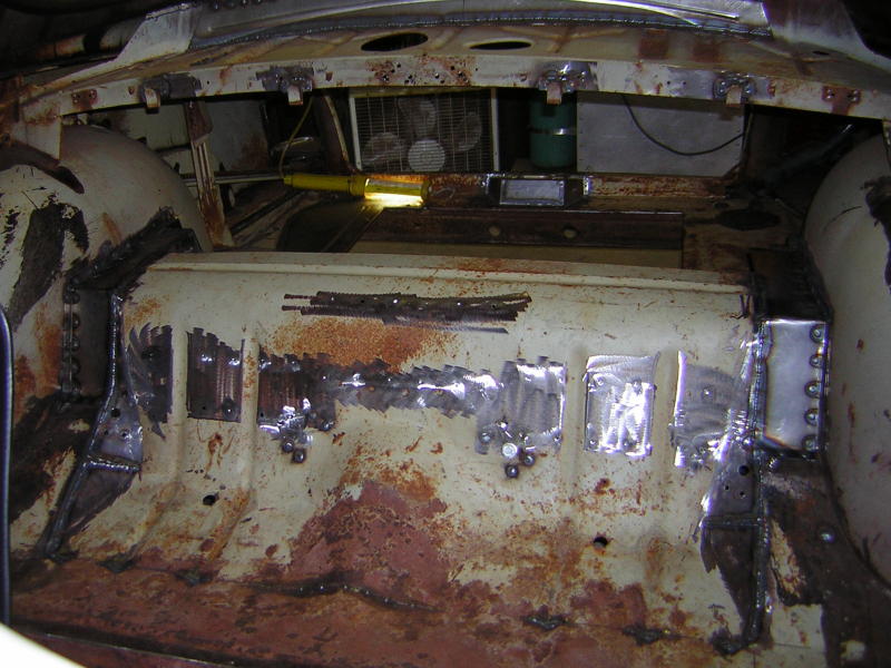

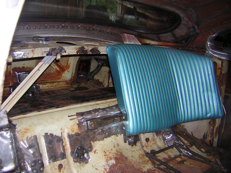

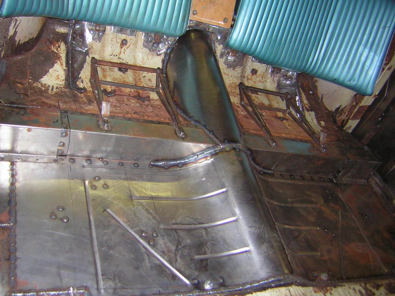

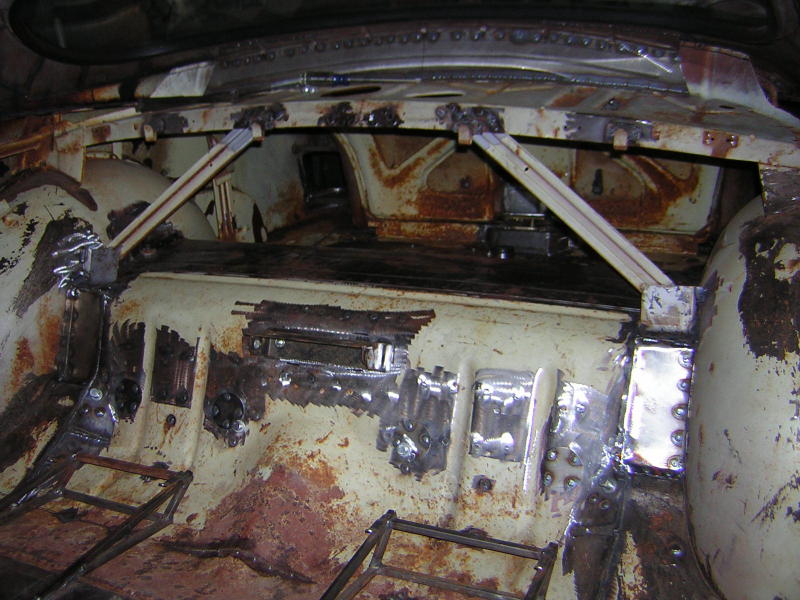

  5. Got the rear half of the differential hump finished. I welded the body mount stiffners back to the wheel wells, drilled, and tapped the notches. The body mounts are now in their original location, only higher. Now the T-bird rear seat rests right up against the hump and no need for the fabrication work I had before (check previuos thread http://www.jalopyjournal.com/forum/showthread.php?t=229300 for that work), I feel better with the seat in this configuration. I seem to have some pretty well fed buddies and I dont have to worry now that the seat is supported better. All I have to do now is trim the speaker deck supports a little and weld them back. A mild drive shaft tunnel job is next. Stay tooned ETHER

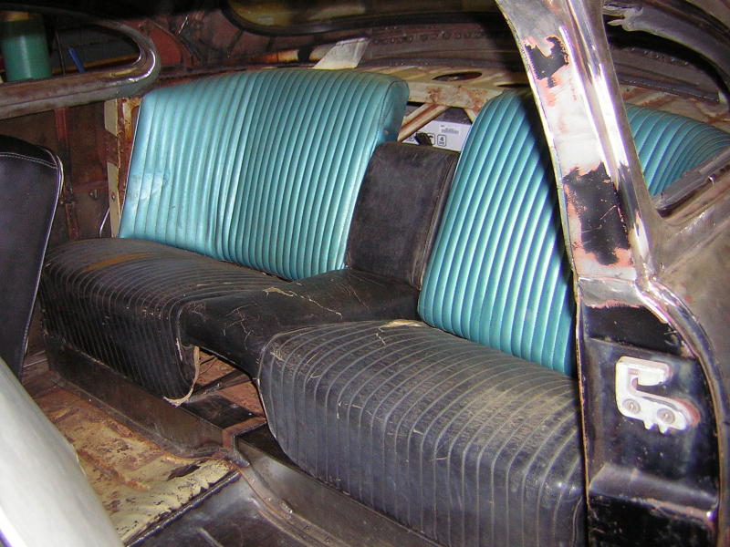

  12. Thanks, if you look at one of the previous threads, I had some supports welded to the hump to position the wrap around rear seat. Now the seat rests right on the hump like it should. I feel alot better with the way it worked out. Alot of work but some times the end result works out for the good of two situations. ETHER

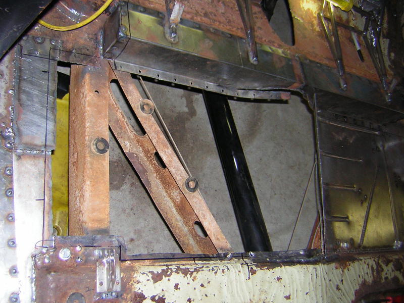

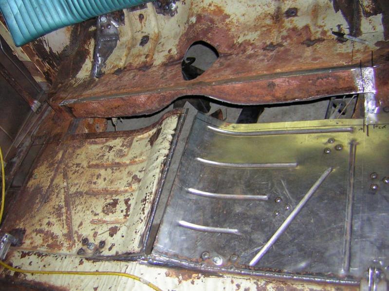

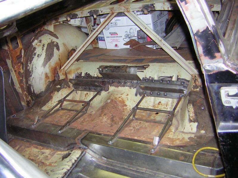

  13. Here are a few more of the back seat placement. ETHER

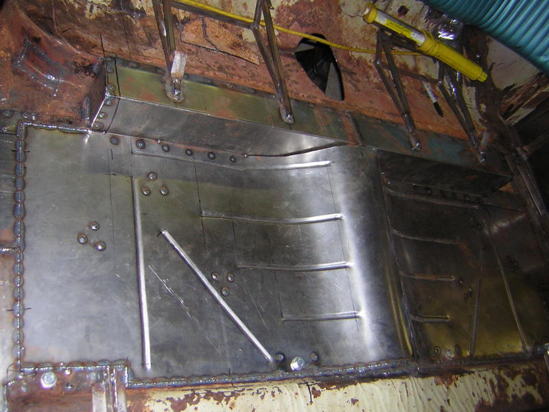

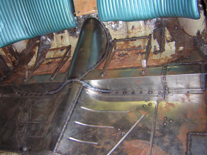

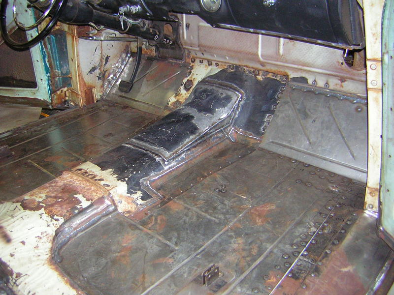

  14. Hopefully this will be the last update before the main body gets blasted and primed. The p***enger rear floor was solid but I had to do a little t******* to move the seat perch forward for the T-bird bottom seat, so I replaced it in the meantime. I lifted the tunnel as I replaced the pan for a little more driveshaft clearence. I am running Jamco springs and 2" blocks but may later bag the merc or use 3" blocks and the clearence for the shaft was tight. ( get your mind out of the gutter) Lifting the tunnel at the rear pans also required a tunnel under the rear seat bottom. When all was completed, the trans hump needed some more clearence as well. Most of the mods are done on the body but I have a good bit to do on the front clip, but I am going to get what is done in primer and maybe a first stage of bodywork. Stay Tooned. ETHER

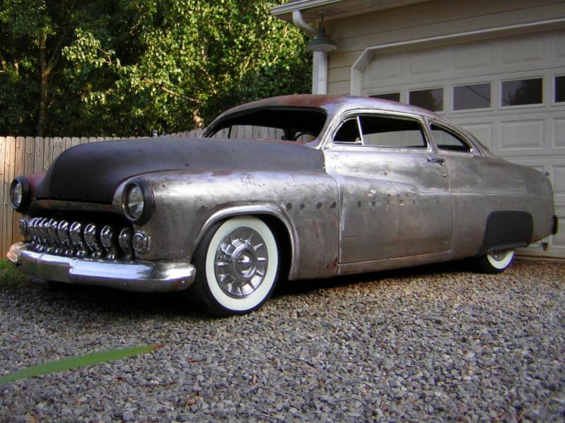

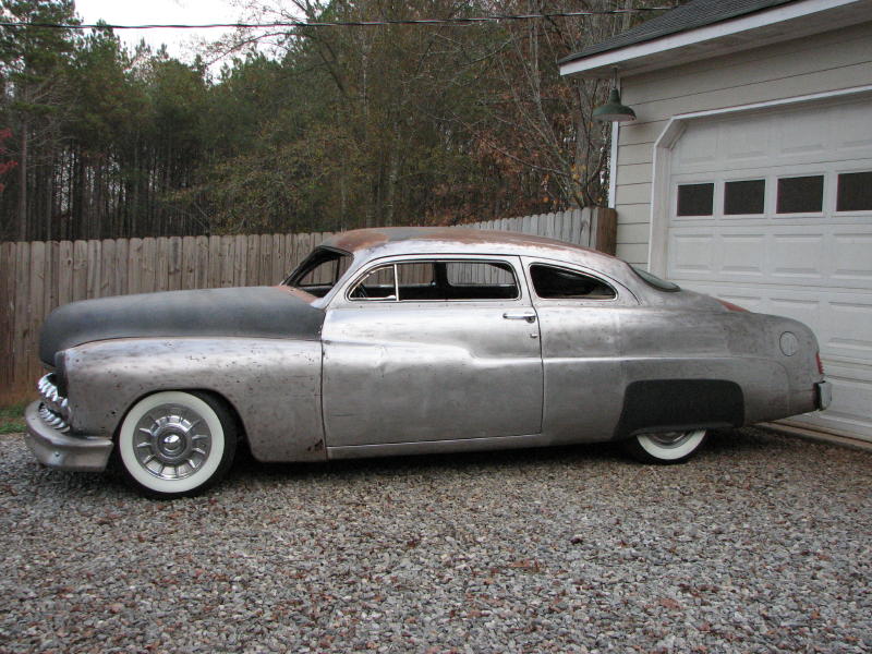

  21. Well here are the last pics before tear down for blast and paint. Just the body, doors, decklid, and frame are getting done right now. I have some more mods to do to the front clip and that can be blasted and painted alot easier. ETHER

  22. Man this thing looks great! She has come a long way, nice work.
