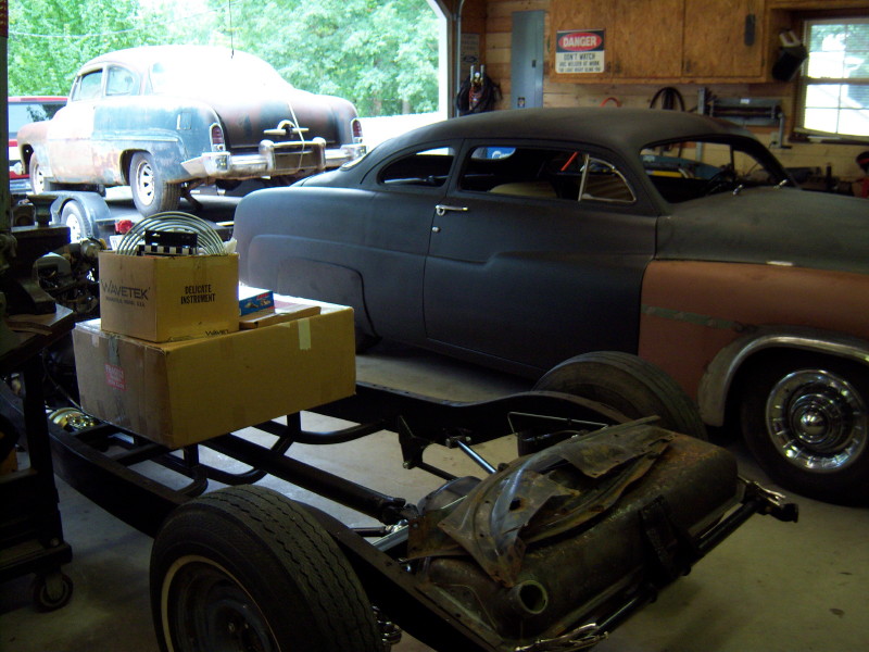

    I dig the hub cap treatment. Something not seen very often.
  2. Trashed & Hammered
    Joined: May 10, 2007
    Posts: 572
    Trashed & Hammered
    from HR,Oregon
    "****, not more merc project pics!!!!! Yep, here are a few more. Sorry if you are bored with them, let me know."
    :mad:
    Don't be stupid.... "bored" if someone is bored reading your post or looking at the photos you post.... then they can go pound sand.
    Your posts are extremely valuable to guys wanting to learn how to do things THE RIGHT WAY!
    Nice job on t******* the two outer DeSoto teeth! The whole build is coming along great!
    So how did you "fix" your caps to stay on the rims? __Trout

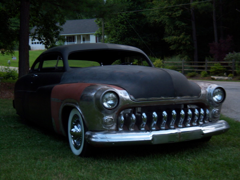

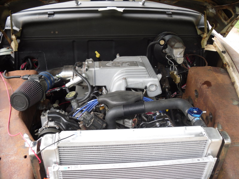

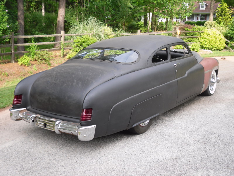

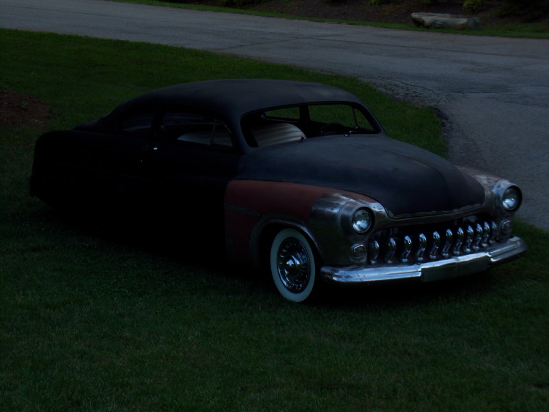

  3. No explanation, just a few with the merc out side today. Made the lower radiator hose out of 2" stainless and elbows from a dairy farm. Fan temp wired for a quick drive.

    Great looking Merc you have there Ether, I had a 5.0 EFI in an early Ford pickup that I used to have. Probably the most dependable.. best sounding engines I've ever owned.

  6. Awesome as always. What is the width of your radiator and fans?
  7. Abone, I sure would like to go to the drags. The merc runs strong and with the programable trans controller I would like to see what it does!! That would be great seeing this sled rolling down the quarter. We'll have to see. But one thing, my merc wasnt quite as bad as the one you started with, just a different approach.
    Prostock, I used a radiator from Summitt. Their brand with 22" W X 19" H and 2 1/4" D. I used one that was of Ford configured and had to revert to a GM and make a crossover pipe out of 2" stainless tubing. That worked out better in the long run. I had to weld the side angles to mount to the Merc rad support as well as the brackets for the A/C condencer. As for the fan it was a package deal, radiator, fan, shroud, contoller. For the price it was the way to go.

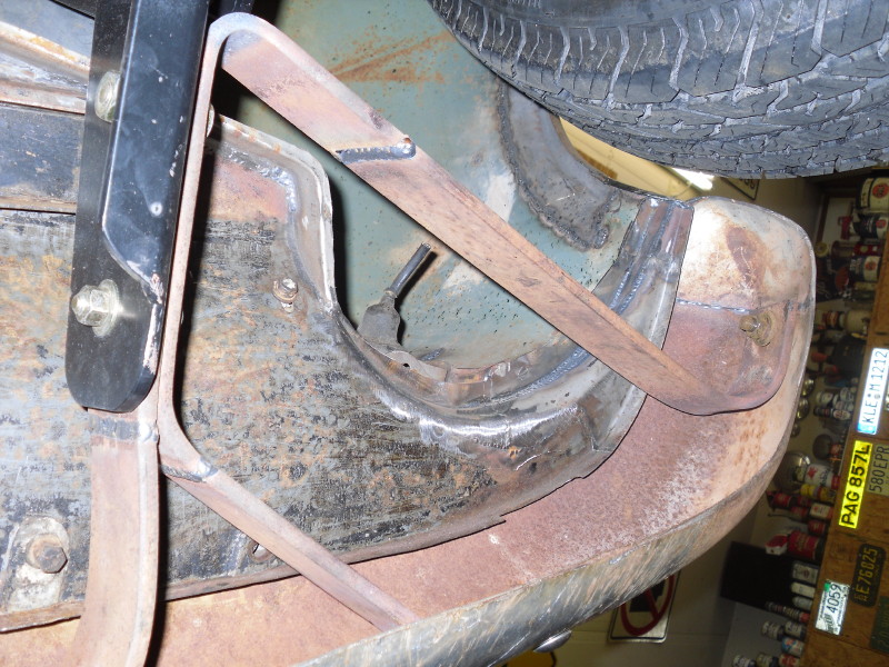

    Ether, what's you plan for the backs of the inner fenderwells (by the firewall)? Yours look just like mine, but I'm trying to figure out the best way to finish them off.
  9. I plan to extend the inner fender walls to the firewall with a removable panel. I am hoping to hide some of the engine controls and A/C components. I will be making access plates to cover the vent duct holes. That will come down the line a bit. I will keep you posted.

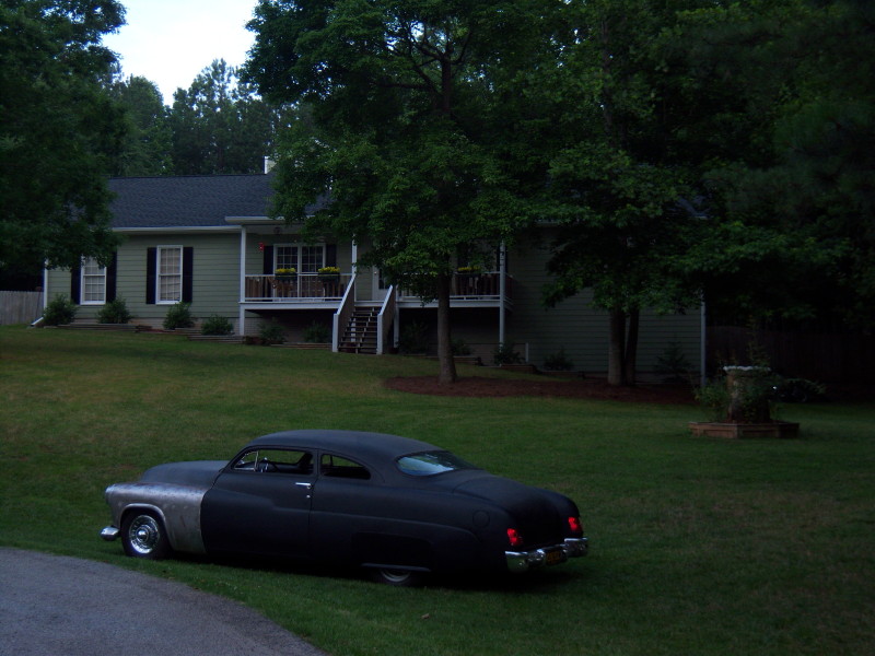

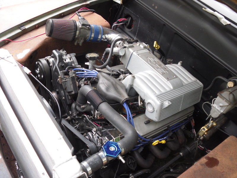

  10. Working on a 34 Tudor and a trip out to the LA Roadster Show, there is not much time for the Merc. I have been tinkering with a few small drivablity issues and have them worked out. One of the biggest problems was the radiator in and outlets. I ended up nixing the first radiator and went for a chevy configured in and outlet set up. Using dairy farm stainless steel 2" tubing, a cross tube was made to get the Ford V8 connected to the GM style inlet.
    Also, A little messaging on the 51 bumper brackets to get some tire clearence since I ****ed the bumper in tight. A little luck and we took he out for a cruize. No window but a ****load of fun!!!!!

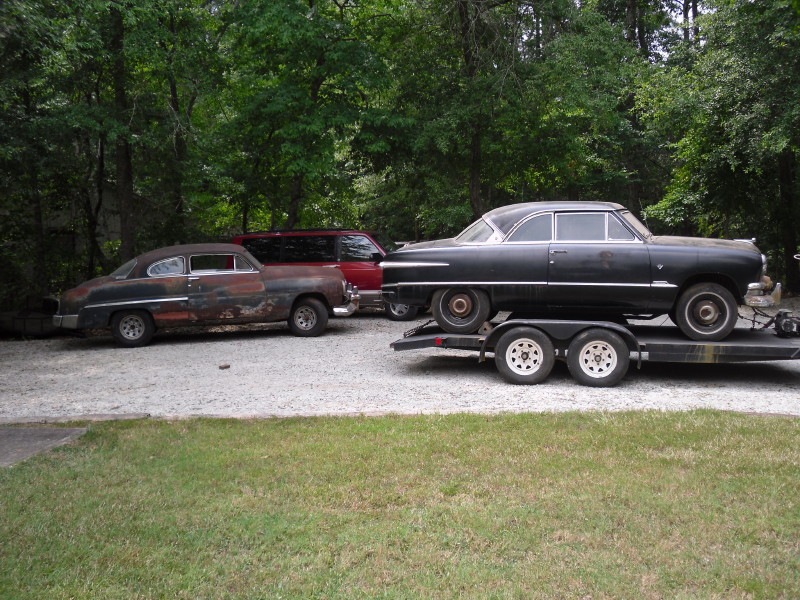

    Now for the good $#!T, I went to a good buddies house and he was going to s**** all this 49 Merc sheetmetal in the last photos. Truck and trailer load. Saved it all and for FREE, that **** doesnt happen everyday!!!!

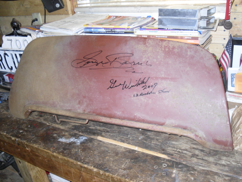

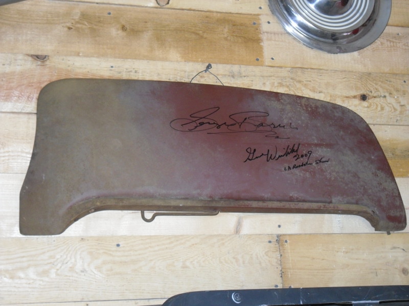

    By the way, The last pic is of the NOS factory 51 Merc skirt I bought at the LARS for a wallet emptying 25.00 and had it signed by Gene Winfield and George Barris. One *****in shop wall hanger, not to mention an expensive one!!!!!

  13. Well, looks like Im having to sleep in the shop tonight. I drug this one home and putting it up for a later build. Telling the wife its for her didnt go over too well. The Vicky is a good friend of mines. He bought it from the same buddy of ours. His is a bit solider than mine ("SOLIDER" damn I think I just made a new word!) We got into a LITTLE trouble at his house with his bride also. What the ****, it must be the moon??????
