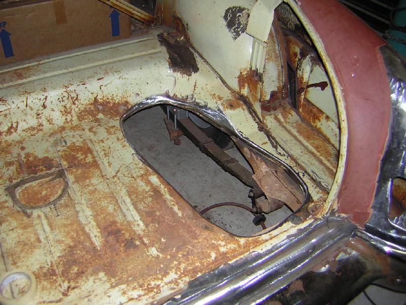

    attitudor

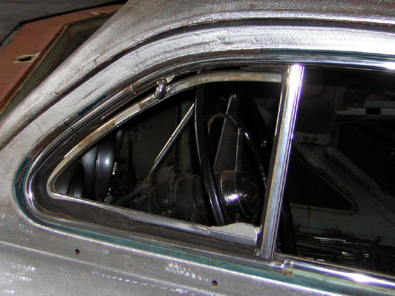

  26. Here are a few new ones. Playin in the trunk!!!! I rid of the spare wheel well and stitched in a new piece as well as the hole for the gas filler tube. Im thinking of running a mustang tank and a space saver spare tire so the well had to go. I also added a pic of the front vent window, just moched up and final weld and polish of the stainless is to come, and the rear tip out window with the Hudson window frame I had mentioned about. More to come! ETHER
