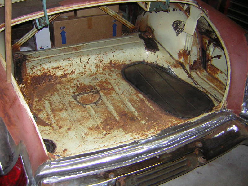

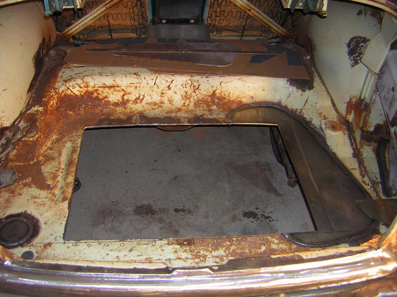

  5. Not a bunch to show as most of the stuff im doing is minor final fit items so i can get the main body blasted and in DP-90. I am going to run a sink type fuel tank and doing that im using a Mustang one. Its out of a 65-68.mustang and holds 16 gal. I might be changing to a 69 which holds 20 but that may be later. I cut out the center of the trunk floor and metal worked the edges down to help add in strength. I have a solid peice of trunk if anyone needs it. I will be removing the existing fill tube from the tank and moving it to one of the diverside corners to help ease in connecting it to the filler door tube. As for now Im just trying to concentrate on the firewall and get all that cleaned up. Ill post more pics later. stay tooned ETHER

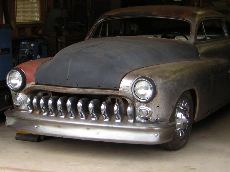

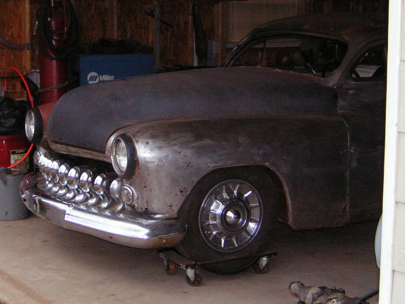

  11. Heres a little bit of whats been going on this week. A bit of firewall cleanup, column mount and locate, brake booster and swingin pedal. At this rate I'm hoping to get the body in some kind of primer.

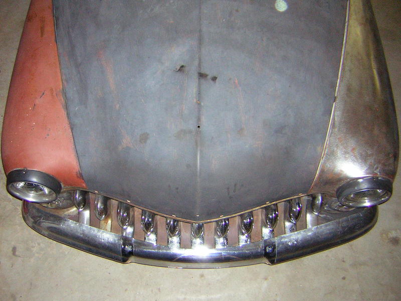

  16. Heres a shot of the 53 Desoto bumper and a pic of the 51 Merc bumper just hangin on the pan.The Desoto one is the bumper with the same face contour as the grill teeth. I really like the merc bumper, but still not sure. One of the few things Im not decided on yet. Anyone??

    mmm im diggin the desoto bumper
  18. The Merc bumper flows better, but the DeSoto is more in proportion to the teeth.....:confused:
    I'd hate to make that decision....but you'll make the right one :cool:
    I gotta say I'm floored by the work you've done to your car. I'm really impressed and humbled at the same time.:eek: Awesome.

    Does your pan and teeth need to come up an inch or two, or is it just teh pic?
    My vote is Merc bumper with out a doubt.

    Any chance you can get your hands on a 49 or 50 Merc bumper? Try that, definately worth a look. You are going to need the brackets too tho, different than 51. That should do it really well with that front end.

    On a friends 51 Convert, they used two 51 bumpers and filled the center flat spot. So the contour was the same all the way across, with a slight "V" in the center. Big $, but damn a good lookin bumper!...............OLDBEET

    I agree with OLDBEET the tag recess is the weakest point of the Merc bumper.
    I like the agressive look to the Desoto one but it'd need some reshaping to look right at the ends.
    Go with a re-worked Merc one and keep it classy. I think.
