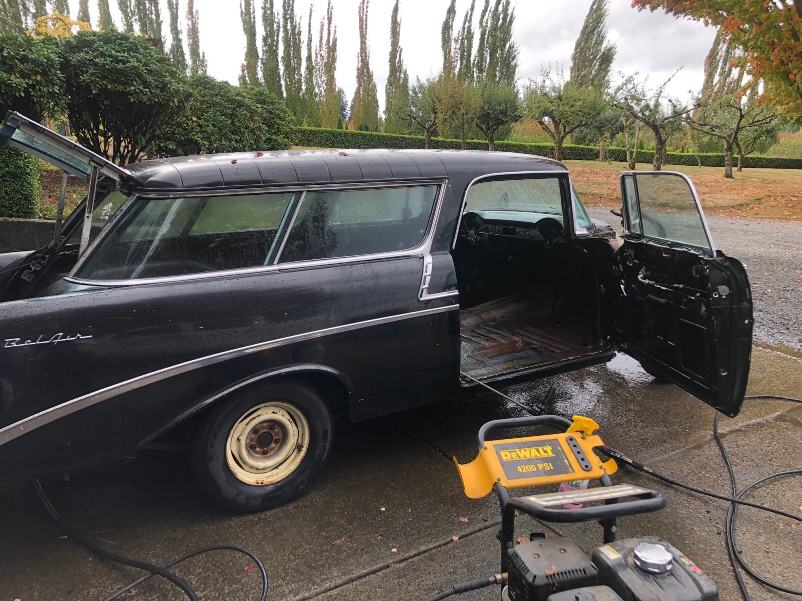

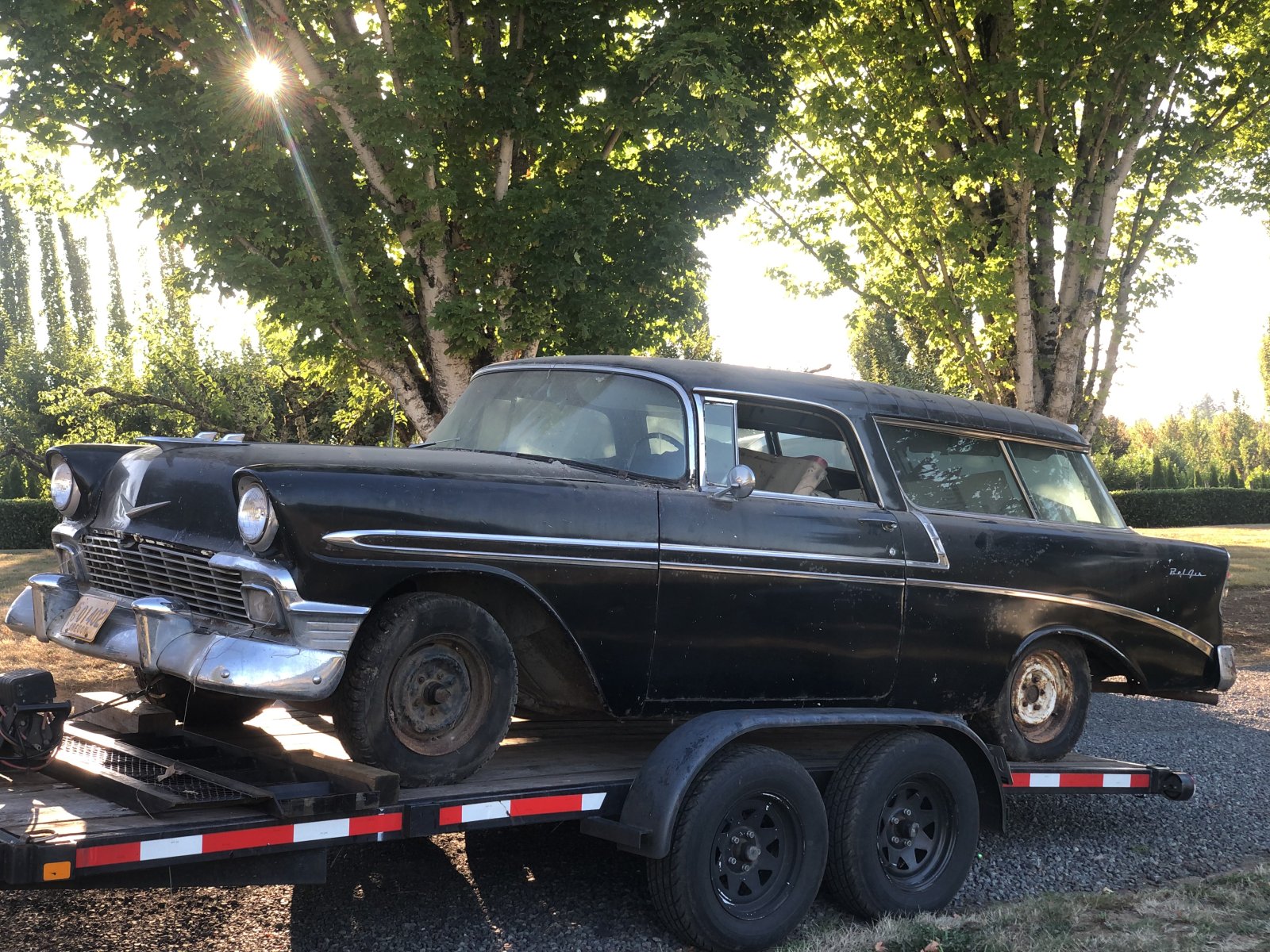

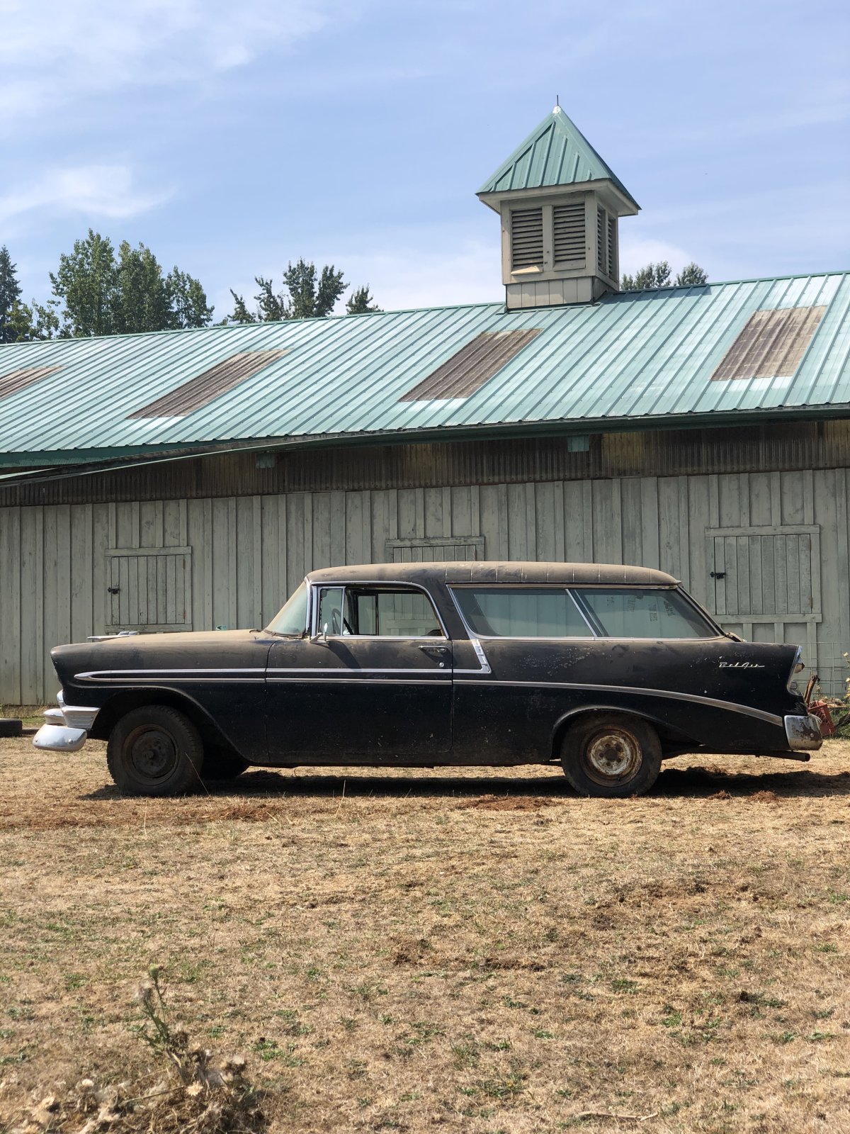

    Here is how it looked when I bought it:
    I got it home and cleaned it up.

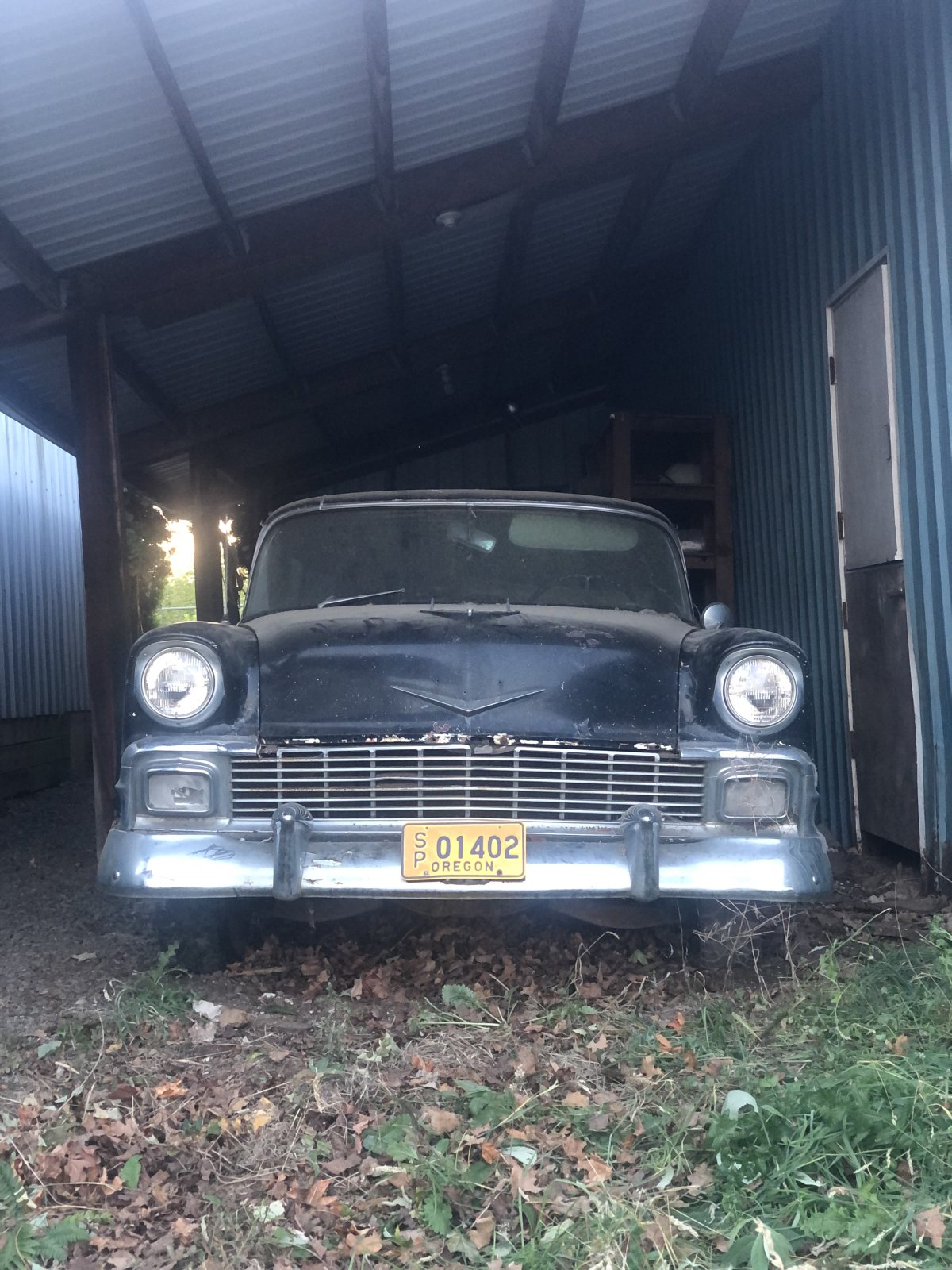

    As much as I wanted to rip into it right away, I had to get what was in front of it done first. So, I had to put this thing back on barn-duty. In fact, I didn't even have space in my own barn. It had to hibernate in a lean to for a couple of years.

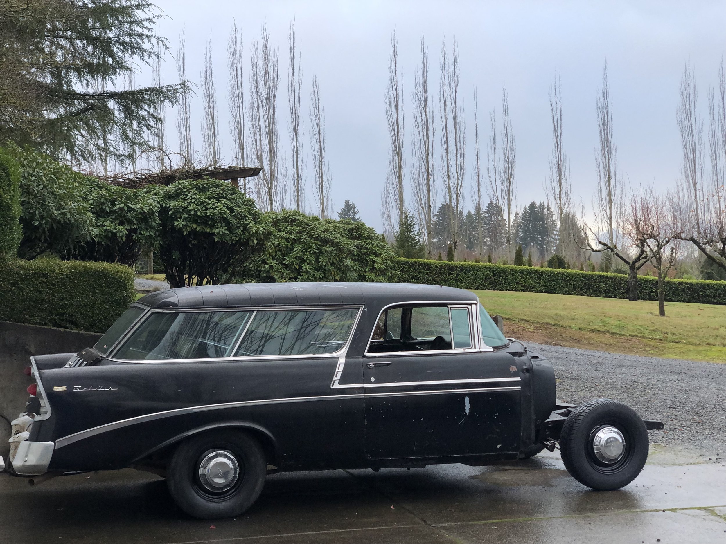

    Just a couple of weeks ago I finally pulled it back out of the lean to and dragged it up to the garage to get started on this long overdue project. To say I'm excited would be an understatement.

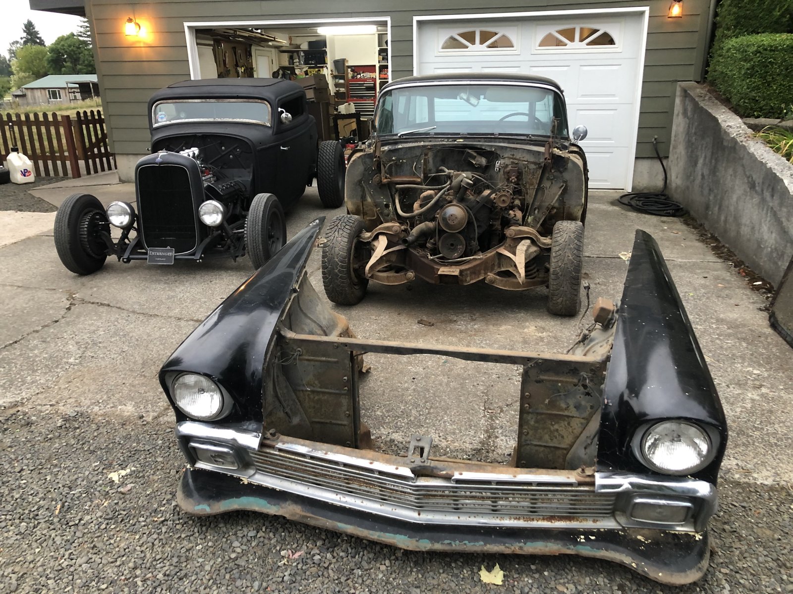

    I do have a fairly decent sized shop, but it is completely full with no room for this project. So I cleaned out the other side of the garage on the house and plan to do this in there since it is all basically bolt together stuff I can throw together with hand tools anyway. And the weather is still nice so I am doing as much as I can outside while I'm able to.

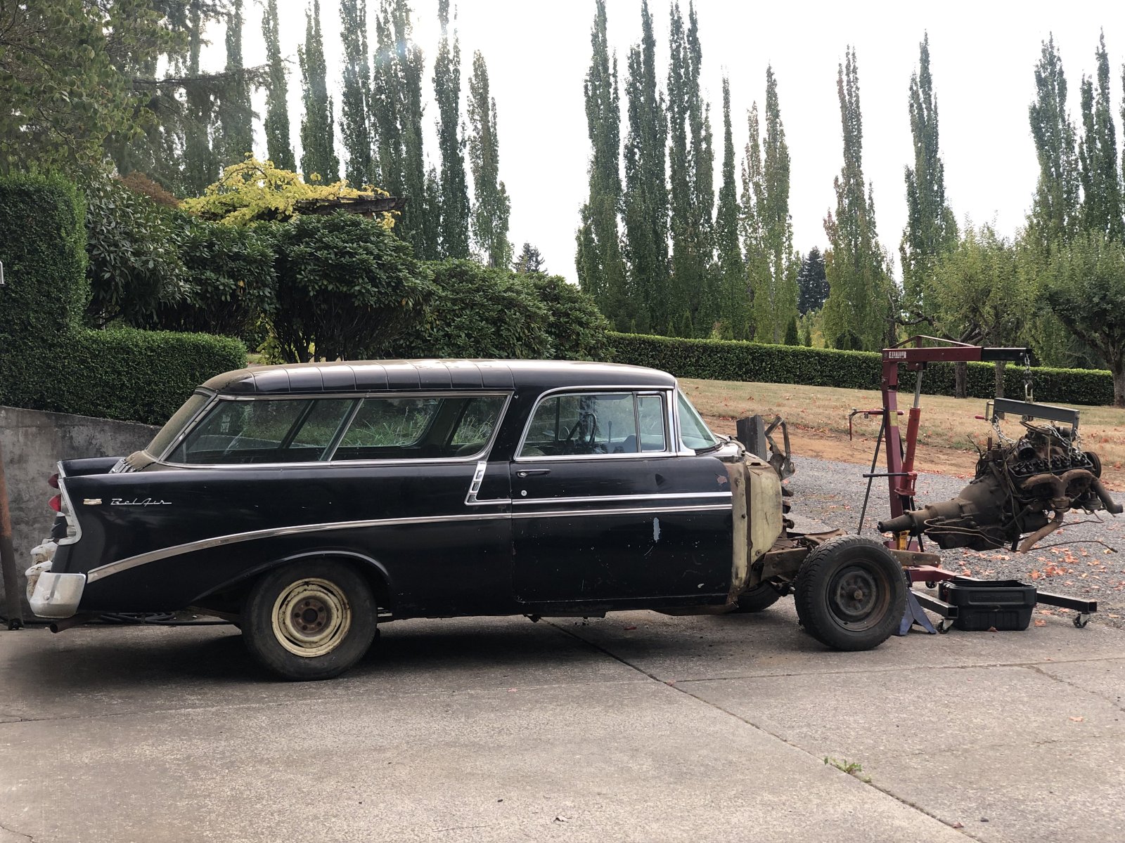

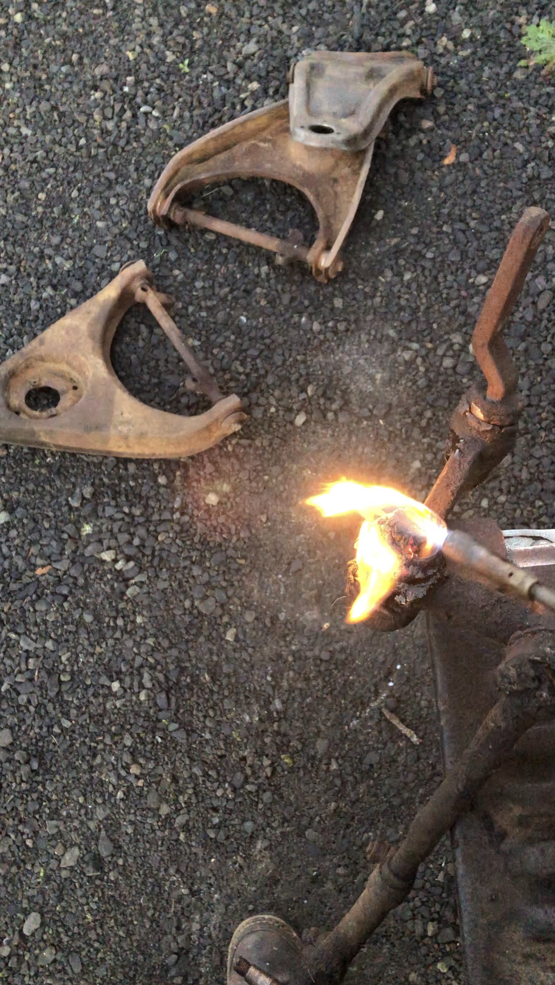

    The first order of business was to pull the front clip off.
    Then I yanked the old motor and transmission out.
    This was just a few days ago and I haven't done too much since, but I'm just happy to finally be working on it and plan to get back to it in the next day or so. I will update this as I go.

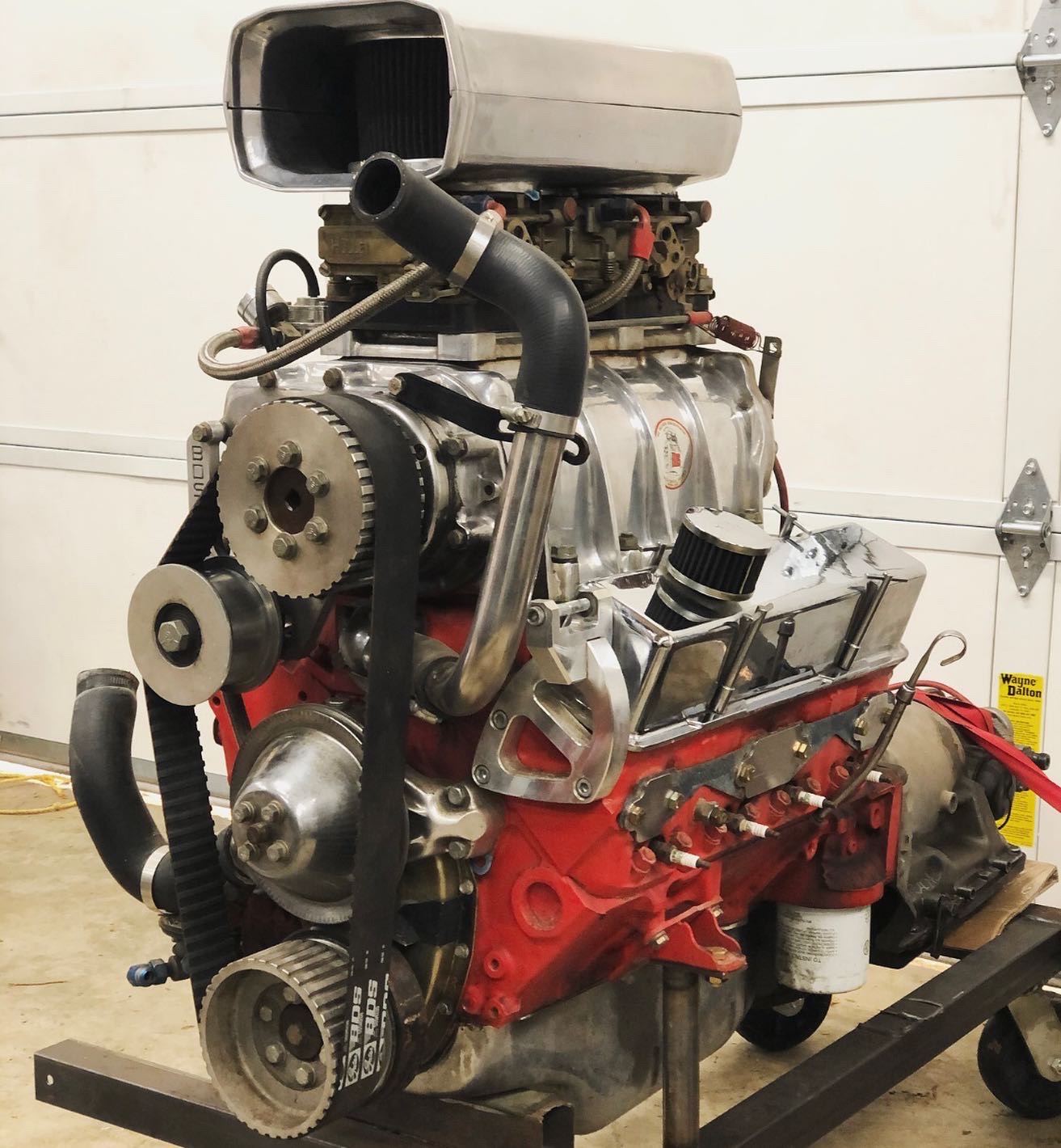

  3. chevy57dude
    Joined: Dec 10, 2007
    Posts: 9,681
    chevy57dude
    This is going to be great! The car is solid from what I can see. Quite a good friend to give you a complete blown engine! Is that a mechanical fuel pump on it?

    A great friend for sure! Yes, mechanical pump. Carbs are just 600's.

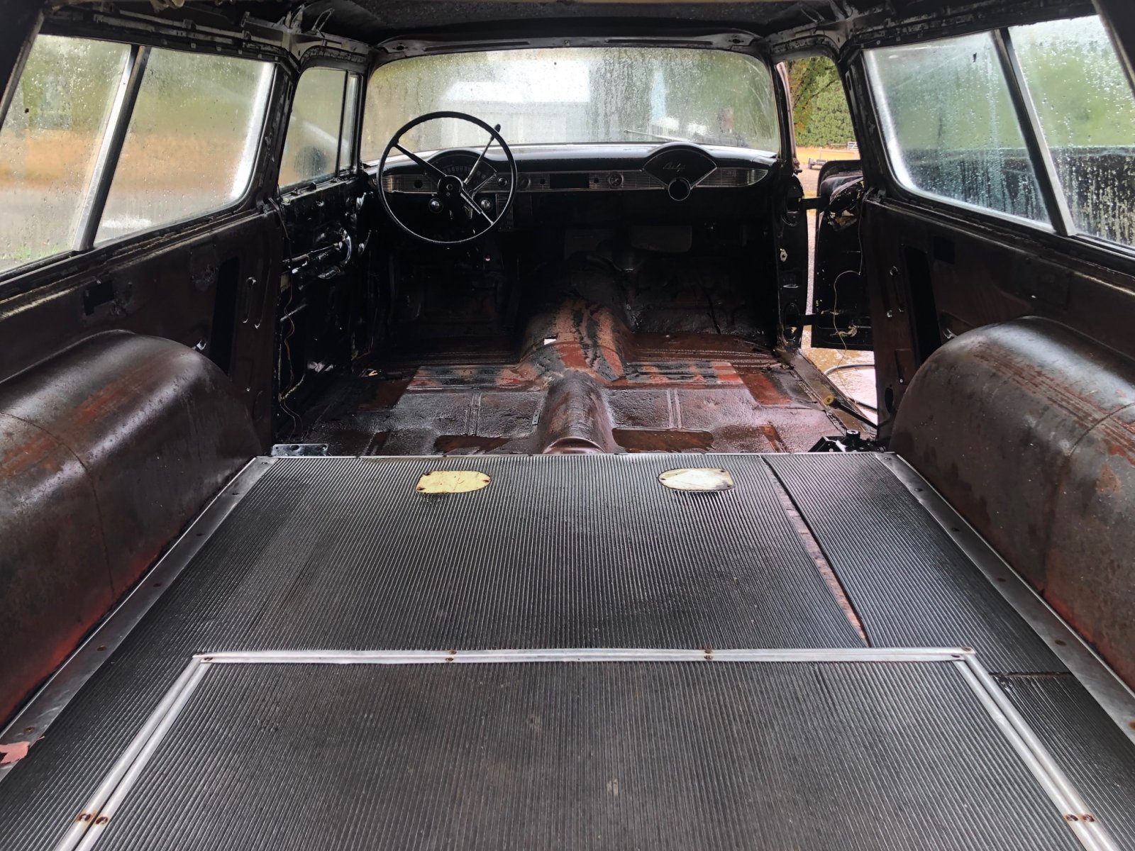

    I have been slowly pecking away at this car over the last couple of weeks, with a few distractions along the way...
    I finished gutting the interior and was pretty happy with what I found once it was out. There are four smallish areas in the floors that will need to be dealt with, but in general it is really solid. I also blasted the inside with Super Clean and pressure washed it for good measure.

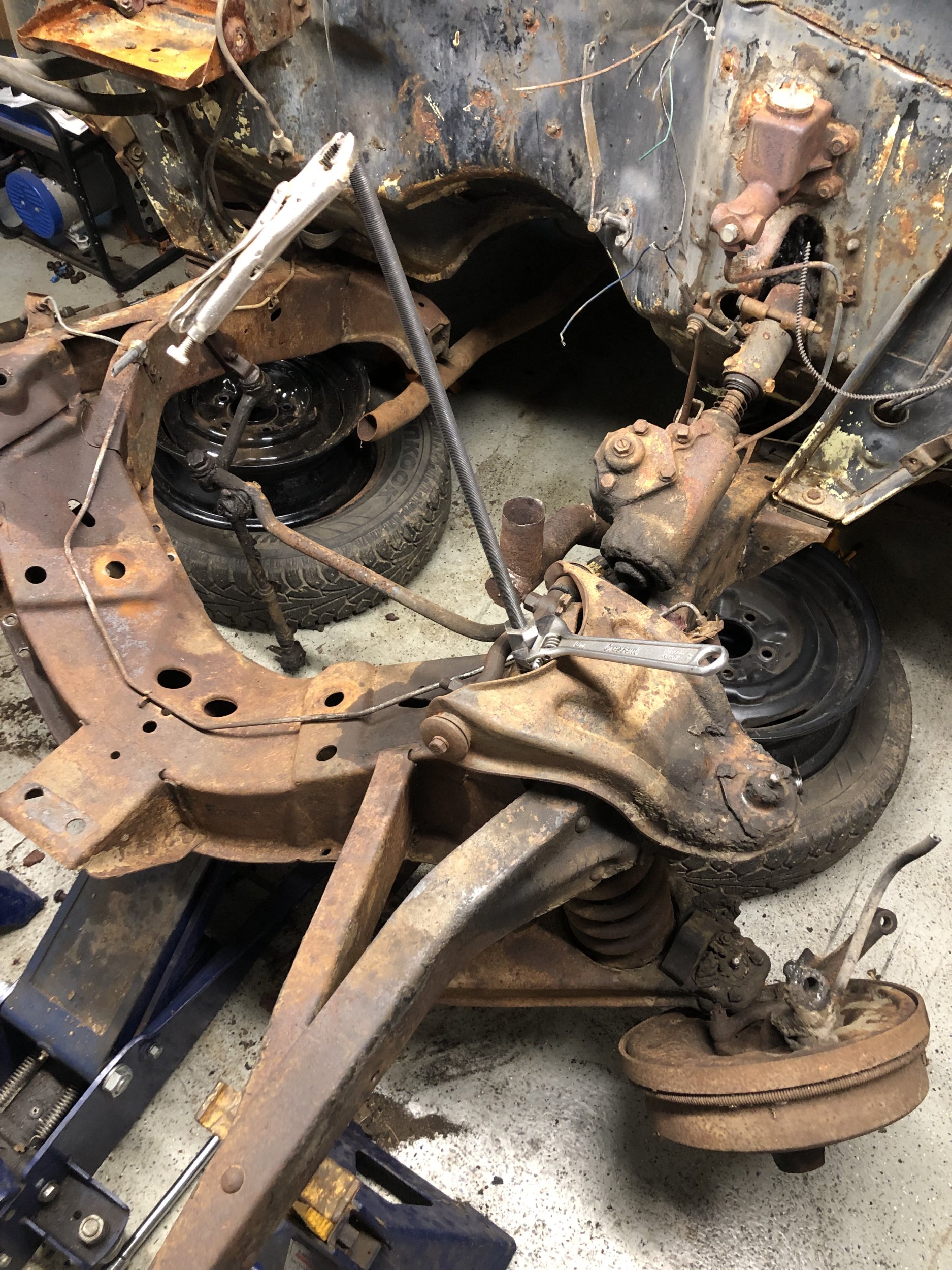

    Next I am going to put it in the garage and pull the control arms and steering apart and start rebuilding/replacing all of that. I need to get some wheels and tires ordered too.

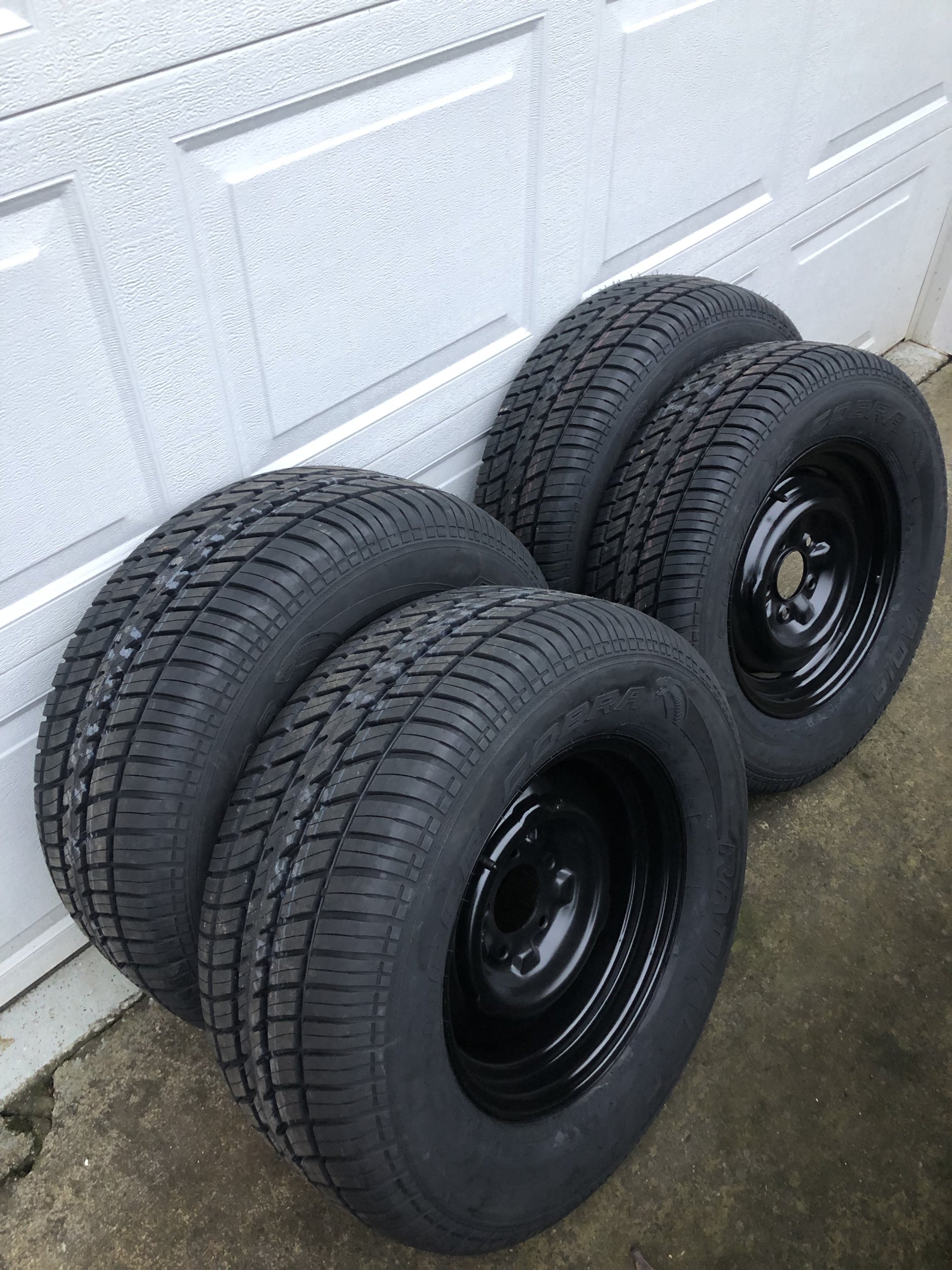

    Nothing too exciting, just 15x5 and 15x7 steel wheels and Chevelle dog dish caps. As much as I'd love to run Magnesium on this car, I really do plan to drive it every day, rain or shine and just don't want to deal with the constant upkeep, not to mention the cost. If I change my mind, I do have a set of big window Halibrands on another car I could rob, but I think this car will look good with the steel wheels and the right stance.

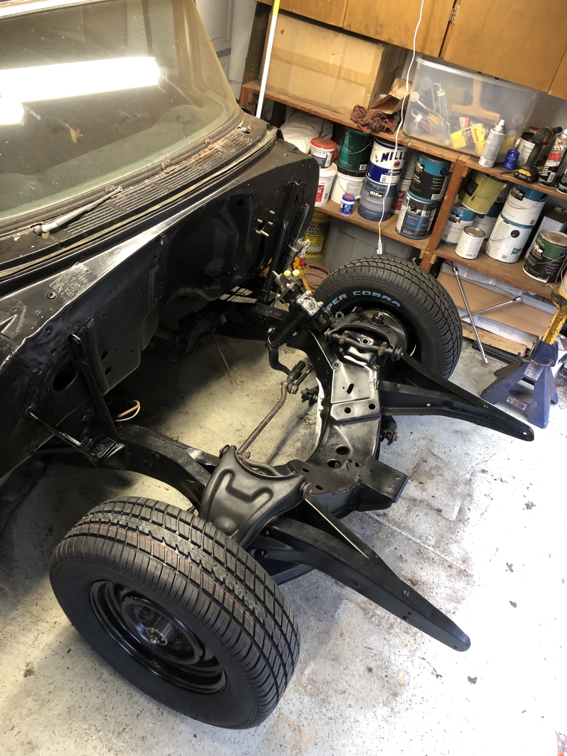

    Just a quick update. I have been working on this car off and on whenever I can.

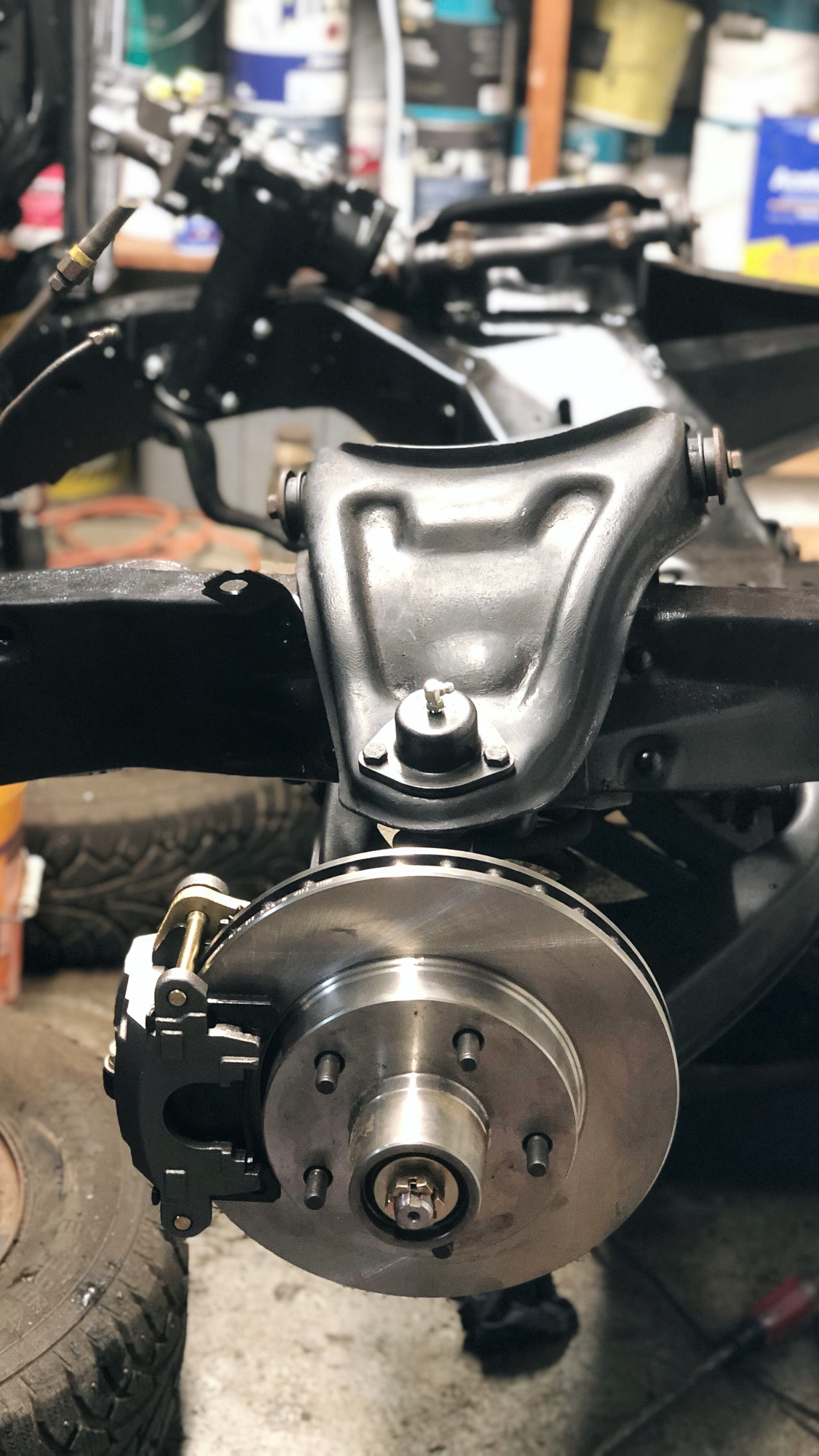

    I pulled the steering and suspension, cleaned up all of the surface rust on the frame and gave it a quick coat of semi gloss. Then scuffed, re-seam sealed and painted the firewall while I was at it. I replaced the control arm bushings, ball joints, tie rods, rebuilt the idler, installed a new Borgeson power steering box, cut one coil and added dropped spindles and disc brakes. I have a new, shorter steering column to accommodate the Borgeson box, I plan to throw that in shortly, then I will haul it to my buddy's shop so I can use his lift to do some things under the car, as well as getting the new mounts in place and stuffing the motor and trans.
    I mounted the new wheels and tires too and today was able to put the fronts on and roll the car outside for the first time in a couple months. The rears are not on yet, I'll do that when I address the rear brakes. It was cool to see it roll again finally and to smack some dog dish caps on for a quick look.

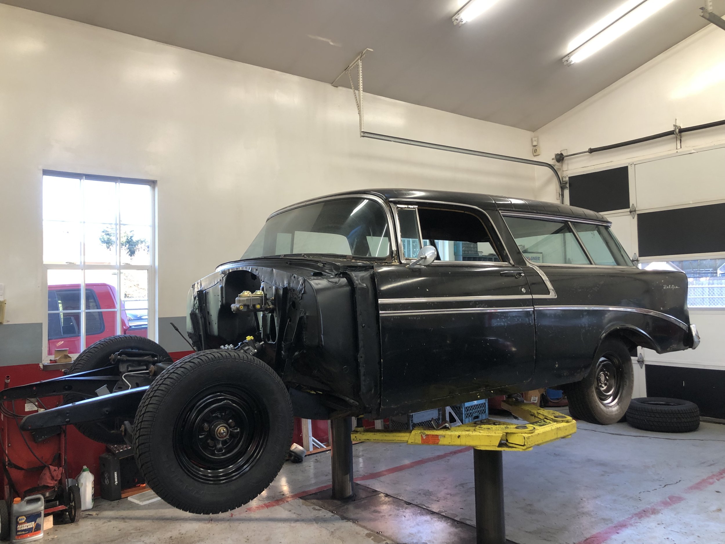

    I was able to sneak the Nomad over to a friend on mine's repair shop and use his rack to knock some stuff out. By the end of the day tomorrow I'm hoping to have the motor and trans in, rear brakes redone and brake lines ran, and a bunch of other little things. It sure is nice having good friends willing to lend their time and their facilities.
    I can't wait to see the motor in it, it will be a huge motivation!
