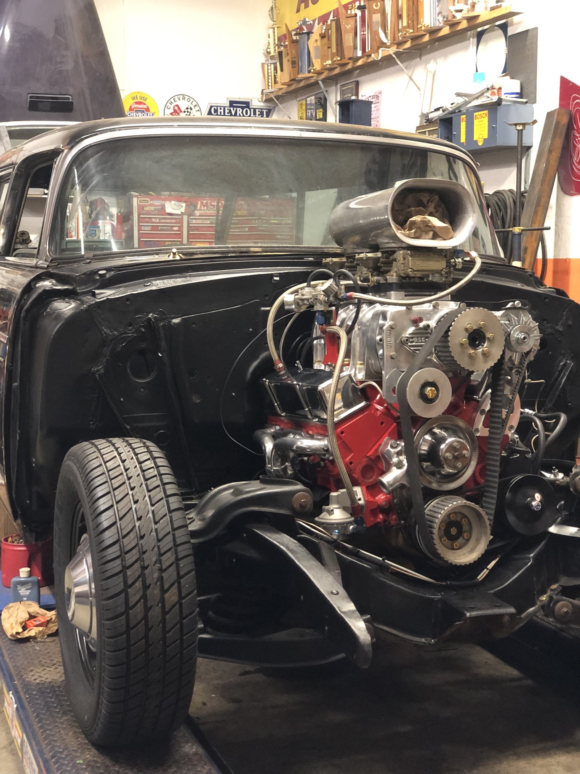

    Ran into some oil pan clearance issues, which I was anticipating. I wasn't prepared though for my solution (had multiple other pans on hand) to not work either, so I will be ordering a Milodon pan and pick up. If anyone has experience using their 30900 pan on a tri-five feel free to chime in.
    I was also surprised at how far off the side mount motor mount kits are in terms of fitment. I tried two different sets, one from a local supplier and one from Danchuk, both had their own separate issues when it came to fitting the frame, each having sizable gaps that required considerable shimming and monkeying with. They were so goofy that I ended up bolting stock front mounts on to locate the engine just to be totally sure they were as far off as they looked. They were.
    All things considered, the challenges were minimal and have been mostly overcome. I was happy to find that my Sanderson Headers clear the Borgeson steering box very well. We also knocked out a bunch of other small, tedious (although not as exciting to look at) items off the list while it was on the lift. I didn't want to plop the blower and carbs back on until I had a chance to final-weld all the mounts for the motor and trans, but it was fun to push it out and take a look at the progress.

    I did a motor swap with side mount kit and transmission crossmember in a '56 Chev for a buddy, and had the same issues. I bolted the new 350 SBC in with the original front mounts, and then did one side at a time. I had to cut small pieces of spacers to slip between the mounts and the frame and tack them to the mounts. Once I had the gaps filled and welded I tacked the mounts to the frame and pulled the engine back out. Then burned them in and reinstalled the engine. The trans crossmember was a great fit, and nothing needed there.

    That's just what we're doing too. Before final welding, I set the blower on to have a look and make sure everything clears ok. I can't believe how killer it looks.
    Now to yank everything out, pull those front mounts of and weld everything up.
    ironandsteele.com​

  14. The alternator is going to be way up top like that ?

    That’s where it was when this motor was in a hot rod previously. It isn’t where I will have it.

    Looks like you might be able to put that alternator bracket on the passenger side head and make a new mount for the adjustment arm to get it down lower?

    Yep, I am moving it to the passenger side.
