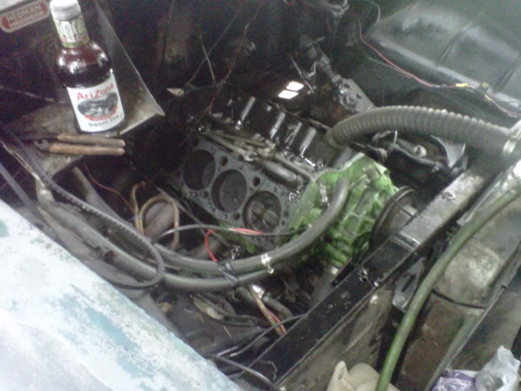

    Cam was flat- like 3 exhaust lobes an a intake lob or two hahahaha shitty
    So all new gaskets, oil flushes like crazy and a lunati cam/lifter kit made this
    Cleaned up my interior a bit, makes driving it now a lot nicer! And since I have all her problems more or less figured out I'm not ditching her... Which means paint and more parts!!! Get paid monday to so let the fun begin hahahaha
    Best thing I've learned... 350ci and a spool tied together with a 5spd is funnnn

  11. What heads do you have on that thing? I can see dished pistons in that one pic, and with 76cc heads, you will have around 8.2:1 compression. Might be why you are having a hard time getting it to ping....
  12. doublenickletickle
    Joined: Jun 27, 2012
    Posts: 32
    doublenickletickle
    I'd have to cc them myself as I don't believe the guy I bought it from about anything, but I'm sure there old 2.02 heads or have had 2.02 valves installed but I'd believe the former over the latter.
