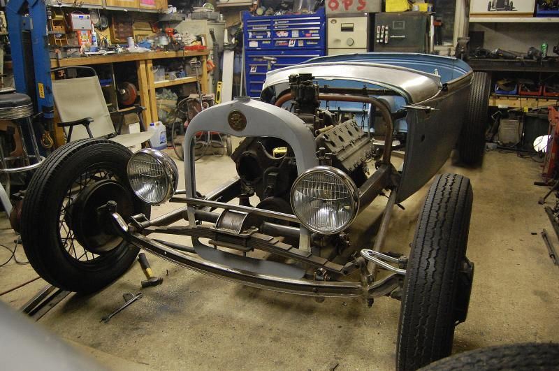

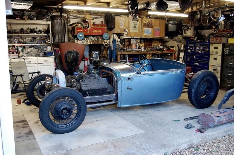

    Hmmm, where to start? Well, basically, Russ has cut most of it up and started again! Not because there was anything wrong with the work Ivor started you understand, just that certain things have changed with the overall build, plus I've changed my mind on a few things, and of course Russ wants to build it the way he wants. Which is exactly what I asked him to do so its all good.
    Its difficult to explain without some pictures to show you, so lets just say that things are progressing nicely, and I'm sure Russ will stop being camera shy and show me soon!
    Also, thanks to Russ and Dale, we've had a major result regarding parts. A guy about 3 miles away from where they live is breaking a '39 Cadillac limo in preparation for banger ( :eek: ) racing, and has been persuaded to part with most of the unboltable bits of the car for a reasonable price. This has included loads of trim and chrome, dash parts, pedals, and even the engine and gearbox.
    This was great luck as it means Russ has a dummy engine to build the rest of the car around, as the delays we've had with the motor were having a knock on effect. So m***ive thanks to both Dale and Russ for not only finding the parts, but spending their free time dragging it all back to the workshop! I've been away on tour since the middle of Jan so I really couldn't have done it without them. Cheers lads ;)

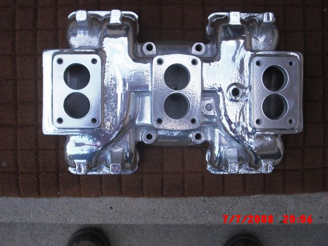

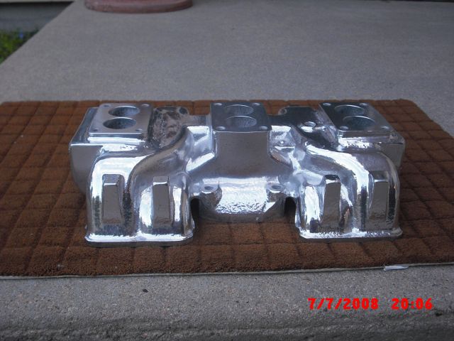

    I don't know where to pick up a 2x2 at the moment, but might be able to get this 3x2 I built back....

    Hey Buddy, how ya doing?
    Hmmm, that inlet certainly grabs the eye, dunno if 3 carbs might be overdoing it a bit though! What did you run it on, tell me more ;)

    I don't think you need to worry about having too many carbs-you need to worry about getting ALL the air you can. If you do a light port job, and dual exhaust, with the cam you need, you'll need air to make HP.
    I never did run it. I made it for the original FlatCad, when it was going to be a hotrod engine. Then I swirched to the first blower manifold, before this was ever ran.
    This intake is now gathering dust on a shelf in New Mexico.

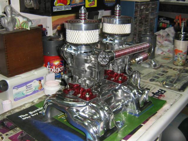

    Ratty, here's some inspiration- this is a 2x2 I used to have. Can you imagine what you could make that 3x2 look like?:D
    Have you, are are you, going to go with the aluminum timing cover?

    Seeing as how I have been making progress I figure an update to this build thread is long overdue...
    This is how the car looks like now. Slowly getting somewhere...
