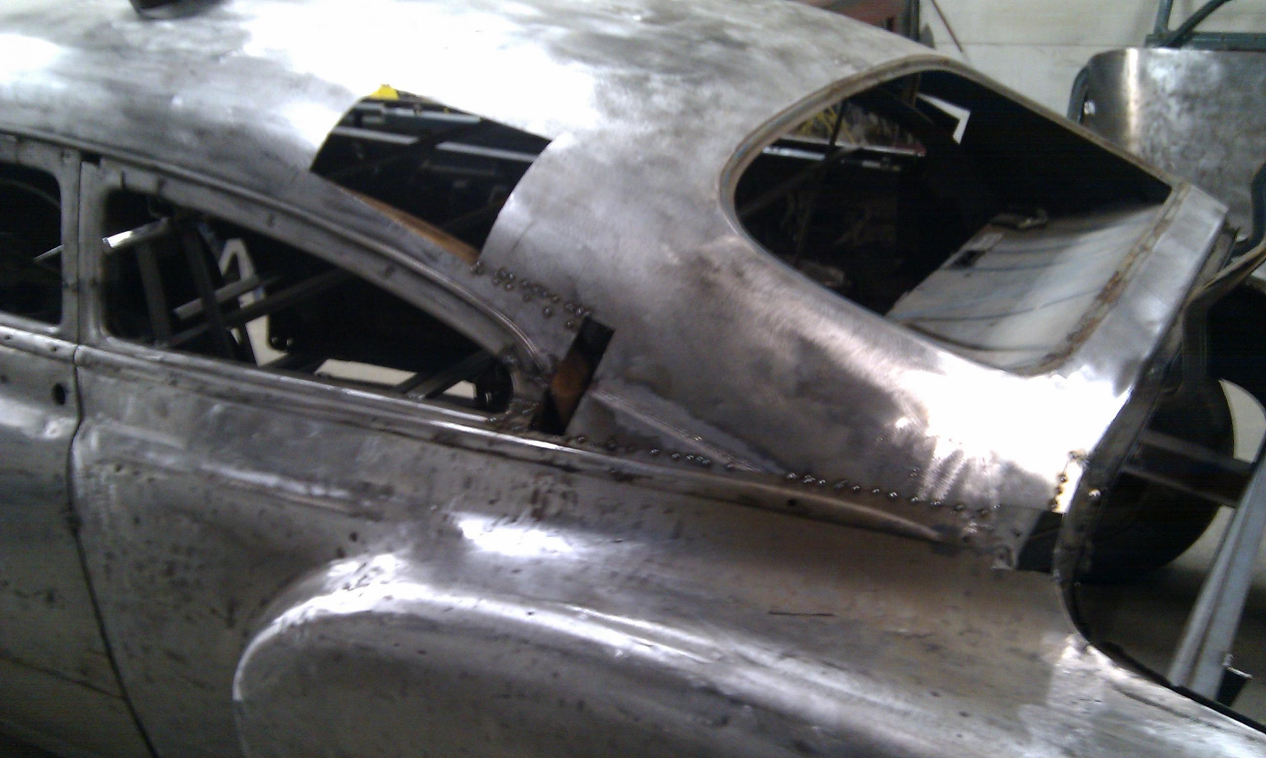

    Nice job Fitzee! Was on West Coast... back Monday (will drop in) gone west again Tuesday.. Like the look of the worked rear quarter better than the stock side... but.. your car...your build!! It looks great!! Gonna be a head turner forsure!!

    I must admit... pictures DO NOT do this project justice. It is just right in the chop dept.. stance is right and it will be a head turner around these parts.

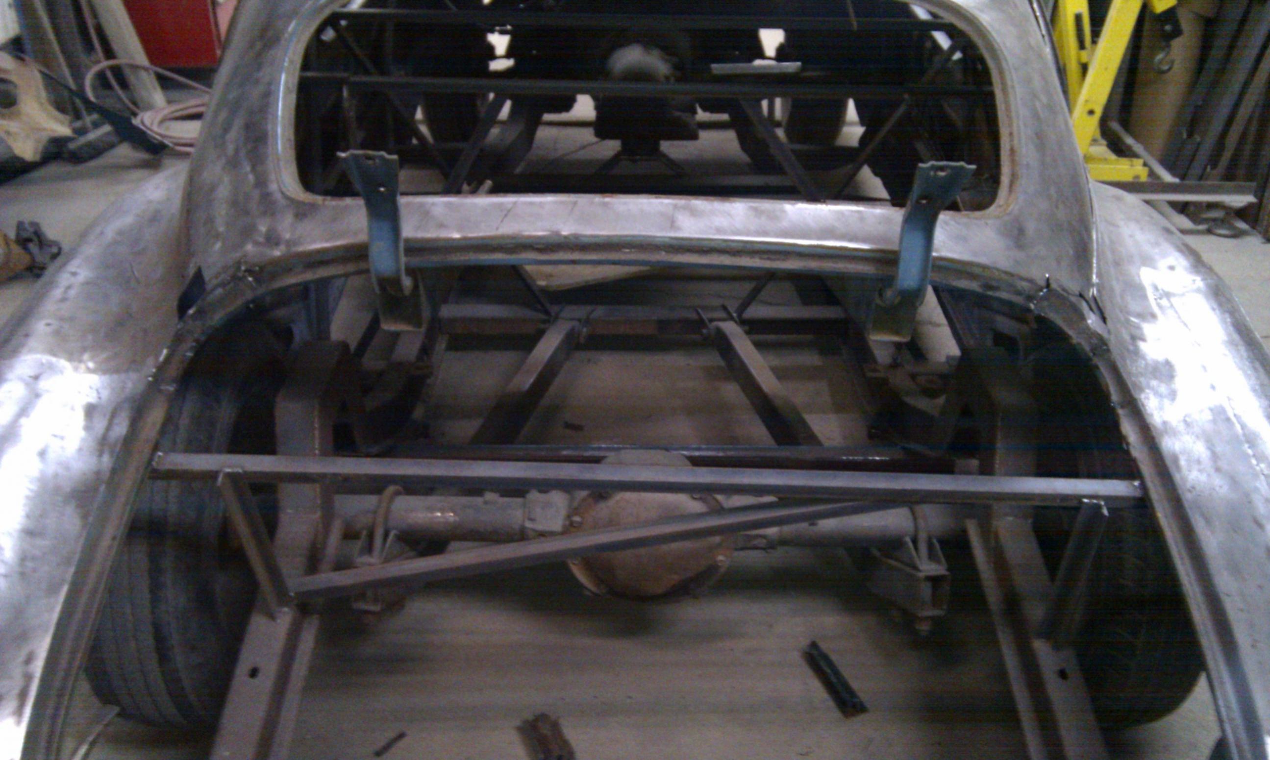

    Got an hour at it tonight.Just fitting the driver side tops and door post. had to go to another job so night was cut short..Oh the chop was 4 at the front 4.5 in the middle and 3 at the back.. Was not sure on how much it was by the trunk.. Measured it today!! Bill Found the problem why the driver side was down.. Body was flexing at that rear body mount.. Jacked it up and ran a brace from the mount to the cross bar you put in.. problem fixed!!

    That was bothering me a bit...but I figured the problem would show itself as you went thru the cutting and fitting.
    Not surprising the old girl has some flexing going on, considering she had no bottom to start with! LoL

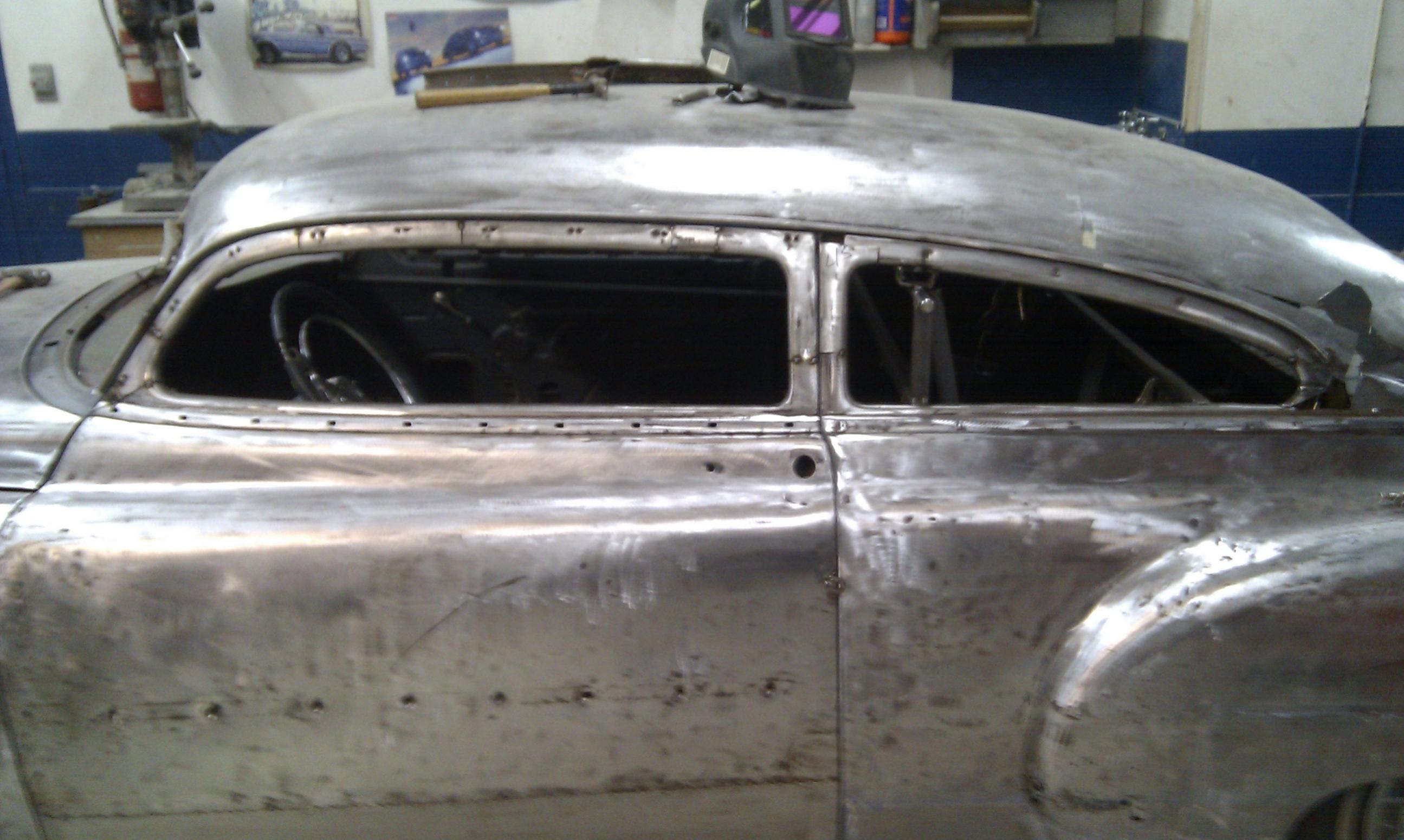

    Well making my way around the car and fitting all the car togeather. Not going to fulling weld everthing yet till I have everthing figured out..Can see a few things I need to address and when you do the other side you always find some different and most times it is too late then and you end up chopping everthing up agian.. anyway here what she looks like with a top on the door.

    The door tops tie it together fitz . Looks good ...

    I really like that you didn't sink the trunk opening. I think it makes for a much better chop. Looking really good! ~spasecadet

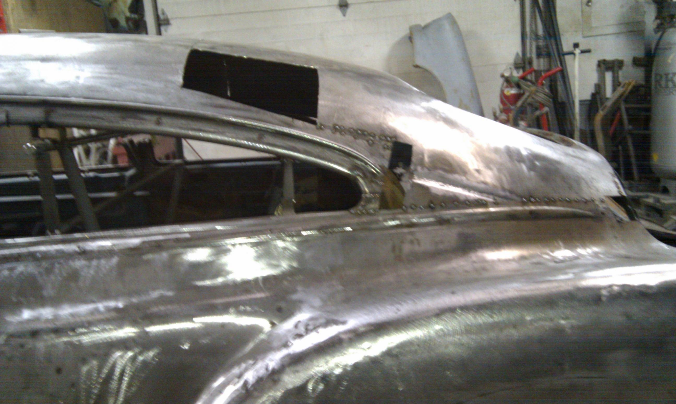

  16. That is amazing Fitzee! The profile of your car looks fantastic.
    I do have a novice question if you don't mind; after looking at the chop you performed and the chops by aw1950 and koolkemp, how do you know where to cut the top in order to get it to go back together? The A and B pillars seem to be pretty straight forward but the C pillars, especially on your car seem very complex. I've been following all three of these builds and am just amazed at the craftsmanship. Very well done.

    We it is not my first chop and I have a good eye now for how metel moves as you cut it up. also I did alot of research first. I found a chop by B*** here on the hamb and much of what i did is much the same as his.. I just took more out!lol
