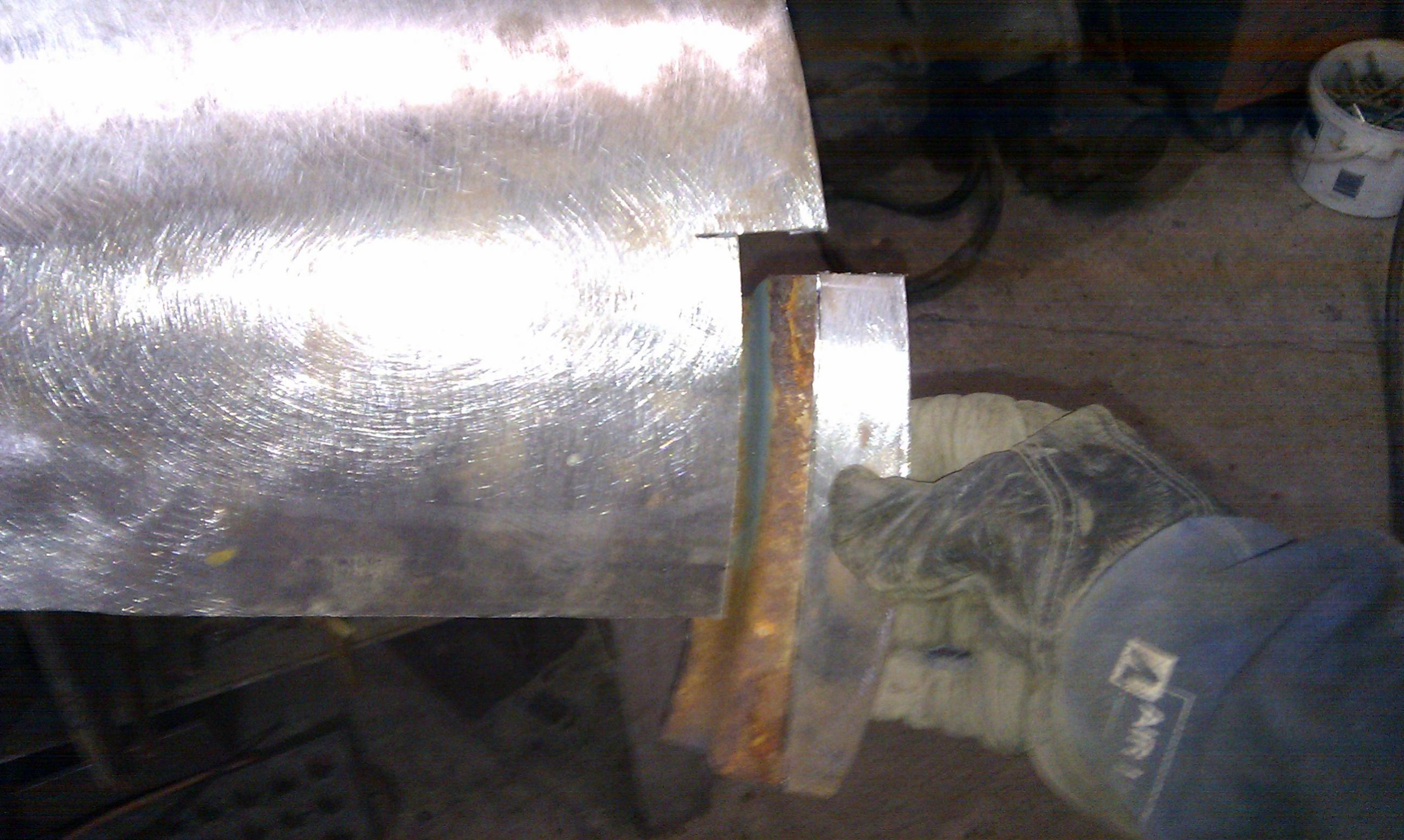

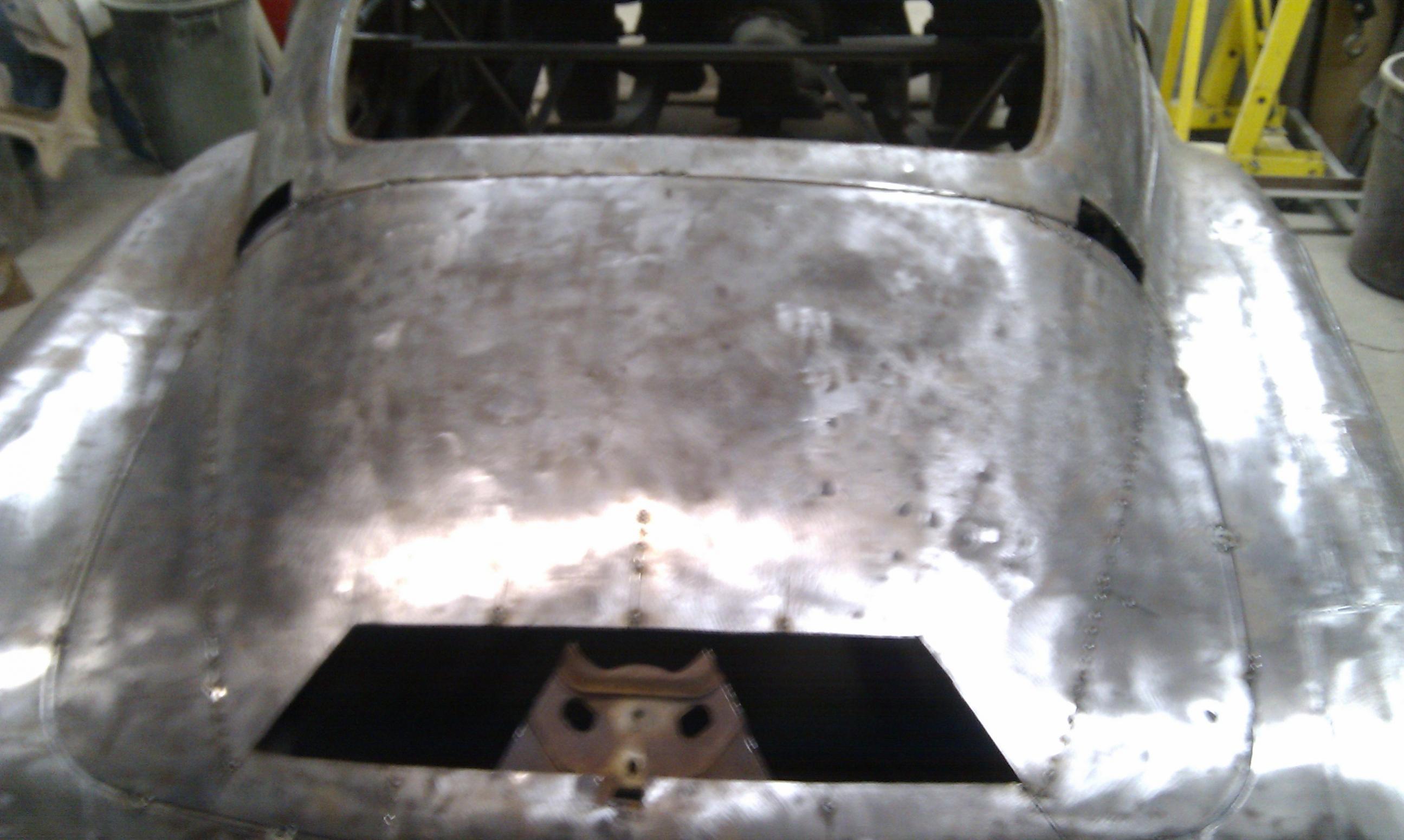

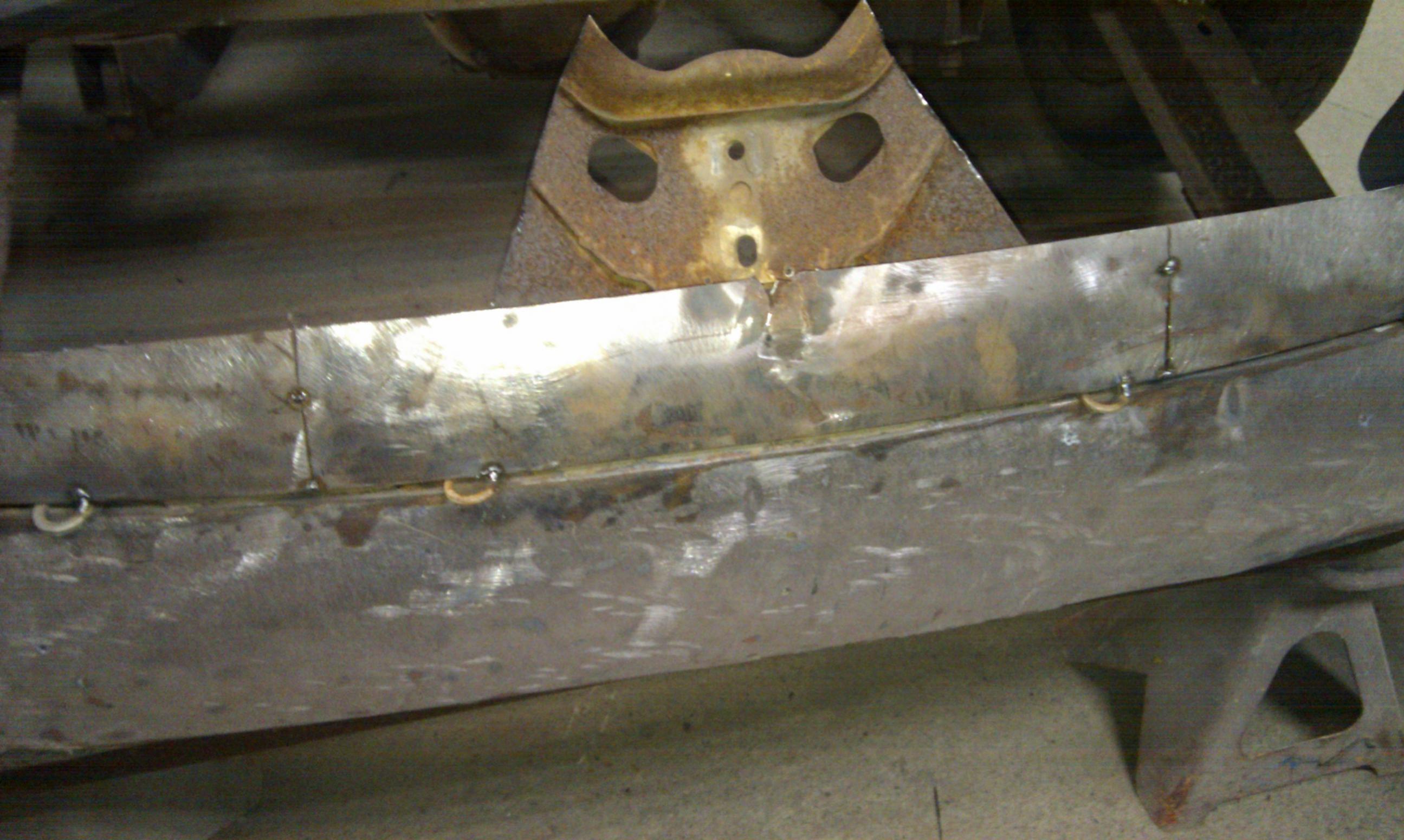

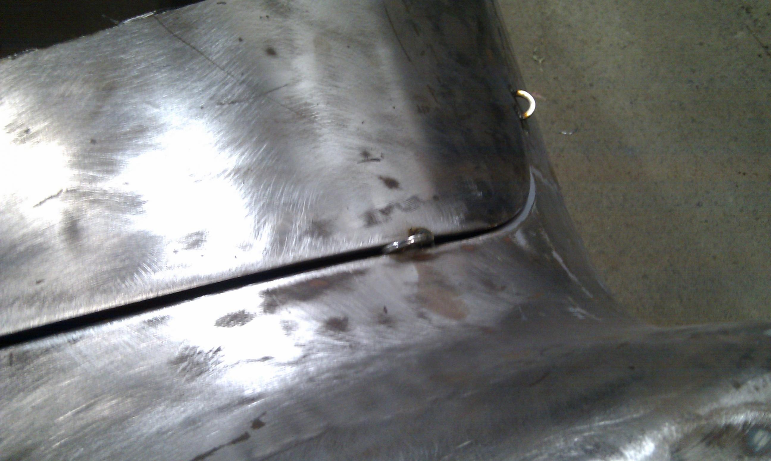

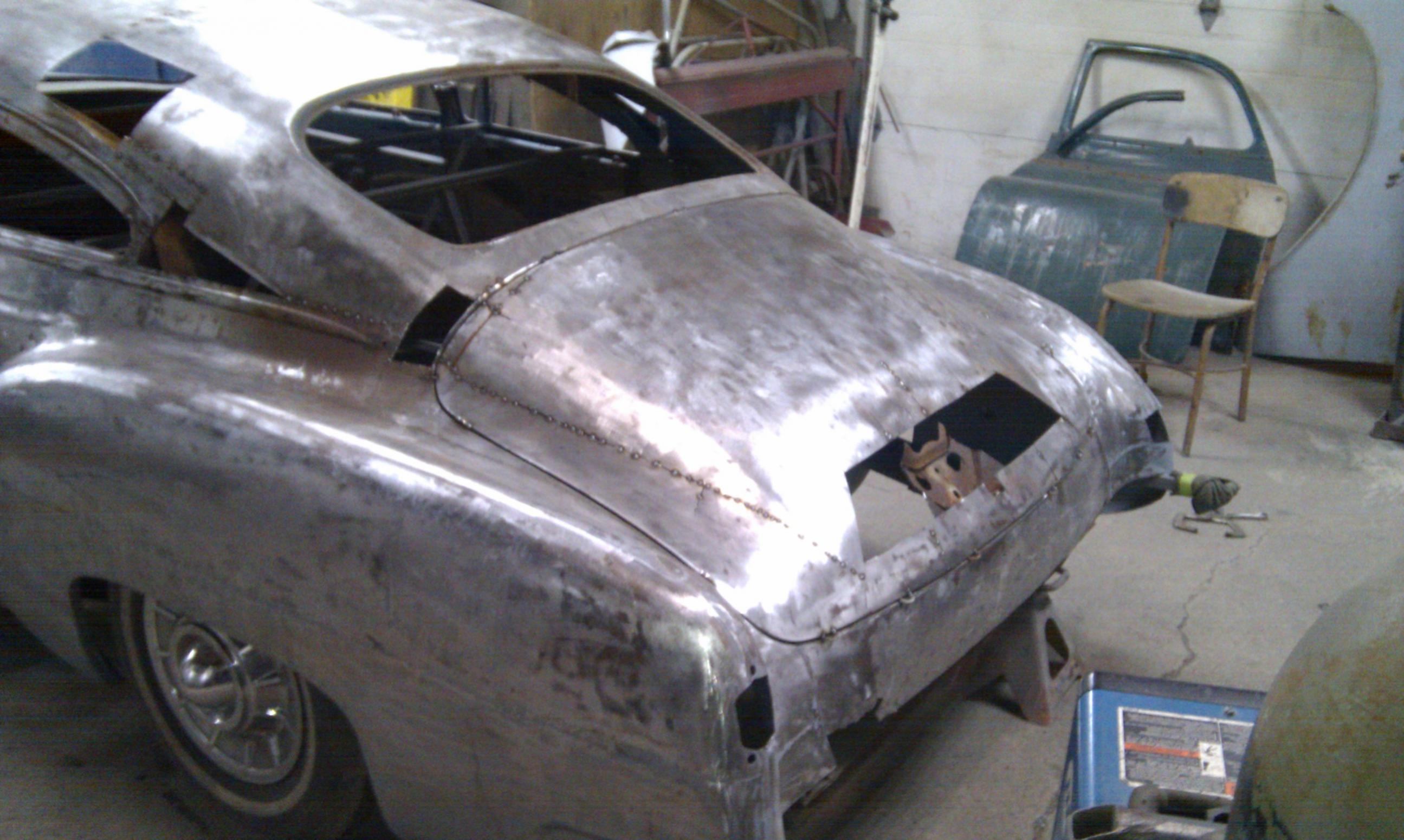

    Well been over a week sence I touched it and I was in the need for a flatliner fix!!Show up at shop this morning with some problems on my mind for the last week.. The back of the car I noticed was not sitting on the rear of the frame right.. so this ment cutting all my bracing on the rear of the body clear and fixing this problem before I moved on..Had to let go most of the welds on the roof on driver side as well!! Well I know one thing..these car are not square!! far from it!! The hinges are out a half inch if I do a cross check with the back window!! anyway after about 3 hours of this I welding the bracing back up and tack weld up the roof agian and also did the p*** side of the roof. Figure I better install the trunk lid before I go very much farther to make sure everthing is ok there. did a quick test fit and cut the corners of the top section of the lid so to let it flow with the car. The trunk seams on this car were always tight and I hated that so I ended up cutting the lower section of the trunk lid in 3 section and using some old lug nut washers for spacers.. I welded this part to the car!!
  17. fitzee
    Joined: Feb 26, 2003
    Posts: 2,862
    fitzee

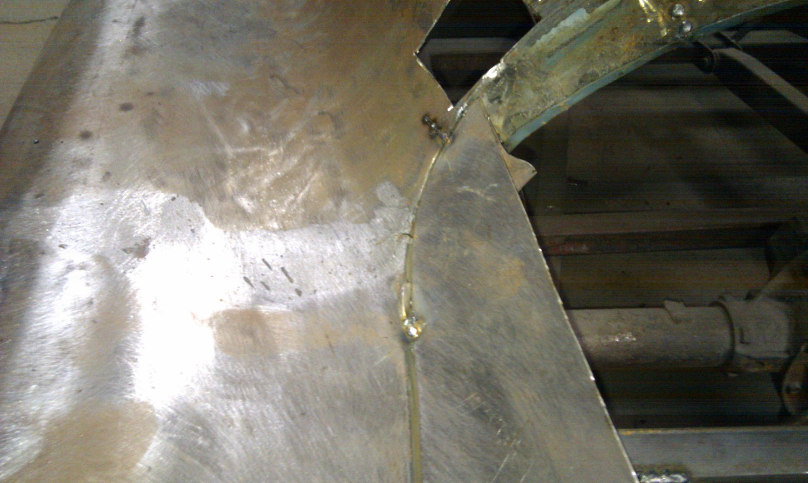

    Well now to the fun part!! tring to get the lid to sit lower and flow with the roof..not easy.. I ended up cutting the rear of the lid out..it was damaged here so didnt matter but this held the lid up and the crown here would not let it fall.. well with some figuring I got it to where I was happy and then I started t******* it and welding everthing up. I thought the two corners by the roof would give me trouble..Not at all! Trimed the two peices I had cut out and reinstalled them..Stll need to be fine tuned but I an happy how it turned out. Sorry some of the pictures are blury!! seems i had dirt on the lence on the phone!! lol

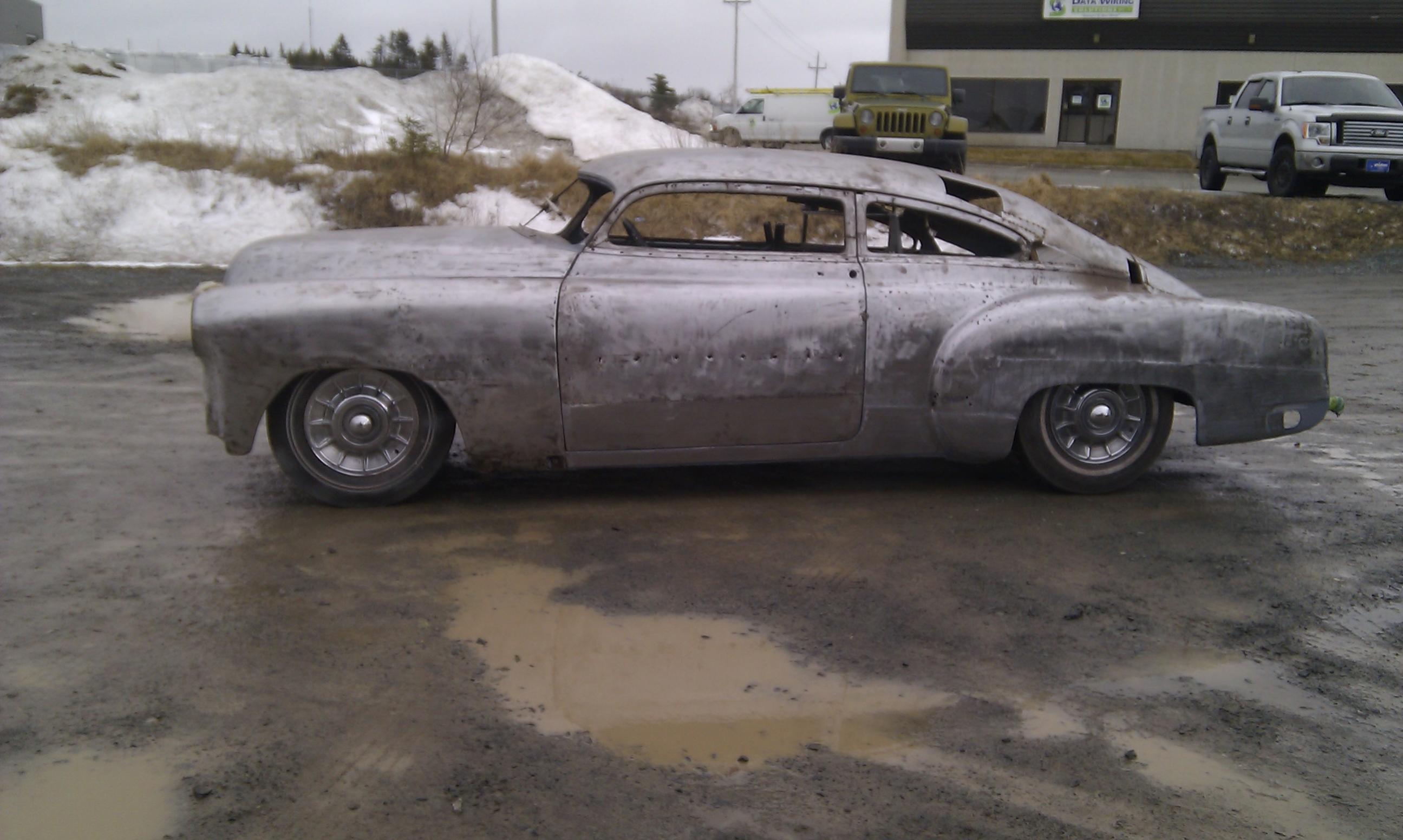

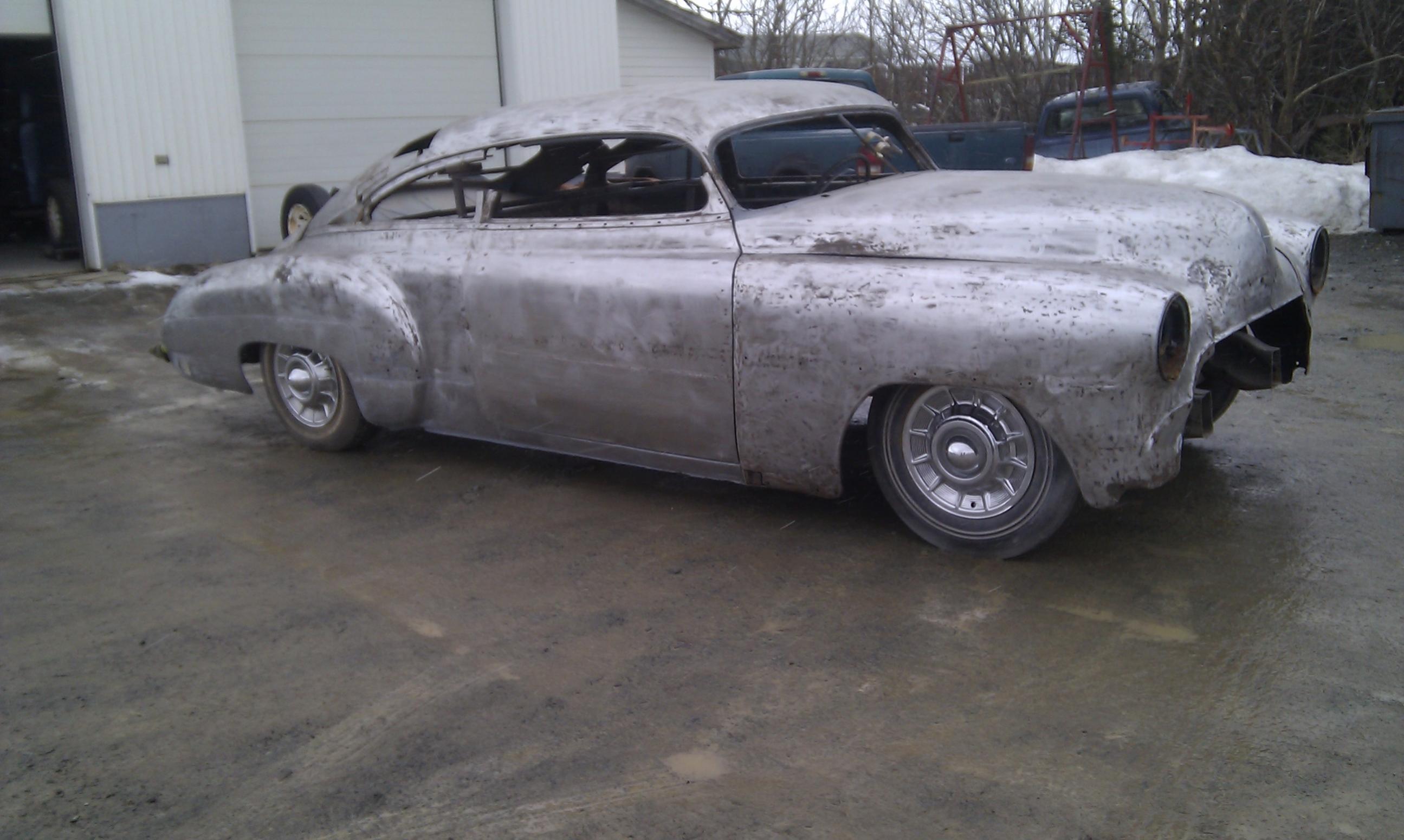

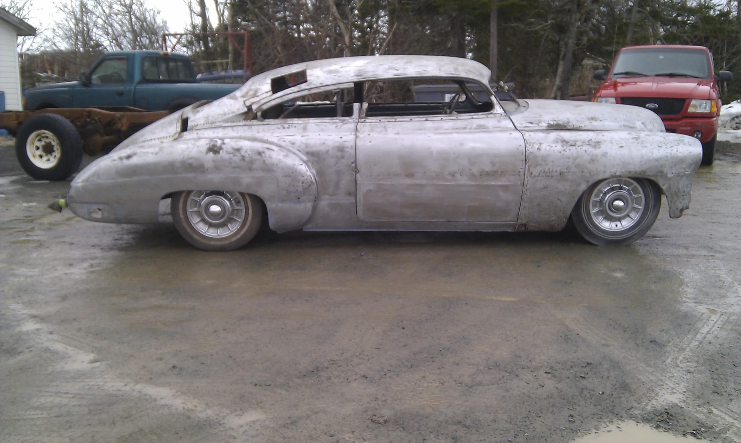

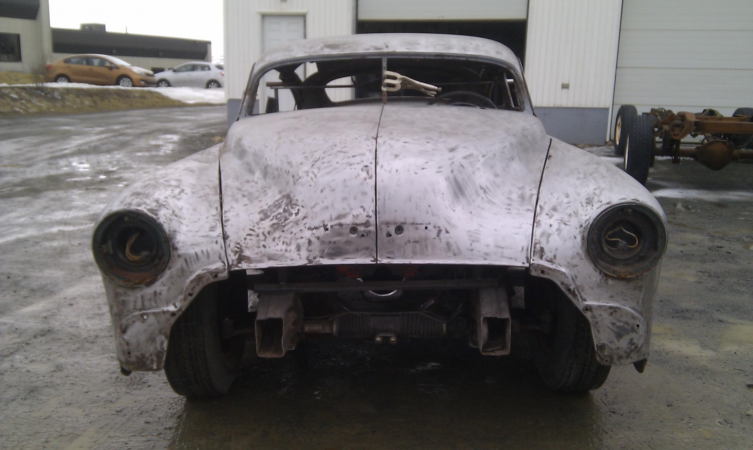

    Ok final got a chance to roll flatliner out by the door today for a walk about.. Oh I can see that right quarter is got to go..Dont know what I was thinking!!I see a few things I need to work on but over all Im very happy with how it looks..
  29. koolkemp
    Joined: May 7, 2004
    Posts: 6,006
    koolkemp
    It looks even better outside, you really nailed the profile ! ,its so easy to mess up a chop on a fastback but I think you have shown us how to do it right! Now get the damn p*** side welded up :D , and yes that includes the rear quarter re-do :rolleyes: How much more metalwork ya figure you have left to do on the chop?

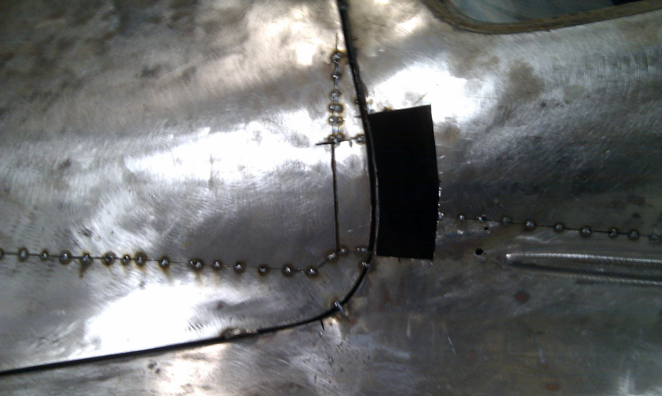

    Thanks Steve.. I just need to make sure the door top and post are going to be good then it start welding everthing solid. you can see the holes that need to be filled. There is still a number of hours here yet..
