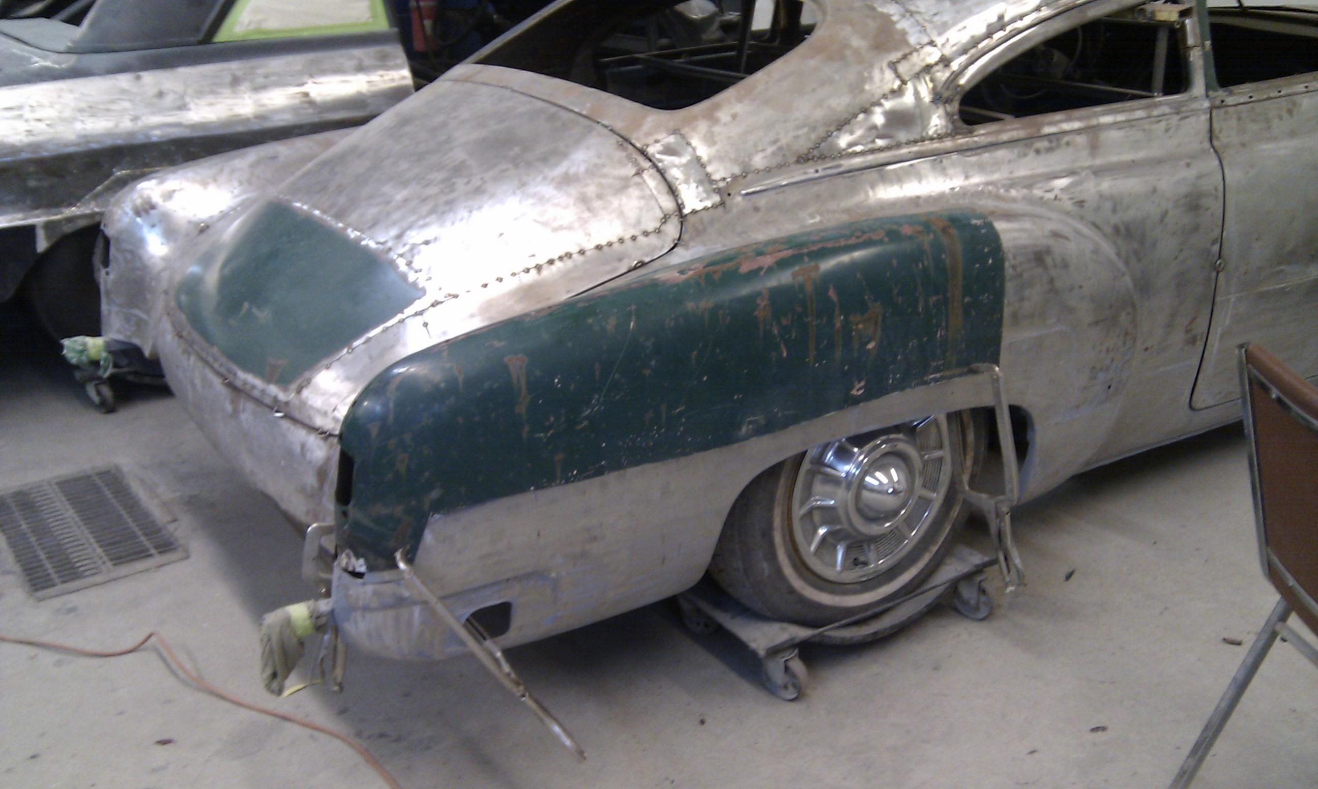

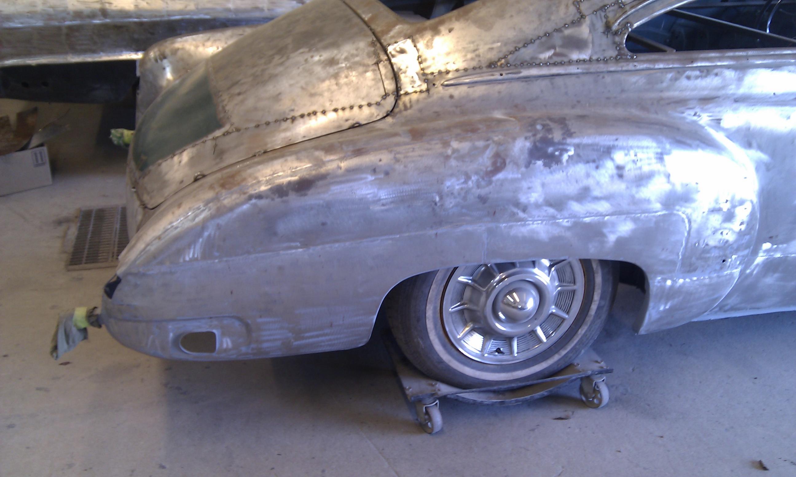

    Looks right on Fitzee . I am still partial to the right side . It all flows in the same direction . Your car , your choice . Either way its gonna look excellant . Think I will spend some time on the Buick today !!! Later, Andy..

    I'm with Andy on that right qtr. It's kustom, is it not? It adds to the sleek profile IMHO. Help me understand why y'all seem to definitely not like it? You're probably right, but I just don't understand what's so bad about it.

    Thanks guys. when I look at some I dont like its because I see something funny!! What I see on the right side is a dog running with its tail between it legs!! lol.also been told it looks like a corvette quarter!! But to top it off I find the left side definds the roof line much better.. The roof has somewhere to end in the profile.The right side the roof just keeps going.

    I second that Fitzee, it seems to never stop. Sometimes things are good in theory but until you do it and see it on the ride, you just never know. The car is looking great though, You do great work, I bet you're seeing light at the end of the tunnel. Try not to get the "finish it" fever, enjoy it as you go. Keep it up.

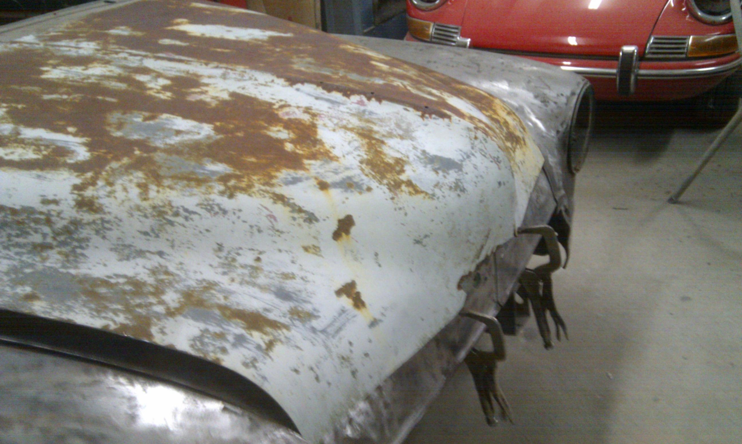

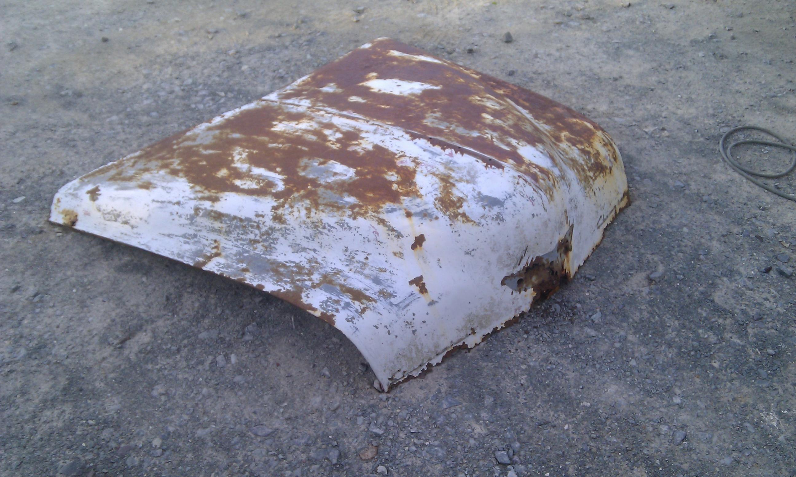

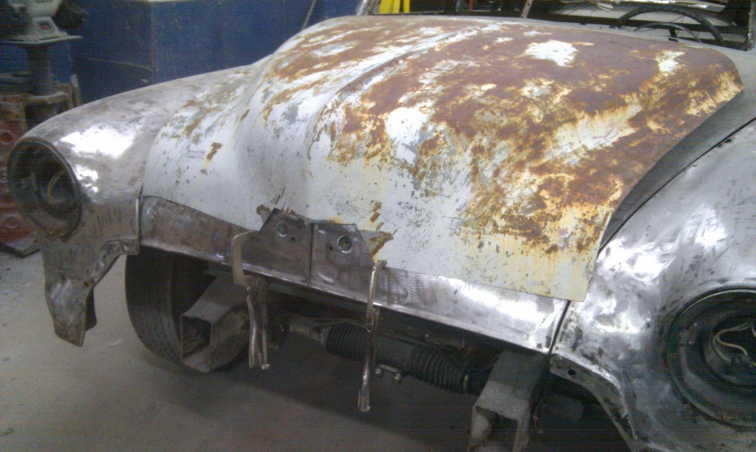

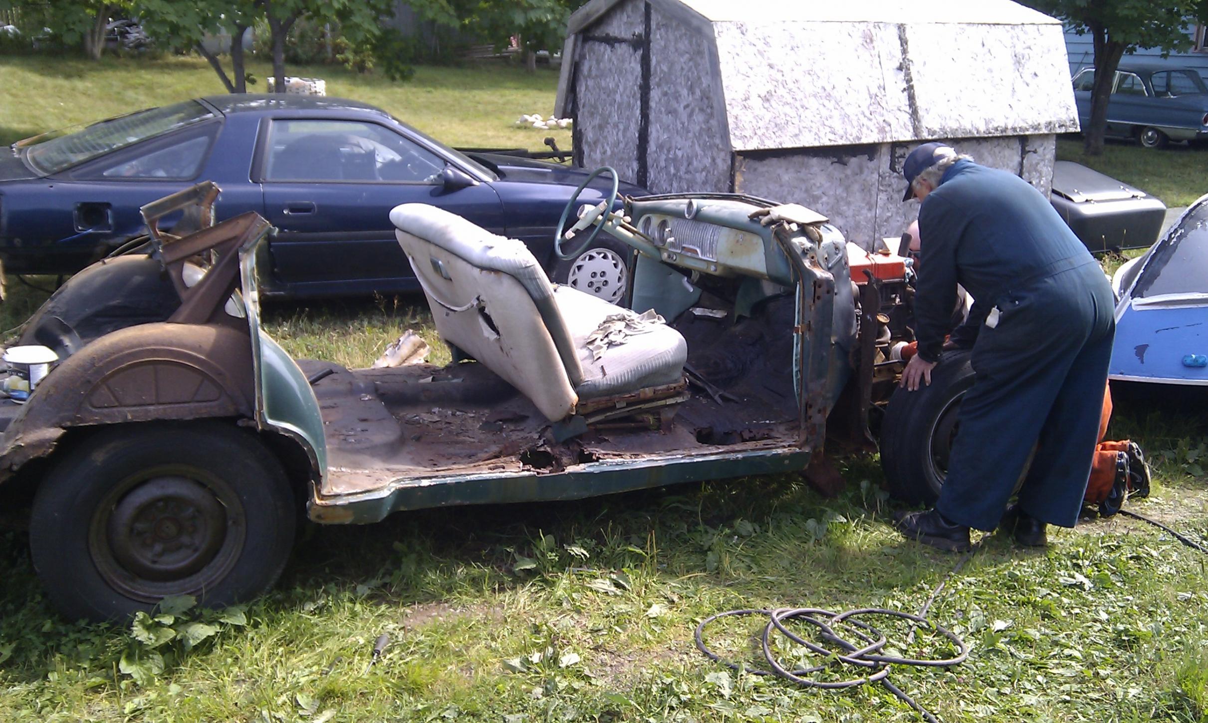

    Might be wonder what has happen to the old girl..well been busy at my shop completing two cars.and Saturday I sent the last of the two out the door. So today I gutted the garage and blew the dust of the old girl and moved her out on the floor agian.. a month back we found a 49 Studebake in the woods in which I took the hood..Now Im running 56 Olds Fenders and find that the hood looks too far back with the fenders so I want to add another hood section from something to bring the peak up and forward to match the fenders.. I think this might just work and with the peak in the hood it will match the peak in the fenders. also got time to s**** the parts car have the quarters and roof at the shop so I can use them on flatliner.. with any luck I might get a nite or two this week at it..

    huh, I think thats gonna look good I can kinda see what you talking about. I would have never thought to do that, cant wait to see the end result.

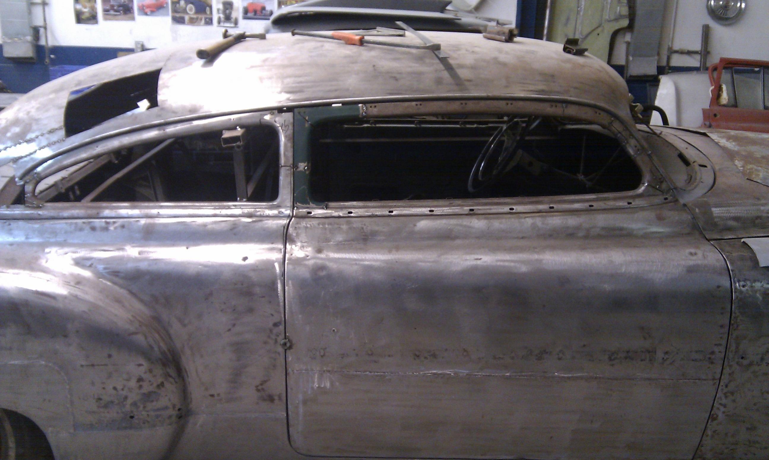

    Final getting back at the old car..first time in a while now..plan is to stick no less then a hour a night at it. got all the p*** side door tops all fitted..need some ajustments and had to use some parts off the 4 door car for the back section.. going to fill in the holes in the roof tomorrow night.. Feels good to be at the car..

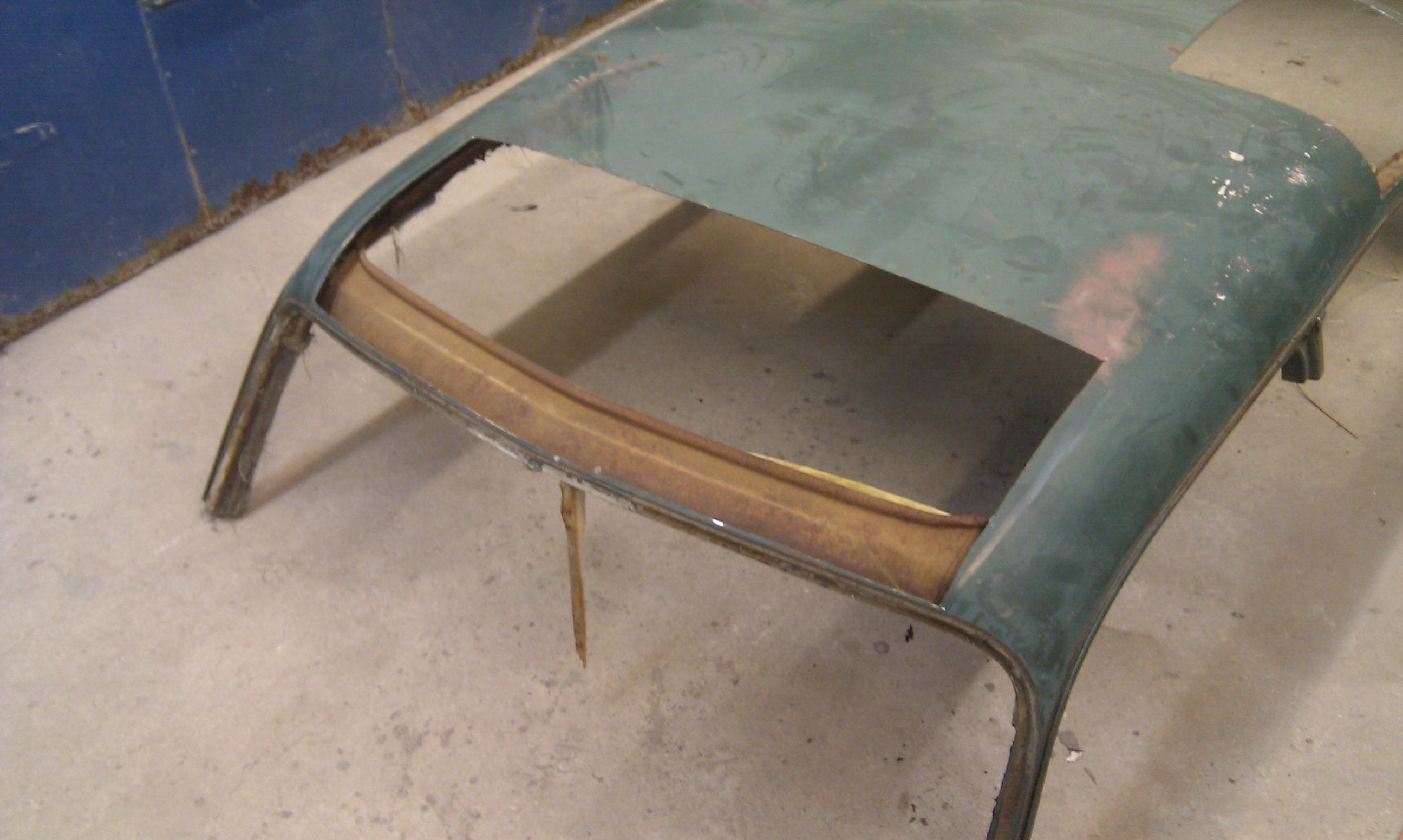

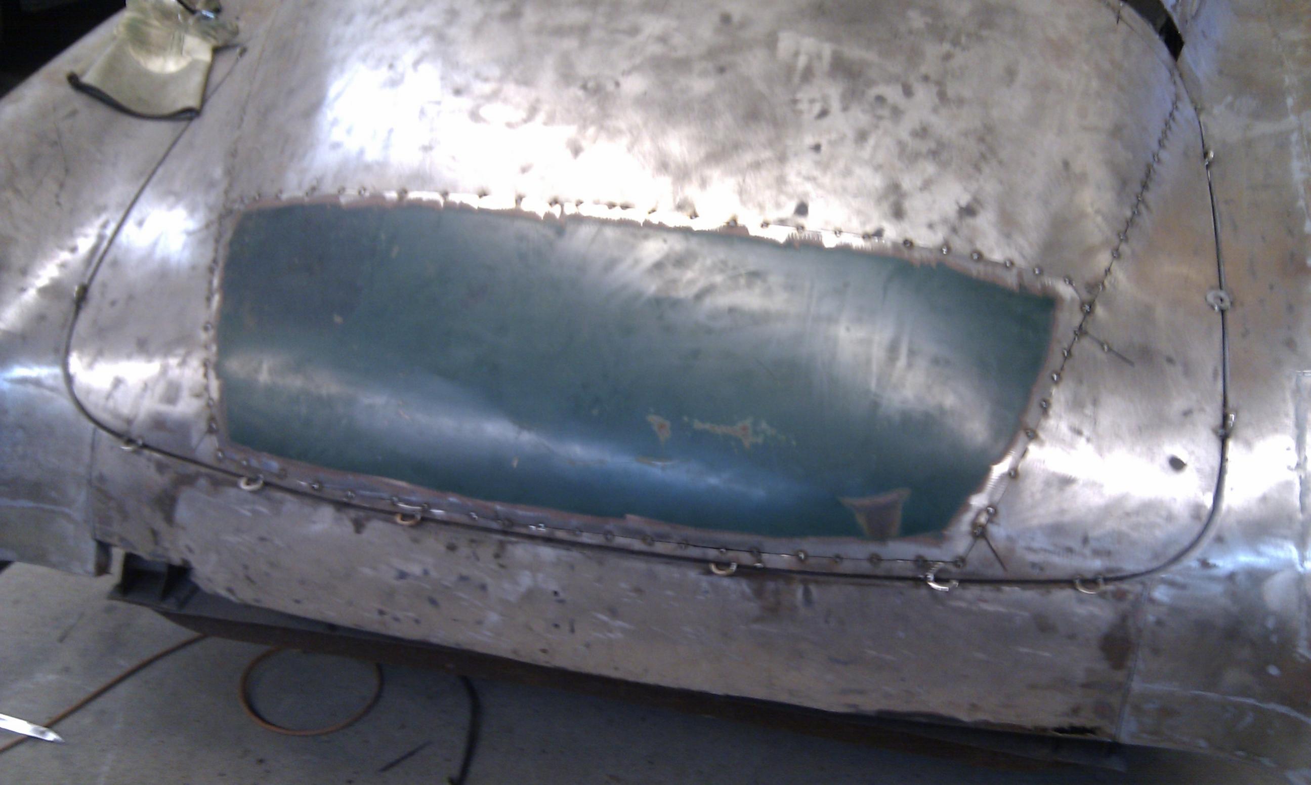

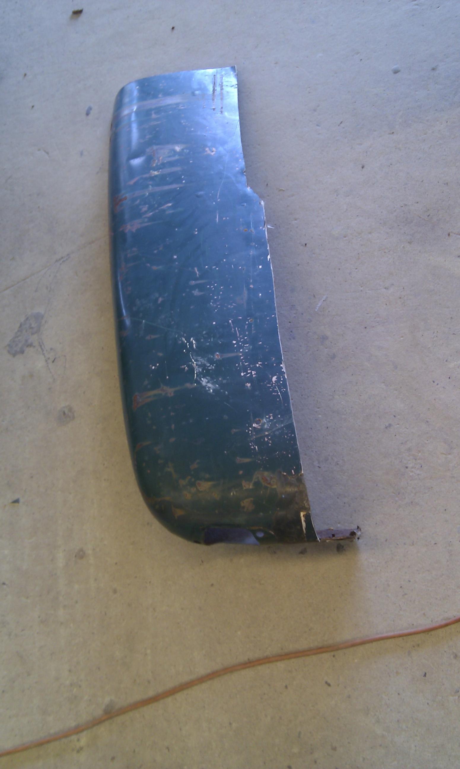

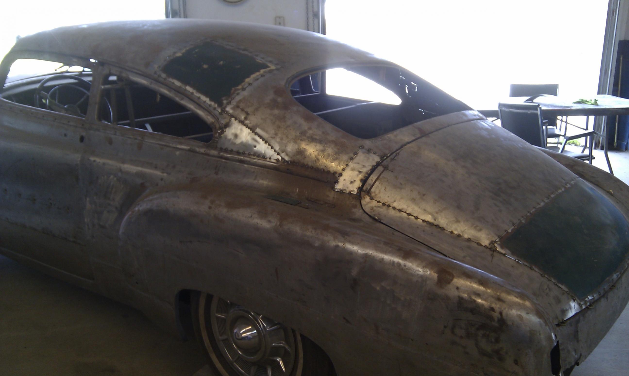

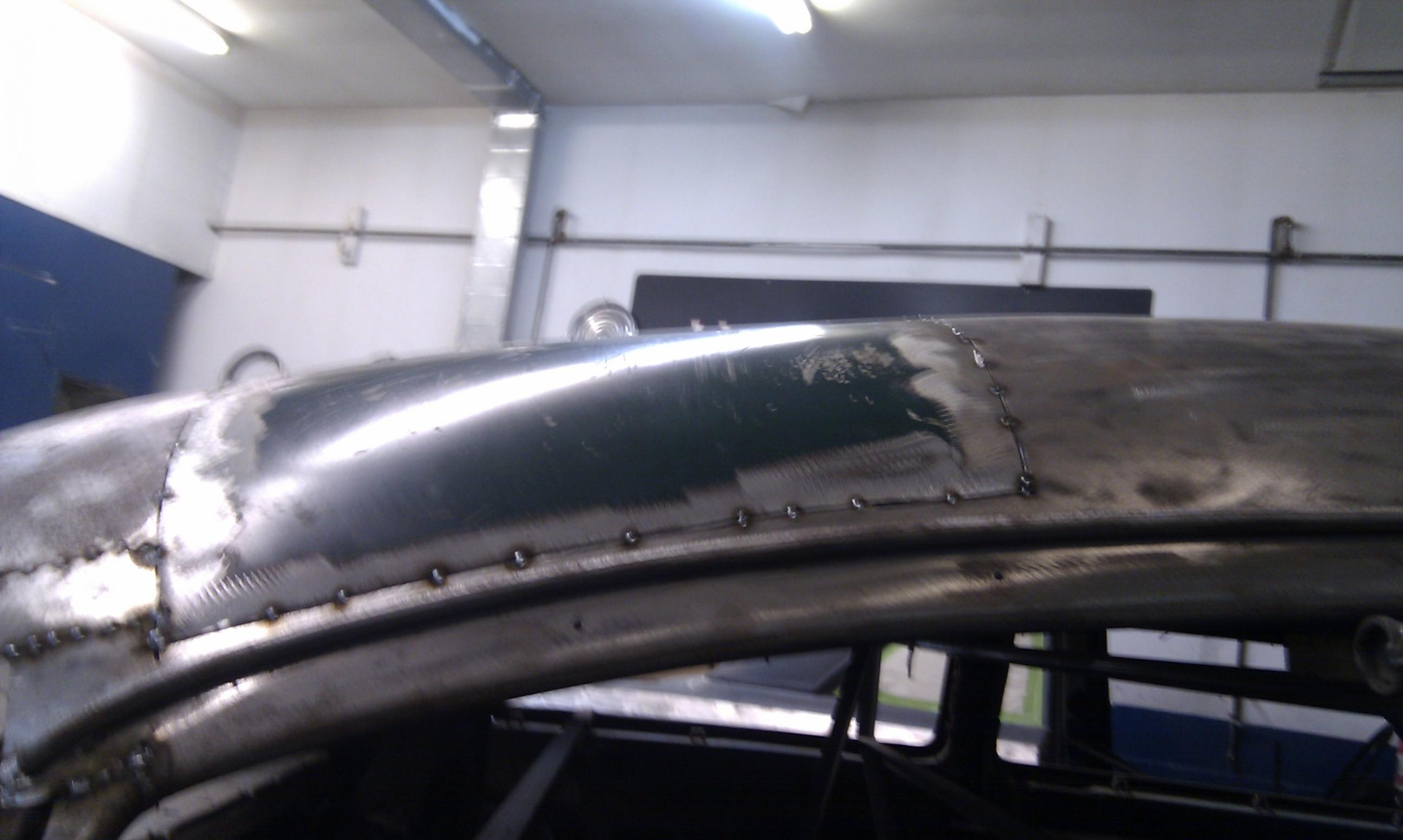

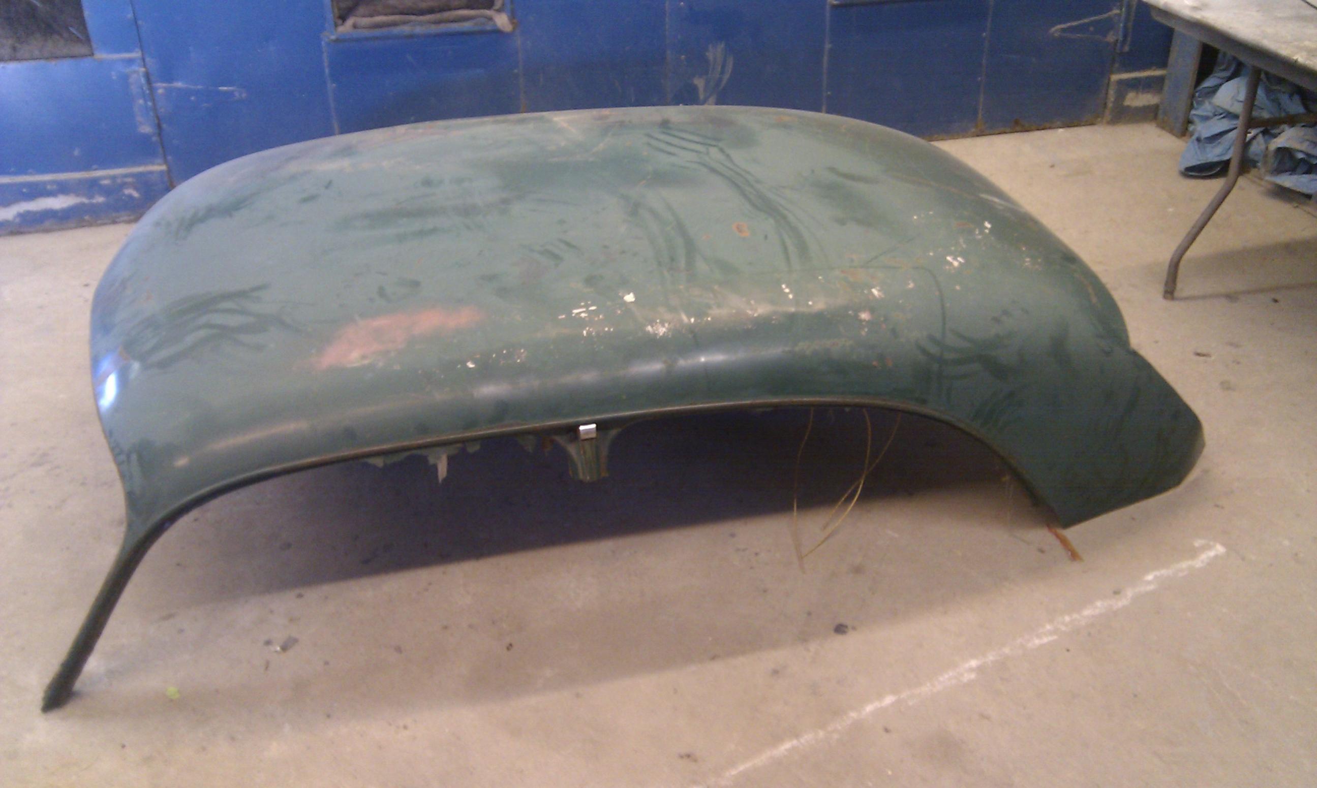

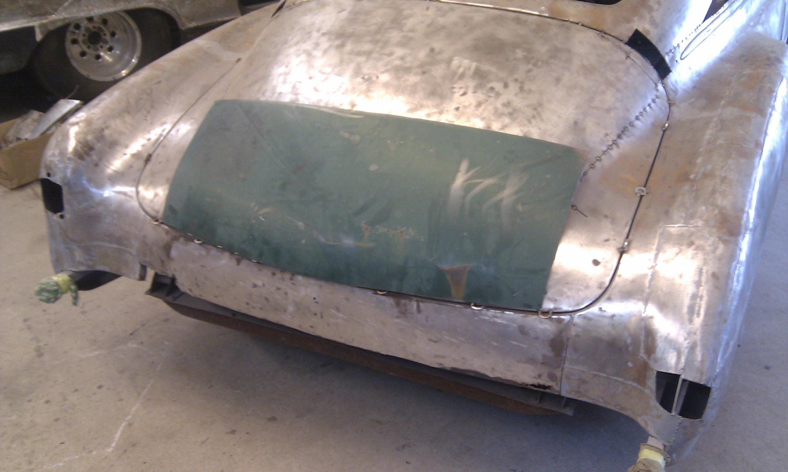

    night two back at the old girl. I figure I work on the section of the roof and trunk that I had chopped out.. now you can sit down and try to make new peices and not be happy with how they turned out or you can hunt for shape that will..well my parts car had what I needed.I cut the roof off the 4 door and would use this for the peices I needed. Now ever now and agian when I do this you come across that perfect peice that works so good it make your head spin! well sizing up the trunk lids and looking at the front section of the roof I figure I cut it out to see how it would fit..well it fit so good that I had it **** welded it in no time. never had to work the panel or it never popped up as I welded around it..just trim and fit it to the car.the fit was unreal.. the flow over the trunk was perfect.

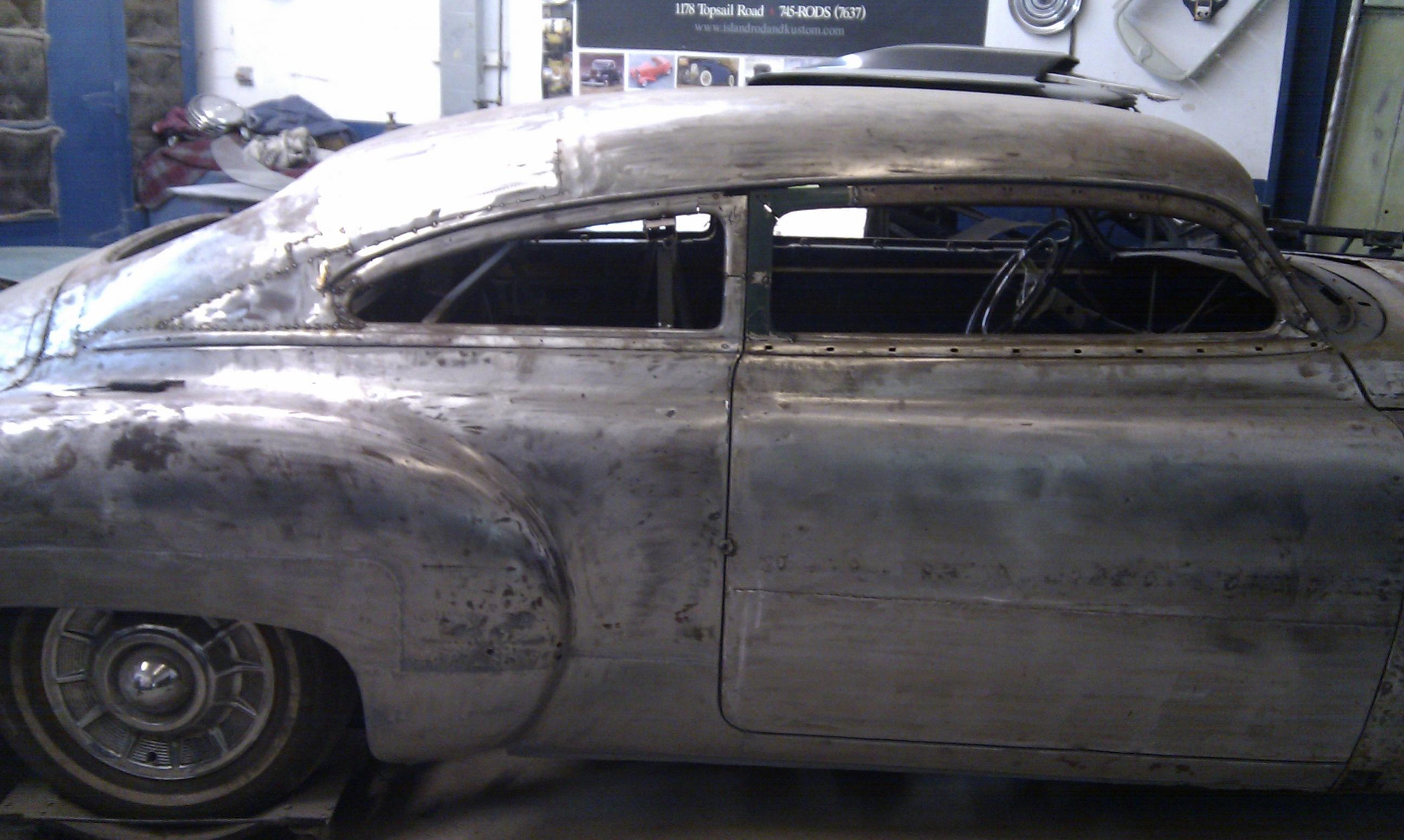

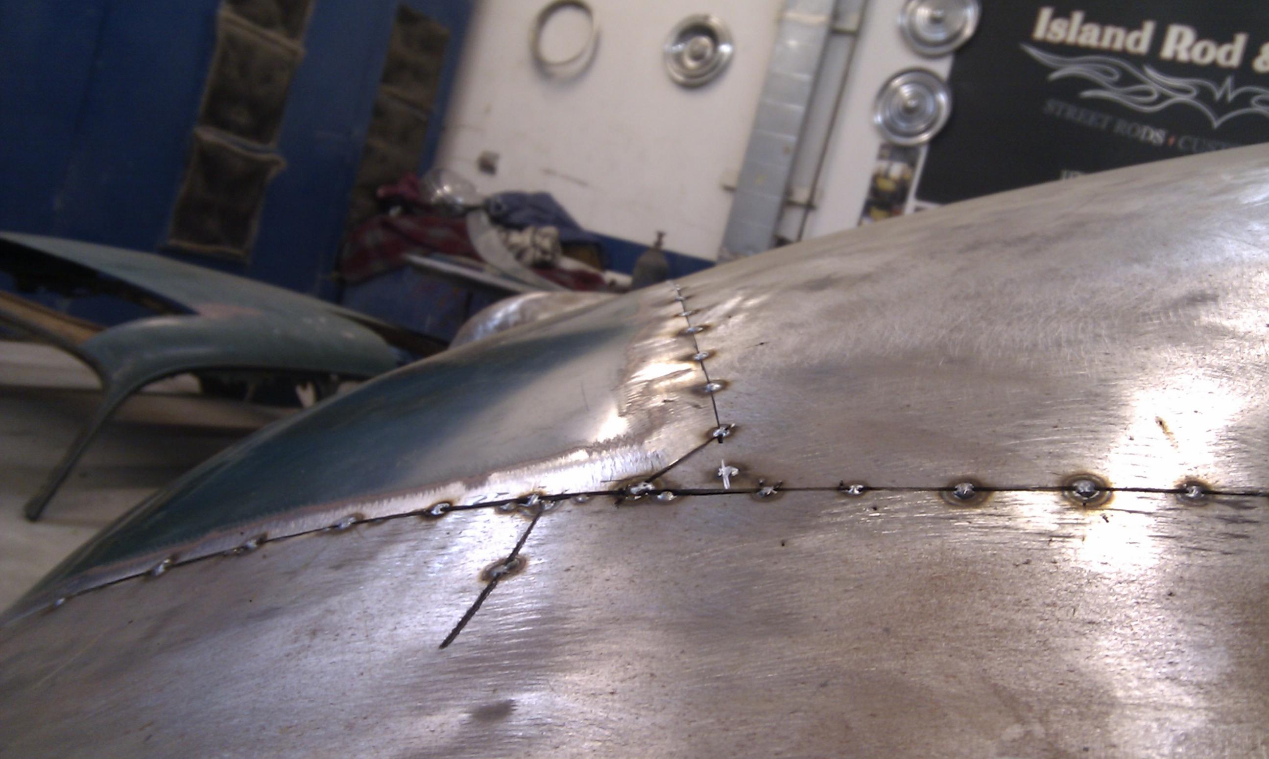

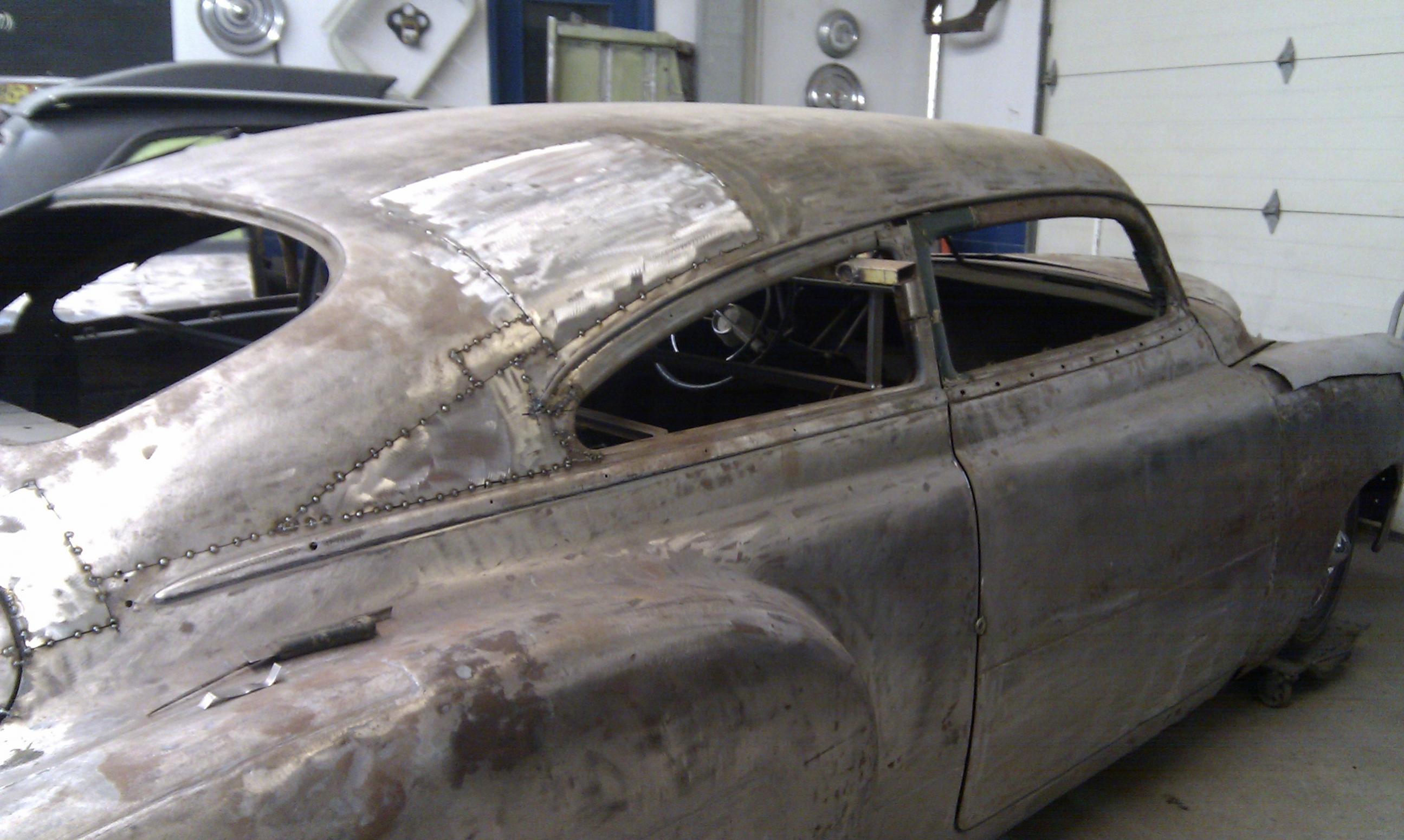

    next I cut two large section out so as to have lots to chose from as I moved the panel around on the roof for best fit..had some trouble with the fit..not as nice as the truck but it worked out just fine.. with other sections of the old roof I then peiced in the other two spots on the p*** side of the roof.. tonight Ill do the other side.. Ill have it all peiced togeather then and Ill go around and fine tune what I dont like then weld it all up.

    Wow thats unbelievable how well that roof chunk fit the trunk lid! Great to see you back at it Fitzee! Moncton next year??? :rolleyes: I would love to take mine but the more I look at it the more I see to do ,gonna give it a try anyways!!

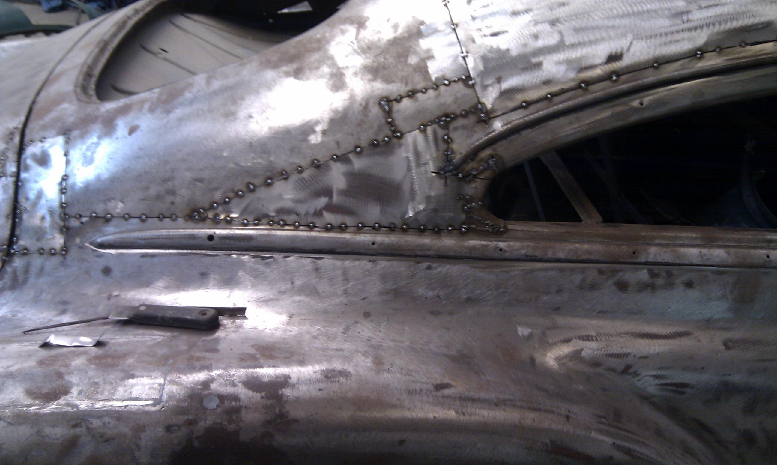

    Clued up the drivers side of the patches so that everthing is in place and now Ill fine tune everthing and weld it up solid as I go.. That p*** quarter I chopped up a year or so ago has been bugging me.It was a bad move I think so I am using the section from the 4 door car to put it back like it should be..I was expecting it to be total different in and around the truck but no. should fit on with very little work..
