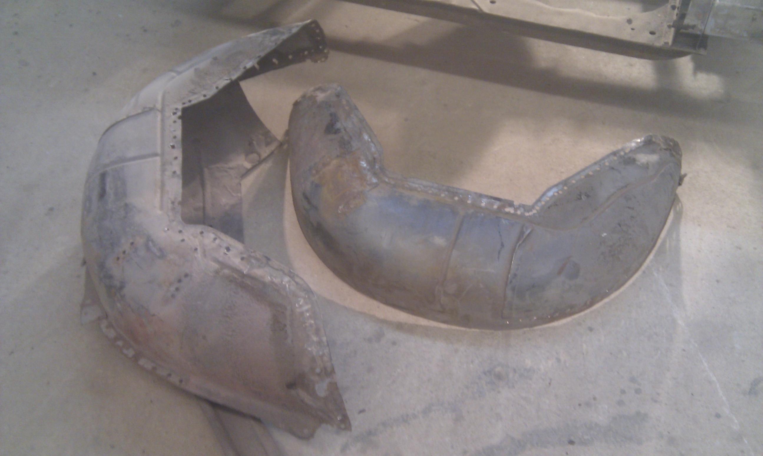

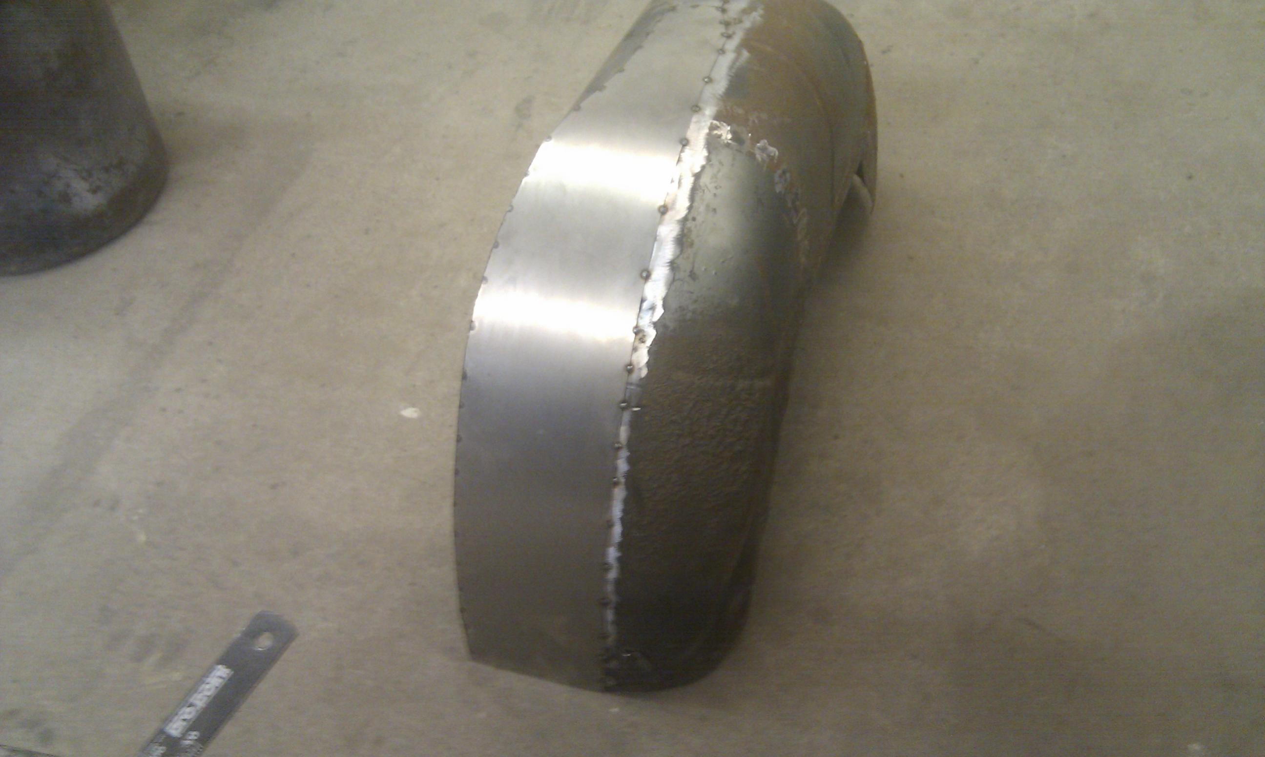

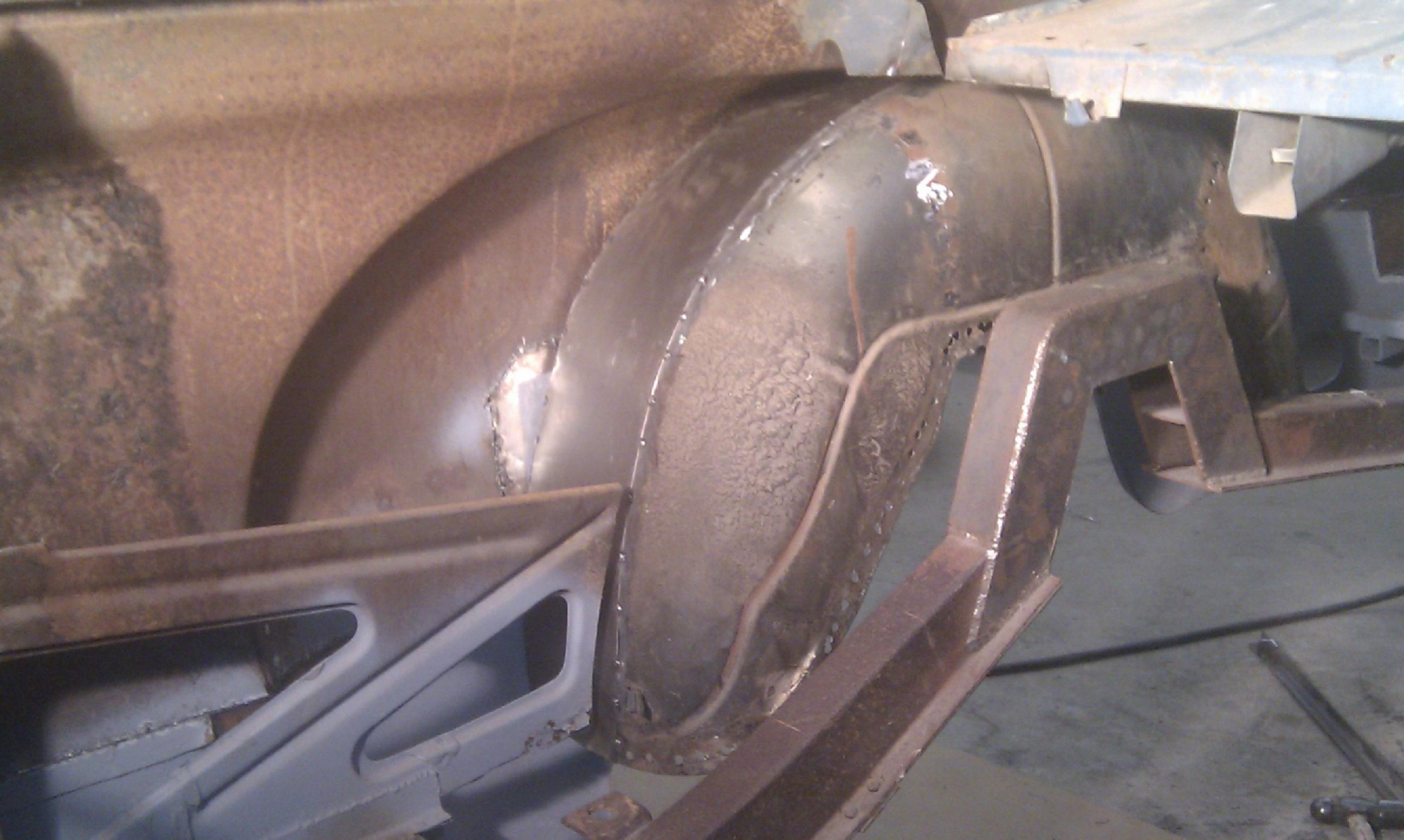

    Final got some time at the old girl.. Got the roof welded up. still some fine tuning on the roof but that can wait..time to get at the floors. Now this car had nothing in the way of floors and wheels wells to save so I had to find or build new wheel wells. Now I was not interested in making a wheel tub in the back..wanted something to look like a stock stile wheel well. I did a 69 Caddy last winter and had to replace alot of the rear of the car so I had a southern rear clip come up for it. Well Never used the wheel wells and I put them away for flatliner.. quick test fit and see what way I will make them..
  4. fitzee
    Joined: Feb 26, 2003
    Posts: 2,862
    fitzee

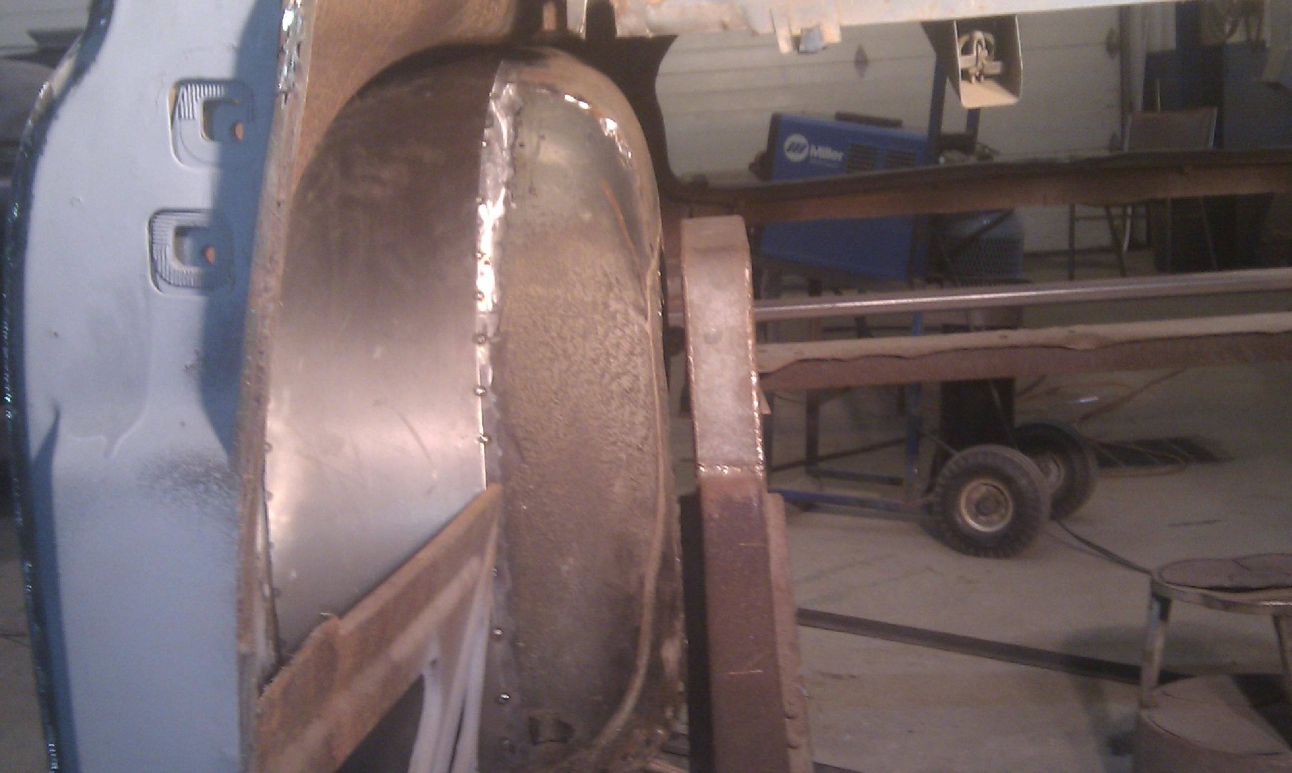

    After triming up the wheel well to where I was happy I then scribed out a outer section on a flat peice of steel.. Then I set it up and trimmed it for the wheel opening and made a lip so I could spot weld it in place on the wheel lip. when this was made and mounted I then mounted the inner wheel well but spaced it out 3/4 of a inch off the rails. I then welded stips from the inner well to the outer to hold it all togeather.. I removed it and then made strip to joine them togeather. tack welded everthing in place and did a final fit. Just need to weld it all up and then it can be installed in the car for good..

    That was a great idea to keep those tubs, nice work Fitz!

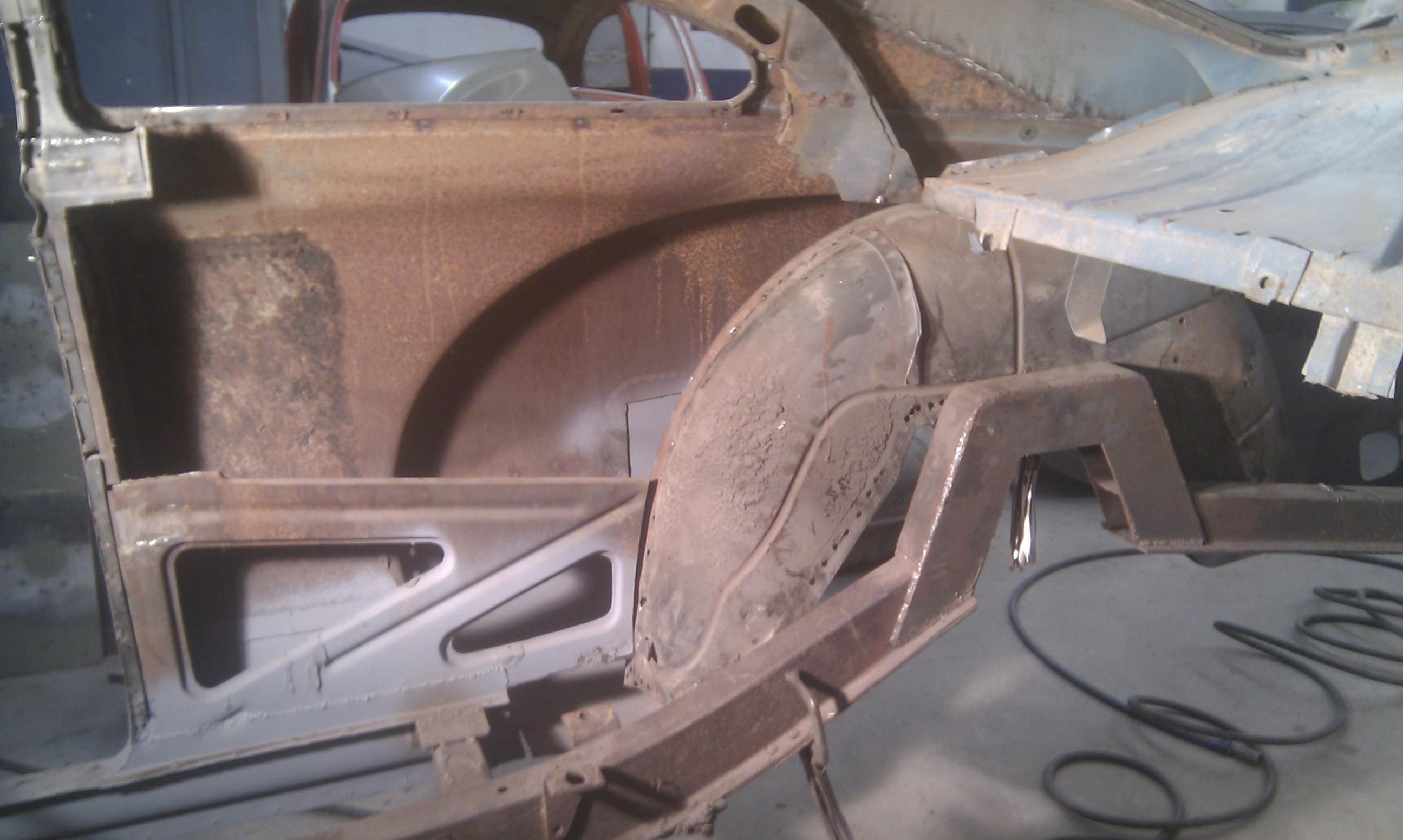

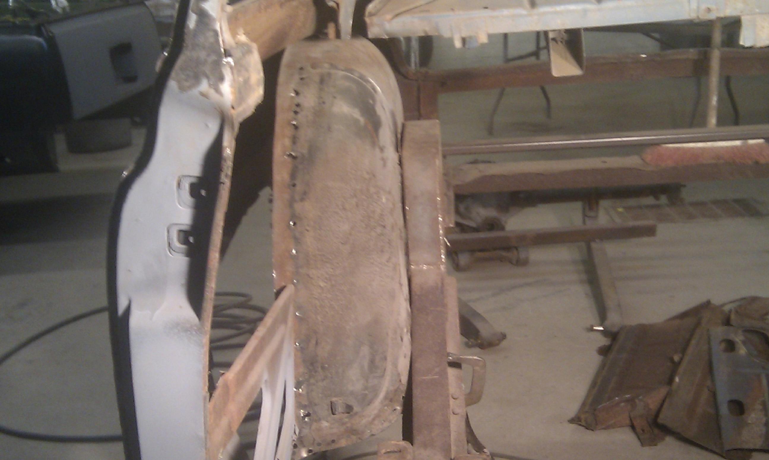

    Well after sizing up the wheel well I realize that when installed I wont be getting at the quarter so any thing Im not happy with now Ill have to address before I install them. Well I decided to redo the quarters and **** weld the over lapped quarters I put on a few years ago!!

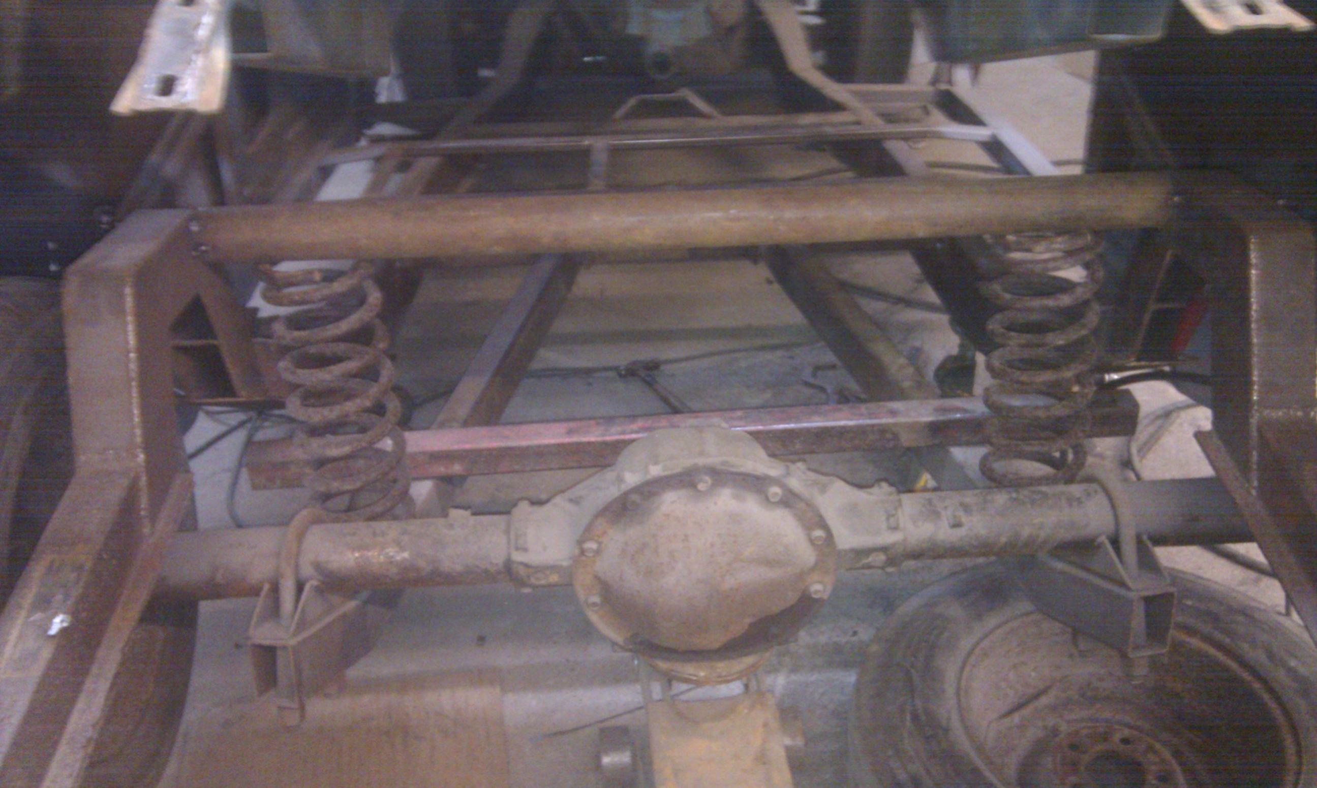

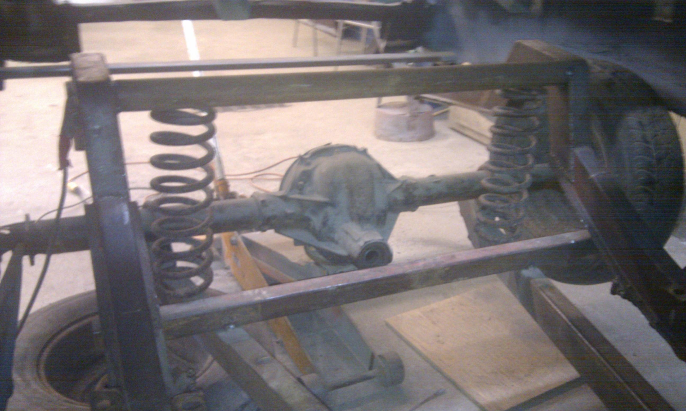

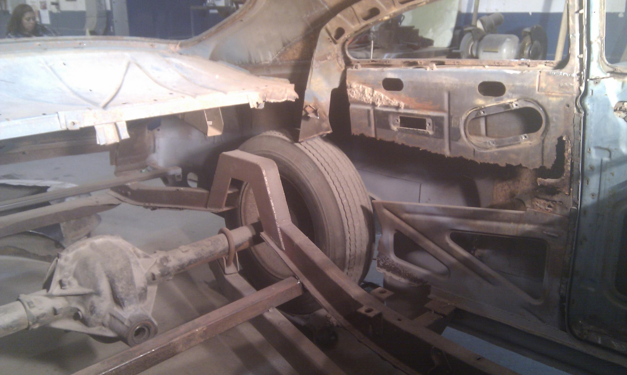

    playing around with the rear spring locations and Im happy with this location.Using a set of springs i had from a 60 Pontiac parts car I s****ped.need to either make or find some spring mounts and set up some shocks and a pan har bar and Ill be ready for floors!!

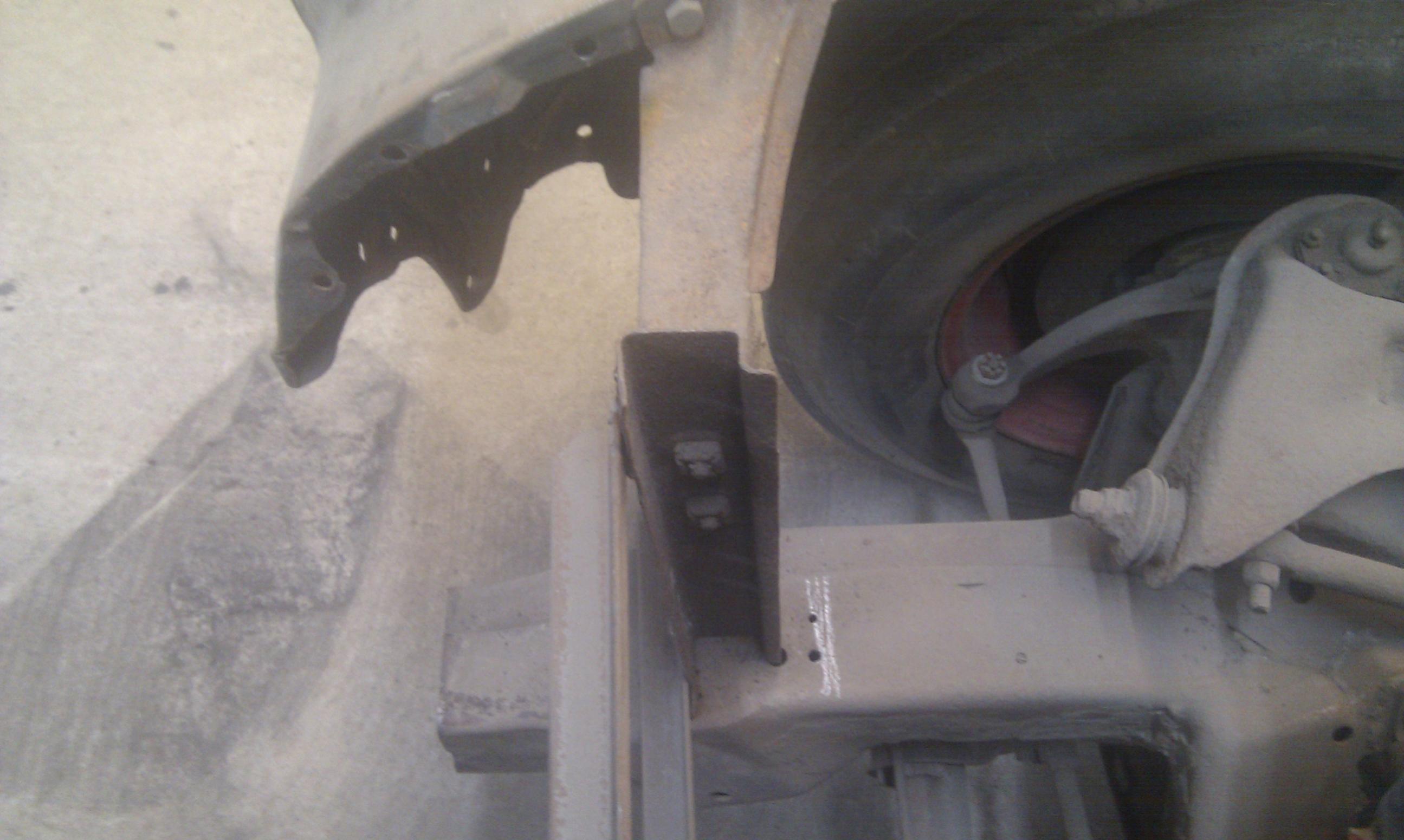

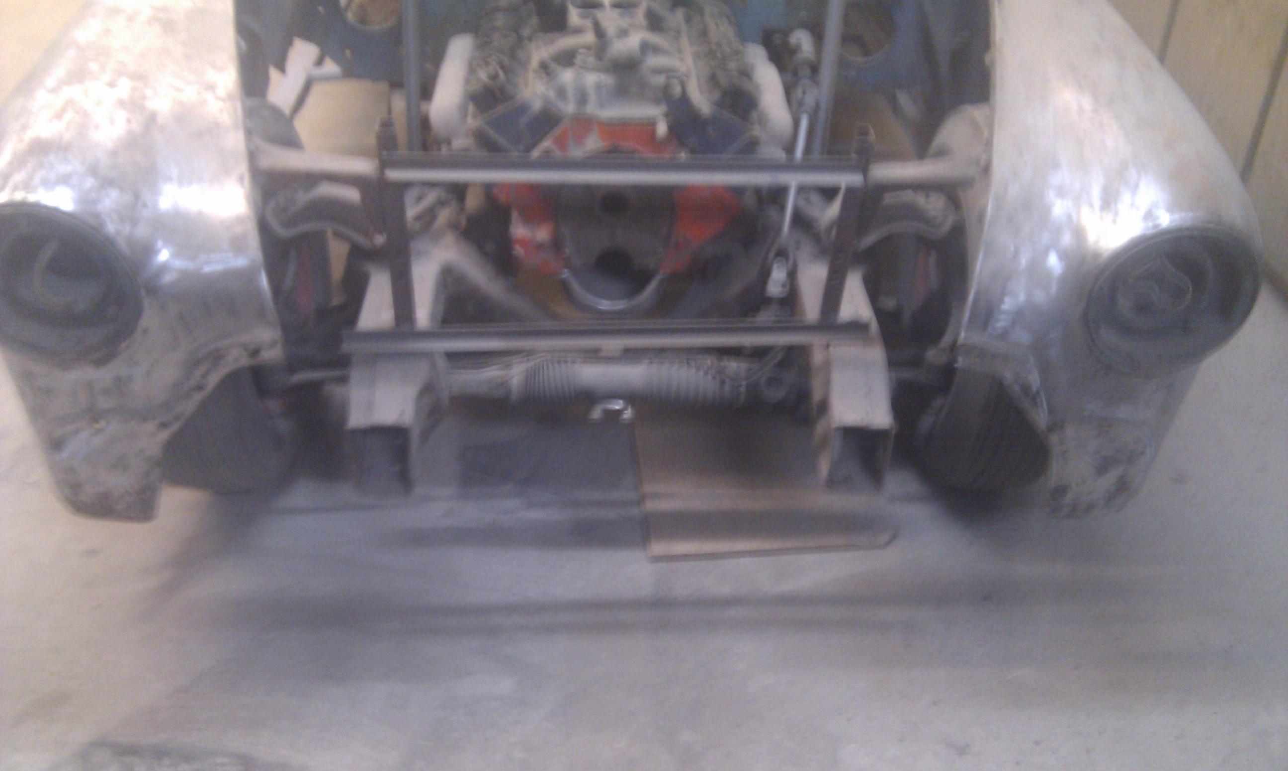

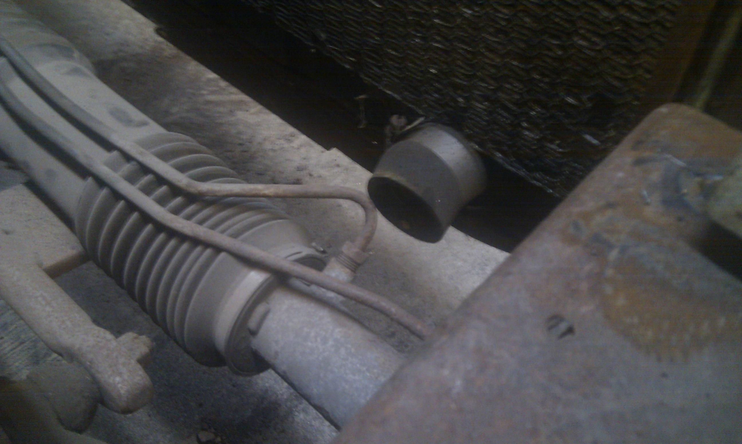

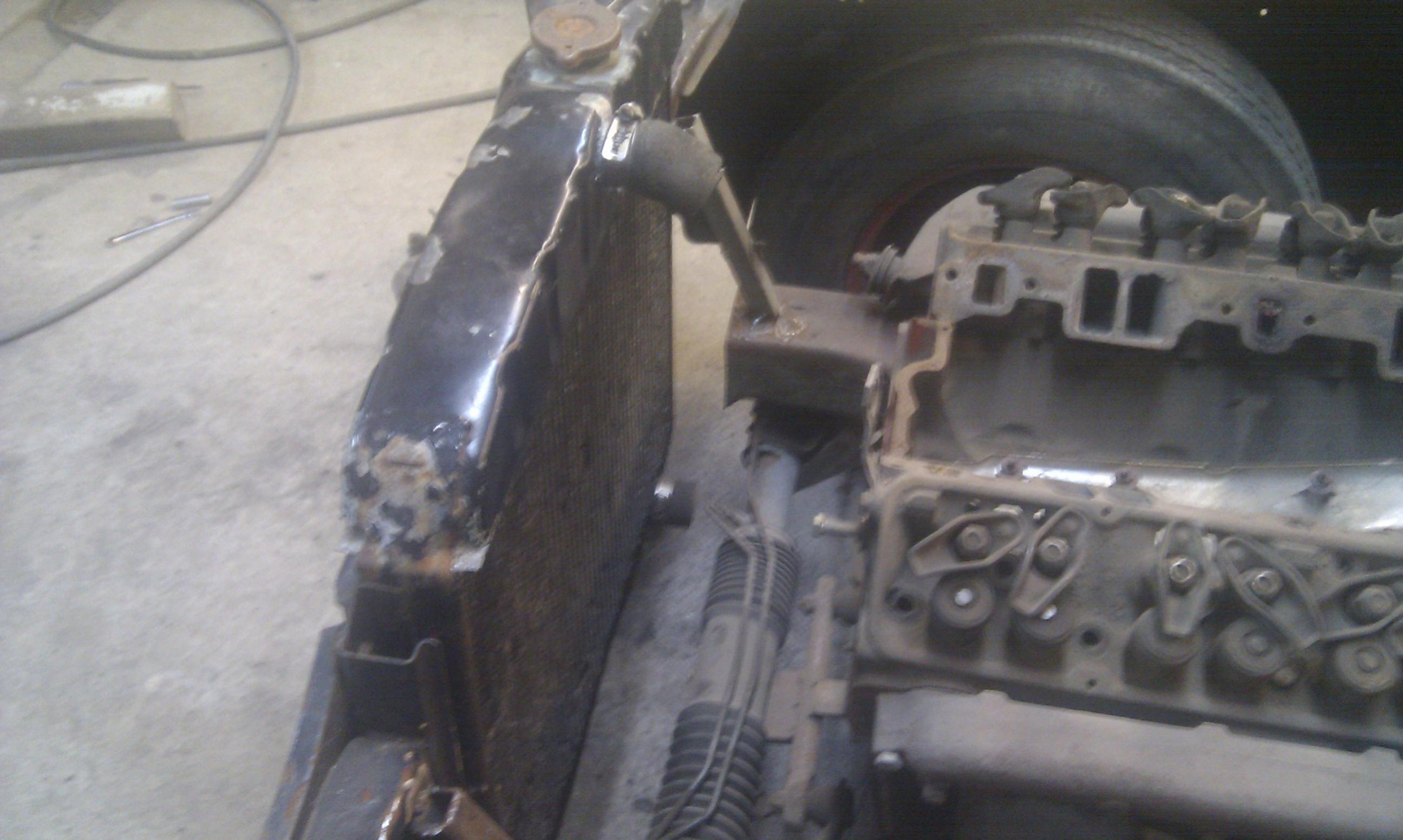

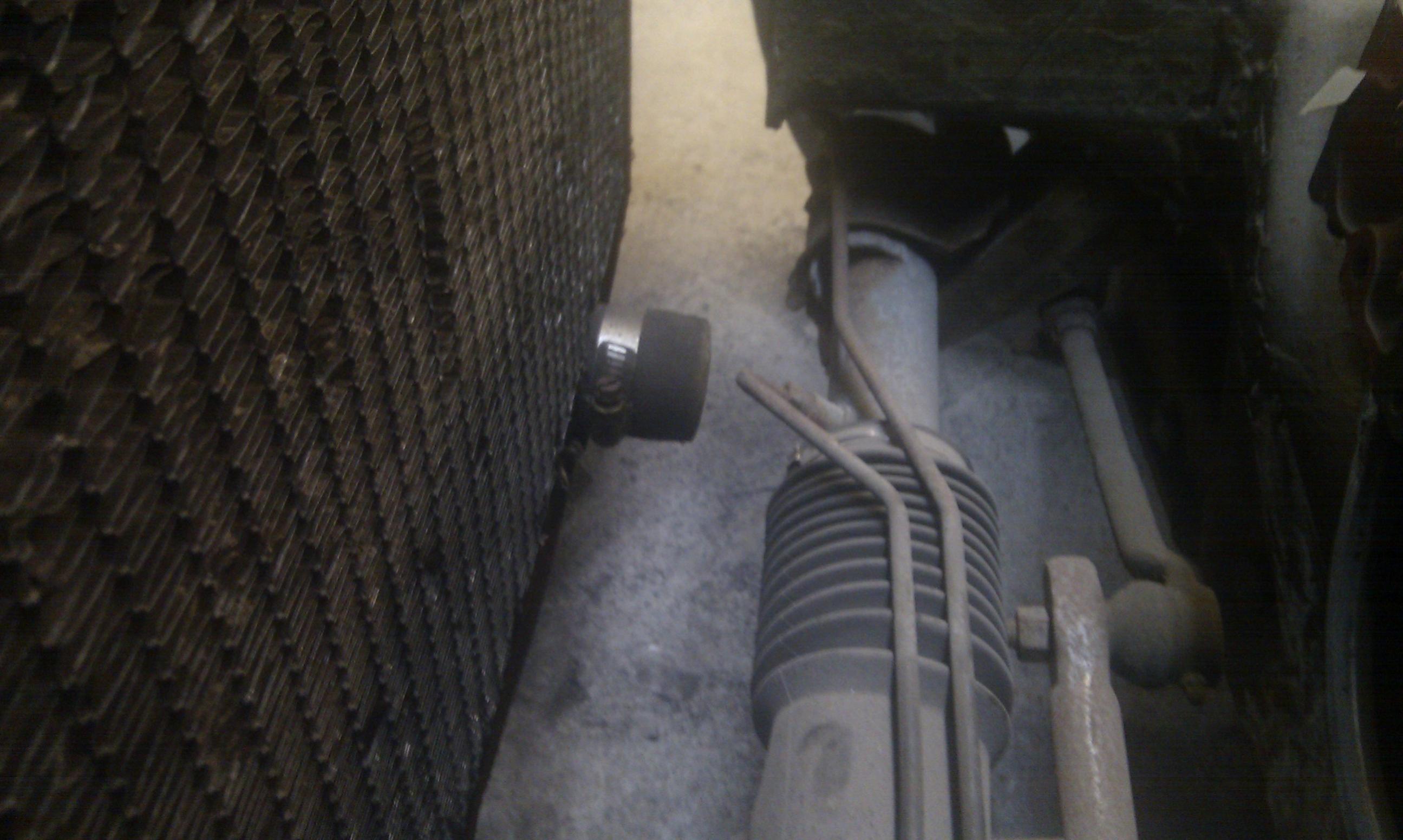

    Got a few hours at the car last night.Jason showed up and helped out agian..thanks bud.. waiting on spring mounts for the rear and I had a few things on the car I need to address.when I finsh the floors I want to pull the body but one thing that would have to be done first is the front frame has to build for the stock rad support and bumper. So we figure we do that and figure out what had to be done.I had a old support that I cut up to mount the fender so I had a idea on where to chop off the rails. used the rad support from the green parts car and left it all togeather and just bolted it to the fenders. Seems like a straight forward job with only one problem that I could see. The lower rad hose is very close to the trans lines on the rack. Figure Ill have to move the outlet over a bit on the tank and that should fix it. We have plans on getting the spring mounts this saturday but there might be some snow headding our way..Just my luck.. Im hoping the weather will hold off till Sunday.

    Seems to fit in there pretty good, hose shouldn't be a problem for you, nice job...Jim

    I just found and, read through your entire build thread. Very impressive! Since I own a 50 Fleetline and have started a similar build I have a question that I hope you wouldn't mind answering. I was considering using a S-10 front frame clip too but, wanted to keep the S-10 steering sector. Sounds like the original style radiator would not fit. My thoughts were to possibly use a crossflow radiator and graft in the matching radiator support. Had you considered this too and figured out it wouldn't work for some reason? Any help or ideas from you or anyone else reading this would be greatly appreciated!
  25. fitzee
    Posts: 2,862
    fitzee
    There is not much room between the rails with the box and pittman arm in the way.. move it forward of that and your in the grill. I have my frame channeled in front about 2 inch so i have less room.. You can use a cross flow rad but it will have to stick up like the 52 rad did.. I think it will look stupid but it can work all the same. a Nova or early camaro clip with the box in the back would work way better.I went with S10 cause I want the tires in under the fenders and did not want to ark the wheel lips for tire clearance.
