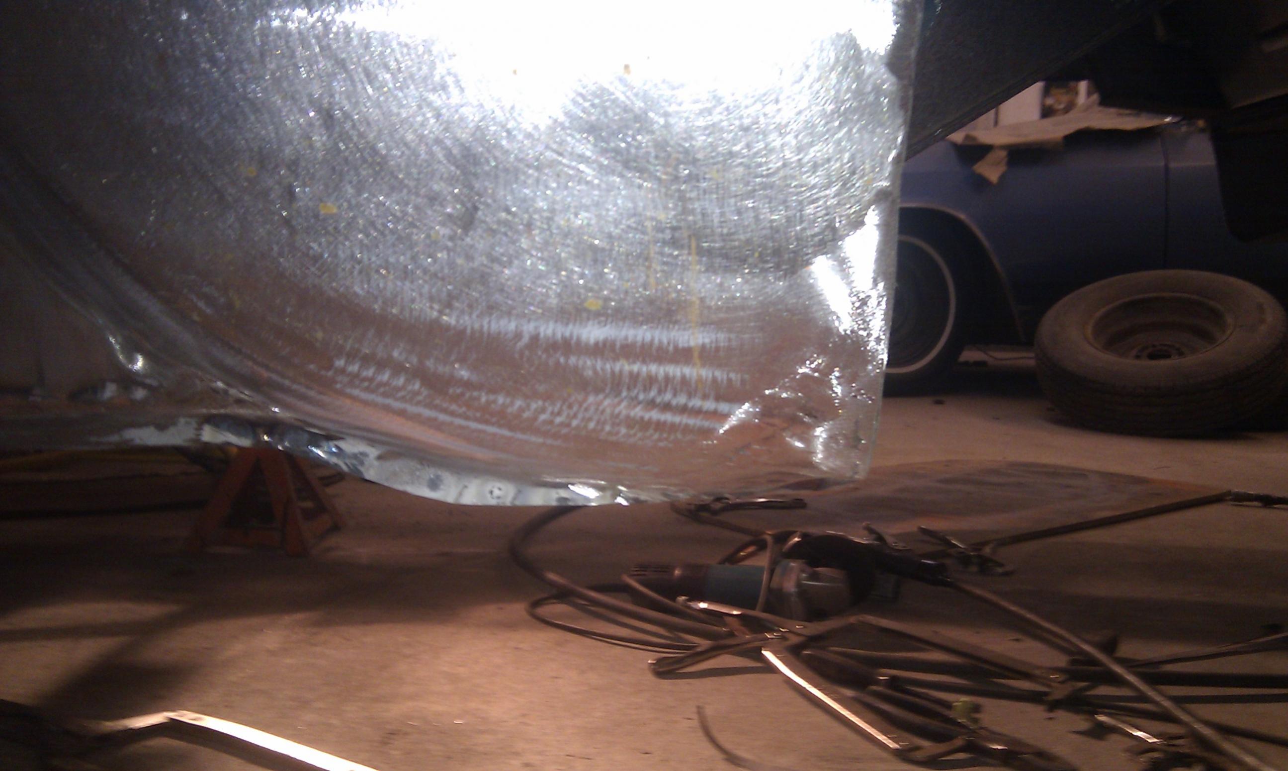

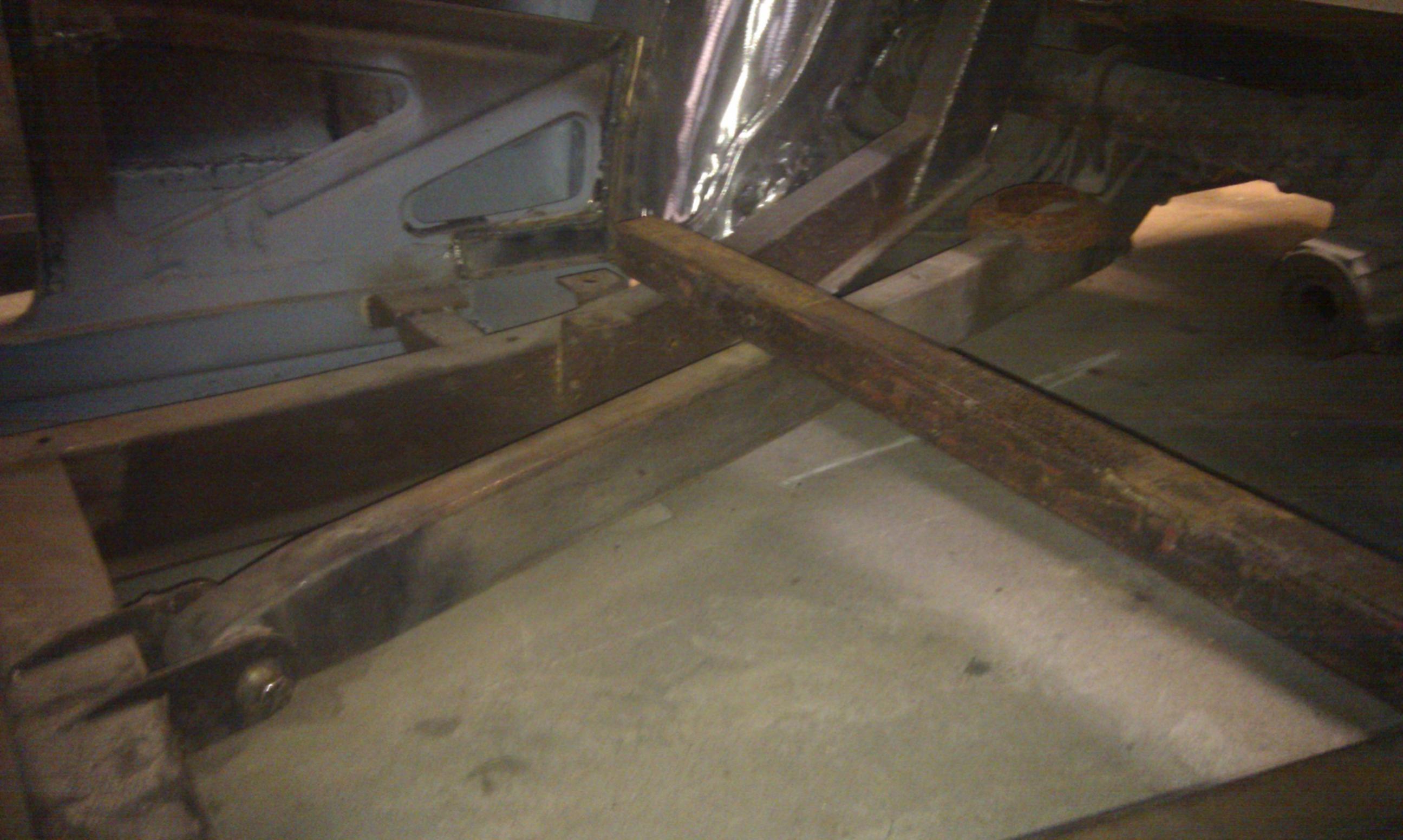

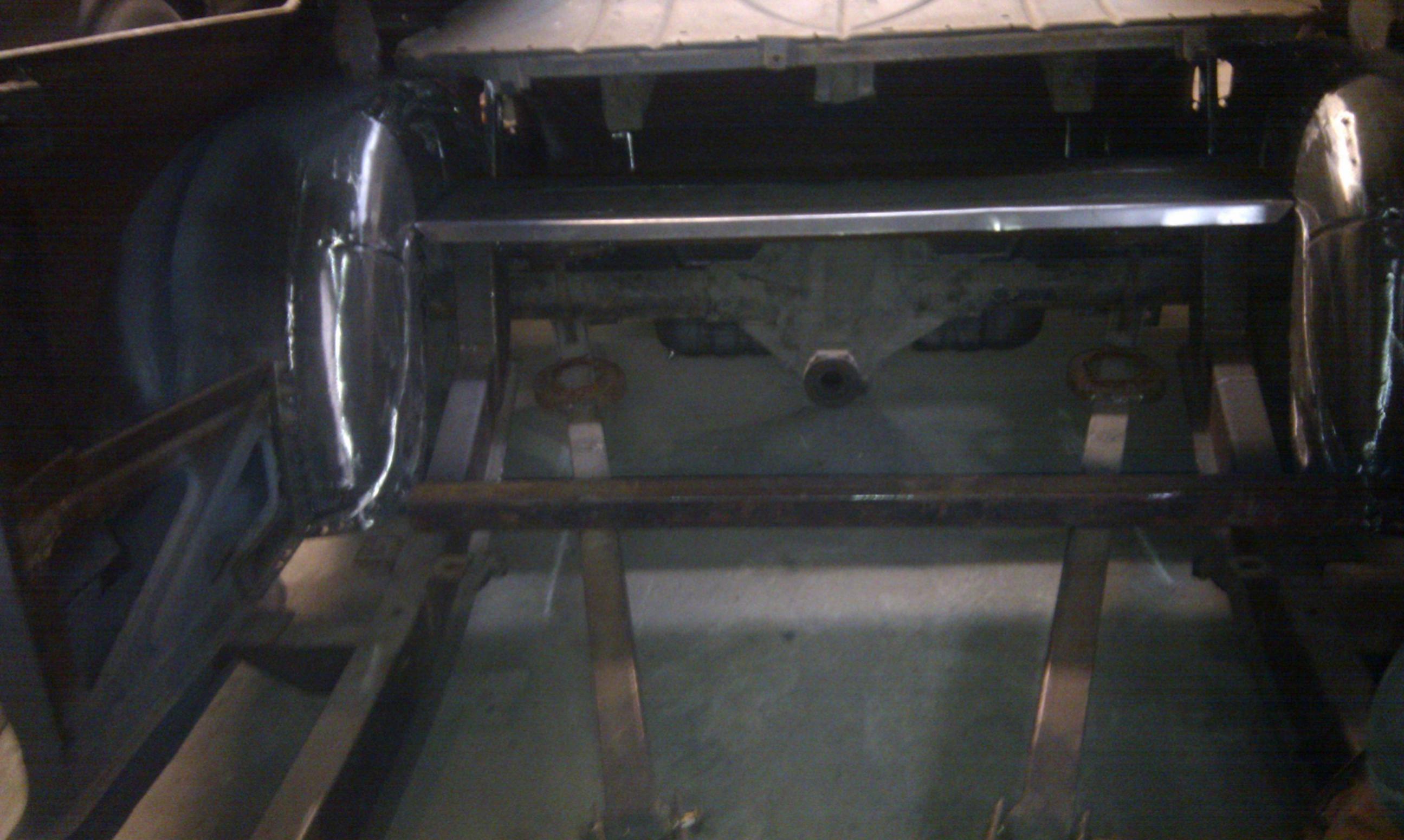

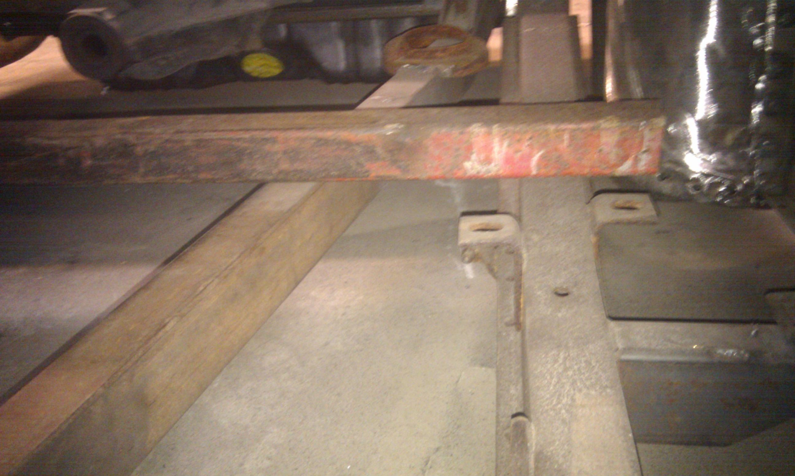

    well the trunk is done and im moving on forward of the rearend. got to figure out how the floors will need clearances on the control arms so had to lay the car down at it lowest point. with a set of 235s on the back she brings up in the tires.lol so wont be running them if I ever run bags. now it time to figure out a back seat setup.the trailing arms sit about a inch above the top of the frame rails. going to be tricky but Ill figure something out.

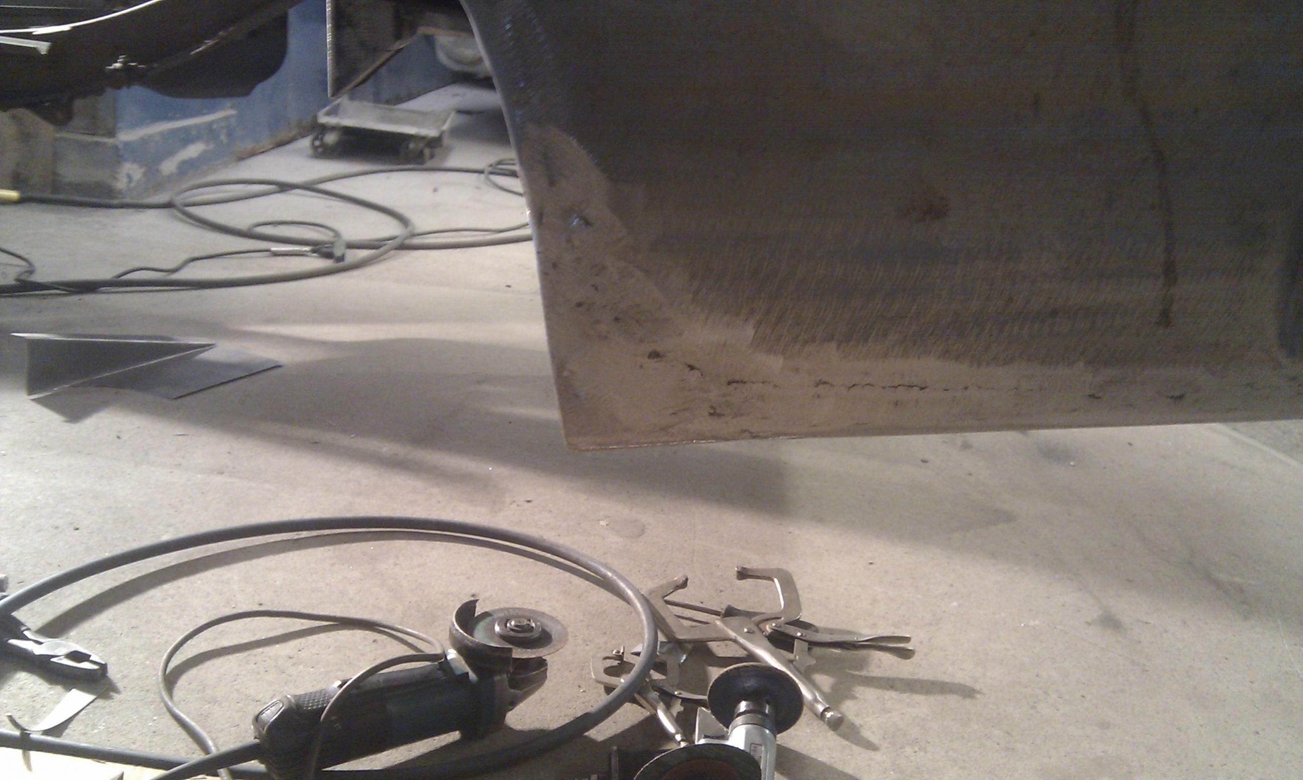

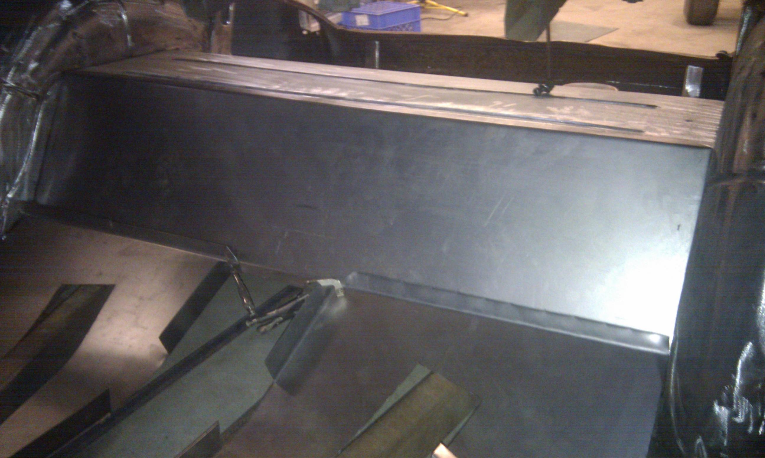

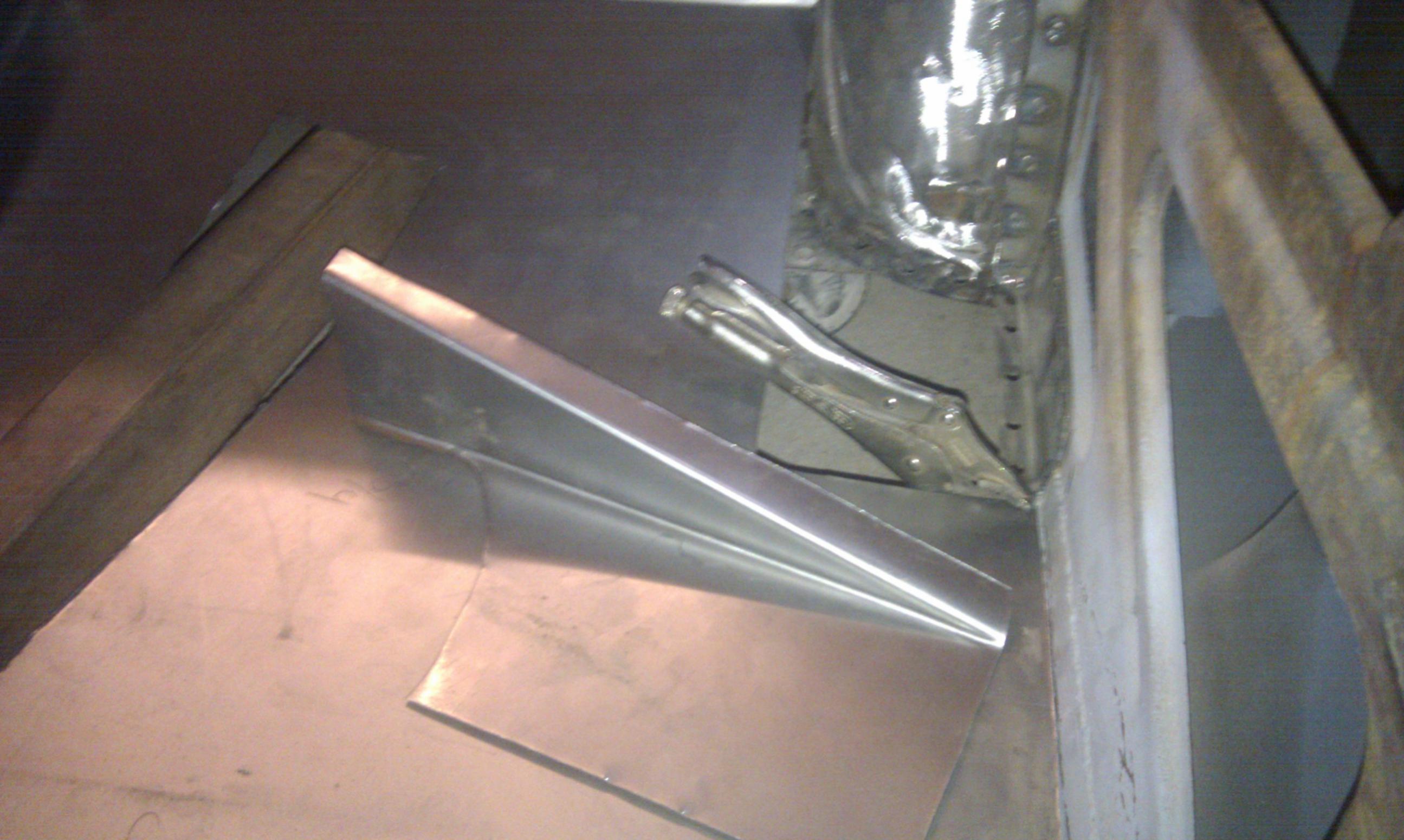

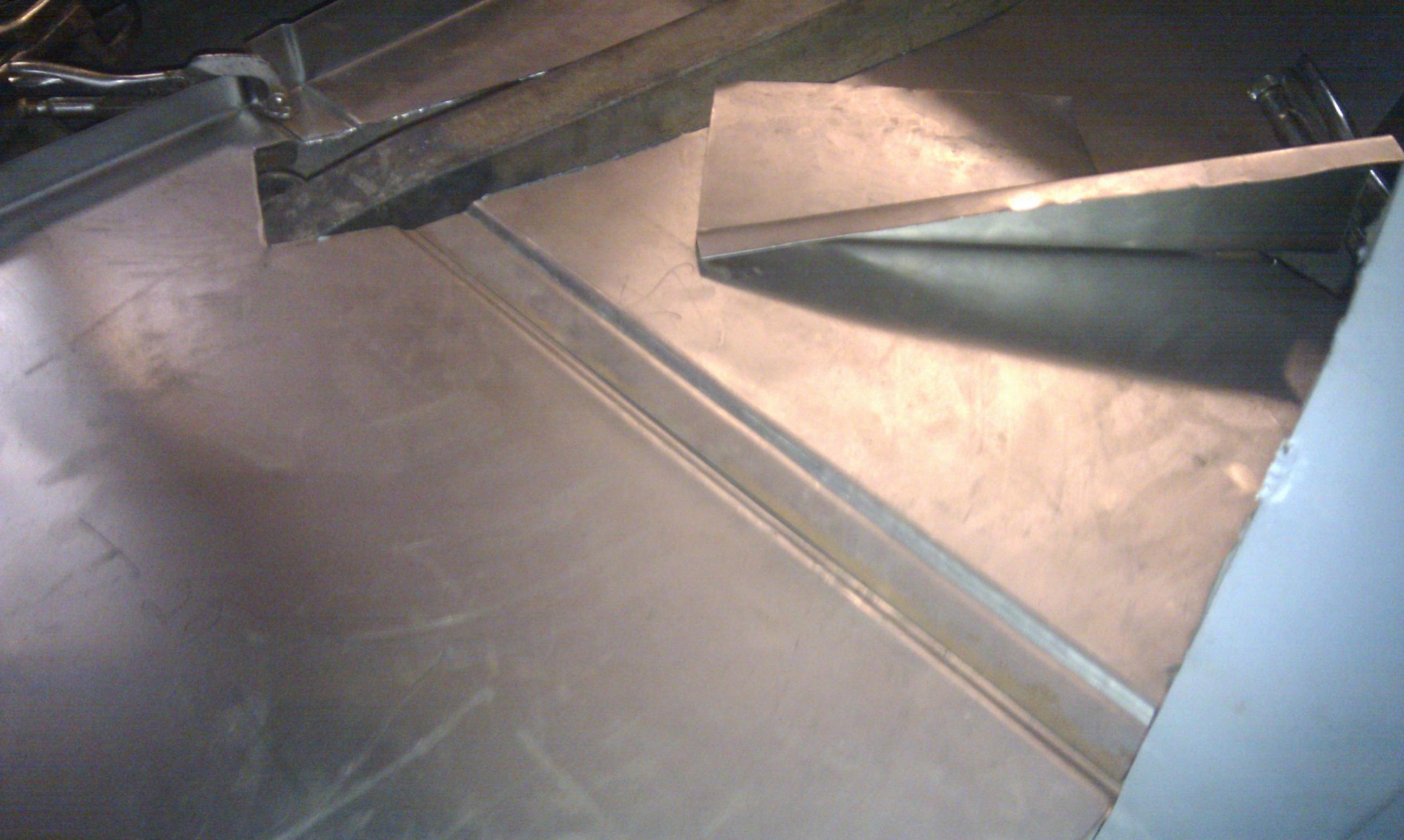

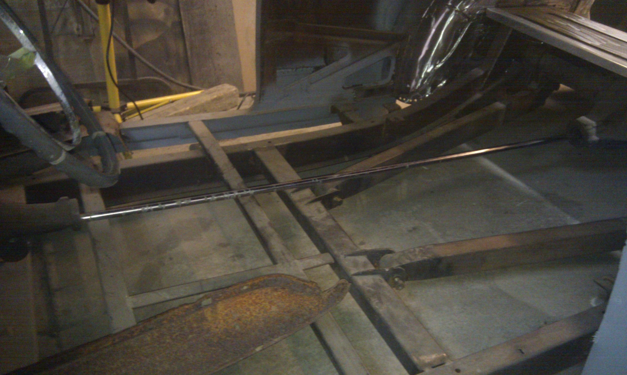

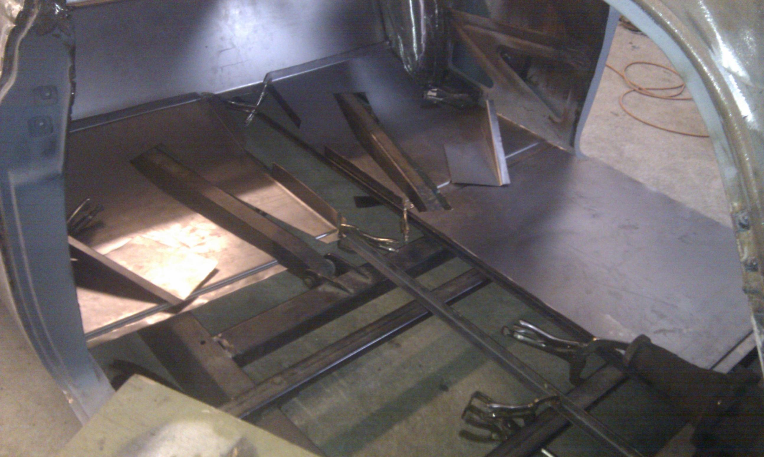

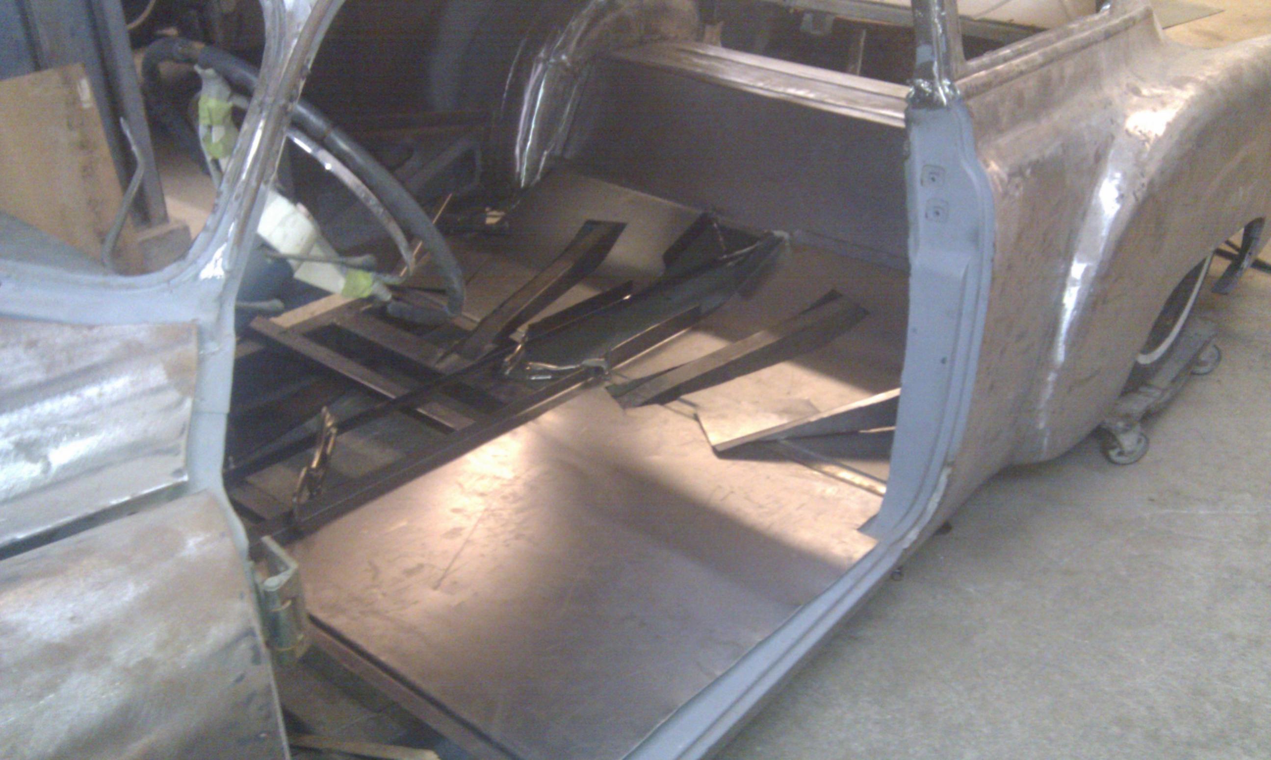

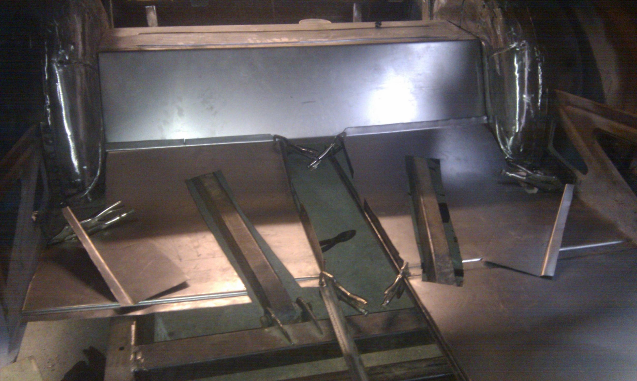

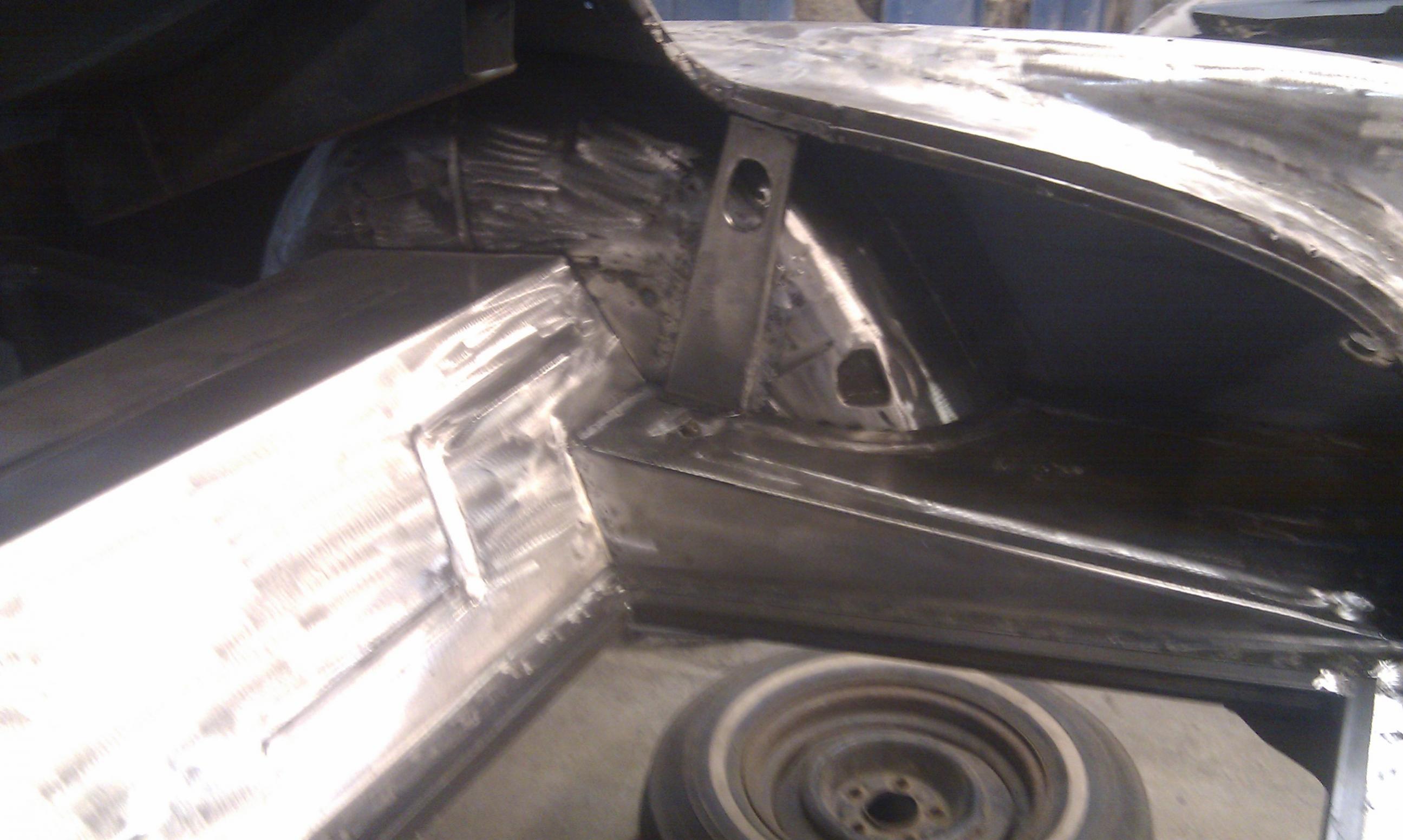

    Was a long day at the car yesterday.Showed up and spent a few hours just figuring out how I was going to do the floors..sized up the driveshaft angles to see if I need to remove any of the crossmembers. Im amazed that the shaft will clear the control arm cross memeber..The car had to be jacked up over 10 inchs on the rockers to ever come close.going to cut a small u shaped section out of it to be safe. well after getting a game plan in order I started cutting up a new 4x8 sheet of steel. like the trunk Ill make all the section up to the trans first and get them all to fit.was amazed at the right side rear panel.after I made the left side and cut it to fit..I said Ill chance it and just make the other the same and just reverse the cuts.. I figure I was going to have to make it agian cause it might of been off..but no!! with one small trim cut it fit perfect..I have the rearend set at it lowest point so I have to build two channels for them to p*** into the car. made the rear down panel and it fit perfect then I went ahead and built the drivers side floor under the seat. it still needs to be worked and trimmed but it fit good..when build floor pans I tend to step the ends where they will be welded..I find it adds strenght and keep the heat from warping up the floors when welding..give you a nice seam to seamseal as well..anyway I run out of steel and my back was killing me so at 8 I call it quits..going to see if I can get a few hours here and there the week..but first I need to pick up more steel..

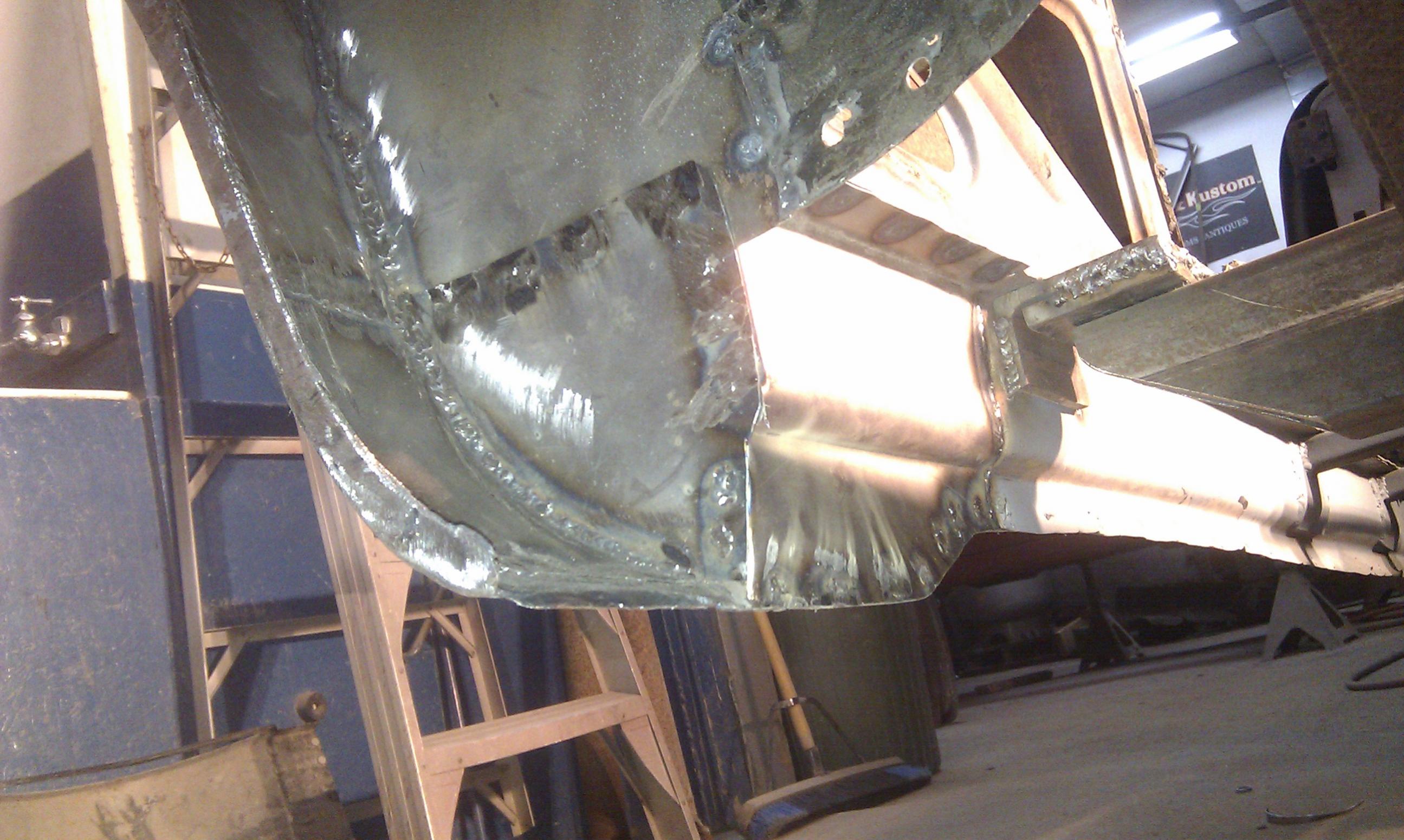

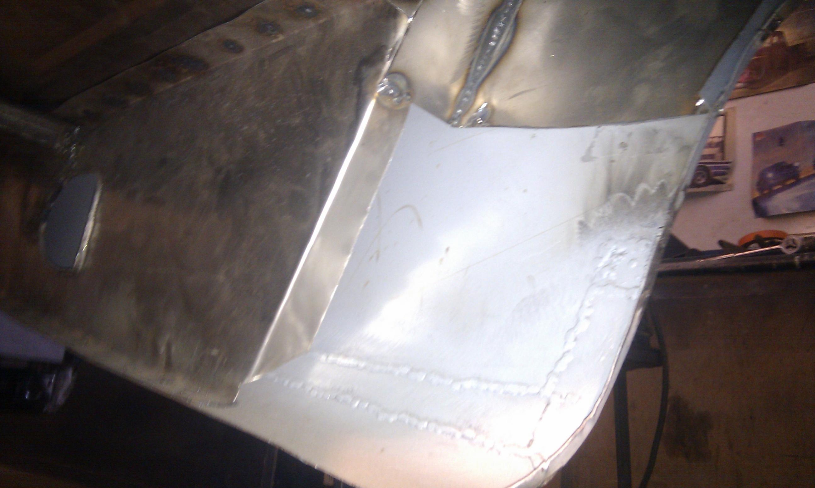

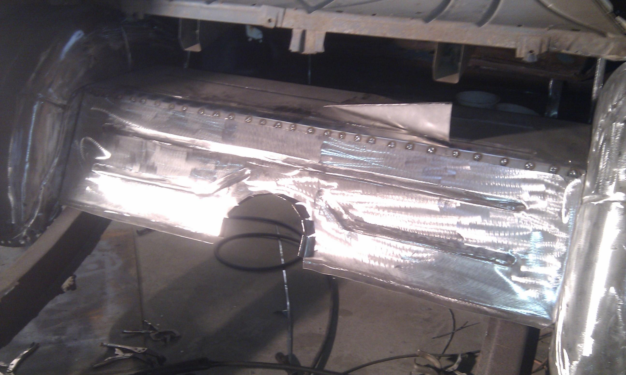

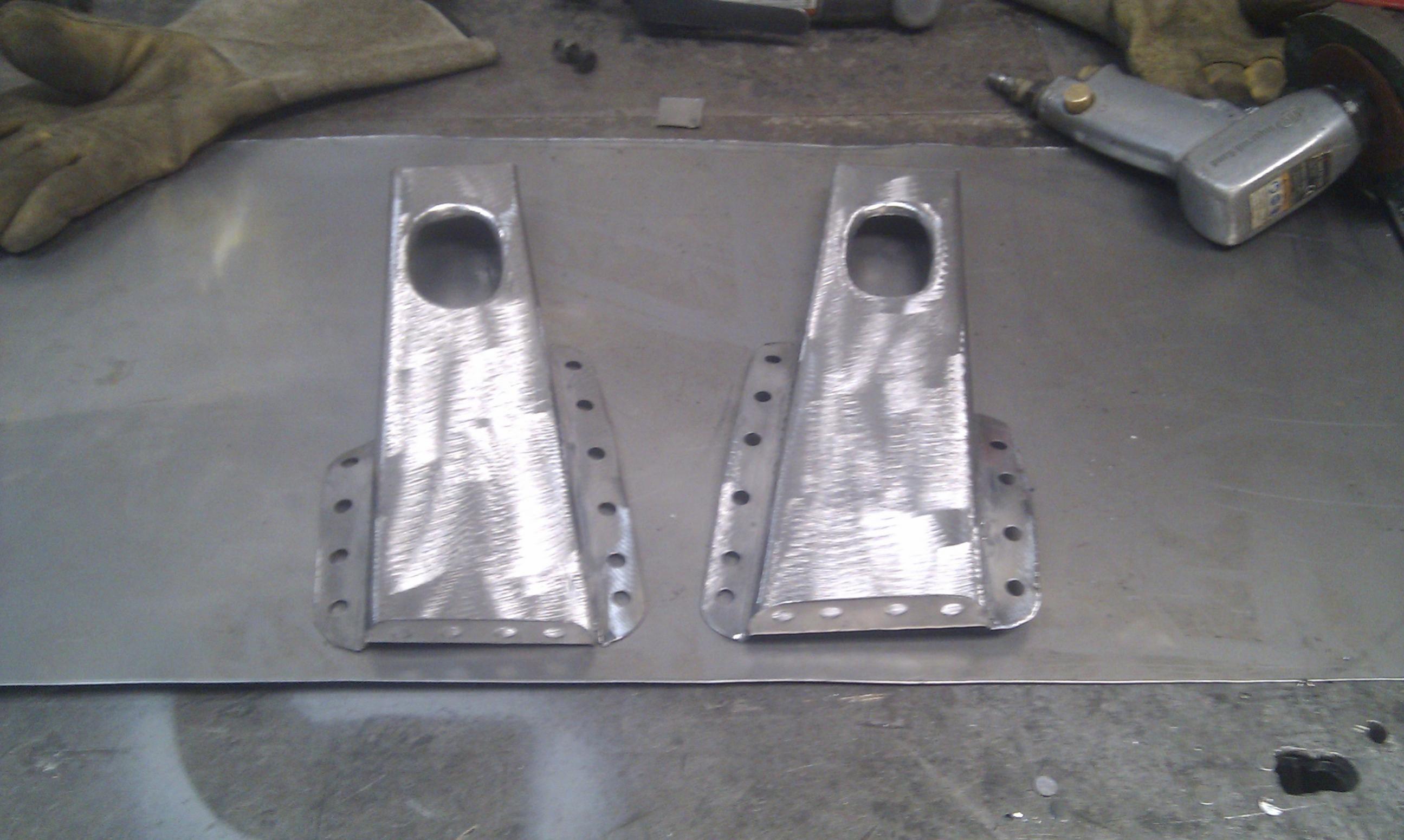

    A little more work done..you know what its like when you think of a dozon little thing that need to be done before you move on to what you want to be putting in.. well the end of both rockers to the wheel well need to be capped as well as behind the wheels.. now to do that my plan for skirts has to be looked after before they are done!!I want the skirts to roll under the car.most have to flare off with the turn on the bottom of the quarters.So I changed it here so I could have the skirt roll under without a flare..well I got one side done and said I got to do something big so I installed the front panel on the C notch. it is slow but im still moving forward.

    problem is there is more then 4 things I need to do before i install the rear floors!! tie in the back dash to the floor and to the roof..tie in the roof to the wheel tubs. cap the end of the rockers! do both wheels wells and then close in the rear quarters under quarter windows on the inside of the car and while your doing that might as well frame in quarter windows for solid windows!!then install the rear floors..lol

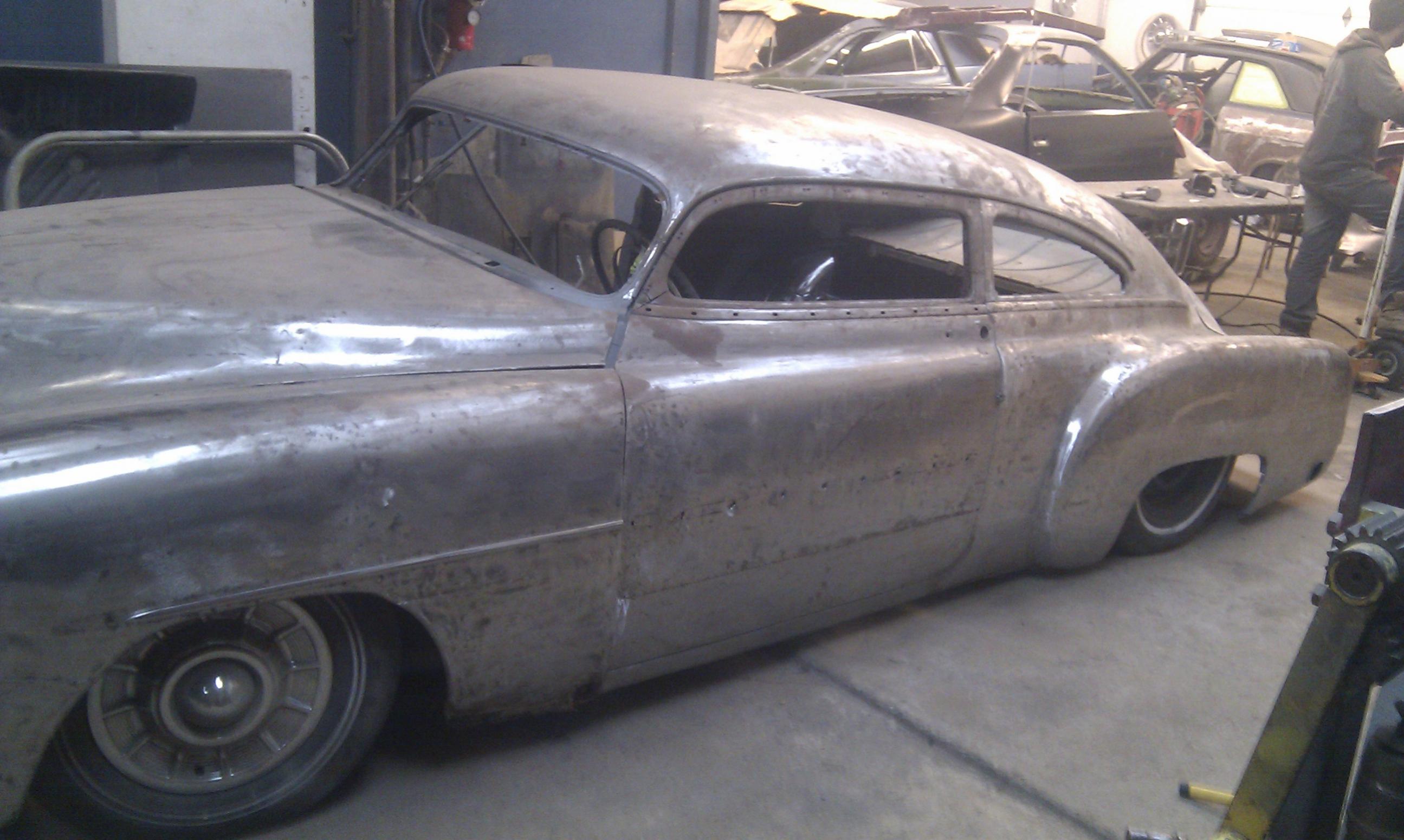

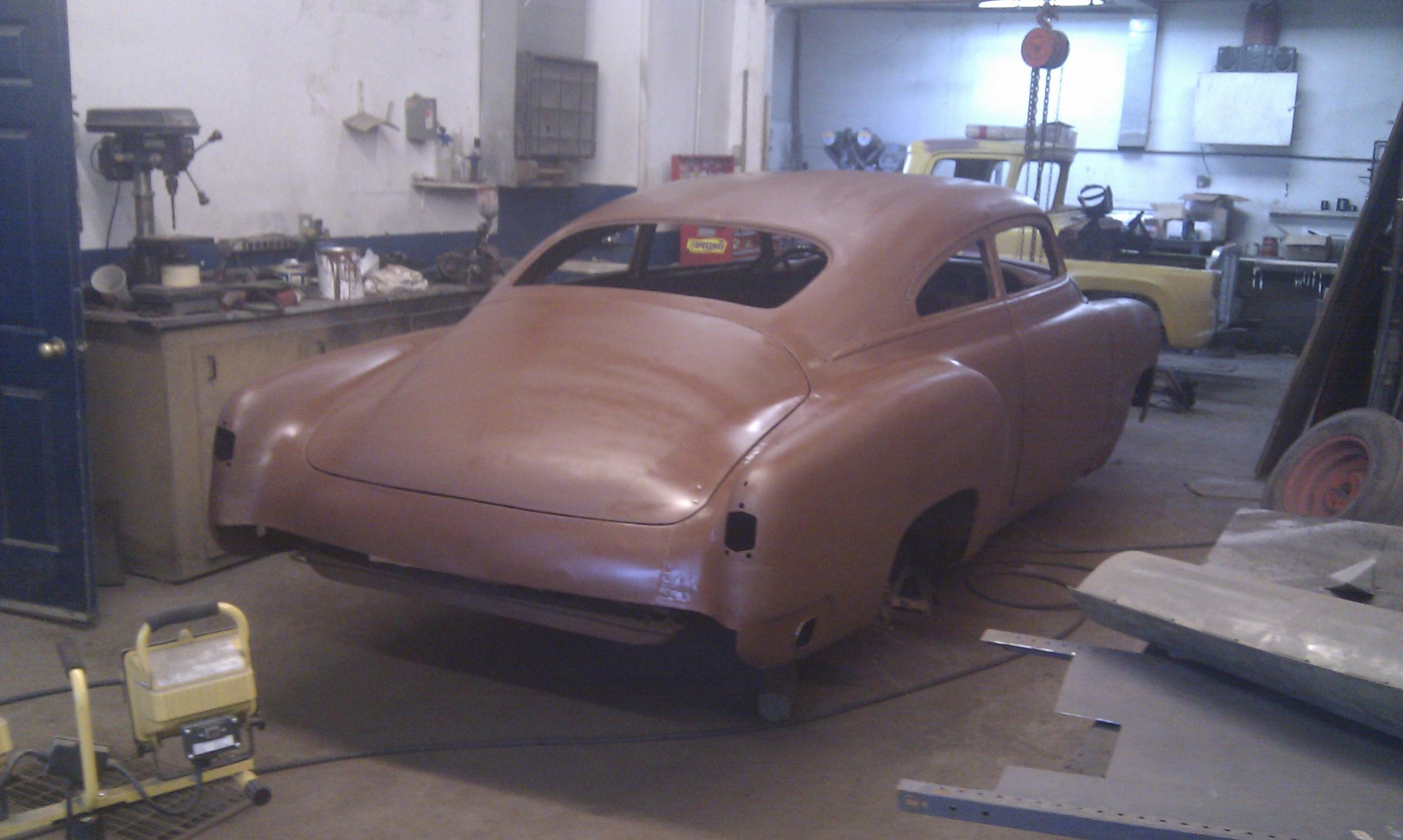

    sorry the car has been in storage now for 8 months and i have moved to a new building and no room there for the car. have it on hold for now but hope to be back at it at in the fall of 2014. have a 51 deluxe now as a mild custom Im getting on the road for this summer..
  26. fitzee
    Joined: Feb 26, 2003
    Posts: 2,862
    fitzee

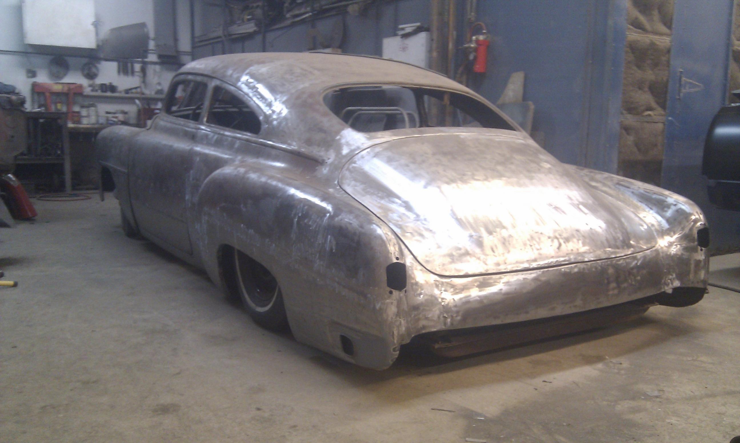

    how she was the last time I seen it!!
