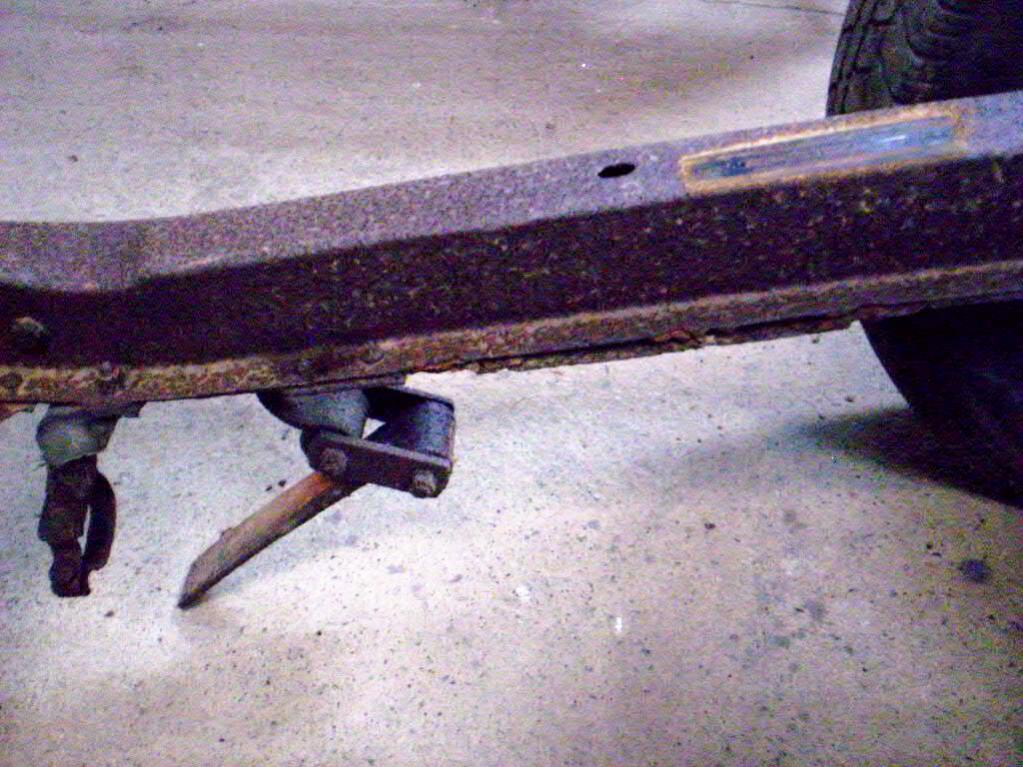

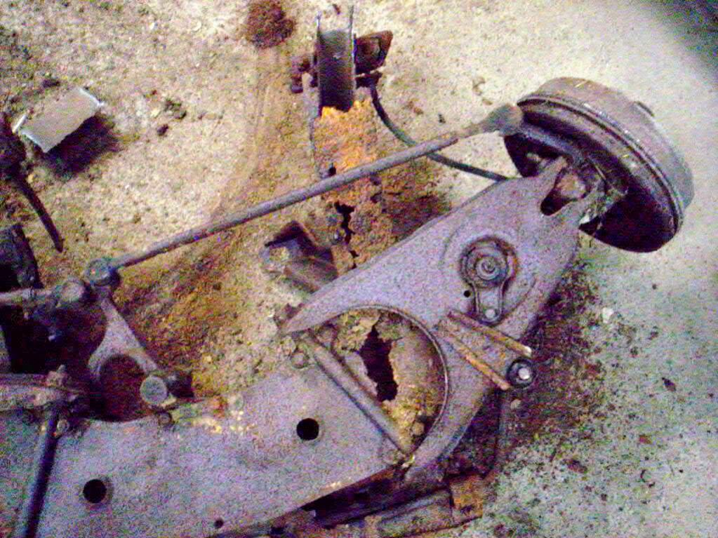

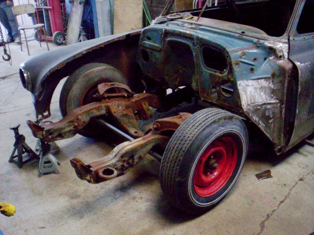

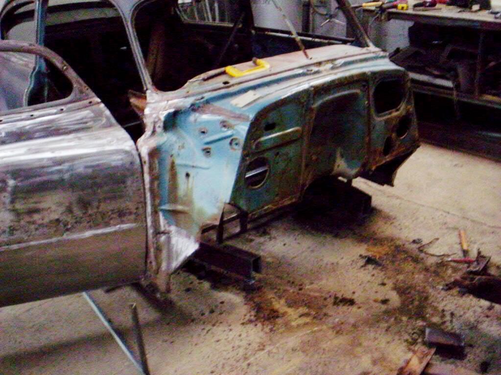

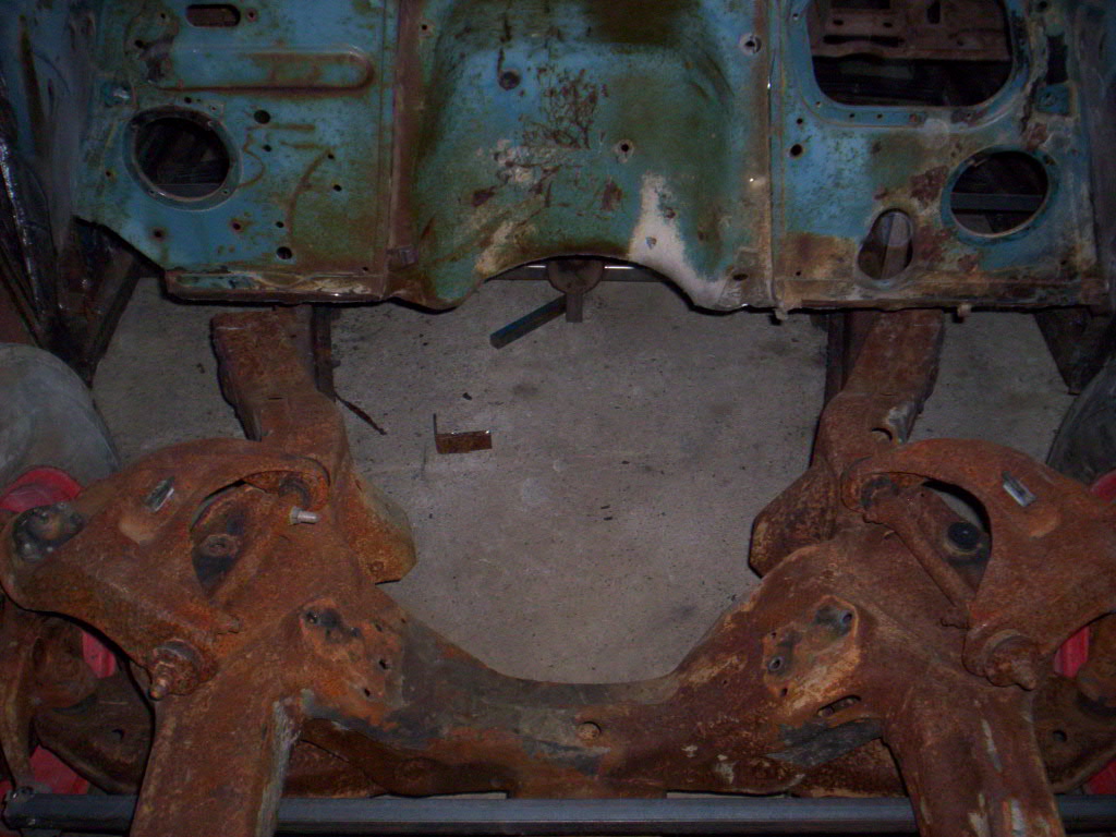

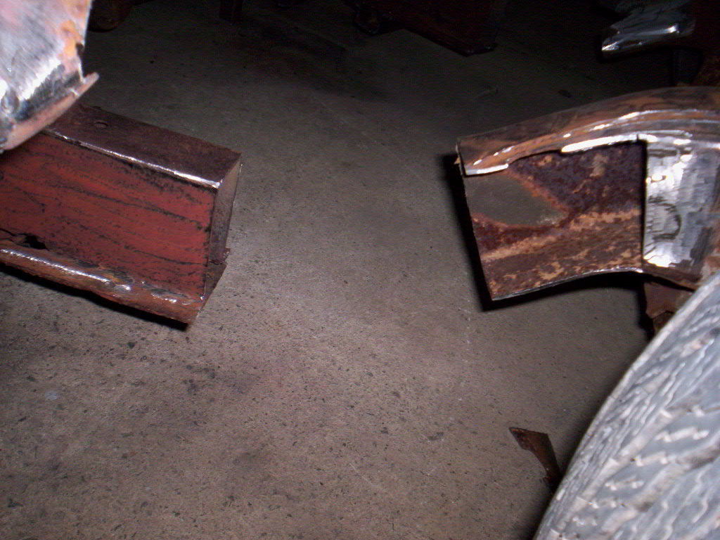

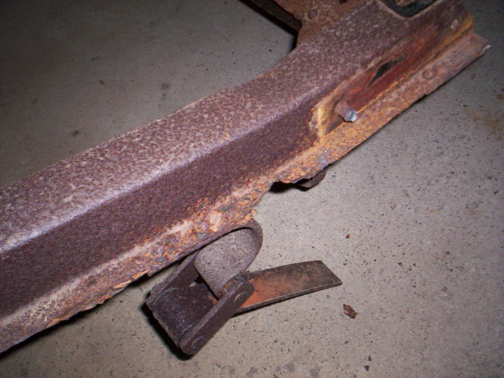

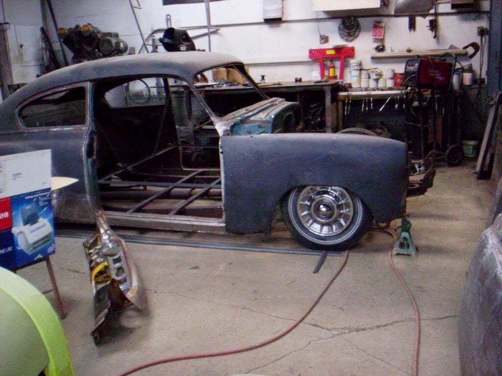

    Been busy getting some of my parts cars s****ed,winters coming!! I should have more done.But here is where i am at. I clued up the driver door. Sorry no picture of it. There in the work computer.DOH!! I set the car up next for the front clip swap. Now don`t get you pee hot. I had to!! The front was rusted way too bad so I will install a S10 clip I have had for 6 or 7 years!! I pack rat everything!! I set the car up at 5 inch ride height and spent a bunch of time measuring everything and to be happy with the height.No turning back now. Add two cross members. will cut the drive shaft sections out later. Chopped off the front as well as the trans cross member. As you can see the front end was bad. and I ended up with another pile of rust.Are this rust piles ever going to end??

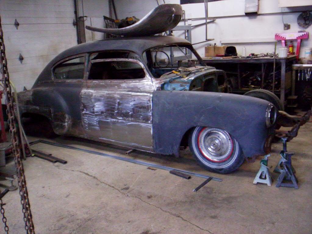

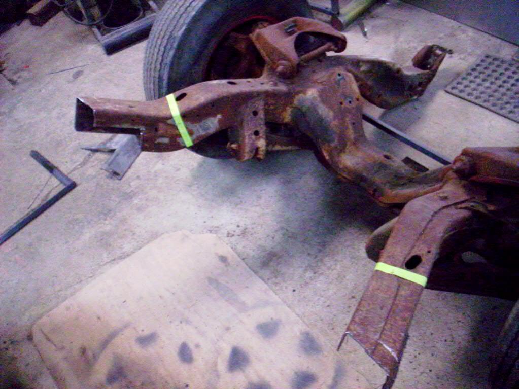

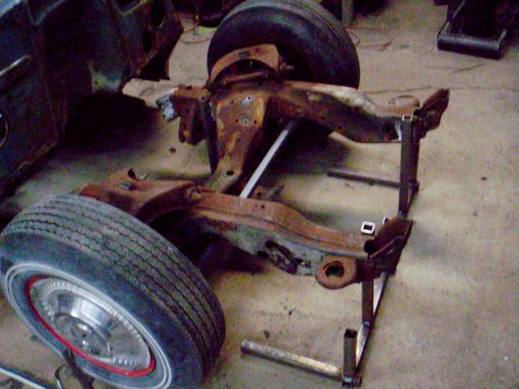

    Ok here is one of them late model frames that you have a hard time speaking about with some guys on here.lol. I removed the front springs and set the lower control arms level and welded on two stops.Then I trimmed the frame to fit to the 52 frame. Need to think now on the best way I will join these frames. Off to the drag strip this weekend so it gives me time to think about it. I couldn`t let it go without test fitting a fender. The Studebaker hub cap don`t look have bad!! I have 57 Caddy hub caps on the way as we speak to replace them.Thanks Peter.Till next week

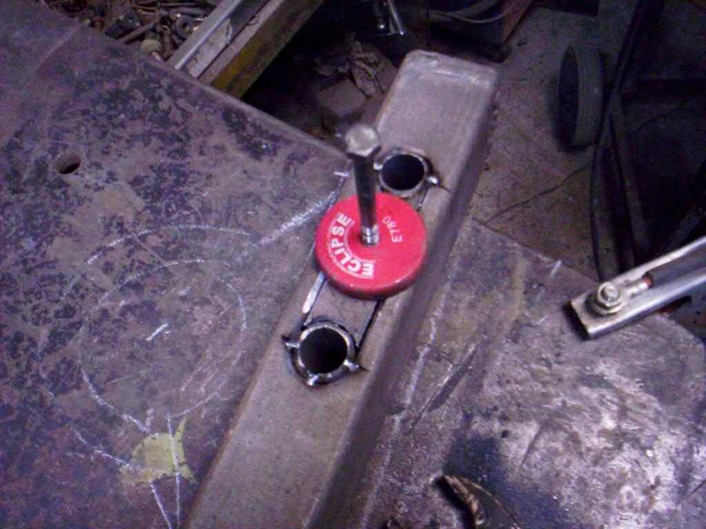

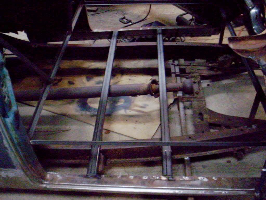

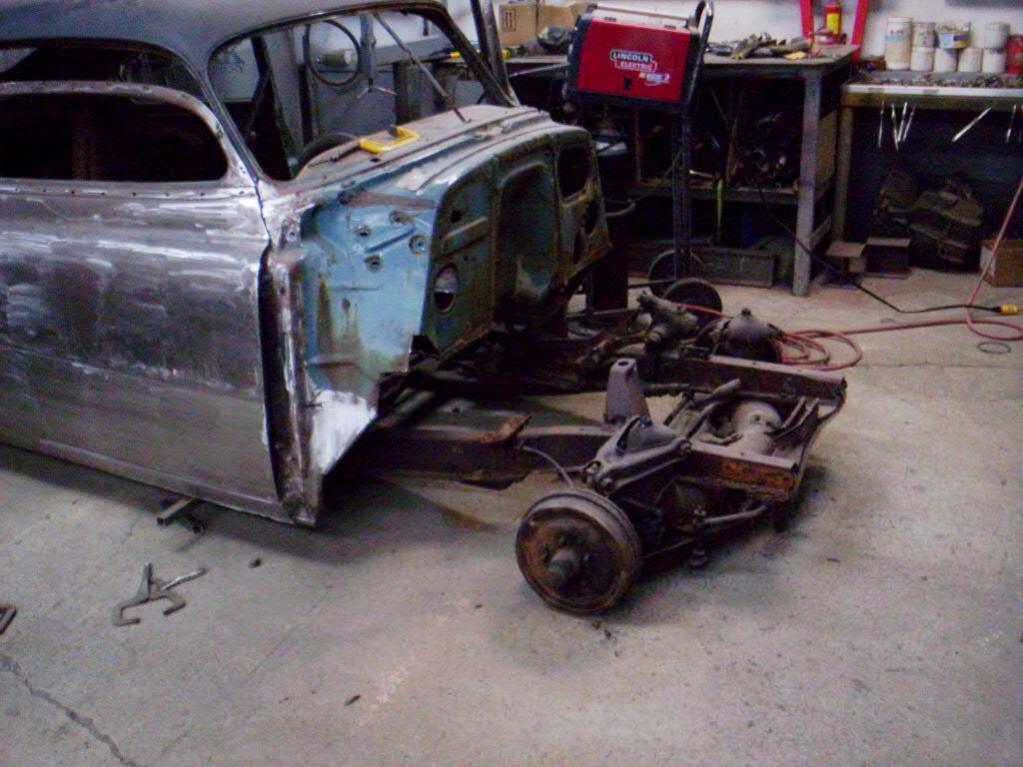

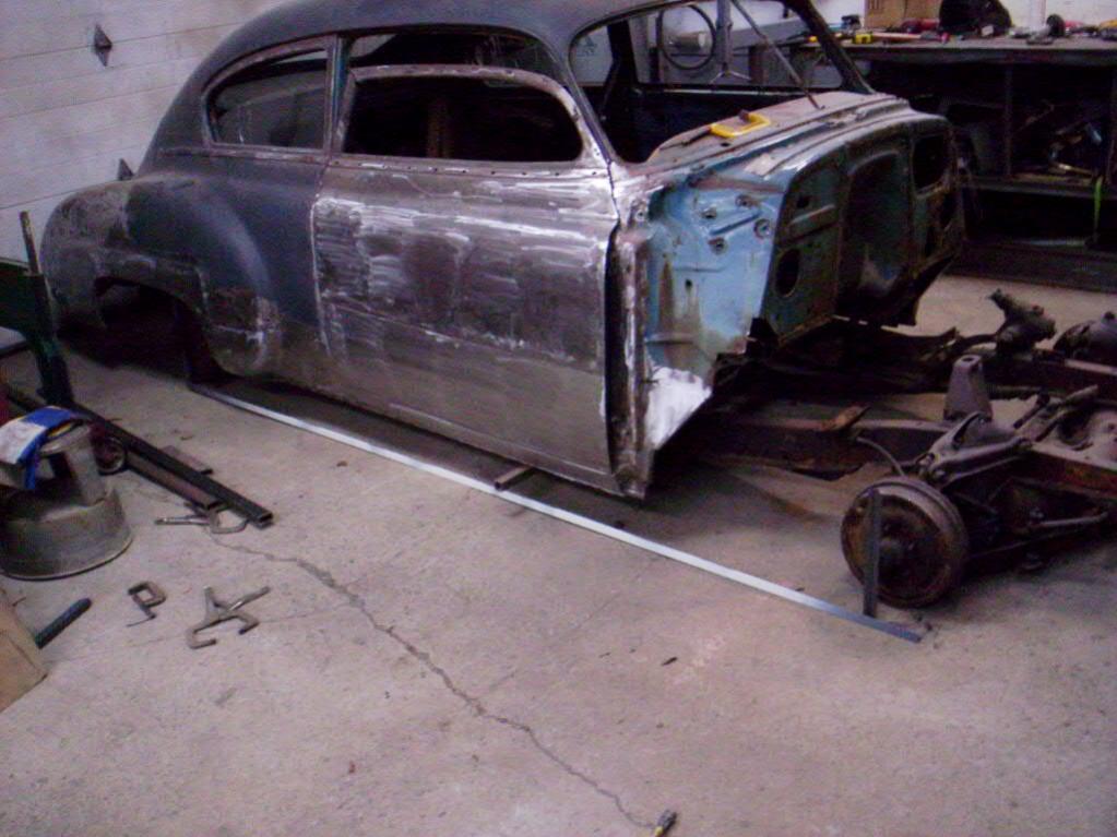

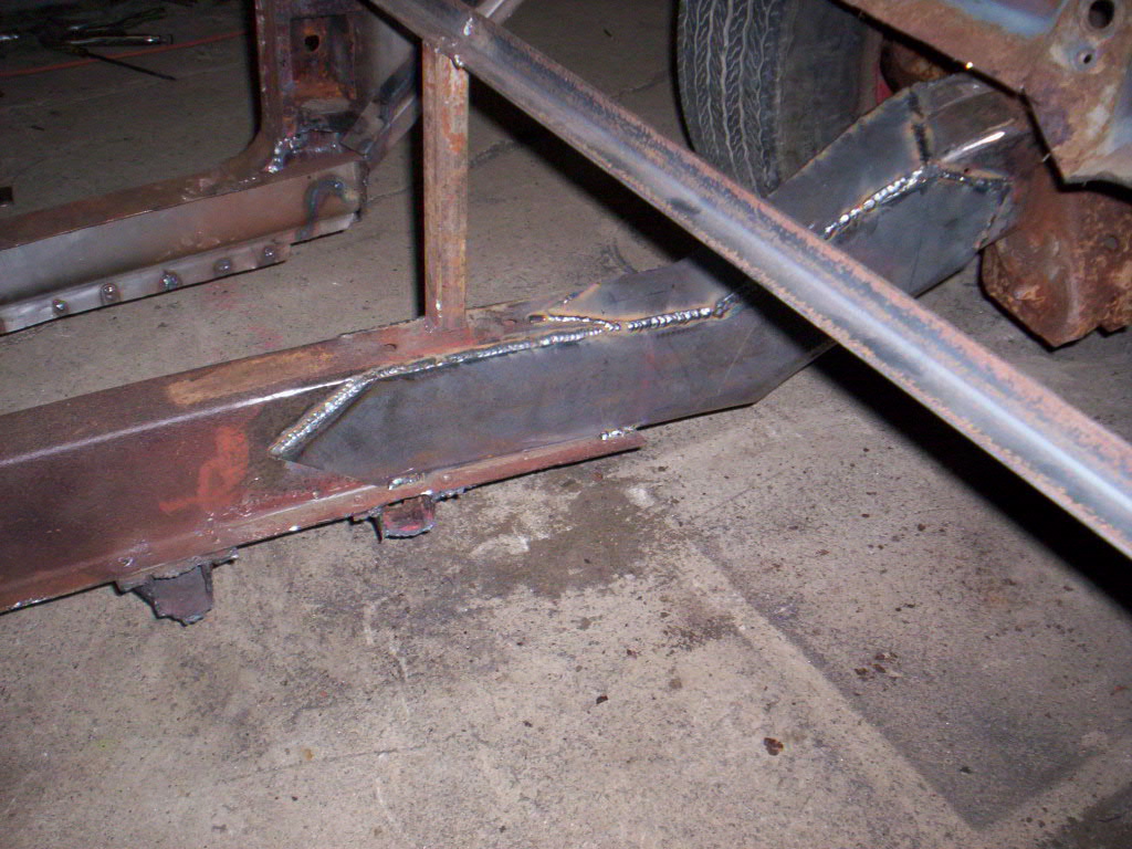

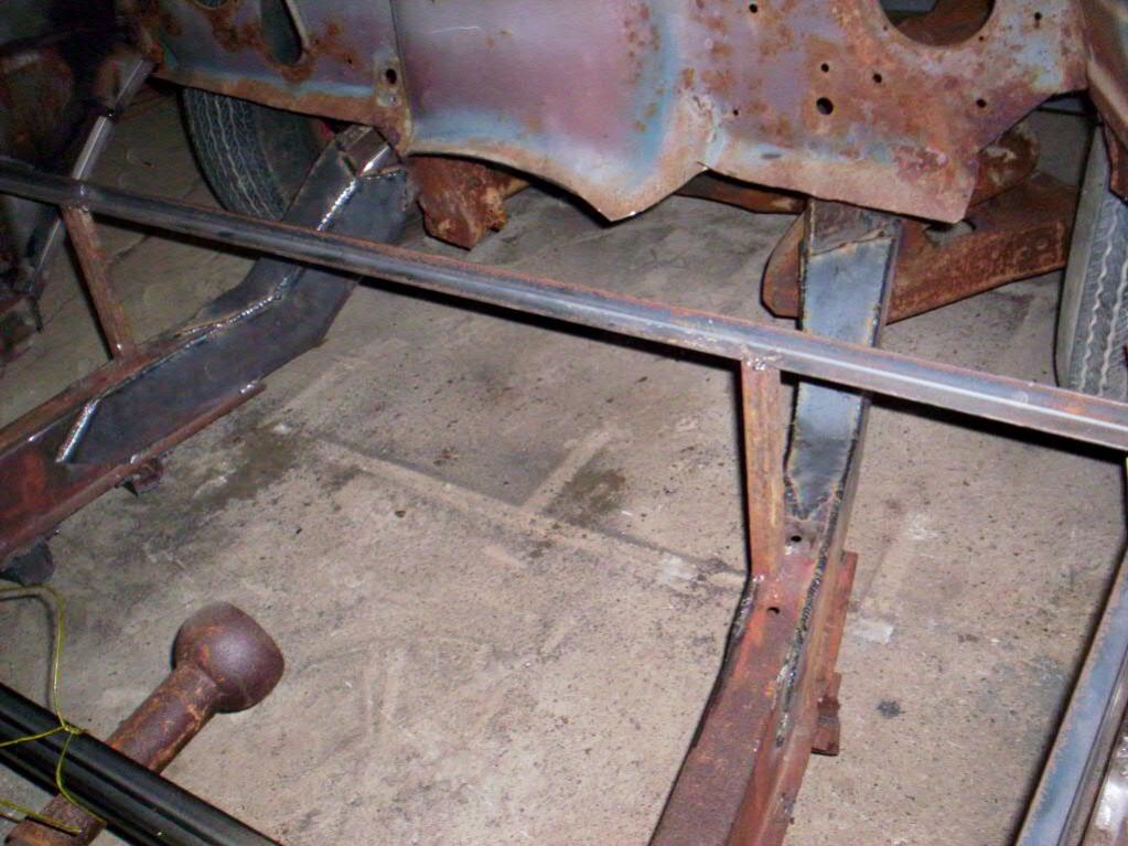

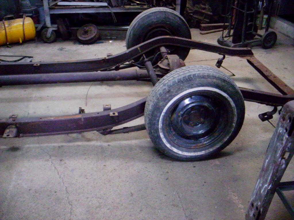

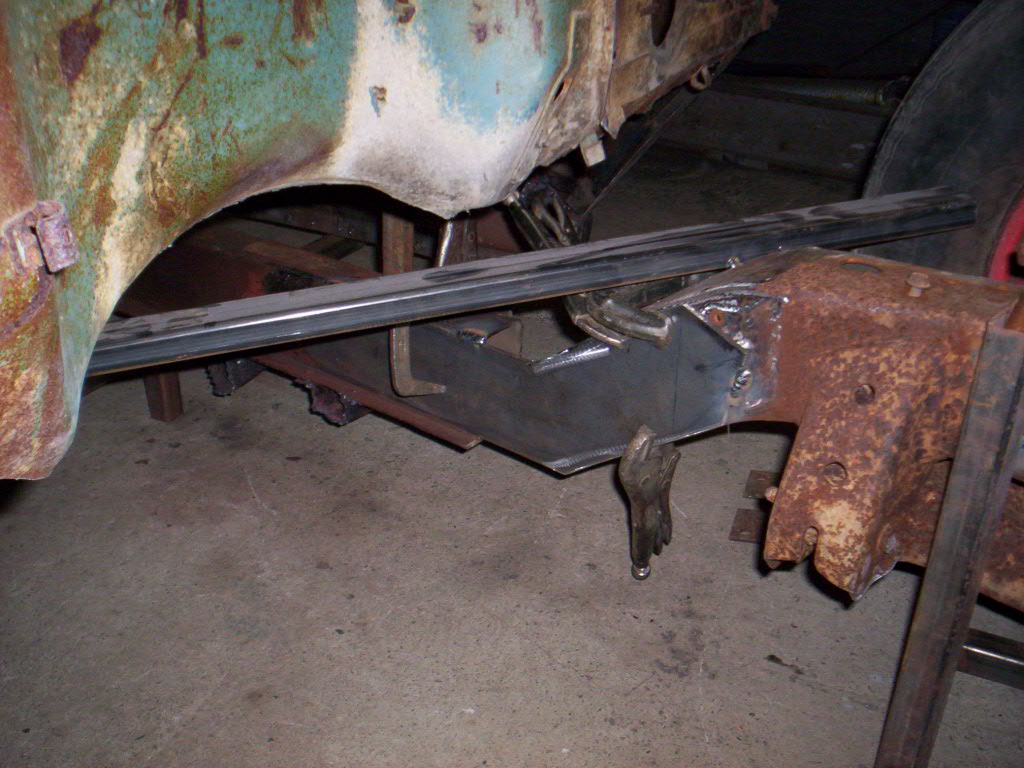

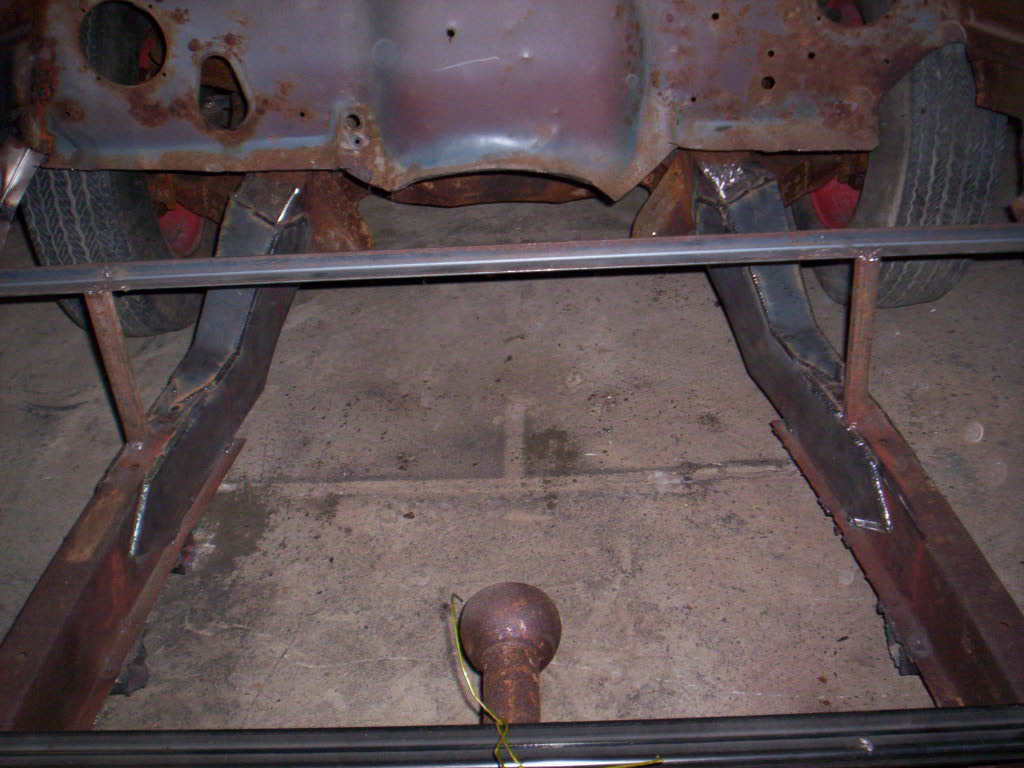

    Another full day at the shop. Spent the last few days figuring out the location of the frame. Where nothing would line up I had to cut the frames and mount the S10 frame on a stand and place it where it would be and then measure,measure and measure again. Hackerbilt dropped by today to give me a hand. Glad you did Bill Nice idea cutting the ends of the plates so they go to a point. Looks better that way. Have the top and both side completed and will cap the bottom when I remove the body and flip the frame. The body is solid enough now to remove so I`ll remove it and work on the rear end next.
  18. fitzee
    Joined: Feb 26, 2003
    Posts: 2,862
    fitzee
    Some pictures might help!! It was a long day!!

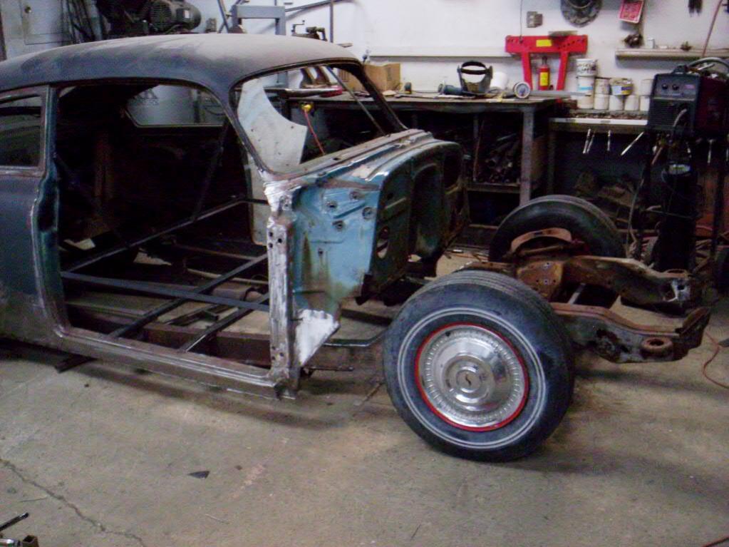

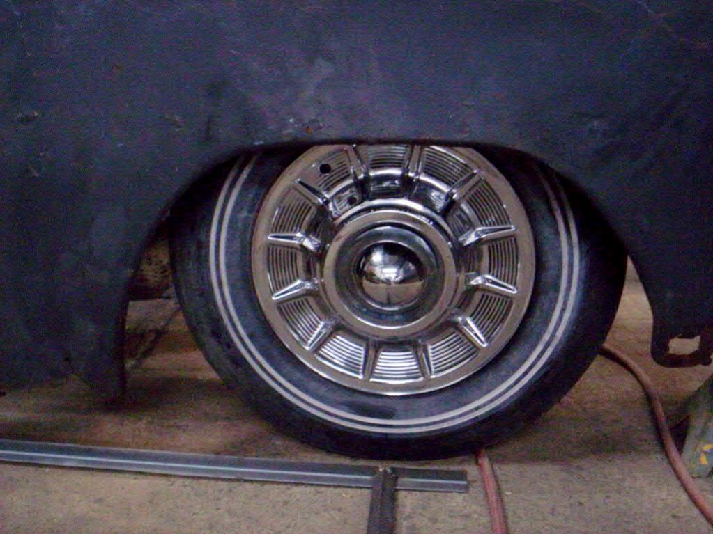

    My Hubcaps showed up. Need to start a WWW can now for my tires

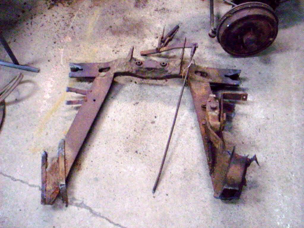

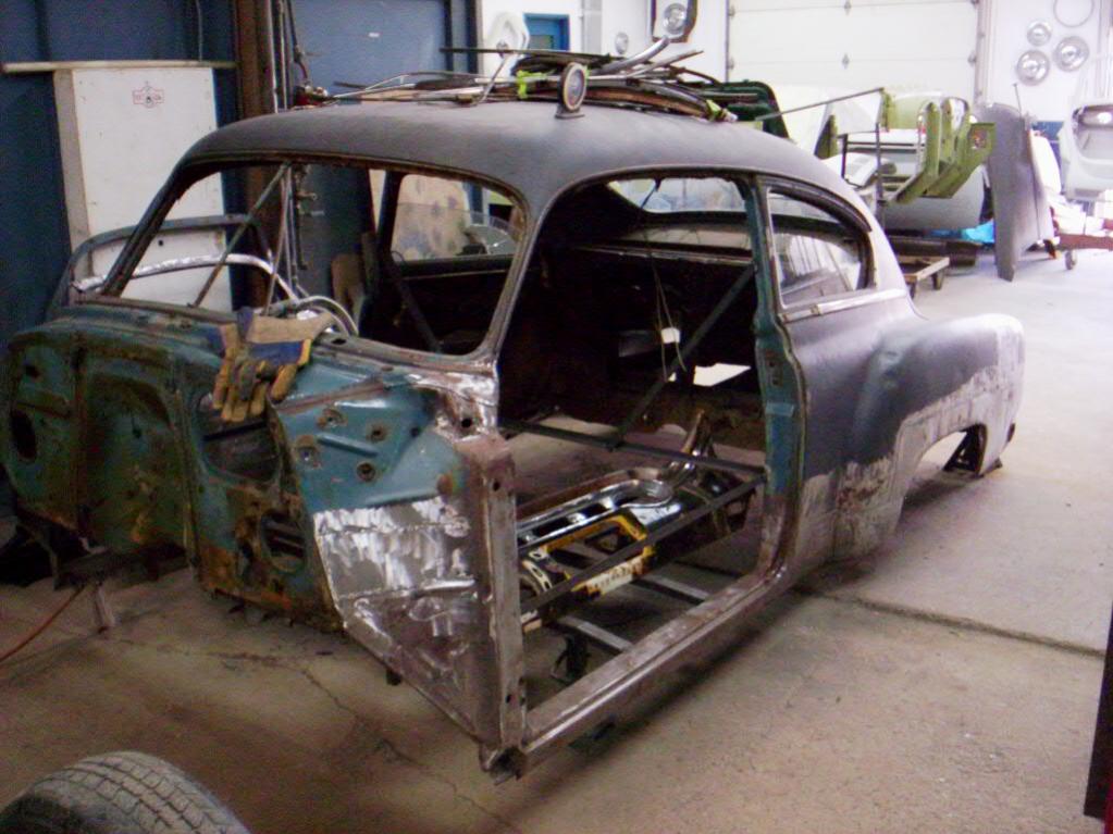

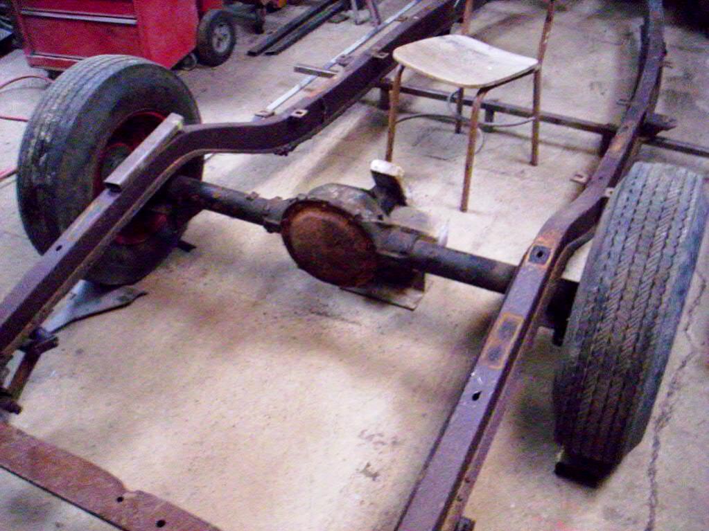

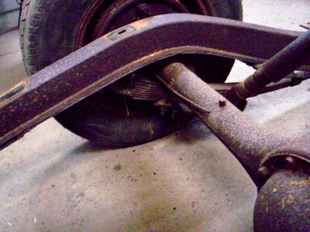

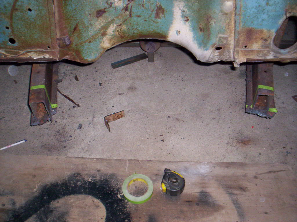

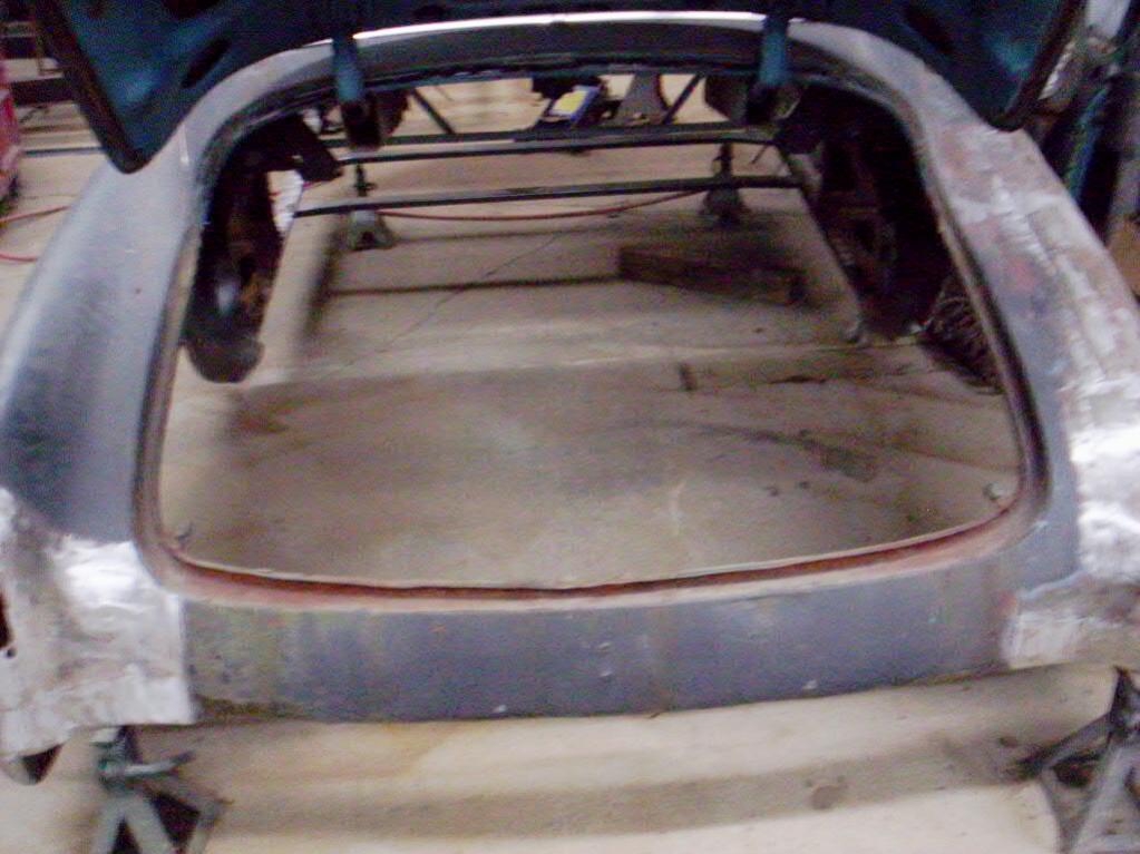

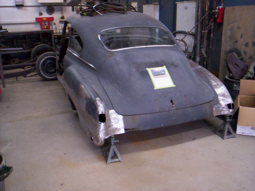

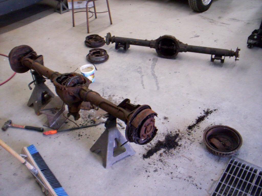

    Well on to the next step. Was going to make front body mounts for the car but decided to wait. there is a few issues I need to look at and need the frame set up with the rear end in place. So off came the body. My rockers held up great.seems that is the only place to jack and support the car!! Rear cross member on the body is ruff. But the rear frame looks solid other then one spot under the left rear spring mount. nothing to hard to fix. I cut the springs off so as to see the frame at ride height. Need to get some ideas now on a rear setup. Like everything else on this Island I had to hunt for a rear end that was not rusted out. Most Camaro rear ends around here have the backing plates rusted and they are hard to get. Well I had two rear ends dropped off, again thanks to Peter,he seems to be finding everything I need.I have enough now to mock up a rear end. still need a center section but again Peter is looking after that. Tomorrow I plan on cutting out the old rear end and setting up the new one and figuring out my C notch and might as well cut the remains of the old floor out of the car. not doing nothing in there anyway. Only thing holding the rear floors in place is the rear dash!! Oh one last thing.My 49 Ford tail lights showed up today. Guess who got them for me??

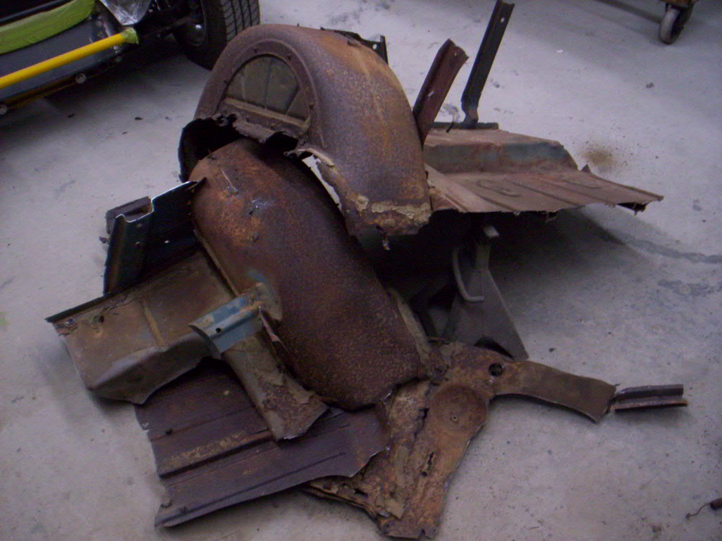

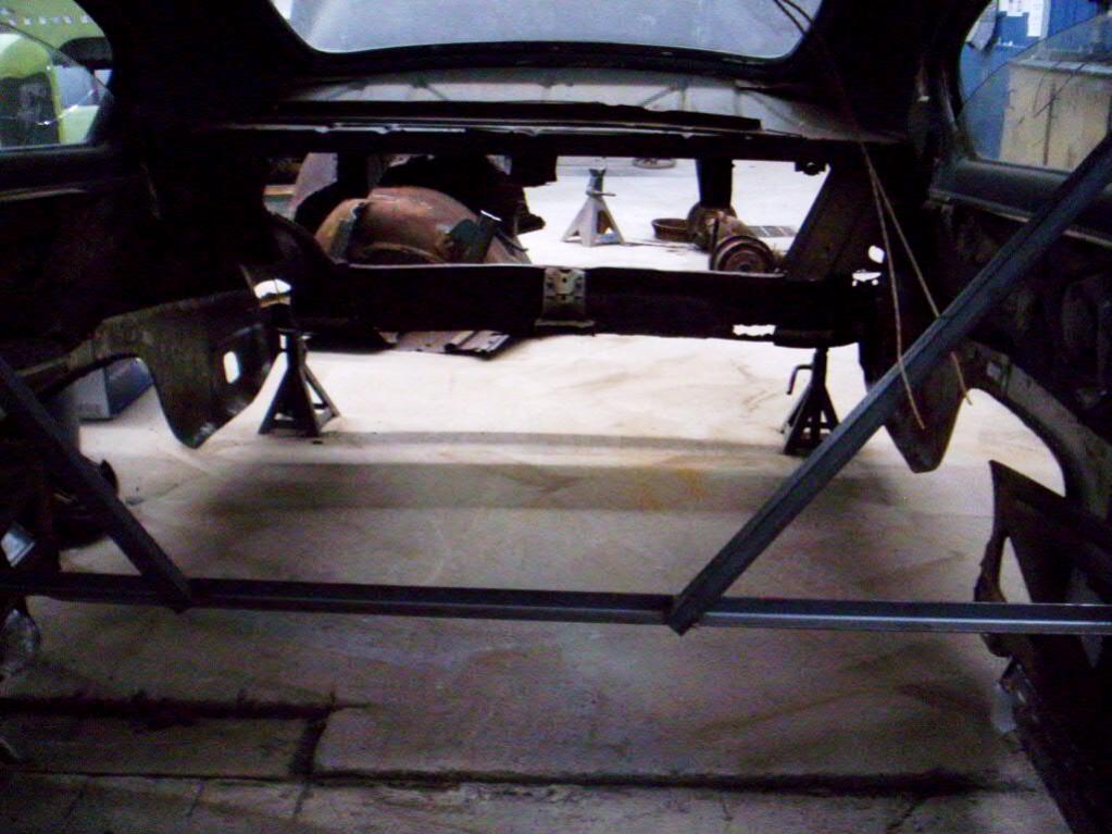

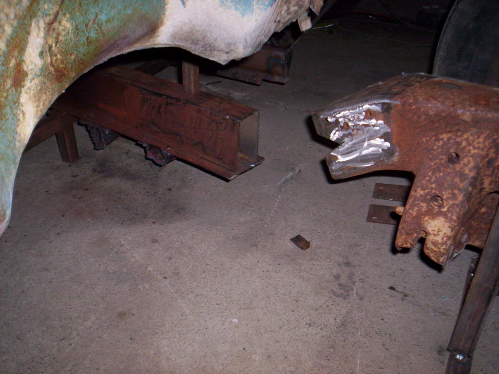

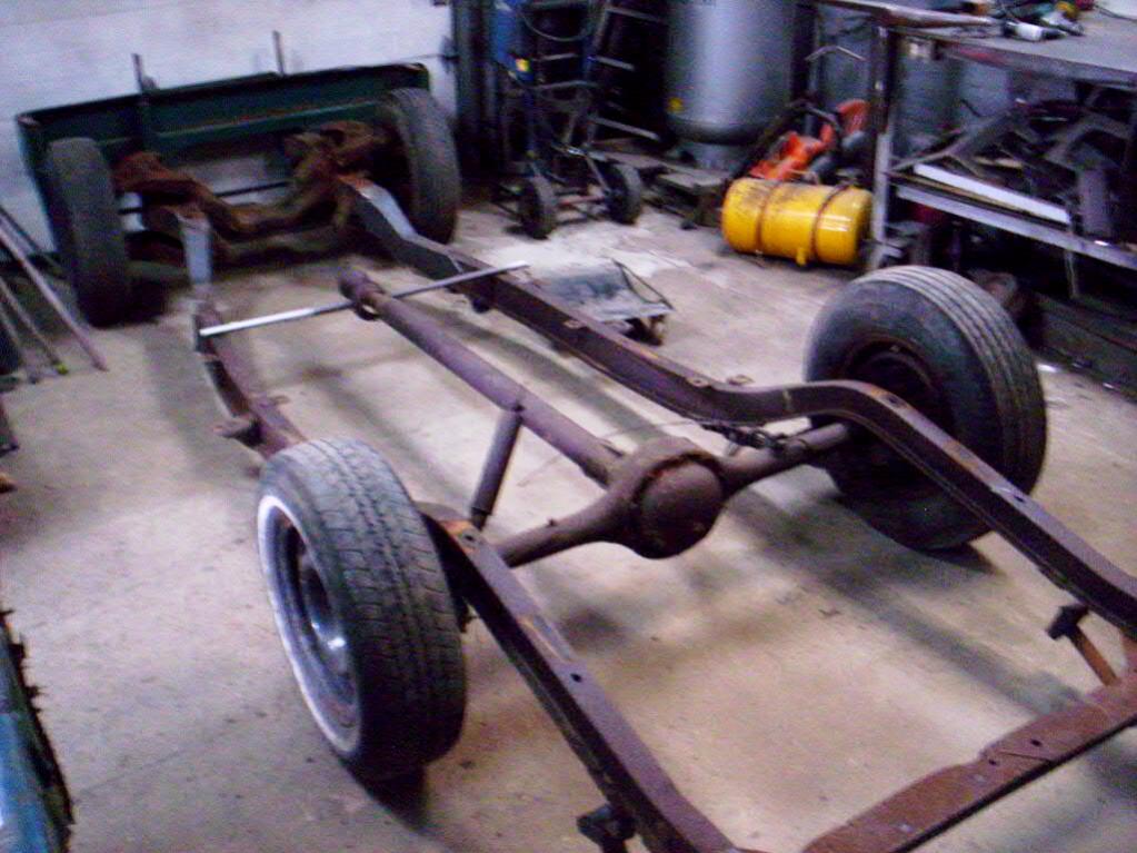

    Not much of a update but i did get something done. Remover old rear end and mocked up the Camaro rear end.Making plans for the set up.Truck arm stile with air ride. Also cut what was left of the old floors out. Almost got all the rust gone!!

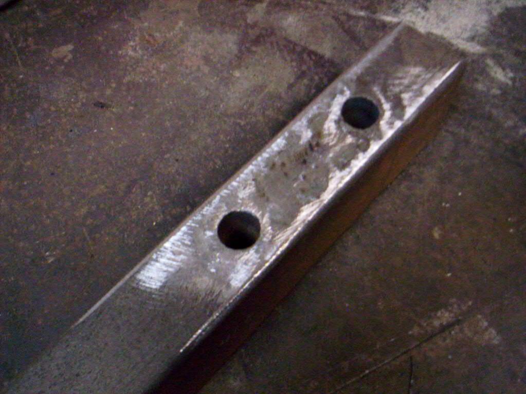

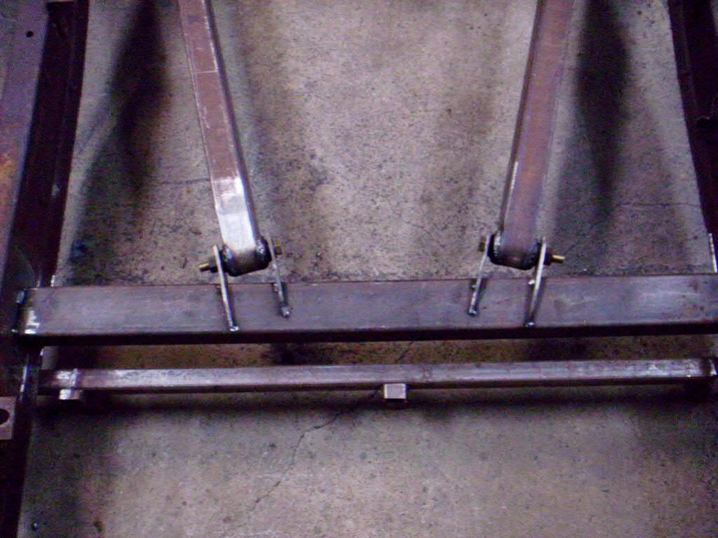

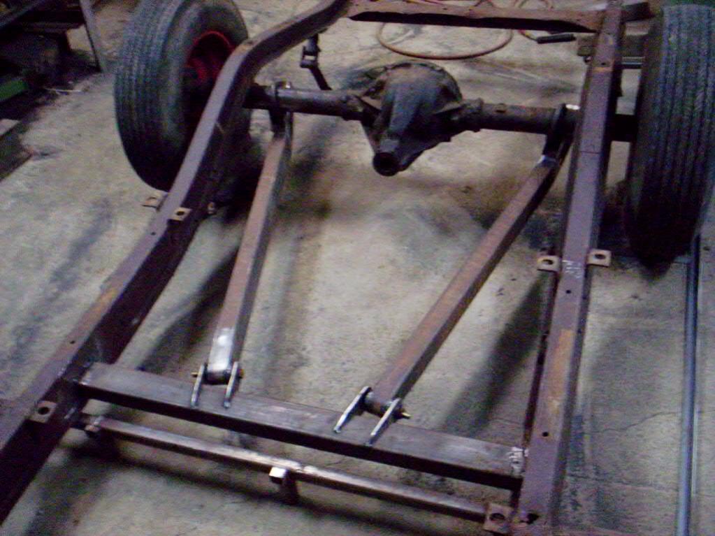

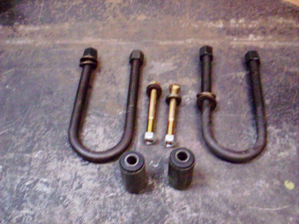

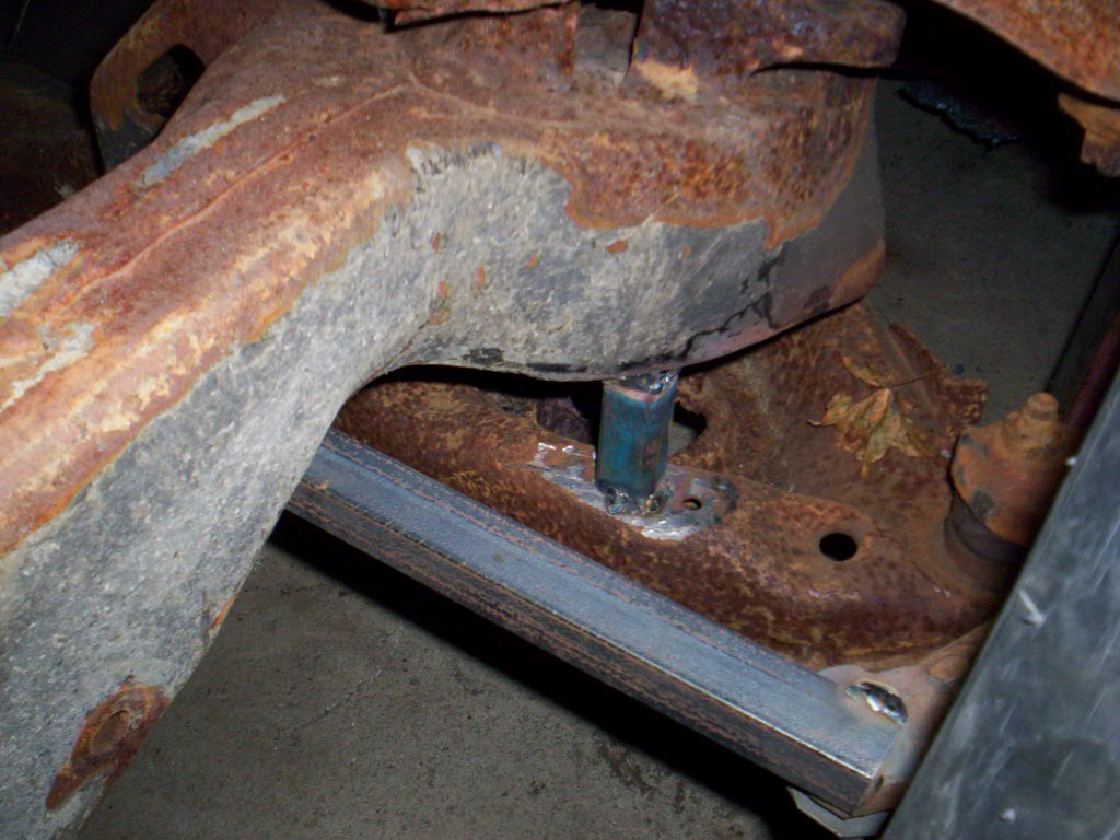

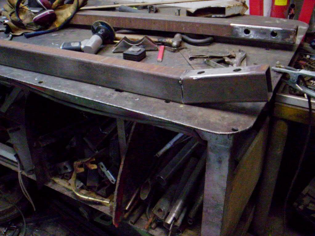

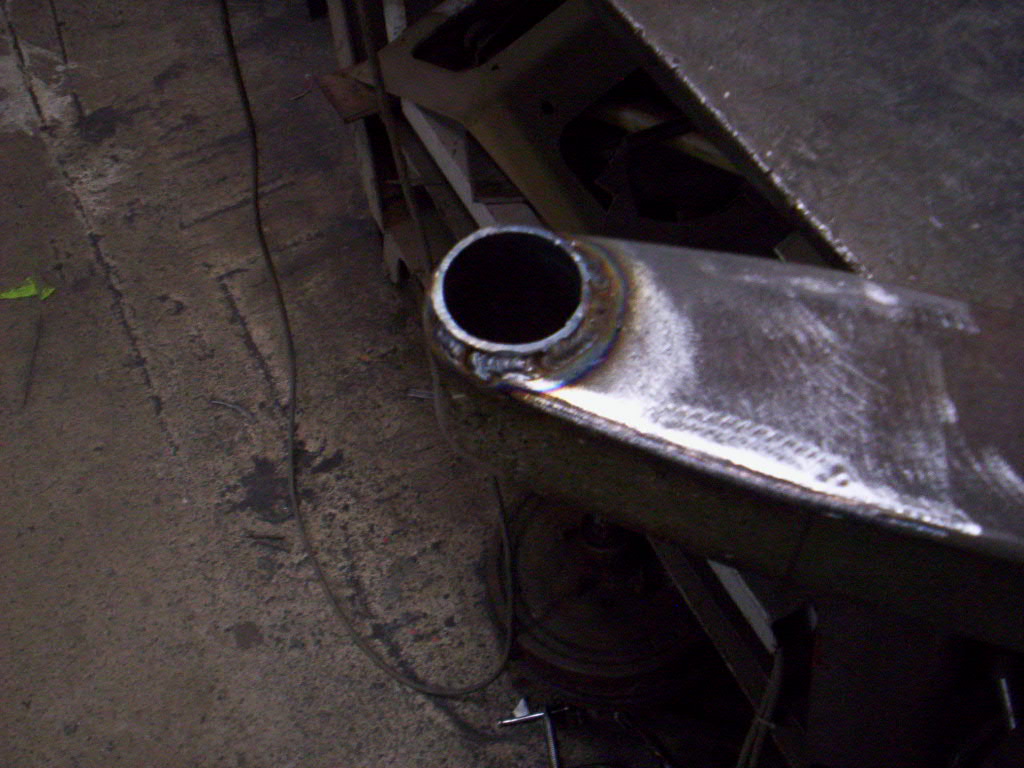

    I spent most of the week doing homework on the truck arm setups. Picked at the arms each night and today I finished them up and installed them. It was a long day so i just tacked them in place I need to take a few more measurements to be happy. Never got too carried away with making this setup fancy.I wanted something simple that worked. After I am pleased and it is all welded up I`ll move on to the C notch.

    Nice set-up Fitzee, what did you use for bushings in the front of the arms?
