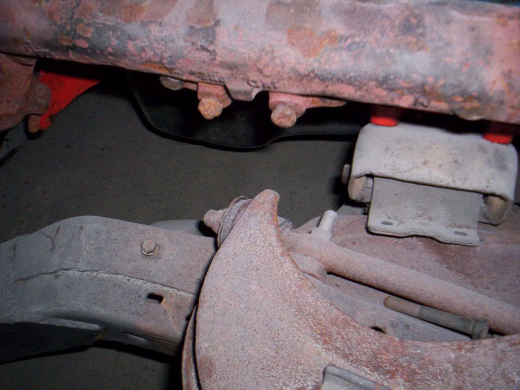

    I picked up replacement bushing for leaf springs from one of our local spring shop. There inch and 1/2. Wanted to get the inch and 3/4 but for some reason the bigger ones were $32 each and the smaller ones were $ 6 dollars each. A bit much for a 1/4 of an inch.

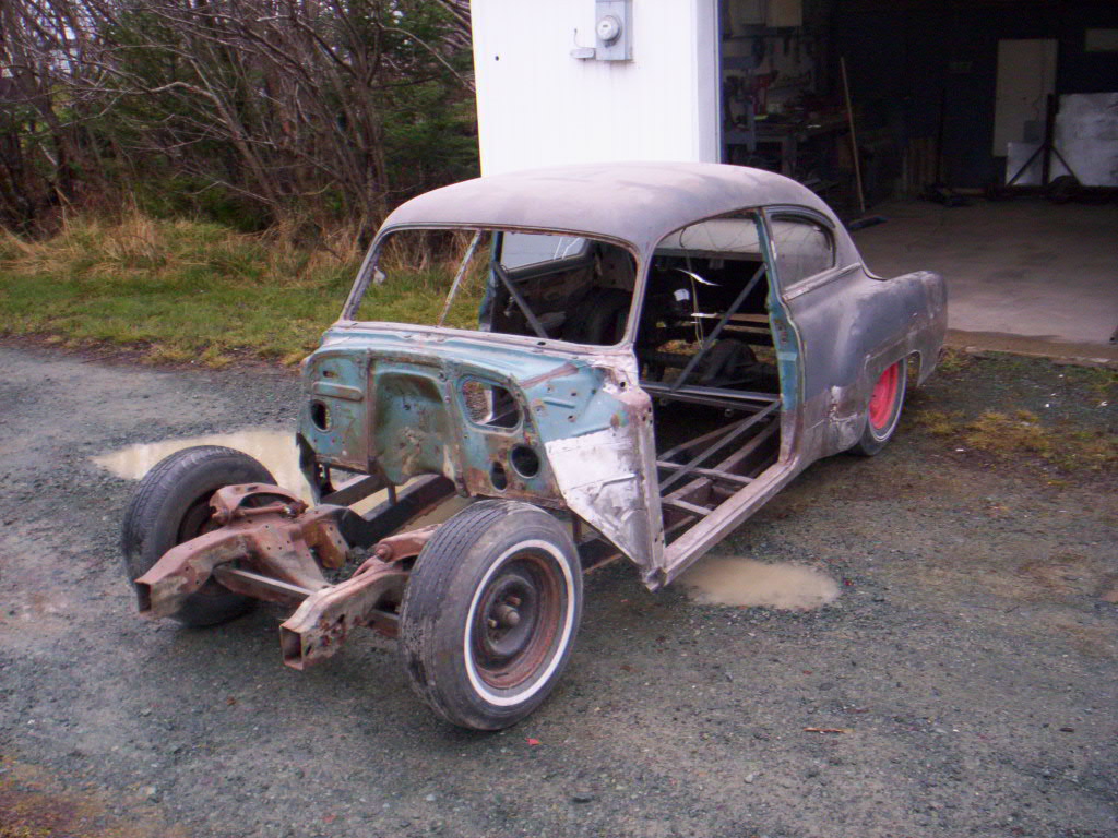

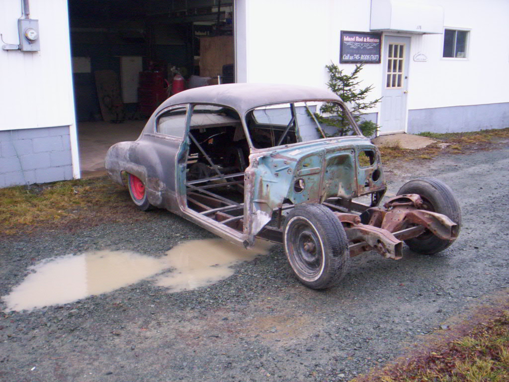

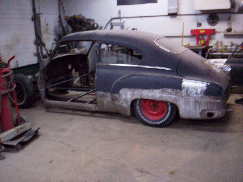

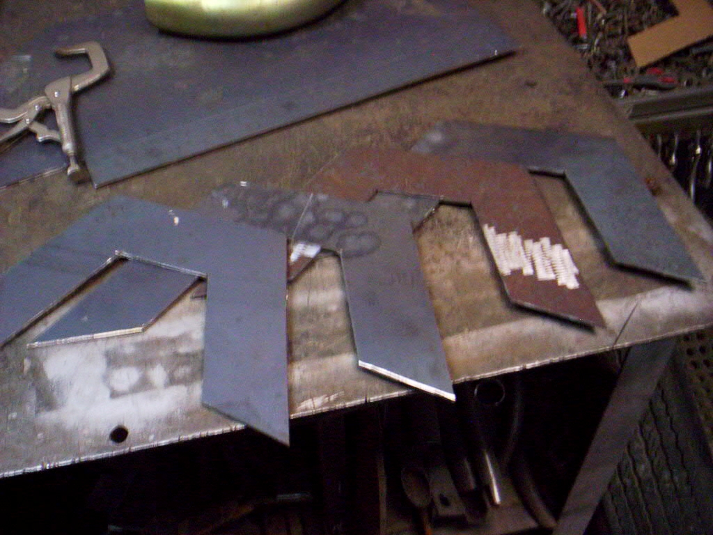

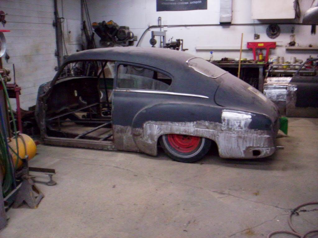

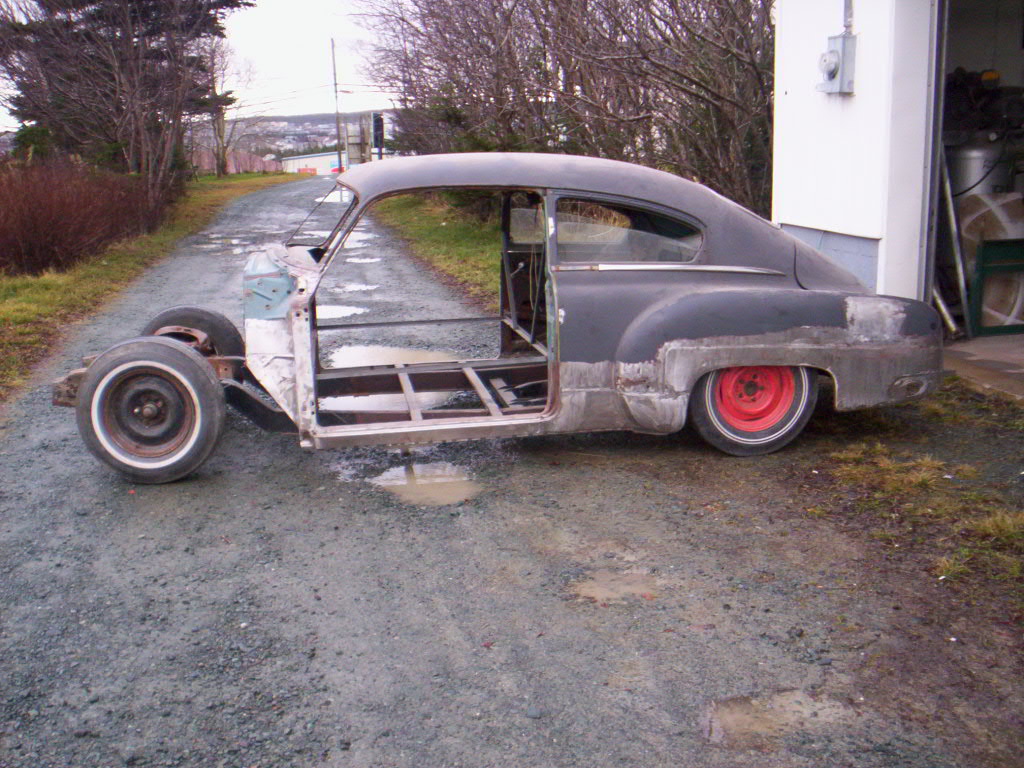

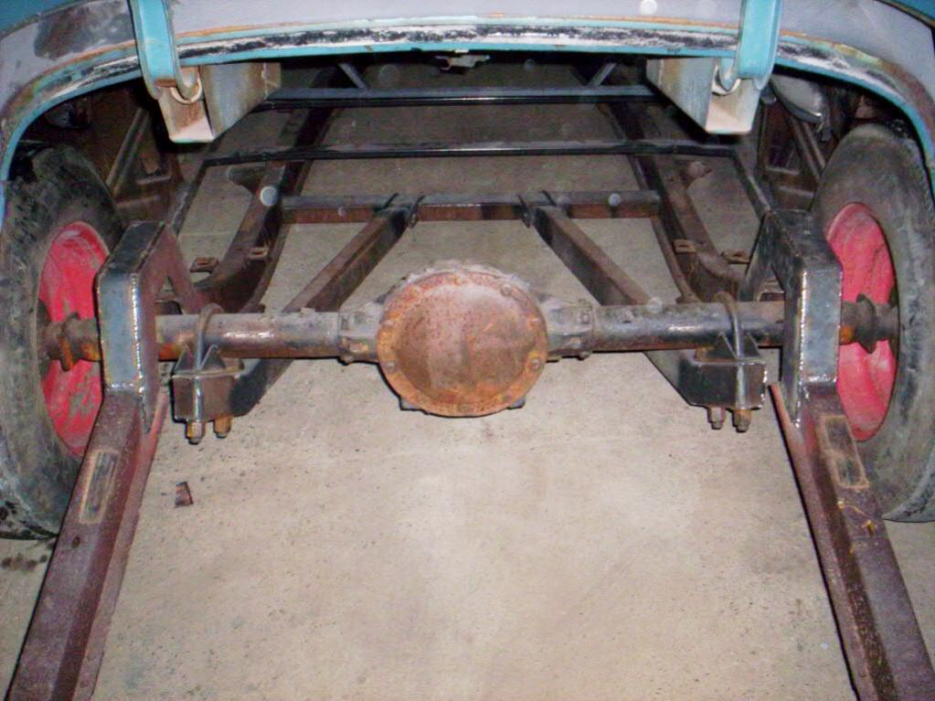

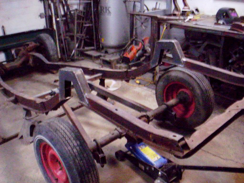

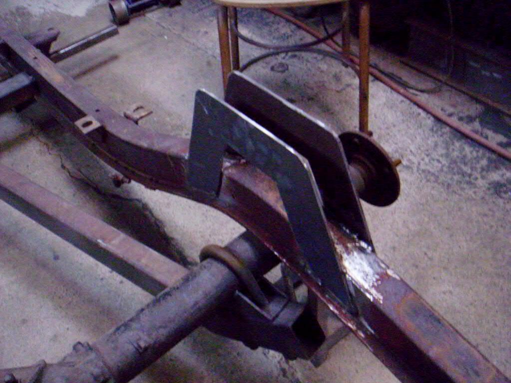

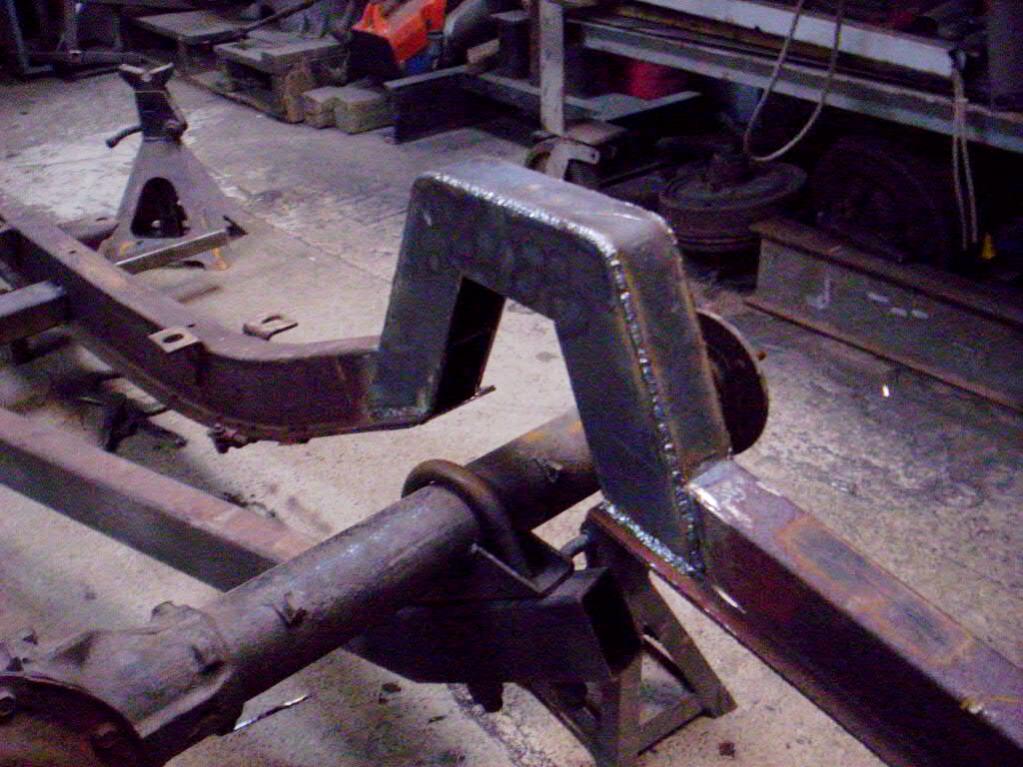

    It has been some time now since a update. Been tied up and busy at other stuff and only got back at it this weekend. It was long over do. I figure out what my C notch was going to look like and cut them out. Welded them in place and cut the old frame out. Much like the front I never finished the bottom side. I want to get a bottom in the main shell and then remove the body and finish the frame then. Had to roll it out by the door for a look.It been awhile since it been a roller with the body on. Didn`t have it a roller for long! Removed the brace I had to set it a ride height in the back and removed the block I had up front. took some cutting both on the S10 frame and the inner body by the tires but I got it to lay frame. So much for a roller!! Next I will mount a motor and trans and set all that up,build mounts and figure out my floors. till next update this is all for now.

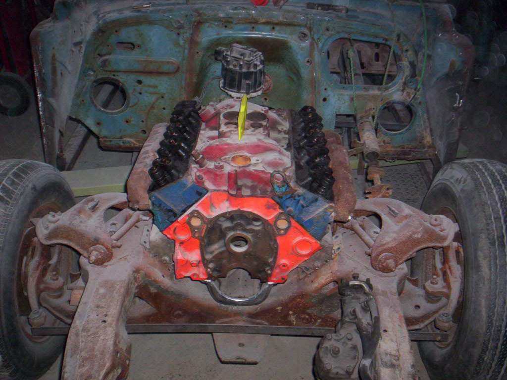

    Not much of a update.Been busy at other stuff. I been at it.Just trying to figure things out.I have a motor and trans mocked up and when I find some time at work I figure out things like exhaust,trans mount, rad,steering, motor mounts and making sure all the parts like fan, fuel pump and distributor will clear everything. Had some problems with fitting a rad but have that figure out.Now my idea for the front body sheet metal has changed.The rad has to be mounted too far forward for my liking because of the narrow S10 frame and the steering box.It will work but only gives me a few inch out to the nose of the car.Had plans for a floating grill tucked inside a opening in the front of the car and this will be changed now to a 56 old bumper.Other problems were, Fuel pump was hitting the frame,have to notch the frame,No I`m not going to run a electric pump!! Also can`t run ram horn manifolds,they bring up in the S10 control arm! So have to run mid 70`s manifolds that dump in the back.Next I will work on the steering column and figure out where that is going to bring up and how to make the linkage for the shifter work.When I have all this ironed out I will mount the motor and trans and then I can attack them floors. So nothing new to see just lots of figuring. Just keeping everybody in the loop!

    Time to make a update. Not much of one but some what of a update. Been playing around with mount the engine and figuring out everything. Final got the manifold problem fixed thats to Bill and some parts he had. Had to run a over the top manifold cause all other manifolds hit the upper control arm.Now that that is figure out I can position the engine so I can make mounts. Also I came across a parts car that will save me a lot of headaches. Because of the parts car I leaning towards a different direction with the car. I will explain as I go. Well that is it for now Get the mount made and off to do floors.

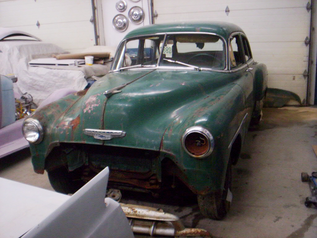

  21. Copper Top
    Joined: Aug 18, 2007
    Posts: 485
    Copper Top
    A new direction? Don't tell us you are going to restore the 52 4dr original!:D:D. It will be interesting to see what you got planned. The 4dr doesen't look too bad, good score. Good to see you got the mount thing sorted out, another stumbling block beaten.
  22. fitzee
    Joined: Feb 26, 2003
    Posts: 2,862
    fitzee
    No nothing like doing the 4 door. Plan is now with having good fenders is just to french the lights and stick with stock grill and bumpers. My old fender were shot around the lights so the 56 olds would fix this. Tring to find ways to simplified the build.

    Fitzee this thing has come a long way . Nice to see your at the drivetrain point . Gotta have it in for sure before the floor construction happens . I am with coppertop that 4 dr looks pretty solid .Good Score . Was it a NFLD car all its life ? It should look like what you started with by now . Go figure !!! Keep at er and she will be a yard runner by the spring .

    Nice to see the motor/trans mocked up! I see what you mean about the manifolds, looks like you got it all sorted out now. Those fenders do look pretty good, most of the ones I saw back in Ontario were ok around the headlights but were almost or completely rusted into two halves where the inner fenders rubber seal touched the out side of the fender lol!

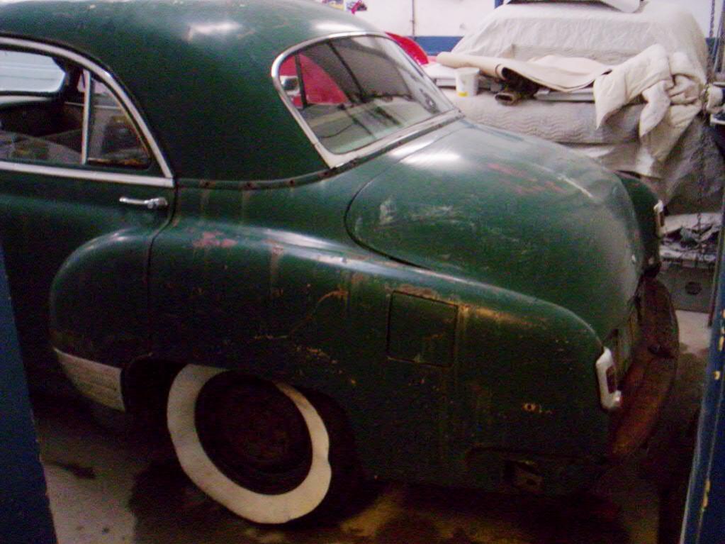

    These fenders have some holes but compared to what I had I only have to replace 4 inch on the bottom instead of 15 inch.lol
  28. fitzee
    Posts: 2,862
    fitzee
    This 4 door was not always a Newfoundland car. I was told it came from central Canada. But from looking under it it might of came here in 1959!!! All floors,rockers are shot. doors are good as well as the frame. Will strip it down to the frame and keep anything that is usable. Have it stored in my back yard for now cause everthing i need off it is cosmetic and I`m far from that yet.
