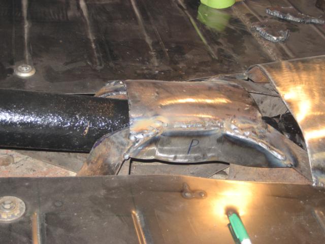

    Been along time coming but I'm working hard to get these done. Still need a little more work. Waiting for the drive shaft shop to finish hopefully they will call tomorrow. If they do I should be able to finish by the weekend. I got all the hard stuff done. I got a slip roll to make the rest of the tunnel.
    heres some pix let me know what you think

    Got the drive shaft today. Put it in and when I went to lower the car down onto the frame. The drive shaft hits the center X member. So Im going to box the sides and cut the top off and weld in a new top. I picked up a 6in pipe at work so Im just doing to cut it in half and that will be my new x member should have it done tonite. Ill post some pix when its done. But heres some to show what Im talking about.

    Problem solved
    back on the tunnel tomorrow
