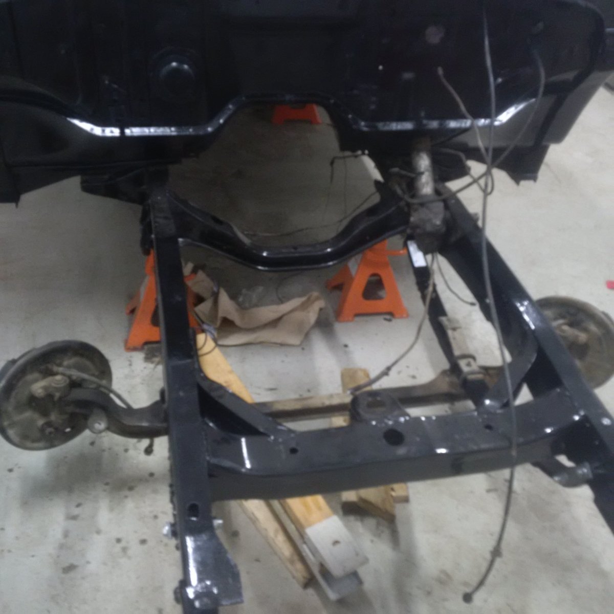

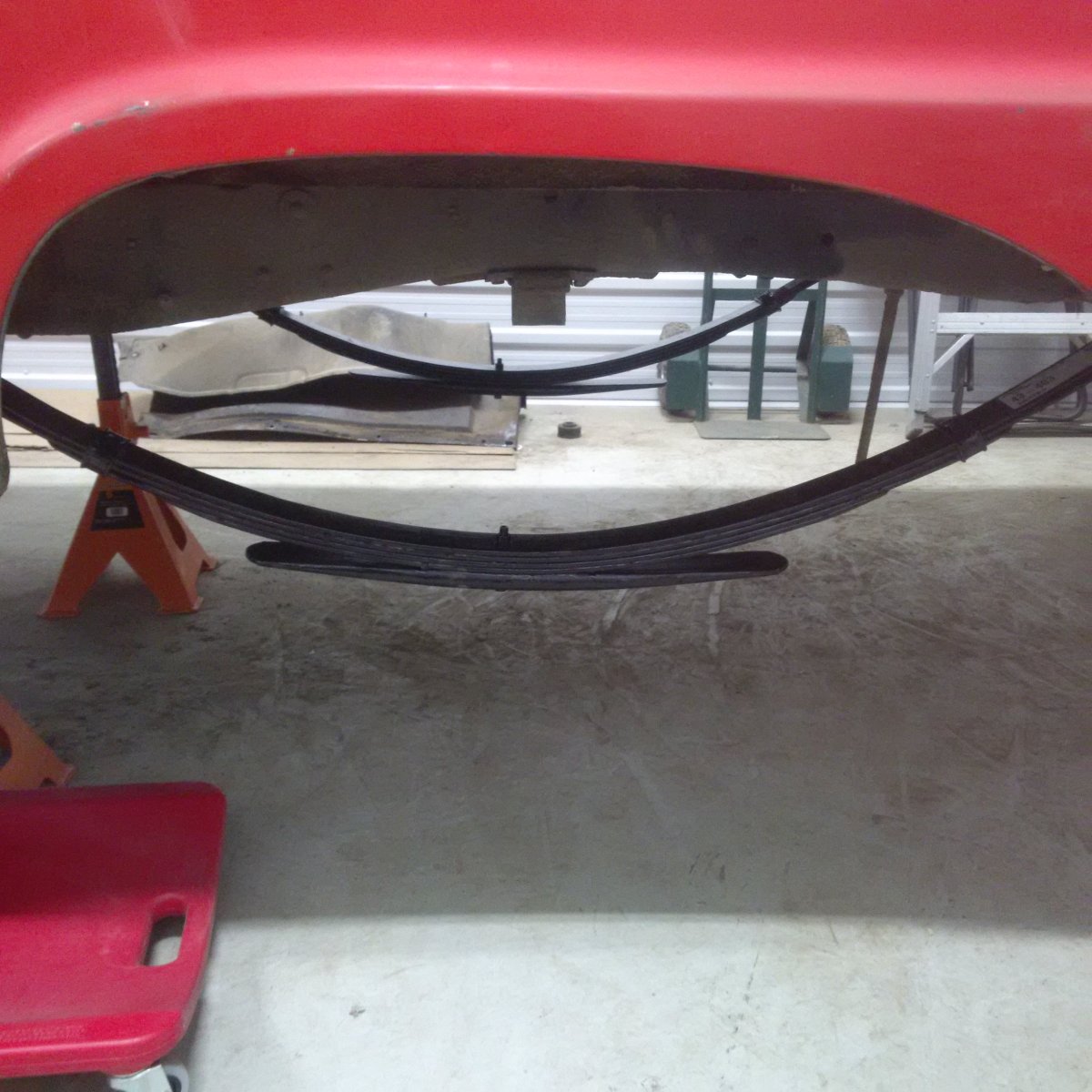

    Finally got the large hole patched in the floor of the cab. Many more smaller ones to go! Will be painting the firewall shortly and the new drive train can go in! Also picked up our new springs yesterday and will hopefully have the rear end back together tomorrow. Should be an active Easter weekend!

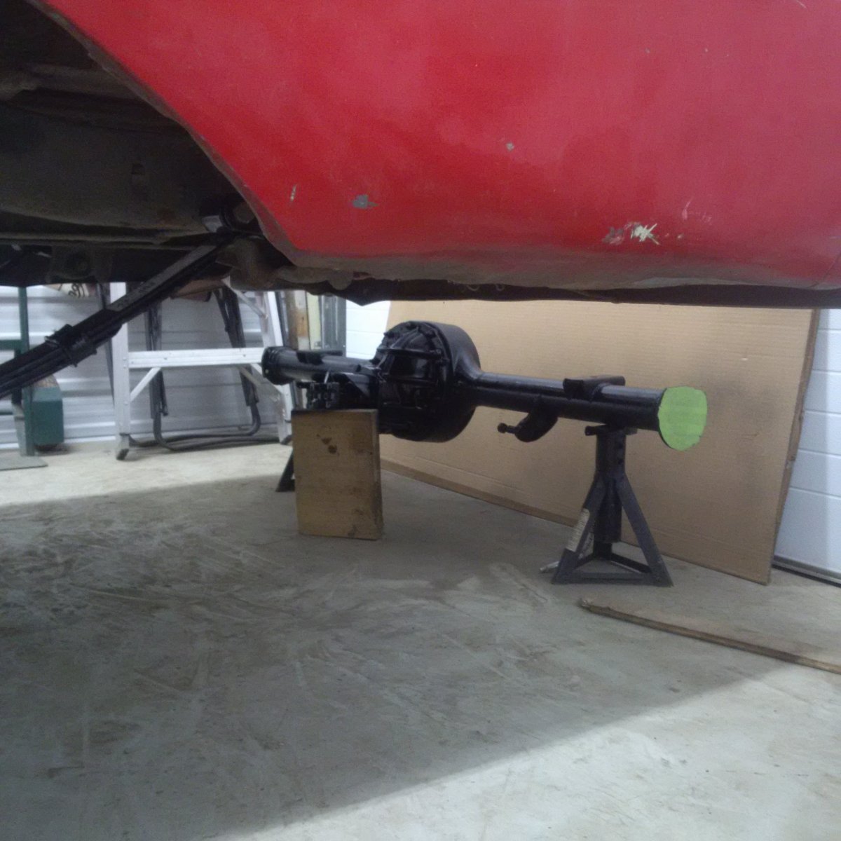

    Got the Steering all hooked back up and rear springs hung. Also finished painting the rear end & axles. I have re-hung the rear end last week. Going to slide the axles in tonight and FINALLY get the motor and transmission in this week. Little hang up with bolts to mount the transmission.

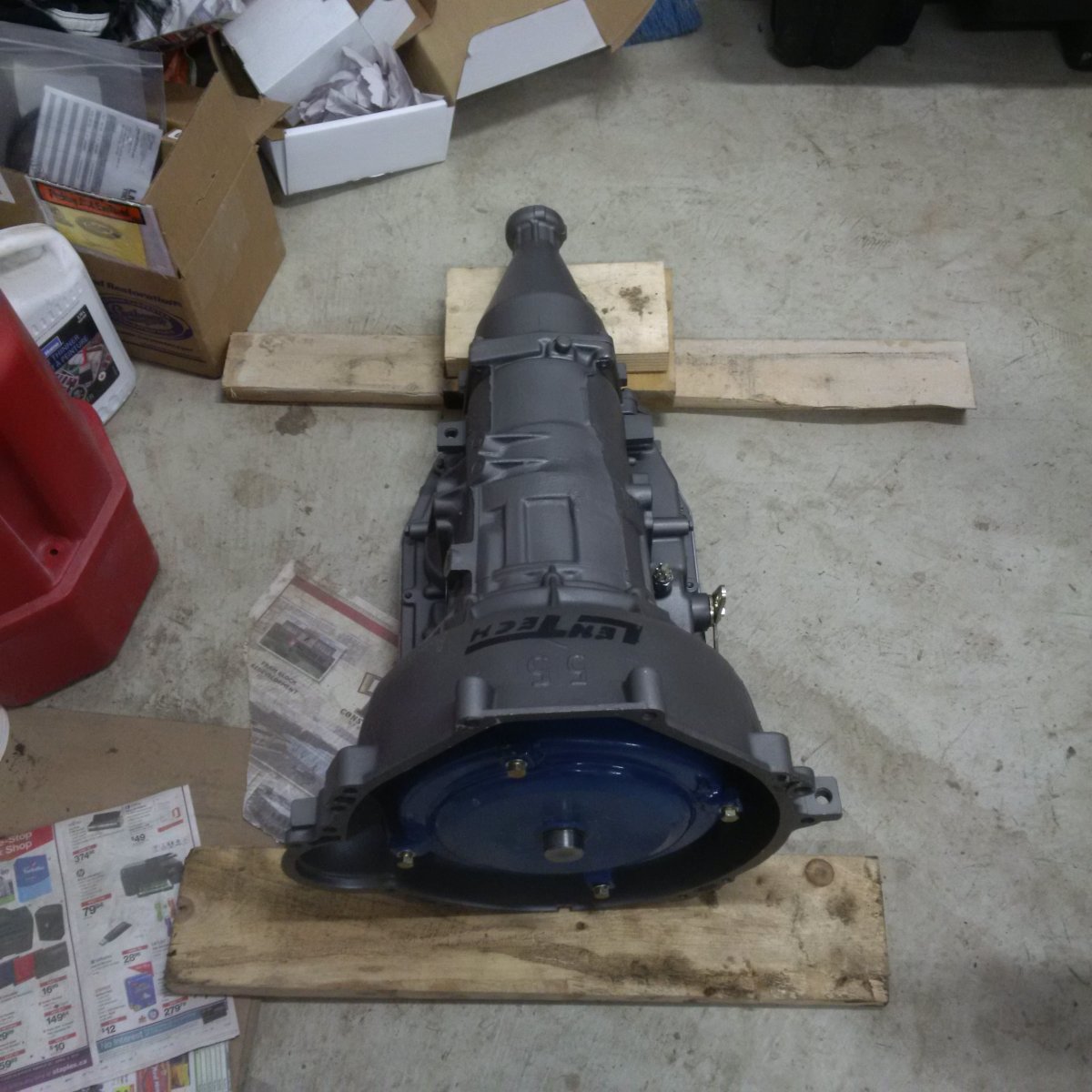

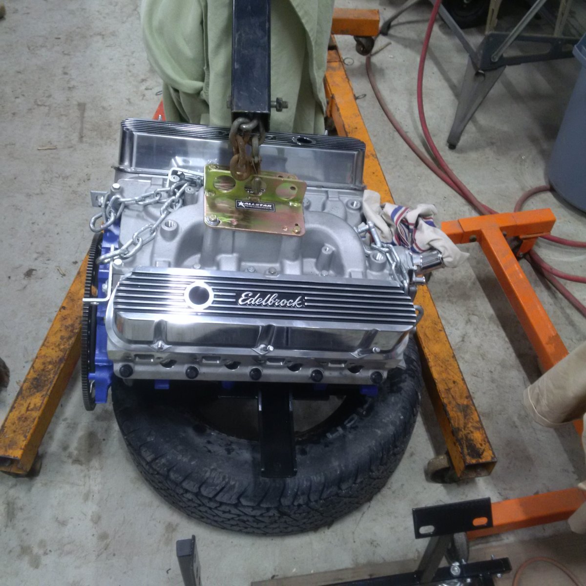

    Made a little more progress last night. Have the front shock towers all painted and reinstalled. Got the engine off the stand and lightly bolted up the flex plate. Unpacked the new Lentech AOD Transmission and reinstalled the rear axles and backer plates for the rear drum brakes.

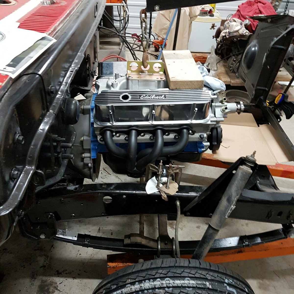

    Motor & Transmission are finally mocked in. Now I need to worry about my clearances. Anyone else out there done this before? Need some help making sure I have it in the correct spot!

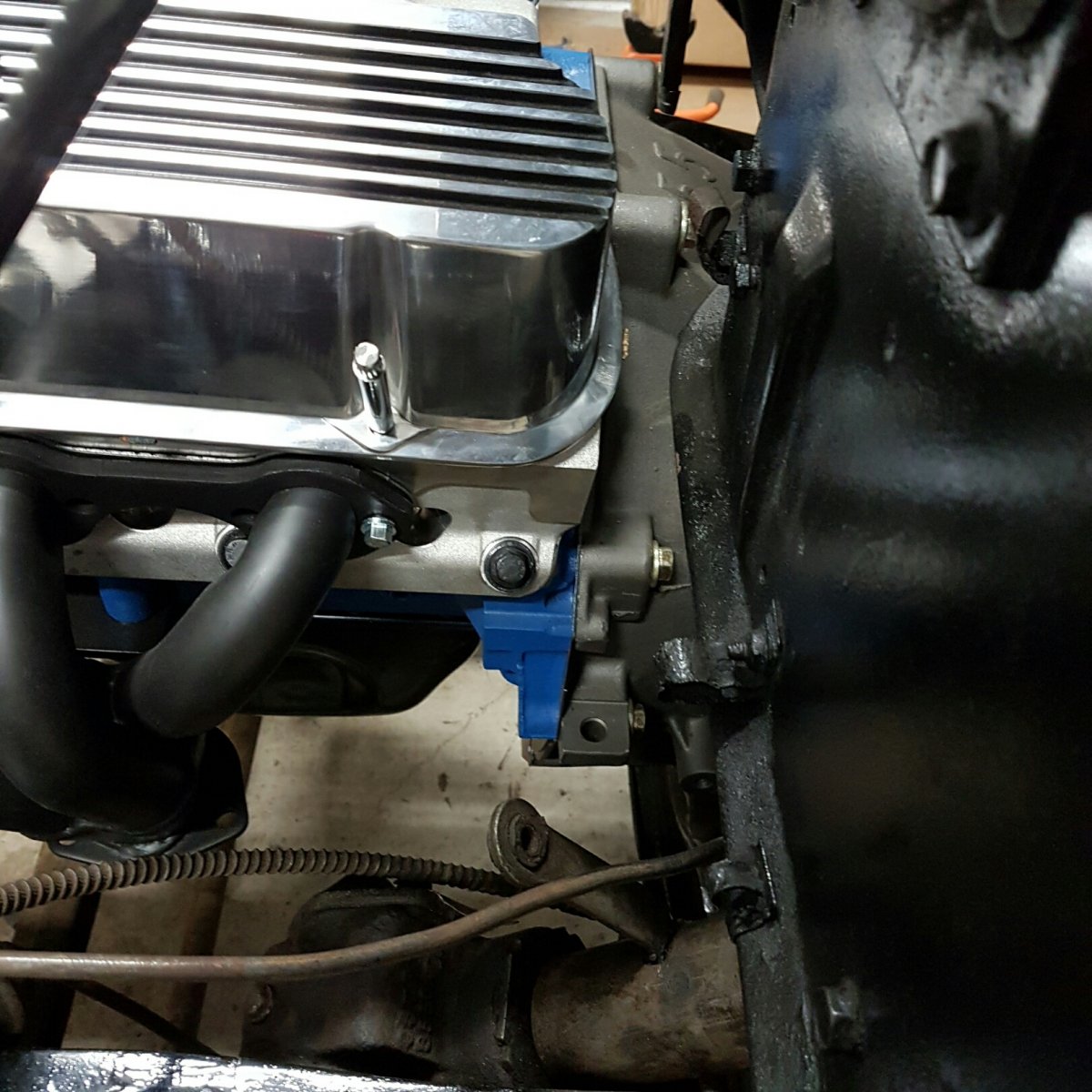

    So I have admitted defeat on this truck being completed for our wedding. Just seems nothing wants to work for me now with the motor and transmission. Can't seem to get my clearance right with the firewall so it gets over the old cross member. Can't seem to get the right angles for the engine and transmission for the new transmission cross member. As well I have ran into an issue with the headers now clearing the steering box and gear selector. Returning these JBA headers, originally had a pair of Sandersons but the drive side interfered with the motor mount. I think its time to take it to a shop and get the drive line installed professionally. Anyone out there able to offer some helpful tips or advice? Or anyone want to buy it now? haha

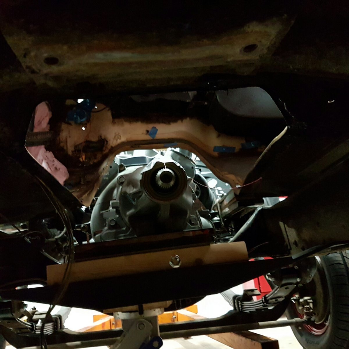

    Well I have finally mocked up where the engine should sit. Put the truck back on its wheels, clamped in the engine and added weight to mimique the sheet metal. Have about 1.75" of clearance on the driver side and the firewall. Little concerned about the transmission cross member, seems I have to raise the tail stock 2.5" so my carb sits level. thinking I will get some shims machined for under the cross member & frame and then under the transmission pad.

    I think youd be safe with your carb on a 1 degree slope. Itll have more than that going down the road

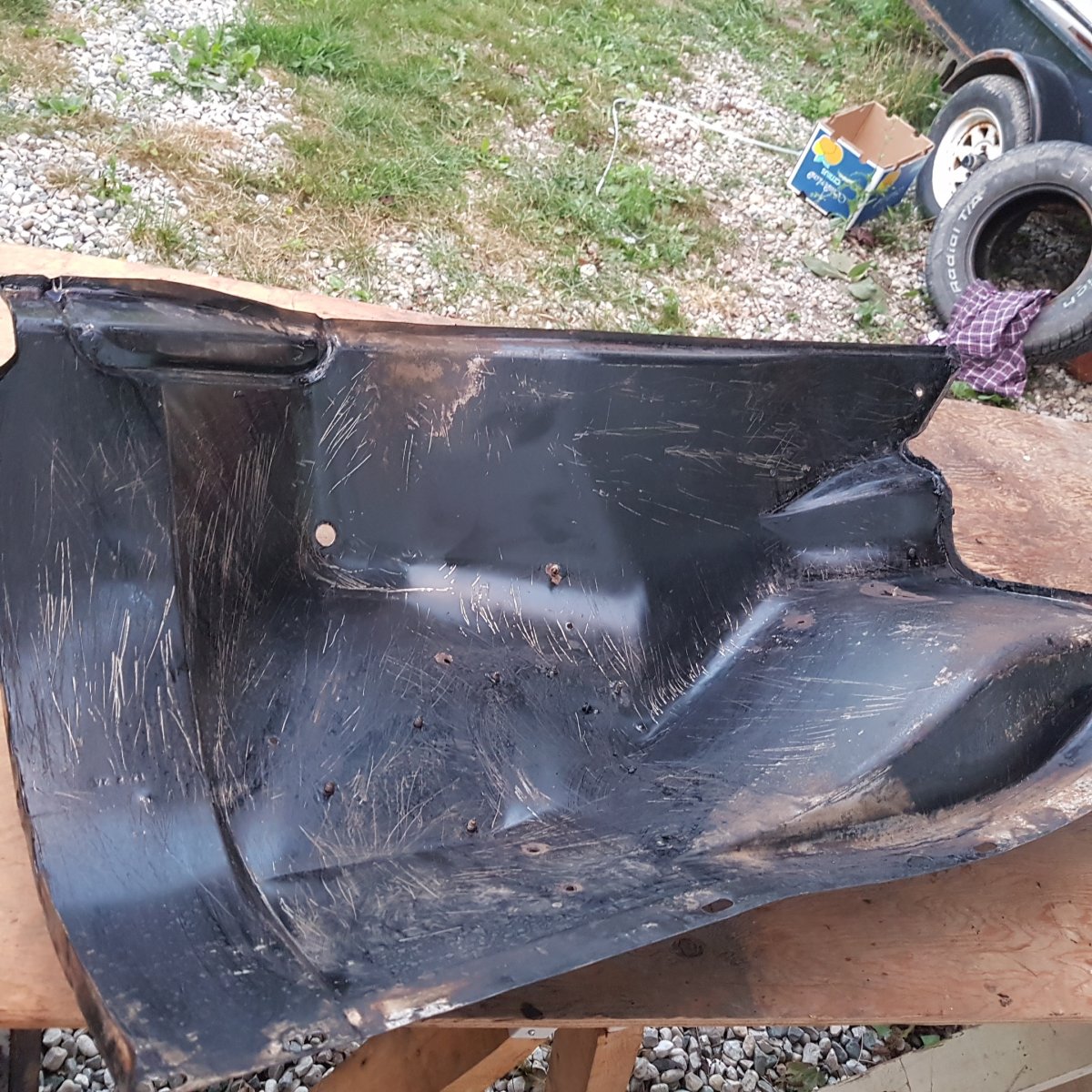

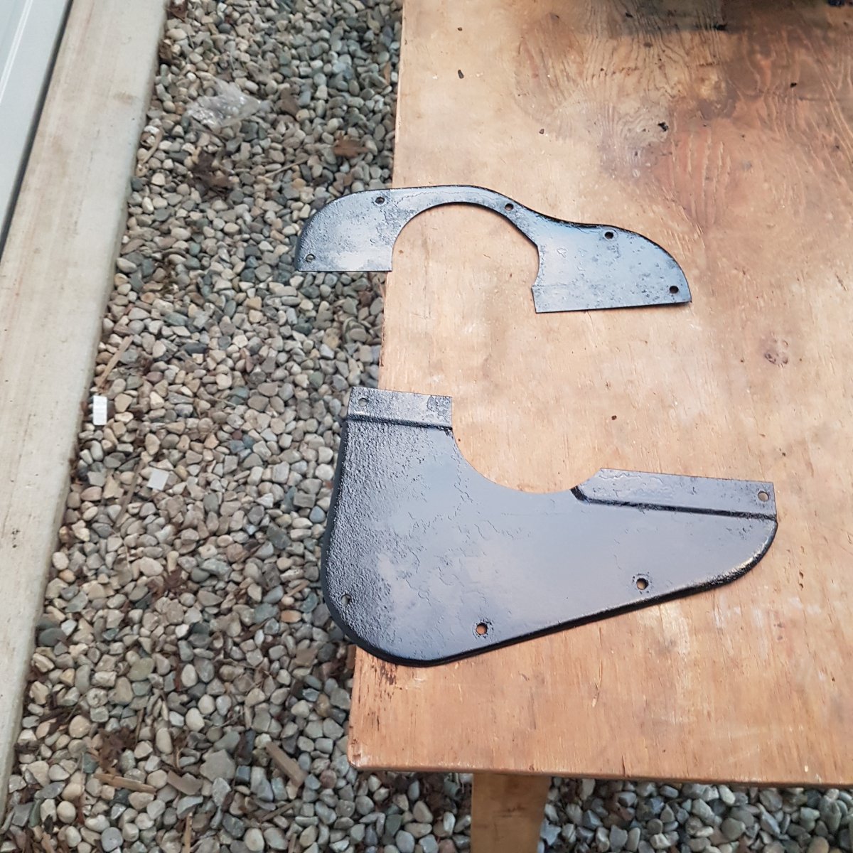

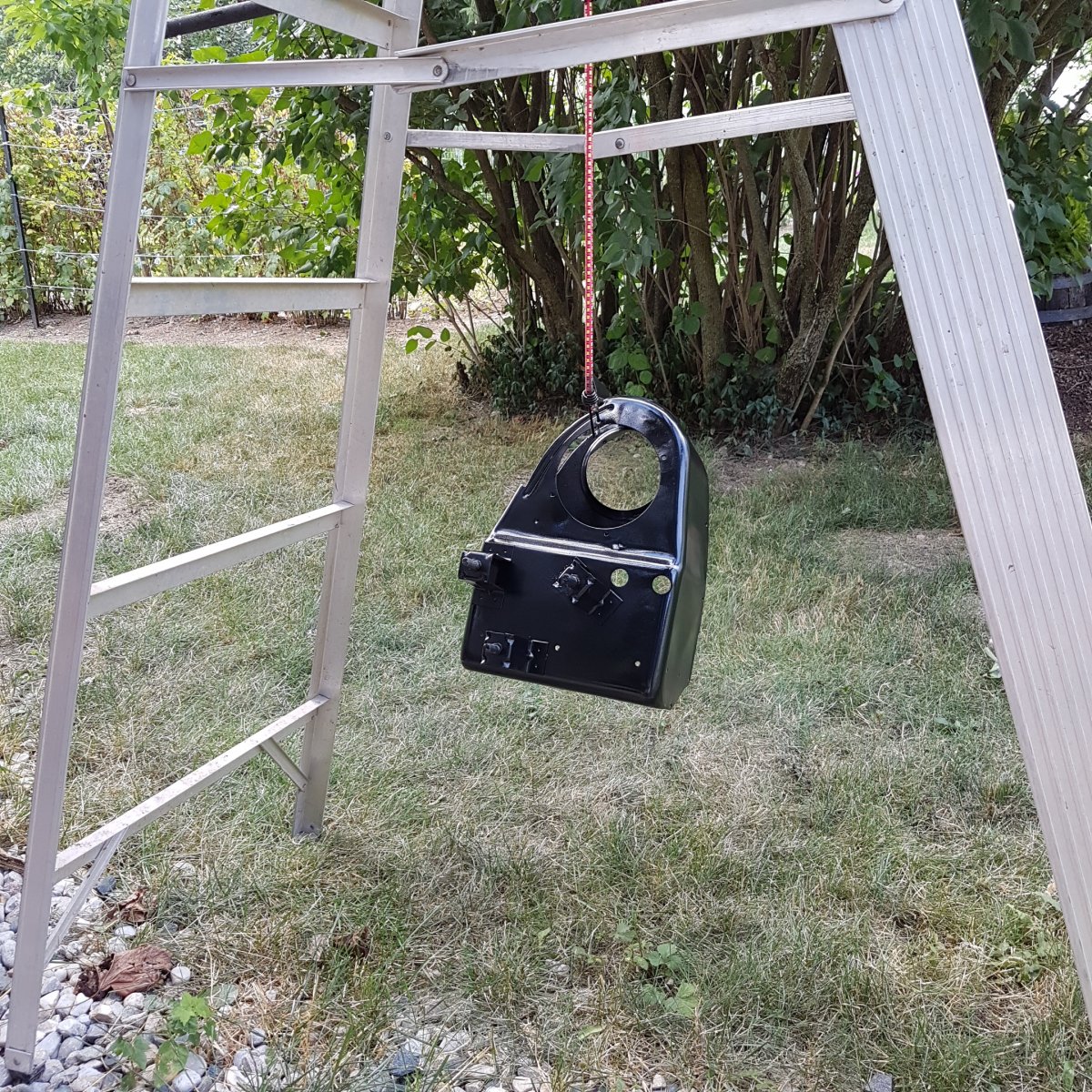

    Well yesterday afternoon was a s****ing, varsol soaking, some more s****ing and then washing of body parts & heater box. Redoing the heater box making it shiny again. The old inner fenders are a pain to s**** the 1/4" old under coating off, but I finally got it off. May try a little heat on the next one, see if that will help. Going to prep them and paint them with POR15.

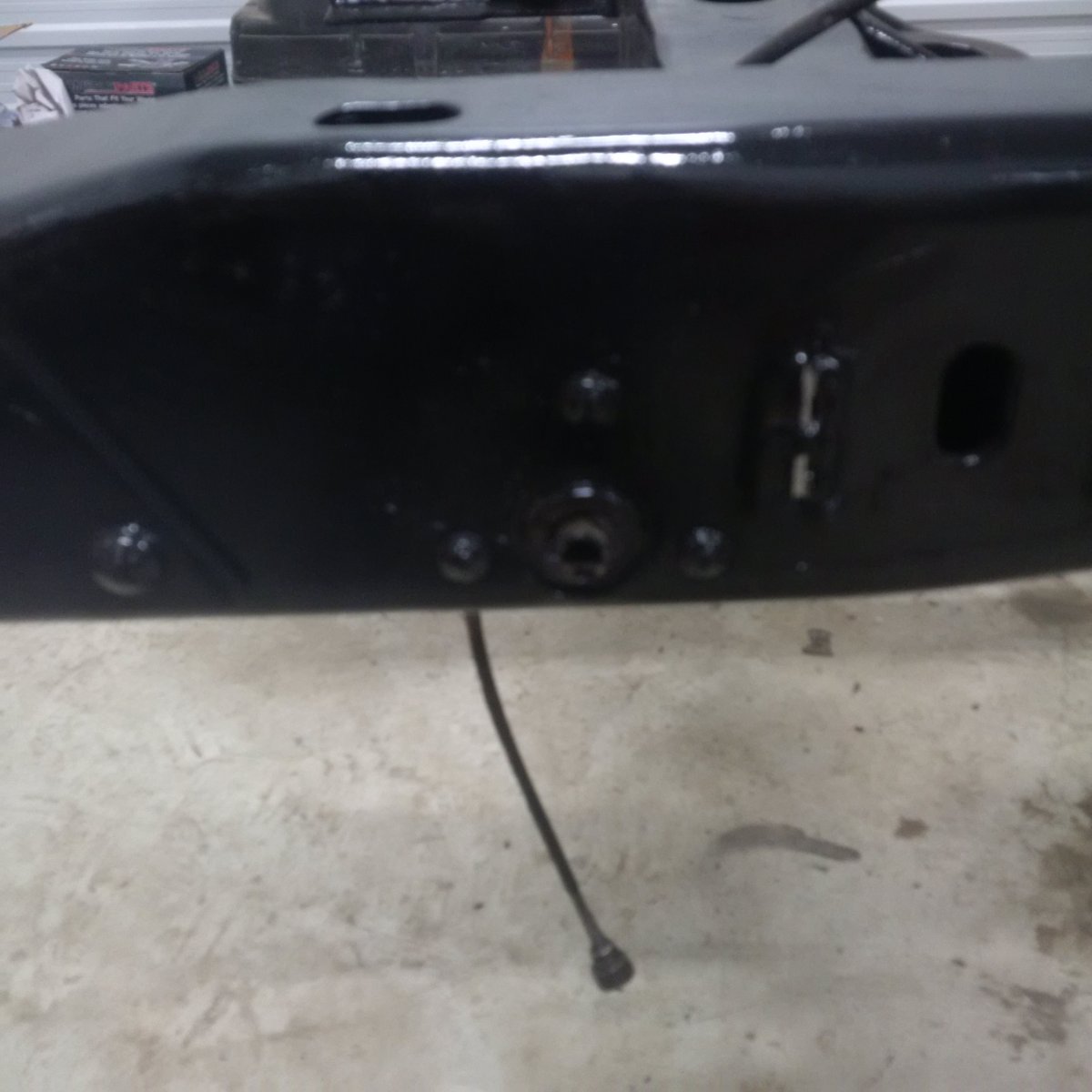

    As for the drive train my father in-law and I got it all settled last night. Getting the new transmission cross member made today. Once that's done I can finally mount the motor in its final resting place and move forward.
