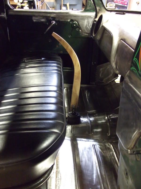

  24. Well Ive been working on the truck alittle over the last couple weekends so heres an update.
    First i finished the floors by remaking the front of the seat pan area.
    Then I bought a set of front fenders off of Skull on here, and started fixing the rust. The back edge full of rust and the mount was gone so i cut that part out and used the old fender to patch it, also the front corner was gone so i made a new one. I also removed the rivets that hold the mount to the fender.
    And all welded and smoothed( both are done, just no picture of the other one up close)
    Next i got some G78-15 tires and wheels on it to make sure it sat low on there proper height tires and throw a fender out back to see what it will look like with the rear fender lip modification done.
    Next i modified the shift lever so i can bolt on a custom shifter when i make it, then i built one out of wood to see if it works and looks good. Heres what ive come up with, there will be speed hole in it and it will be chrome when done.
    what do you guys think?
    Justin
    bengeltiger likes this.

    nice work very insperational

    Really nice fab work.I like the idea to match up the wheel wells.

    Oh Yeah. Nice repair work, and laid out looks good...Jim
