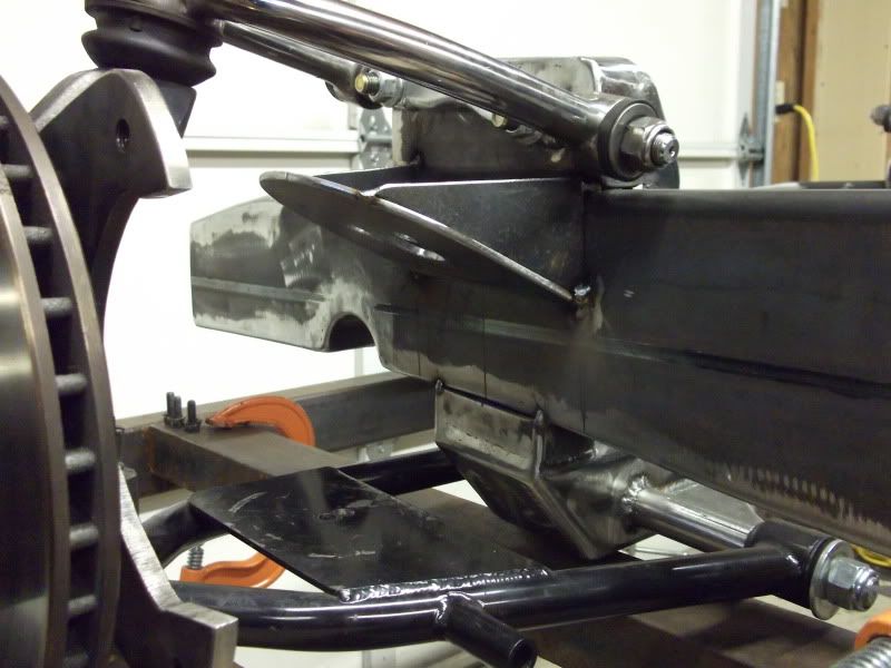

    im kinda new to this but, why did you put the upper control arms at and angle?

    Thanks man, actually both the lowers and uppers are on an angle. The uppers are on a little more of an angle. they were this way an the old frontend, its for caster or anti-dive cant remember for sure...

    I haven't seen front upper arms slanted like that before (but I haven't seen a lot of things). Is that normal or do you need it that way because it will be bagged?

    As for the angle on the upper control arms, its for anti-dive. Helps keeps the car level when your slamming on the brakes and transferring all your weight to the front. The amount varies from car to car, usually the less suspension travel you have the less you build in. Road race cars usually have 5-7%, factory stuff can have as much as 30% built in (think, 70's station wagon).

    Well i got to work on the frame last night a today, got the bag mounts made up front. Had to get 2" drop spindles, so i got those installed mocked up the rack to make sure it would fit. Also got the frame gussets cleaned up and tack where there suppose to go.
    Anyways heres th pictures...
    bag mounts
    rack mocked up
    And the frame gussets tack on
    Justin

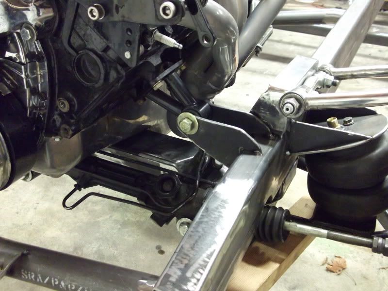

    Well made some progress last night and today. Got the frame gussets welded last night, and today i got the motor in place. Had to make the motor mount tabs and the ****** crossmember. Also picked up a new rearend housing for it since the old one is to wide.
    Heres the pictures...
    Gussets welded (Lots of welding)...
    ****** crossmember i fab'd up...
    Motor mount tabs....
    Motor in place...
    New rearend housing, still needs cleaned up (about 4" narrower then the other one)...
    What do you think?
    Justin

    Everything just keeps looking better! Awesome work. And that's some seriously nice welding with the 140, just goes to show that even a 115v welder will take care of a lot of work!
