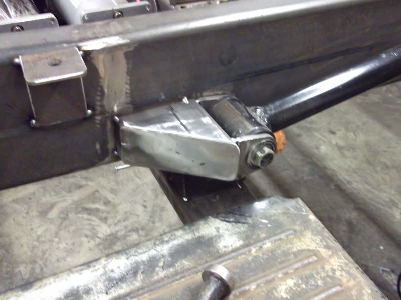

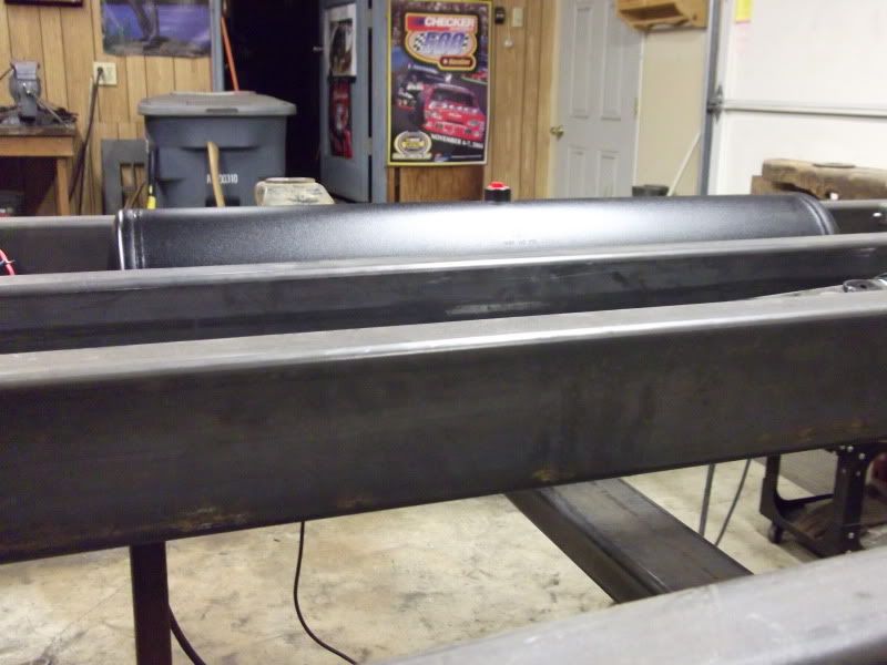

  1. Well i made some progress on the frame this weekend. Got my air tank mounted. I capped the lower link frame mount and mounted both front shocks. Still have to mount the rear shocks but i got there placement figured out.
    Here are the pictures.
    Air tank mount
    Lower frame mount capped
    Front shocks mounted
    More later................
    Justin

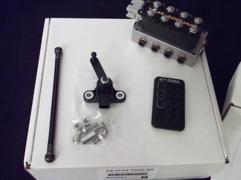

  6. Well I finally got my ACCUAIR E-level touch pad controller and VU4 manifold valve. All i can say is Wow this stuff is very nice. Thanks to Nate at Porterbuilt.
    Heres the pictures
    Full color manuals
    Touch pad comparison with my Blackberry storm
    Cant wait to get it installed and ride with the system
    Justin

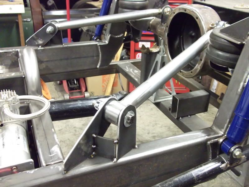

  7. Well I decide to change the upper wishbone to a triangulated four link, didnt like the long front mounting tabs. Also Got the rear shocks mounted to the lower bars. As well as made the mount for the accuair vavle and i've started the computer mount.
    Here are the pictures...
    Rear Shocks
    Accuair valve mount
    Whatcha all think?
    Justin

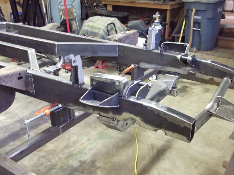

  20. I redid the accuair valve mount cause i didnt care for it resting on the driveline hoop. I also got the lower link end changed out to rod ends, and got the third member in to check driveline clearance.
    Heres the pictures.
    valve mount and computer mount...
    Link ends...
    third member in...
    Justin

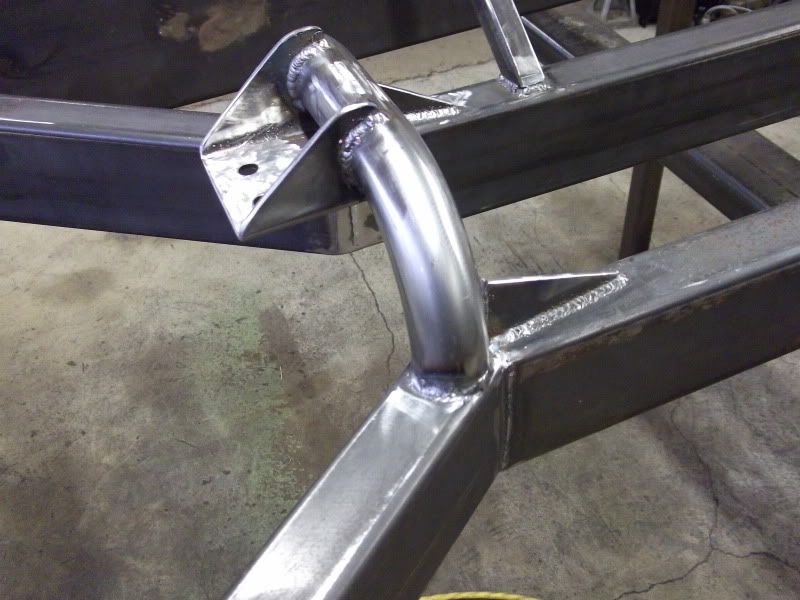

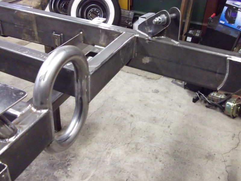

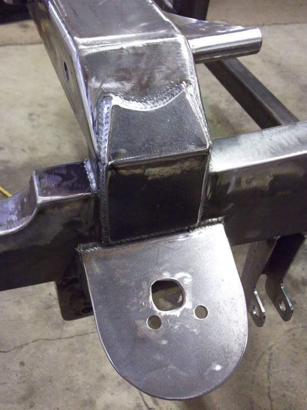

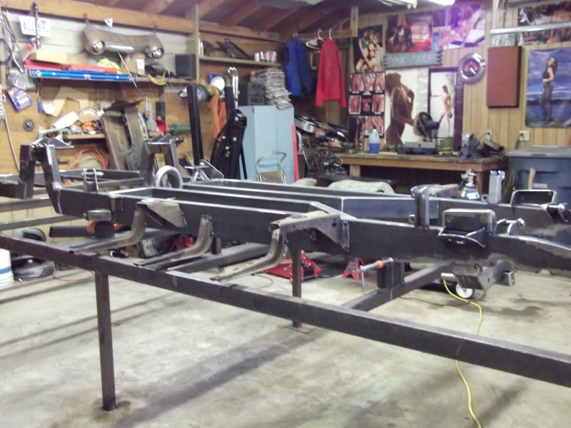

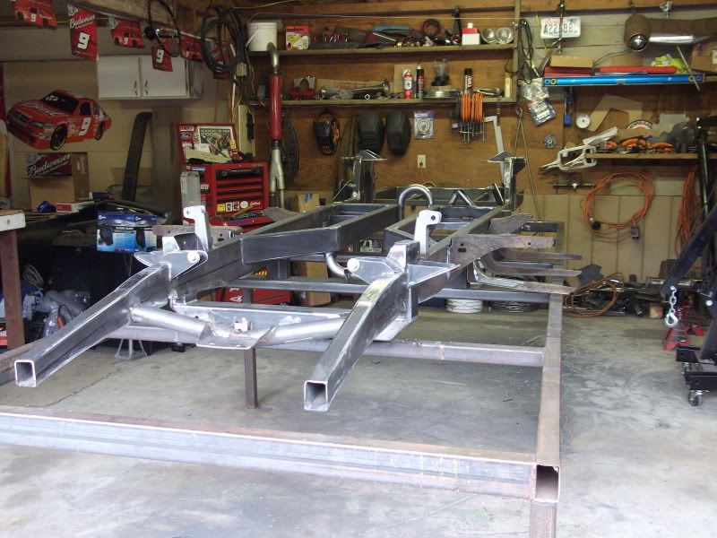

    Well heres a good update! I got the ch***is mocked up and fully welded. Also got the front frame horns finished. Got the ch***is off the table and almost nocked back up. Need to get rear drums and put the rack in upfront and then it will be a roller.
    Anyways heres the pictures....
    Full mockup
    Torn down....
    Heres some close up of the gussets and it all welded...
    (hole have been rounded)
  28. Front frame horns...
    What you guys think?
    Justin
