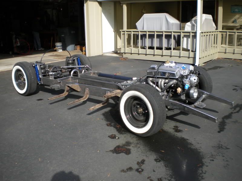

  15. Well i finally finished the rear body mounts so they would support the cab weight. Got the cab set on and bolted down. Have to notch the rear of the cab for the driveshaft and tub the firewall. Also set the front end on there to make sure it fit right.
    So here are the pictures of the ch***is out side...
    Body mounts gussets...
    Cab on and about ride height ( will be about 1" or so higher)
    Front sheet metal just setting there...
    Whatcha think?
    Justin

    Awesome work! Looks great. That thing will be back on the road in no time!:cool:

    always loved your truck. what is great about this build is that you had a finished truck laying on bags, bt then over the years your skills got better and you decided to take it to the next level.
    Top marks for the decision. you have all my respect. Now drag that ****er!

    I have a similar project going, although my frame doesn't look this nice for sure.
    On my rear airbags, I was told to use the cone style instead of the bellows style for the rear. Something about the range of motion on the cone style would allow for more rear suspension travel than the bellows style. I have a 4-link and a panhard bar basically. My bags are mounted wider out towards the wheels, relative to yours as well. Just what I was told, seemed to make sense at the time, but with you using the bellows style in the rear got me wondering if I was told some wrong info.
    Don't have a picture handy
    What say ye?

    You have sleeve bags and yes there better for a over the axle setup. they have better lift aswell, be thinking about switching to them actually. just make sure you limit there travel.

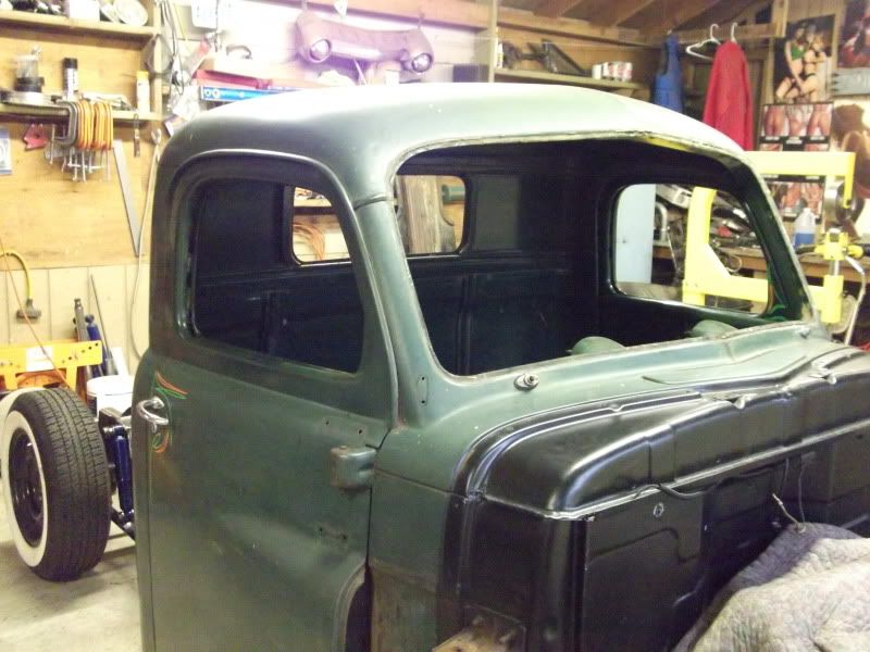

  28. Well I got all the windows out and started on the rust repair and dent removal on the cab, Also shaved the cowl line. Next i hope to fix the sagging drivers door and then on to chopping the top.
    Heres the pictures
    Gl*** out...
    Dent/cracks inside drivers door...
    Lower drivers door rust...
    Spot light holes fixed (no before shot)
    Cowl lines filled...
    Gas filler hole shaved...
    And last but not least my crude photoshop of what it should look like chopped, Im thinking 5 1/2 up front and 4 out back...
    Justin
  29. thanks bud, ya i have the chop thread in my favorites. Ive looked over it a couple times.
