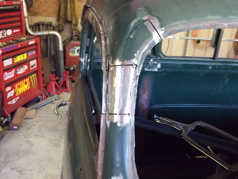

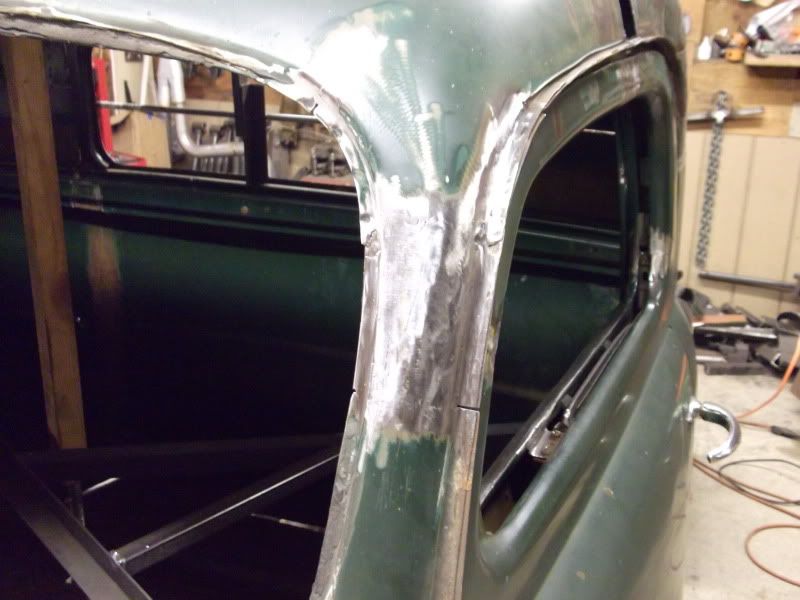

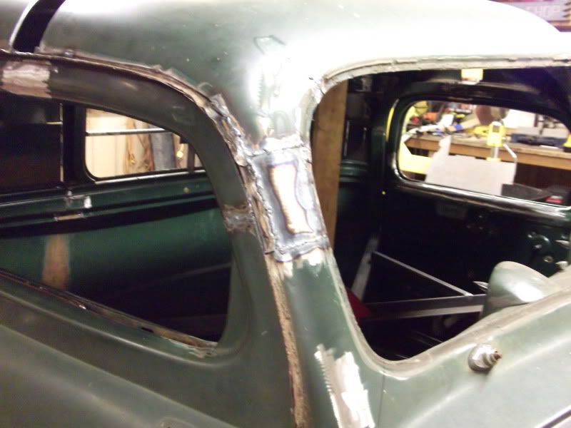

    OK, big update!
    Im happy with the chop but i didnt like the front window. still looked to big and aslo wanted to take some of the crown out of the roof, so i lowered the frame work an 1/2". Then i removed the seems on the A pillers. Fixed the drivers side corner and door jam area. Recently bought a TIG welder so what better time to learn than now. then on to filling the gap between the roof sections, need to redo it cause i got to big of gaps but it will have good flow. Then i tried to fix more of the driver side roof but i decide to just make a new section.
    Any ways heres the pictures!!
    Before lowering the window opening
    During
    After
    New corner and a pillers
    Back cab wall welded and smoothed
    Cab upper corner after my first atempt to fix it
    New peice i made
    And fitted
    What do you all think?
    Justin
