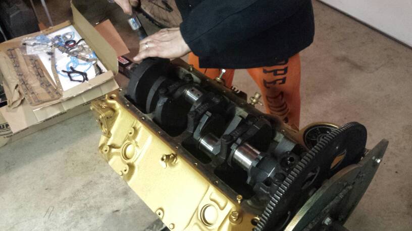

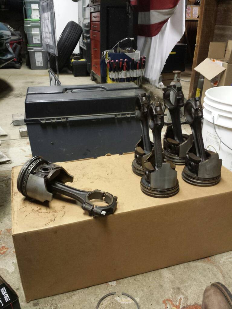

    Since we are re using the pistons, cleaning the carbon out of the ring channels was taking some serious time....crankshaft and cam are in, majority of pistons done. But we are in an unheated garage only working with a space heater...so it's time for a break. Dad is going to finish the pistons, and we will return another weekend to finish...

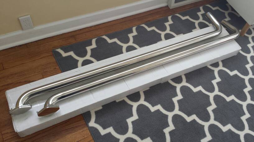

    ...and more. Thanks Mr. Postal man!

    So I mocked up the location of the lake pipes. The 60" is the perfect length. I want the opening to follow the curve right before the rear quarter hump. The distance from the front wheel opening to the leading edge of the door is about 14". I'm going to have about a 20" molding. I am going to mock that up later this week. ImageUploadedByH.A.M.B.1453856787.177605.jpg ImageUploadedByH.A.M.B.1453856802.785880.jpg ImageUploadedByH.A.M.B.1453856820.740211.jpg
