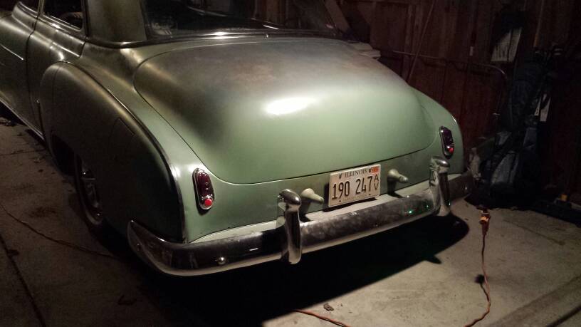

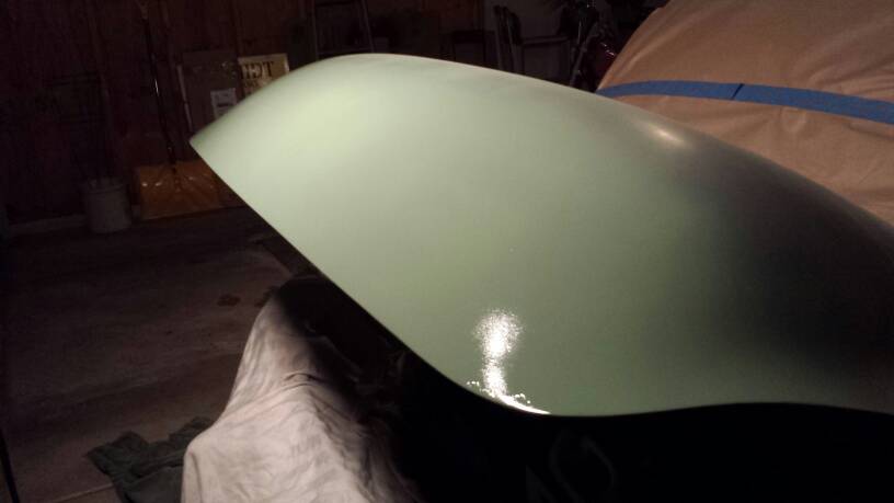

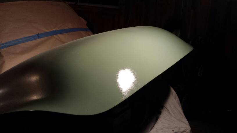

    More mild kustom touches. The bodywork isn't perfect yet and needs a little more filler - hard to tell in these pics with the primer and the lighting. But I ran out of time in my weekend as I had plans to attend to. Going home on lunch to fill in the rest of the way as cold weather is coming - AGAIN, and I want this done before MotoRama this weekend. 20160227_131111.jpg
    A little primer to help guide me on my highs and lows, before any skim coat.
    After one skim coat, sanded and primered, but it hardened on me a bit as I was working with it as the weather was a little cooler which made the trunk lid a little cool. Still a few small pits to fill in, but it is looking great. Love the smoothed out look!

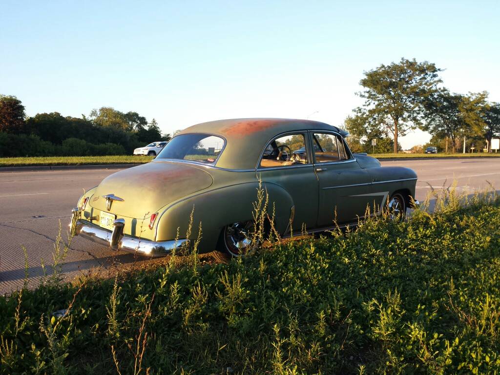

    Great picture! Do you happen to know the name of that factory color? I'm digging that green for my 51 coupe
  16. cmarcus
    Joined: May 23, 2012
    Posts: 953
    cmarcus
    Thanks!
    Unfortunately I do not. I know Robletica on here nailed the color for his 51, but I haven't seen him on here and he only had the wheels painted. I believe he had a custom mix, and I know my car was repainted at some point, so I don't believe it is a 50 paint code when I've researched.

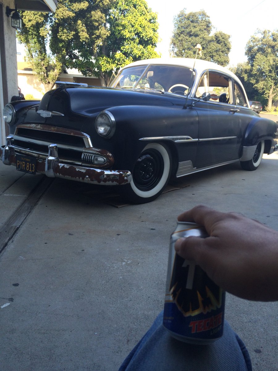

    So I actually am currently running 2" blocks in the rear with 1 coil cut from the front. For now, that is the lowest I can run and still make it out my driveway. In the long run, I am shooting for the same stance as Mike Sorci's Chevy (my dream car...) I am hoping to achieve this with a mini compressor and air shocks which will give me 2" or so of extra travel when filled up, so I can run around 4" total lowered.
