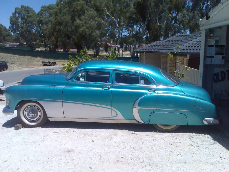

  20. hughesy
    Joined: Mar 12, 2013
    Posts: 32
    hughesy
    10418184_1399911916964740_5995316972172067120_n.jpg This is my 49 chev from Australia..

  22. cmarcus
    Joined: May 23, 2012
    Posts: 953
    cmarcus
    That's exactly what I'm going for with the chop. Perfect profile! You have more pics?

  25. hughesy
    Posts: 32
    hughesy
    084.JPG Its chopped 4" at the front and 6" at the back with the rear window layed forward.
  26. drew1987
    Joined: Nov 22, 2015
    Posts: 682
    drew1987
    That's cool. I think, for me, 2" front and 3" rear with a welded and slightly pancaked hood would do the trick. My wife, who certainly has a say, wants a stock body. I'm good with it. For this car.
