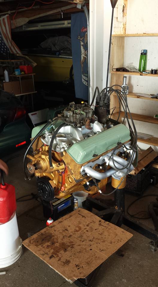

    Speaking of photos, here is some catch up from the weekend. We made killer progress, however it was two steps forward, and one step back. Got the entire motor back together, which was even further than my dad had expected. BUT, we didn't get it to run. Everything was there - fuel, timing, dwell, compression, and we even had a couple pops. However, by the time we got SUPER close to it firing, the fuel pump sprung a m***ive leak, and simultaneously the coil started smoking (worked great on this thing before we rebuilt it, just old). So, we know it is ready to run, just need 50 bucks in parts and we are there!
    Just a simple cleaning of the block and heads with some emory cloth. Super the****utic.
    Learned how to set valve lash. Definitely a science to it...but fun to do.
    These Walton Fab mounts are incredible. Worth the money. Once we get the mounts in the frame, it'll fit like a glove. Can't wait...couple weeks!!
    And here is where we left it. It's a really *****in' looking motor. Can't wait to see it resting in the rails. Stay tuned!

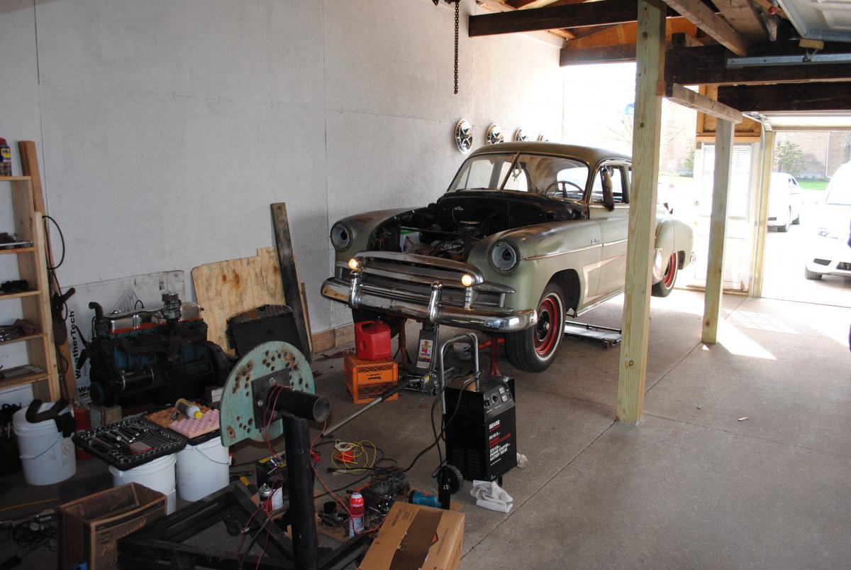

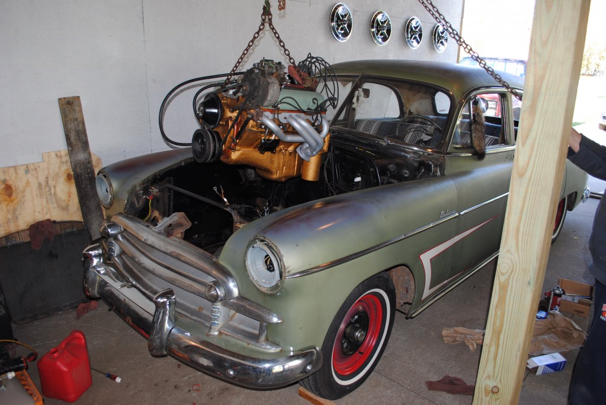

    Some quick pics...better ones from my real camera later. Very pleased with how easily the engine and transmission went in. Tons of room still, and already have my trans crossmember plans sketched up...very simple and will easily install with the existing crossmember "stubs" from where we cut it out.
    The caveat to all this is unfortunately the engine still would not fire for us. New points and condenser, swapped carbs, new coil resistor when they precious one seemed burned up, pulled the plugs (twice) to clean them from flooding...we got to the point where we just had to walk away after being confused. We did get it to bark once, and numerous fireballs from the headers....but no full idle.

  19. Dan Hay
    Joined: Mar 16, 2007
    Posts: 6,464
    Dan Hay
    Maybe the dizzy is 180 off?

  21. Roger O'Dell
    Joined: Jan 21, 2008
    Posts: 1,162
    Roger O'Dell
    Fire in tail pipe or fire from carb timing ( dist position) Just make sure plug wires in correct position on dist to eng

    cmarcus
    Exhaust fire, not carb. Checked all that. 3x, maybe more. Checked and re-checked dizzi, had the timing light out, and everything. Swapped carbs. Two separate trips to NAPA - new points and condenser, 2nd trip for a new ignition resistor.
    Keep in mind, I am working with my dad, a 30+ year technician, GM license/certified, used to work in dealers, rebuilt his own engines for fun, and so on. So you can imagine his frustration right now. We got to a point where we just had to step away to get a clear head (that and the ether was getting to us :p) He is going to do some de-bugging and thinking on it this week. We know it'll be something small and stupid oversight.
    It was a two steps forward, one step back weekend. Hot rodding anyways. No one said it was easy! :confused:;):D
