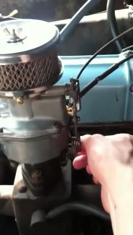

    Well, she runs great! FINALLY got fuel up the line from the tank - apparantely it was just a matter of tons of priming needed....but one the gas got up to the carb, she ran great. Got the idle adjusted nicely and everything. Found the source of the oil leak - the pan just wasn't tightened down all the way! And finally, we tore into the brakes, and as opposed to needing a whole rebuild kit, we probably will only need a wheel cyclinder and a couple feed lines to get them all working! Great news there for sure!
    I wil post up pics later, but thought I'd share the news. Here is a video of it running just for good measure!

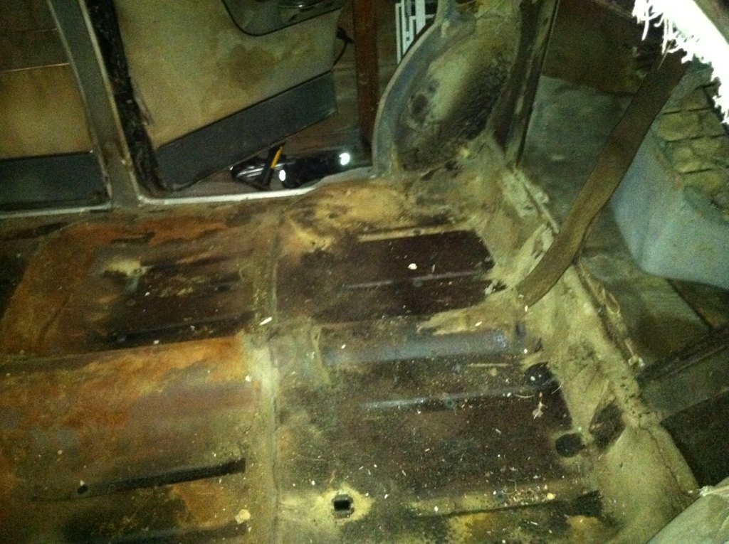

    Steady as she goes! Updates are slow, but so are resources and limited space make it tough as well. Got all the carpet out and back seat completely out, only to move it to the trunk for storage! Floors in the back are super solid which is awesome! Just a couple pics.
    As you can see, space is limited...

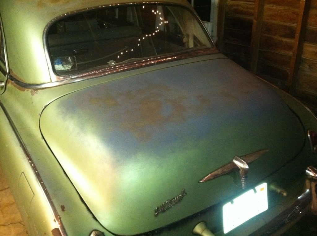

    CLR light scrub on the trunk lid to knock some of the surface rust down. Some more light-ish blues came through as well.
