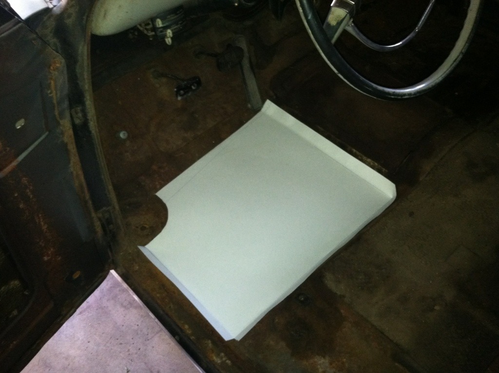

    Small progress! Got floorboard templates made from poster board. Looks like they will be about perfect. Now looking for a decent metal supplier in my area.

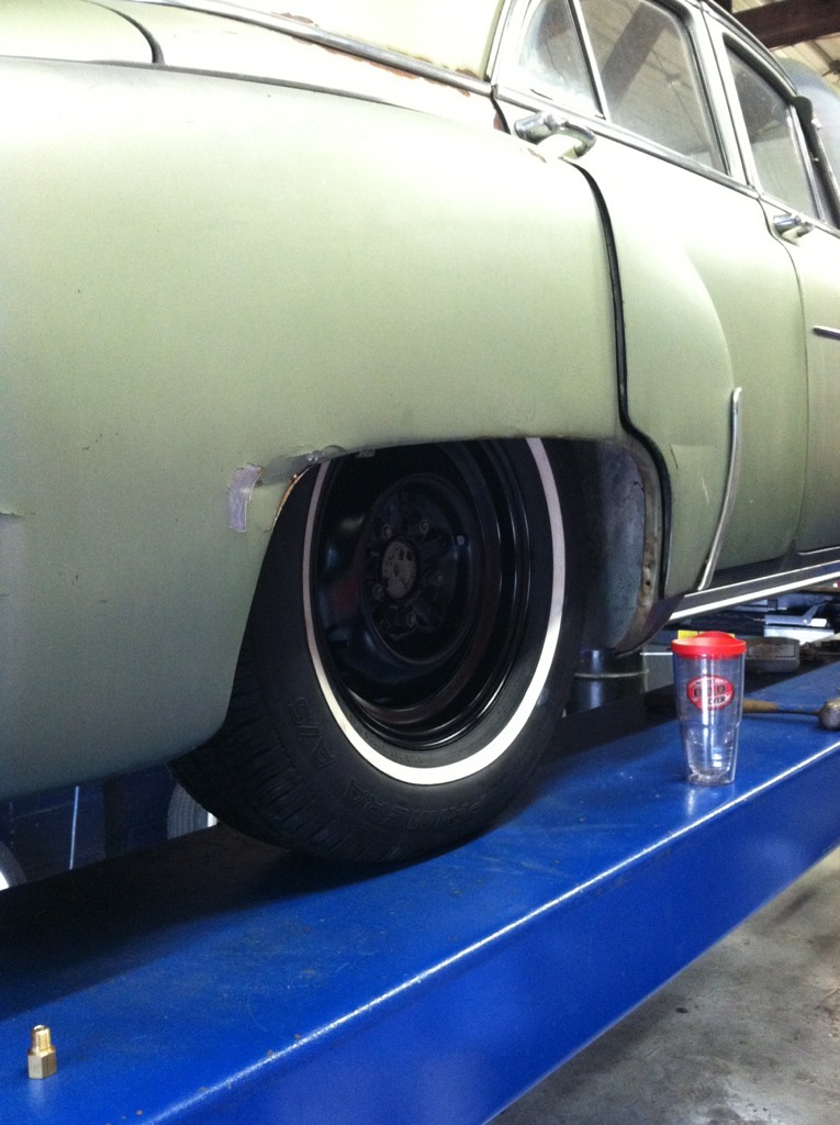

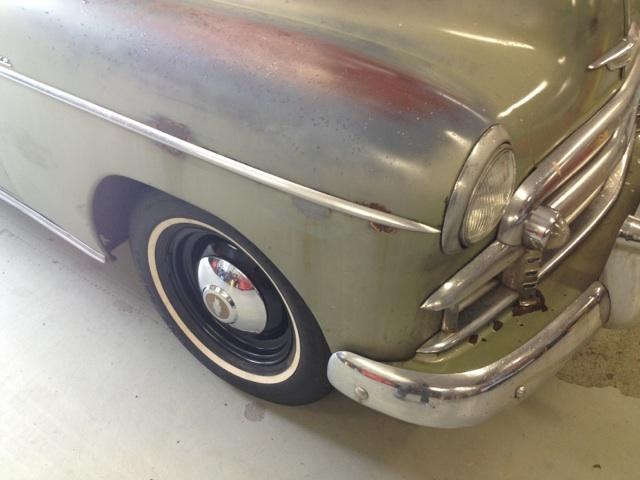

  5. cmarcus
    Joined: May 23, 2012
    Posts: 953
    cmarcus
    Daddy got new shoes!! Now to paint them black, and polish up the caps!
  6. 416Ford
    Joined: Mar 28, 2007
    Posts: 826
    416Ford
    Charlie, will the tires clear the fenders once you cut the coils? I am sure one of the other Chevy guys know for sure. I just happen to know about this problem by trial and error on my car.
  7. cmarcus
    Posts: 953
    cmarcus
    As far as I know, these are basically the factory size tires in a radial form. I know other guys have done the same with this combo, so I should be okay from what I have gathered. I plan on starting on 1/2 a coil at a time to see how it goes.

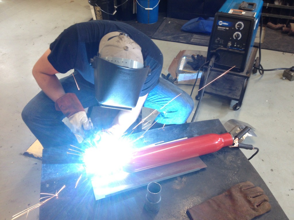

  13. cmarcus
    Posts: 953
    cmarcus

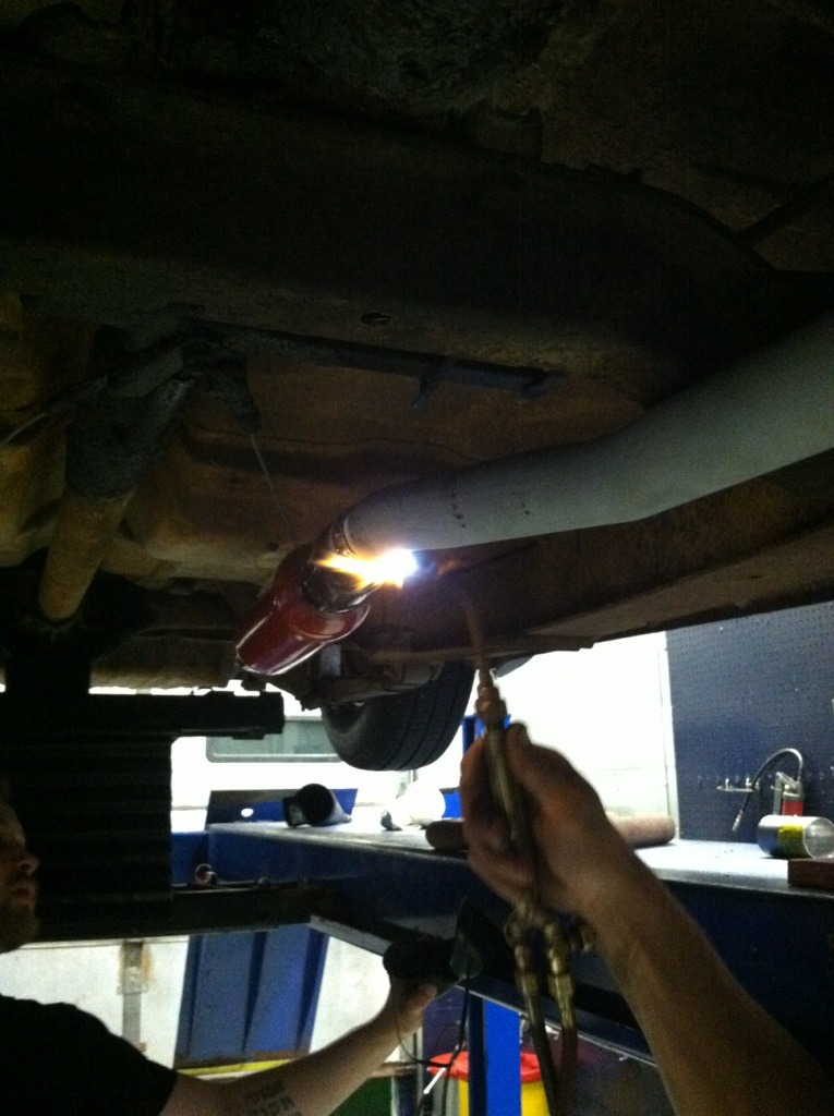

    Just some more of the progress....
    Sittin' right...
    Dad with the art of brazing... Always amazes me.

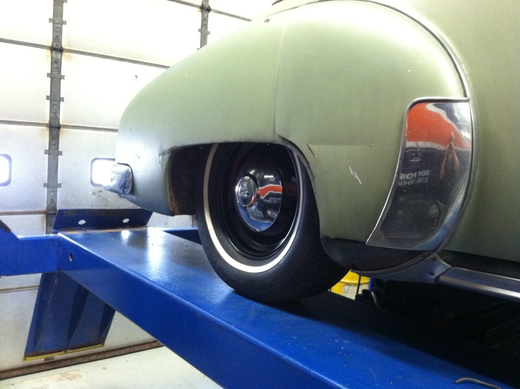

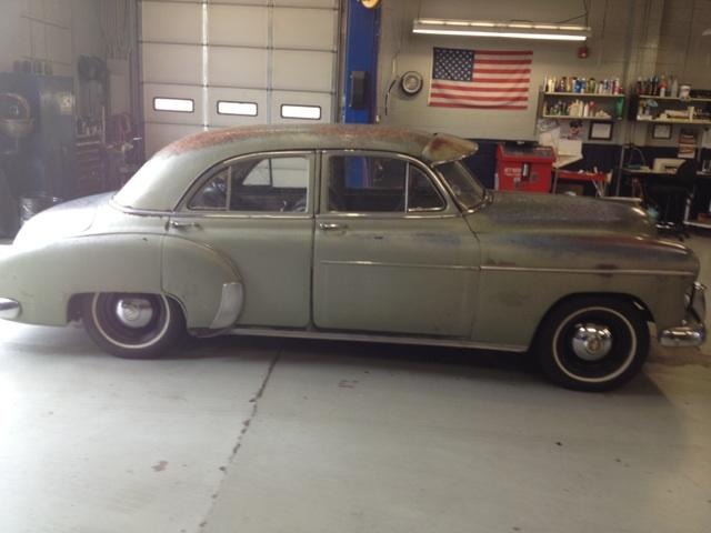

  16. cmarcus
    Posts: 953
    cmarcus

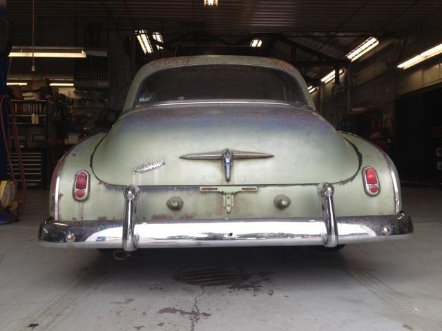

    Unfortunately I had to leave earlier than expected today a my wife's grandfather p***ed away this morning, but my dad and buddy kept hard at it. Here are some pics of where we got. Brakes not yet done, and the front still at factory height, so it has the taildragger stance for a while. She sure is running sweet now too with the tune up! And that Thrush muffler sure makes here spun great!
    I am SUPER happy with how the wheel/tire combo turned out. It is super rewarding when your vision works as you hoped!! Hopefully will still get to the Relix Riot
    cdoh likes this.
  17. 49styleline
    Joined: Nov 1, 2012
    Posts: 507
    49styleline
    Nice! I surprisingly like the thin white walls a lot usually I'm a wide whites guy how much do you plan to lower the front?
  18. cmarcus
    Posts: 953
    cmarcus
    Thanks man! I plan on coming down about 3" so it sits level with the rear, so around 1 1/2 coils cut out from what I am being told. I plan on going 1/2 coil at a time to be safe. The tires worked out by chance. I needed some good tires, and have seen the black wheel/center cap/thin line tire combo, and had a good feeling it would work. And it certainly came out EXACTLY like I was hoping!

  23. cmarcus
    Posts: 953
    cmarcus
    Still here!! Was finally able to get some work done! Got the front end lowered down to level her out. It went way way better than we thought. We just dropped the lower A arms and they slid right out. Torched out 1 1/2 coils, but it still sat a little nose high. I didn't want it TOO low, as I was already bottoming out on bumps with the 3" blocks. So we cut off 1" from the blocks, and now it's perfect.
