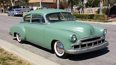

    I'm digging on it. That looks good and isn't over done. Just spray a few coats of satin clear over the green to knock down the gloss.

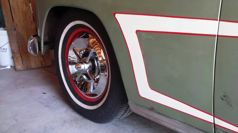

    Well, I decided to go red on the wheels...I felt they were missing some depth with these caps, making the tires feel larger and almost like I was running a smaller wheel. White walls will (eventually) fix that issue...
  12. Slopok
    Joined: Jan 30, 2012
    Posts: 3,002
    Slopok
    Nothin wrong with red rims as far as I'm concerned...

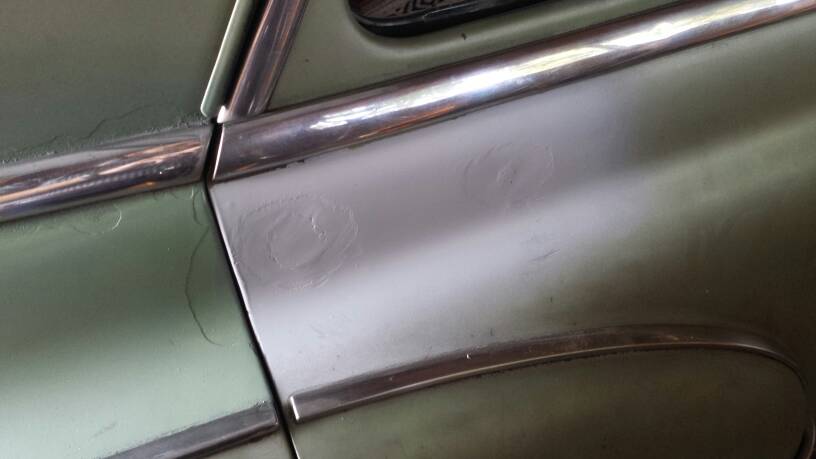

    A big milestone (to me) that came in a small package! So @cdoh and I decided we wanted to learn something, so we decided we would give shaving door handles a try. We got one done last night, will finish the rest this weekend. It's not perfect and needs some more finish work, but nothing a couple more grinds and a skim coat won't take care of. Felt good to make sparks fly using my car!

    I will also share this picture with no shame to show what we are learning, again, our first time ever doing this. For the other ones, we are going to clean up the entire area of paint so we get a better feel for the flow of the surface. We also really dialed in our heat settings near the end so we will get better clean welds. Again, the primer was more to seal it before I left for the night knowing we would be coming back to clean it up this weekend. This also truly helped show the highs and lows.

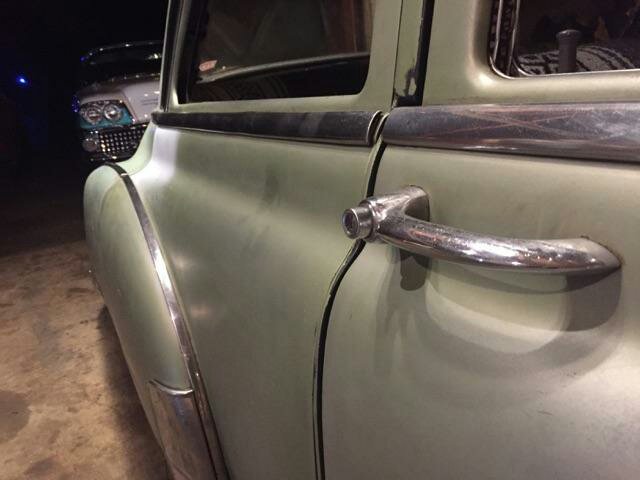

    I like your car, keep at it. I plan to possibly shave the rear handles on my olds someday, what are you planning to use to open the doors?

    Thank you! For now I am doing the old reach in the window trick :) Eventually actuators and ****ons will go in.

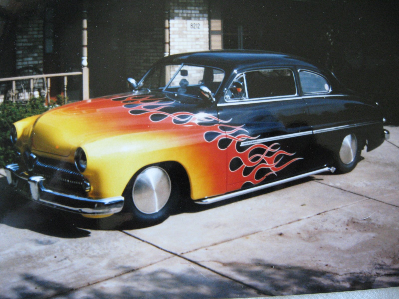

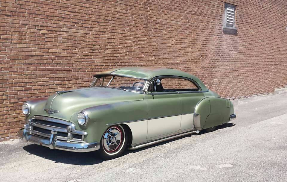

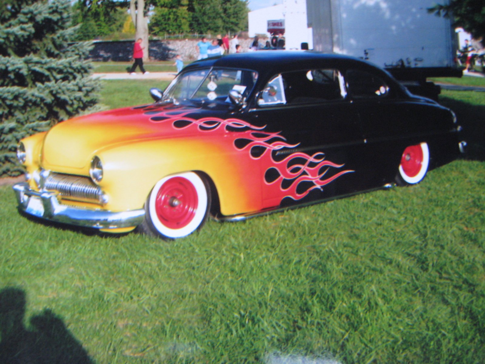

    So, I've been considering keeping the paint similar to its original color after doing the attached rendering of my (5 year??) plan, a chopped hardtop. "Sage"/teal green top, wimbledon White bottom. I ran across this picture today and I have emailed the fella to see what color he used.

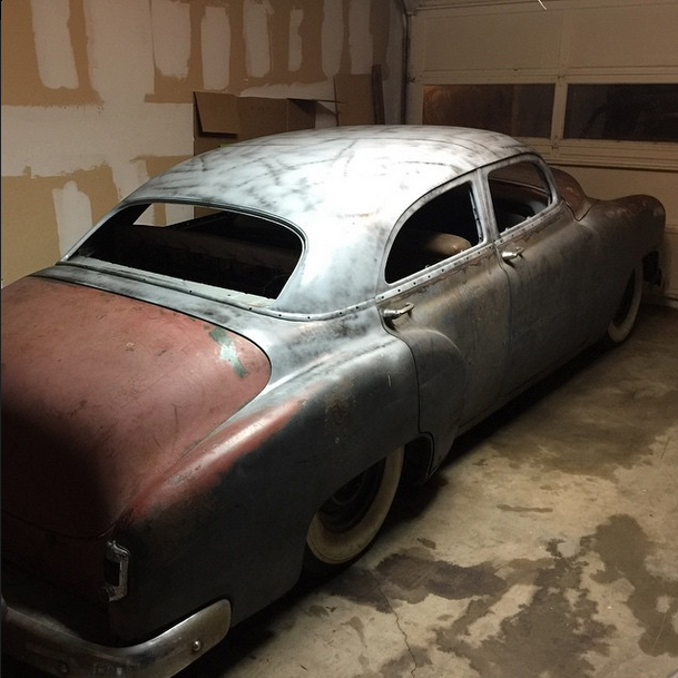

    How do you plan to address side gl*** if you hardtop it? I ***ume being up north, no side gl*** would be pretty limiting to how often you could drive it. Here is a pic of my chopped 51 four door project. Screenshot 2015-05-22 at 1.52.17 PM.png
  26. cmarcus
    Joined: May 23, 2012
    Posts: 953
    cmarcus
    First off, that chop is right on. The flow is perfect. How much is that front and rear?
    In talking to Voodoo Larry, he explained you retain your front door flat gl***, but then make a channel for the rear doors that a window simply slides into horizontally, that you would store in the car under the seat, in trunk, etc. for when needed. That piece of gl*** would have a rubber channel/seal to seal the gap.

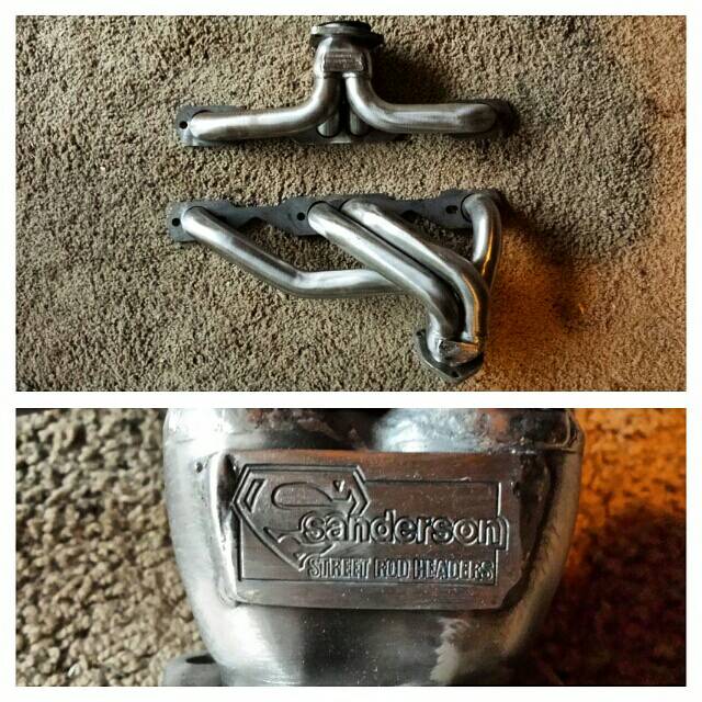

    More goodies! Bit by bit...
    Got brake overhaul kit as well...but haven't opened the box yet!
