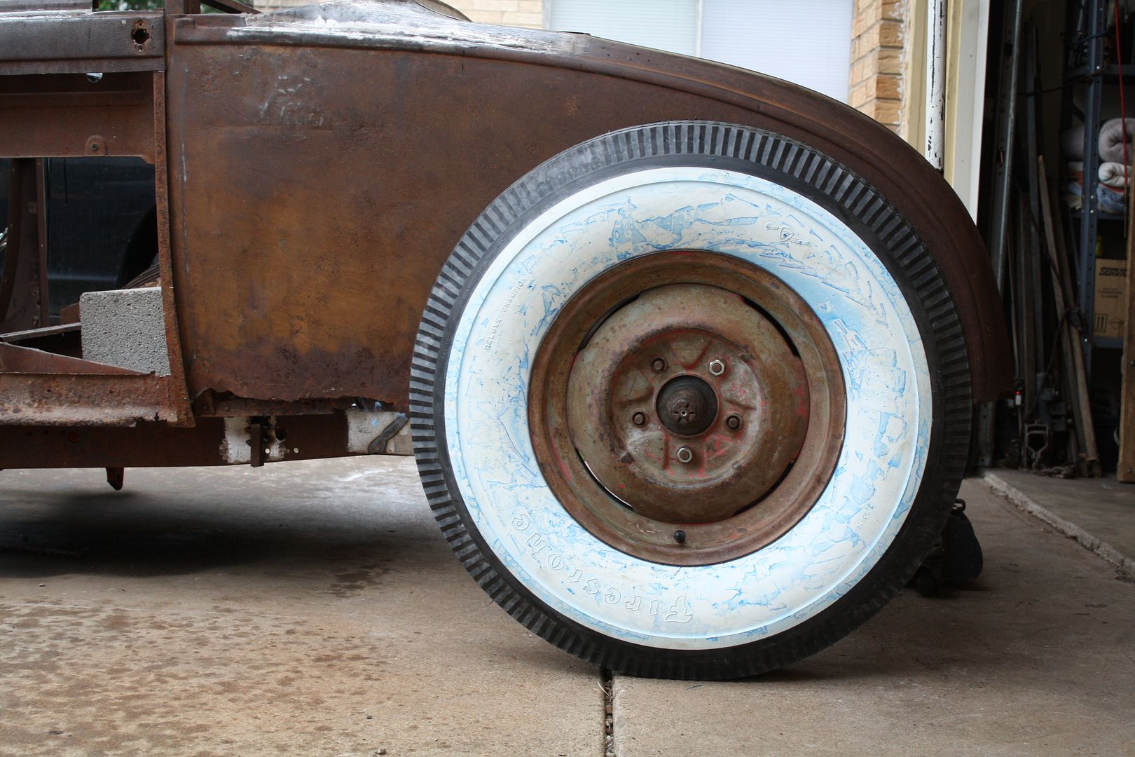

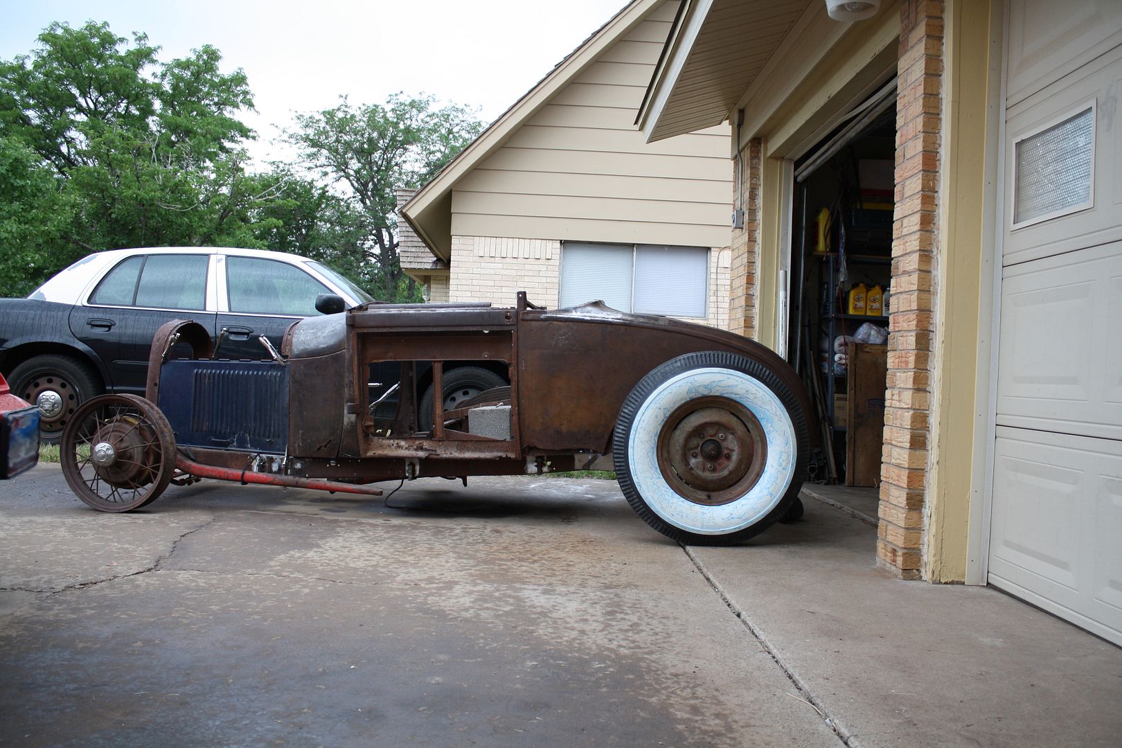

    Super-mini update:
    Using the tech that Andy (ThunderbirdEsq) posted on the HAMB a while ago, I was able to mount one of the back tires to the 16x4.5 wheel and mount it on the car. Then I burst out in a fit of giggles of excitement.
    Don't worry.. They were manly giggles.
    Andy's thread on mounting bias ply tires all by yourself in your own garage:
    http://www.jalopyjournal.com/forum/showthread.php?t=462011
    I got some shackles from Vern along with bushings for the back and a reversed eye main spring for the front. If nothing turns up at the swap meet next month, then I'll order one of Okie's dropped axles which LSGun turned me onto. Thanks Jake! I should be able to start messing with the suspension next month with the motor and transmission. I just need to find one more 16x4.5 for the other side which I hope I'll find at the Amarillo swap meet on June 2nd. Speaking of that, anyone else going?
    I REALLY dig how the body line flows into the tire. That was my goal and it looks like it'll come out beautifully. The back end of the body is just hanging there as I cut the subrail out to make room for the Z. I still need to cut the ends of the crossmember off so the body can fit around the frame better. But that's the least of my worries.. The rust and absence of clean and smooth metal is really annoying me. I'll be hitting that hard as soon as I get the motor/trans and suspension sorted out and it's a roller.
    I can't wait to order the 5.50x16 tires next month from a source outside of Coker that JJ told me about. Thanks Jeff! My 2 Ford wheels are sitting here waiting for them. Oh, and another interesting thing that I learned from wasting the wee hours of the night away on the HAMB that I thought I'd point out on here. Hopefully someone'll learn something new from this..
    I searched for more information on early Ford wheels from the '40's and stumbled across a thread that explained that the '40 Ford wheel is an one-year only deal as the inside of the wheel has two right angle corners as opposed to one right angle corner and one slope. In the picture below, the '40 wheel is on the left while the newer wheel is on the right. It should also be noted that the outer sides of the wheels are both facing out, so these wheels are back to back.
    Anyhow.. I'll only be doing small things here and there in the garage before I make a serious update. Thanks for following, guys. :)

    That looks awesome, you'll really get a good idea and even more drive to finish it when you get it sitting on all four. 16" early Ford wheels are weird, I've heard all kinds of stuff about them including the '40 16x4 inner bead area difference. 1941 was also a 4" wheel like the '40 but it has a slope like the 4.5" wheel and the center is slightly offset in comparison to a '40 4". I have a 16x4 that has two straight right angle corners but it's dated July of '41, who knows.

    That's real weird.. Henry liked to keep things interesting, uh?
    Thanks. Just that one wheel alone is getting me really motivated. Haha. Imagine what three more will do. :D
