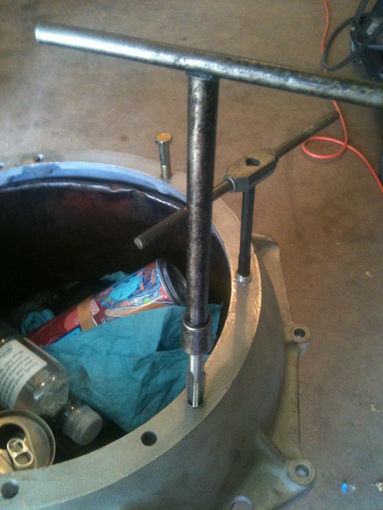

    To make sure I can say that when I'm older.. I did some work yesterday and today. The good news? The motor is sitting on the frame! The bad news? It's sitting on a couple bars of tube steel for until I make the mounts. But, hey, now it's starting to look more and more like a hot rod. I got a chuckle out of how m***ive a Model A frame makes a small block Chevy look. :)
    First off, the Offy adapter I bought off here got drilled out and tapped one size too large for the bolts to be able to pull it against the '39 Ford transmission so I worked on getting some heli-coils in. I do have to admit they're pretty cool, especially since this is the first time I'd worked with them.
    And while I managed to get the adapter to bolt up to the transmission with some bolts that just feel a little too short but they were able to get partially into the holes. Before I bolt everything down for the last time, I'll get some longer ones to replace these just to be cautious. Then after scrubbing the grime off which I decided to put off, it turns out the transmission was painted red at one point in its life then one of the PO painted over the red with a dark blue. Safe to say it might have some history.. :)
    (in the above picture, the bolts were too long on purpose just to hold the adapter in place)

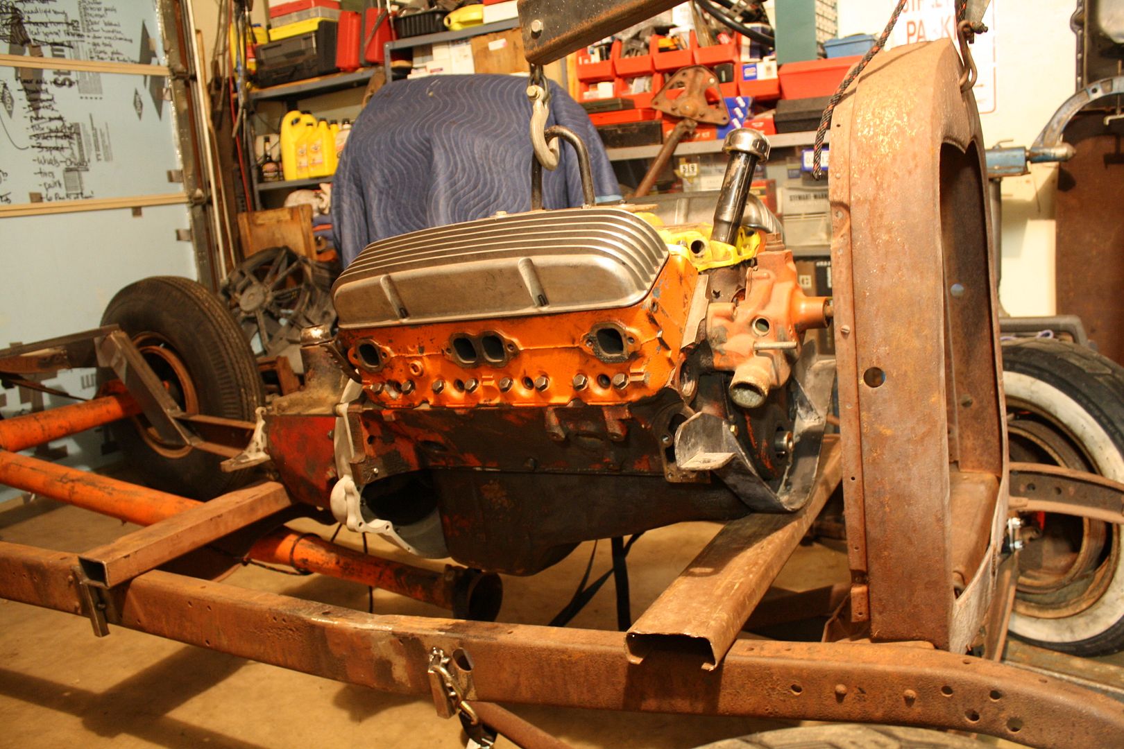

    I still haven't brought the '57 283 over since my brother-in-law is in the middle of a big move and I didn't want to be a burden just yet. I decided I could just put one of the SBCs in my garage to good use as a mock-up motor. This is the 350 that came out of my dad's '72 GMC long-bed that was involved in the accident. The 350 itself wasn't in the accident as he had replaced it 5 or 6 years prior with a crate 350 so it sat over in the corner. He ***umed one of the cam lobes had gone bad but taking it apart to appease my curiosity, one of the pushrods end was smashed in. The Hurst motor mount is bolted to it and the Corvette intake is sitting on top of it but this isn't the motor I'm using.. Just for the heck of it.
    Anyways, with it taking up space, I figured it would be better off taking up space on my frame instead of precious garage space so I took it off its stand today and worked on mating the transmission to it. Of course, all the grade bolts I have are too long so I took the shortest of them and some flat washers and went to town..
    Then jacked it all up and set it on the frame. The tie rod on the '46 spindles wouldn't clear the cherry picker so I took it off and rolled it straight then once it was where it should be, turned the wheels in so it can't roll back. This is only temporary. There are some wood blocks behind the back tires as well.
    One of the things I want to do is raise the motor to fill in the engine space visually. While this is probably a little too high since it's just sitting on a piece of tube steel, this is the general idea of what I want to do in comparison to the grille shell.
    Ah.. Progress.
