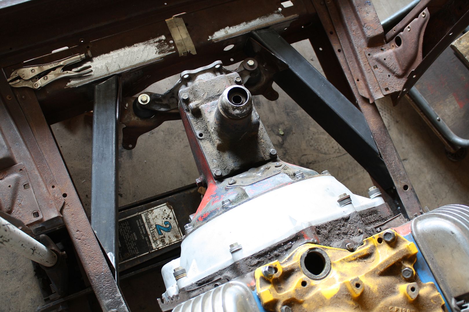

    Knocked these legs out today.. Still need to notch them to fit the transmission cradle in and tack them to the frame. Some fitting to do, some grinding to do, a little more sweat and it'll all be solid. Everything's loosey-goosey for now. The center part of the legs will be more inward but they're mocked up this way so the cradle can fit in between them.. Does that mean they're spread eagle?
    Went from this..
    To this.
    The angle of the sides of the cradle is what determined the length and angle of the legs from the center crossmember out to the rails.
    Slowly.. But surely.

    Jeesh slow down! At this rate that's going to look like a car pretty quick! What's your "cradle" cross member out of? It sorta looks like what my 46 had as the crossmember between the legs like you have it except mine had an additional piece that bolted to it in the middle and then the trans bolted to that.

    I only wish I worked faster. At this rate, my beard is going to touch my toes before I get this thing fully finished. ;) I bought that cradle from Chris on here. If I recall, it's from a '35-'36 while the saddle mount on the transmission case is from a '37-'41. The original saddle mount that came on the back of the '39 transmission was too narrow to bolt up to the cradle so I swapped it over for the other saddle that I also bought from Chris which bolts up to the mount.

    Got the legs tacked in, cut the notches out, slimmed the '35 Ford cradle down some and it fits in nicely.. A little more t******* to do then I can tack it in and mock the motor/trans up to see how it's looking.
    Still up in the air about making super-high motor mounts for the Hurst mount or making my own Hurst-style mount from scratch. The ears of the Hurst mount sits up pretty high over the frame. 4 inches if I'm not mistaken.. But it'll have hood-sides so the mounts won't be visible unless you lean over the engine bay to look inside.

    Go for the homemade mount. It will look better and it won't look like a bought part. Too bad I didn't think of using the trans cradle like that when I made my mounts up. It would have looked a lot cooler.

    Matt your doing a really great job keep up the good work! I really love the way the trans mount is coming along, looks pro man!
