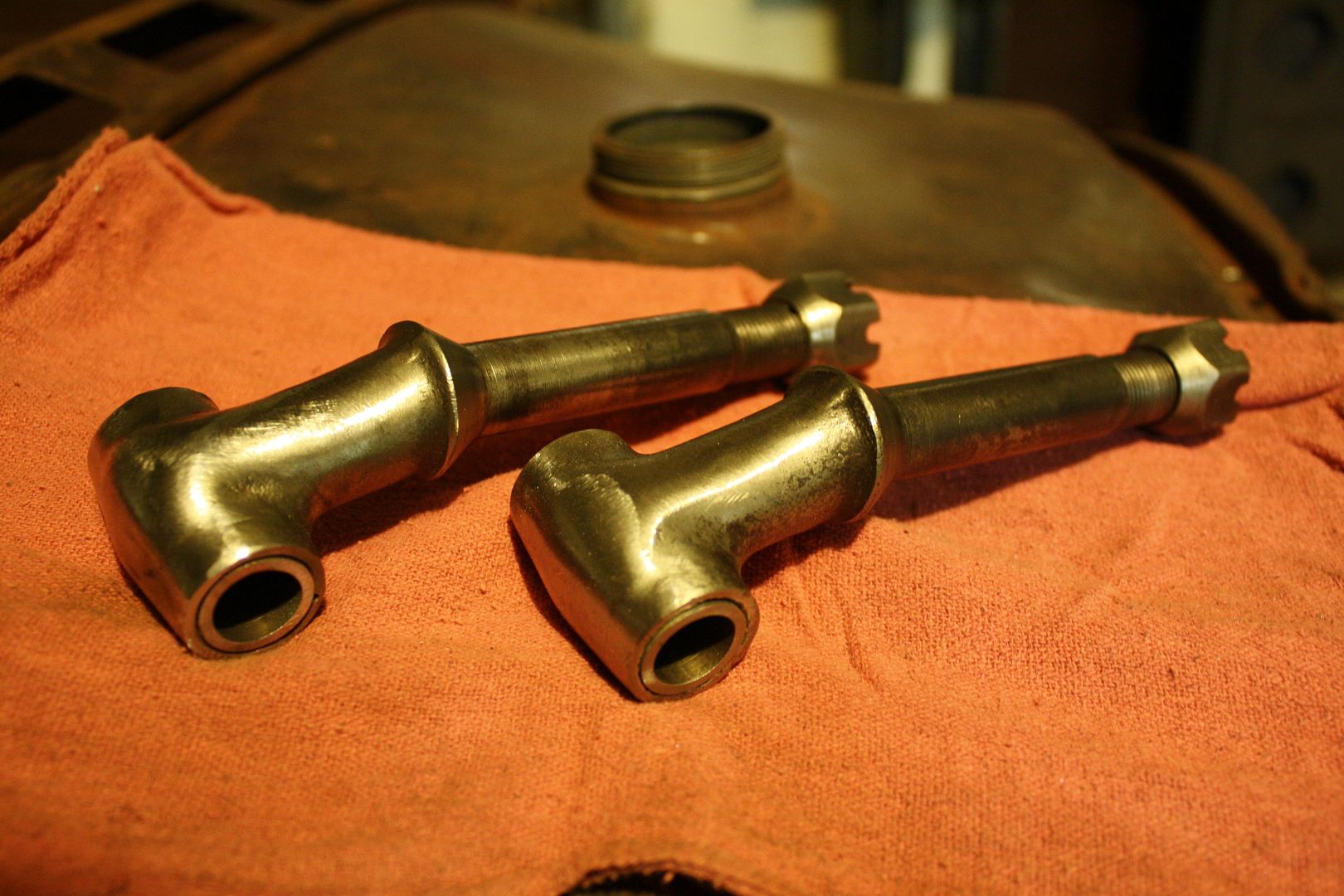

    So until that axle arrives, I chose to clean up the perch pins. Unfortunately, the shock ends on the perch pins had been hacked off decades ago and they were left with some ugly stubs in their place. I forgot to get a good picture of them but you can make out the ends in the picture below.
    I spent some time on the bench grinder getting most of it knocked down then spend a lot of time with a right angle grinder giving it a much better appearance.
    You will notice the bushing sticking out the sides of the pins. After measuring the '34 spring and the A spring, I realized that they're both basically the same dimensions which meant I could run the front A spring on my A. The problem, however, is that the bushing that comes on the front shackles from Macs are for A perch pins and not the '34. The '34 perch pins have larger bushing holes. I pulled out a new rear A shackle bushing and stuck it against the hole and saw that it would fit in there. Then I put it onto the A shackle and compared it with the smaller bushing and found that the bigger shackle is the same diameter as the smaller bushing, just thicker and the right size for the '34 perch pins. They were just too long by a fraction of an inch. So I headed to Harbor Freight and bought a new bushing/bearing driver set and spent today's afternoon getting the new bushing in the perch pins and cutting the excess off, grinding it down flat and beveling the inside edge a little and cleaning out the metal shavings.
