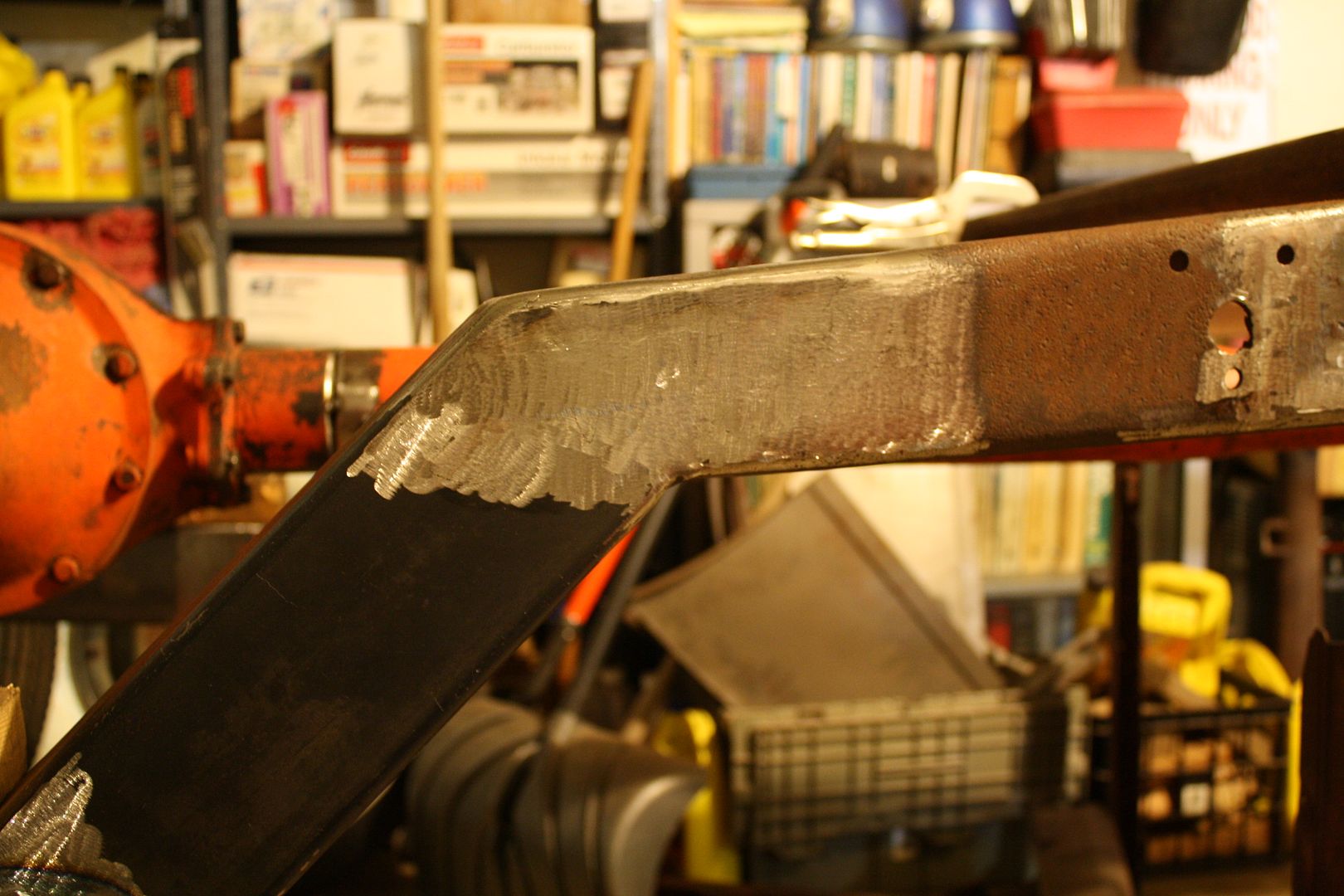

    While I had the frame upside down, I went ahead and fixed the little "dip" that you can see in the side-profile shot below (just in front of the rear tire). That bothered me from day one but I knew that I'd get around to fixing it. I'm too much of a perfectionist to let something like that disrupt the flow of the frame..

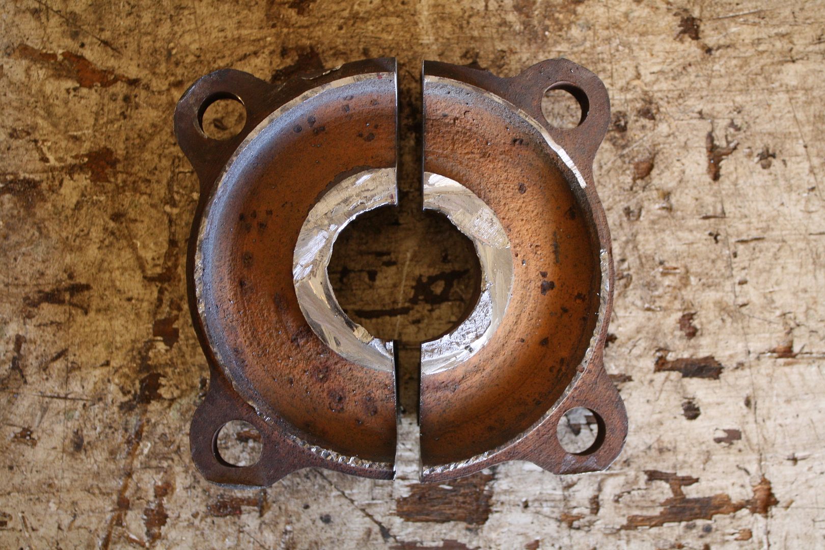

    That's when I thought "Hey.. I've got a couple banjo tubes that are only good for s****. Why not cut the mounting flanges off one and use that?" So I stuck the very end of the banjo tube underneath my chop saw and learned how thick the steel is on the end of a banjo. My chop saw let me know it wasn't happy with the amount of cutting it had to do either and I had a smoke-filled garage. :D After airing out the garage, I proceeded to cut the bearing surface tube off the flange, cut it down the middle, then I kinda hit a wall here..

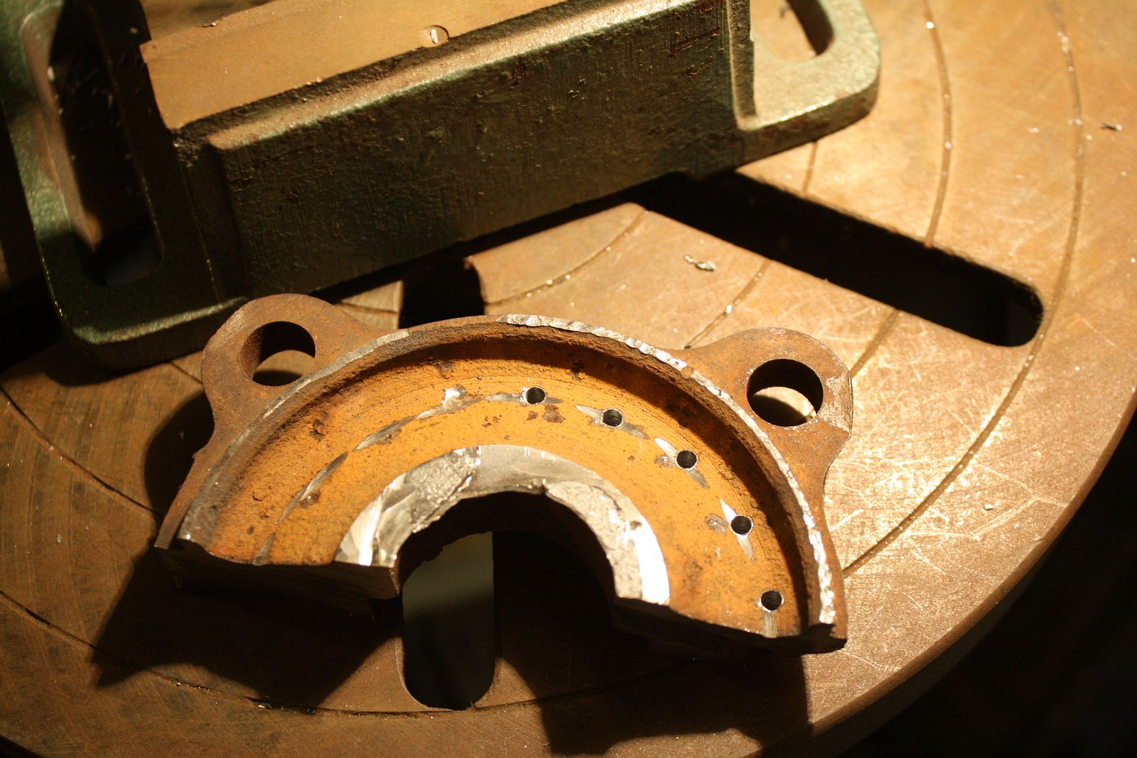

    This was a real thick piece of steel I was cutting here. I had no clue how to cut the center out without cutting into the "half-ring" that I wanted to save and use on the banjo. I tried cutting with a cut-off wheel but it really wasn't working out too great for me. Then I had one of those "Why didn't I think of that?" moments. I realized that I could drill out around the flange where most of the material needed to come out and then grind to shape to fit.. So I started with a smaller drill bit, and stepped it up until I was able to break away the piece. I spent some time with a bench grinder getting it to kind of fit over so you can see how it would work out. I still need to spend some more time getting it ground down so it'll fit snuggly against the tube, tack it on, tack the front mount on the tube, and get it all together so I can test and make sure the arms clear before finish welding it.
    My Taiwanese "King" drill.. Surprisingly till going strong after almost 2 decades. :eek:
    The flanges will still be pretty thick after grinding it to shape and should be plenty strong on the axle. The wishbone is staying unsplit. As soon as everything seems fine, I'll heat and bend the front of the 'bones so the flange is flat against the mounting bracket on the torque tube..

    I dig that bracket & in hindsight you could have,used a whole saw befor you cut it in half

    I like that bracket work, the weld is going to be critical one, nothing wrong with farming it out to a good welding shop if you don't have the equipment. Bob

    If its steel or malleable iron it will be fine to weld on. I don't think that is cast iron??

    I did all of the welding on the frame myself and everything's pretty sturdy. I do realize with this one, I have to take my time to ensure I don't warp the banjo tube, but I plan on fully welding all around the bracket with my MIG. I think I should do just fine considering it's not a bunch of moving parts like a 4-link.
