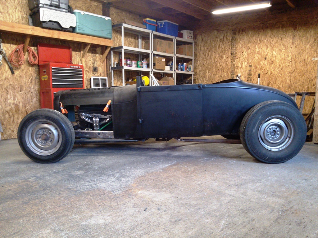

    No body work so far.. They're sitting in the corner of the garage. I want to get the frame all welded up before I start back on the body again. Don't worry, I'm anxious to get back on the body.

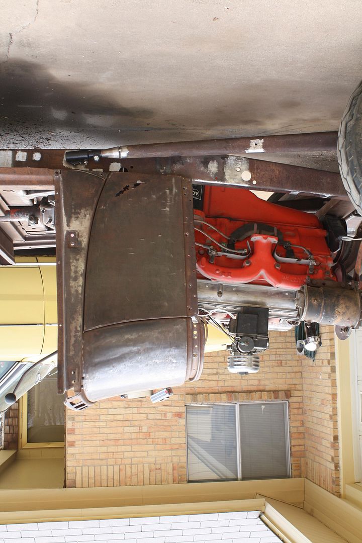

    First, I got the split bones mounted up to the frame. Using CTaulbert's bungs which enables you to use '28-'34 tie rods to mount the bones to the frame with ball studs using 3kross' through-the-frame bungs. I settled on mounting them right underneath the A-posts which worked out nicely. The bones do pretty good at hiding the upsweep in the frame. It'll probably work better when the frame is all one color.
    Then just to get it off the shelf and out of my way, I mounted the generator.. and broke the rear mounting tab. :mad:
    I had to cut out the floor some for the TT to clear, but the rear bones clear everything so far. Pretty happy about that. I'll have to add a little more back into the TT since it pulled the banjo inward some. That's why the wheelwell looks too far back in the pictures..
    I also took apart the F1 steering box to modify to fit the Model A frame. It'll require making mounting flanges to weld to the box. I plan to use another flange to bolt on the outside of the frame so the frame rail is sandwiched in between. Since the pitman shaft is too big to be able to fit through the stock A steering holes, I'll have to weld those closed and cut out my own pattern. Here's some pictures of the F1 box after cutting off the mounting flange and grinding it down..

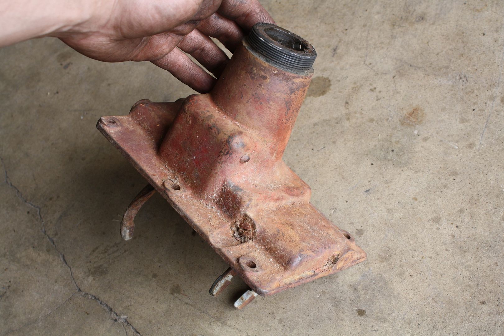

    Since I wasn't accustomed to using a torch, and knowing I'd have to be able to use it soon to drop the spindle arms as well as heat and bend the pitman arm, I'd have to teach myself. My dad never got around to teaching me, but practice makes perfect, right? I decided to look around today in the backyard for a piece of s**** that I could practice with. That's when I saw this shifter tower sitting in a pile and thought "gee.. That looks like a flathead shifter."
    Which is really weird, since my dad has never messed or tinkered with flatheads. I had know of the shifter all this time and forgot about it. I thought it was probably the shifter that came off the '48 Chevy truck we were working on before he got killed. No way it's a flathead shifter.. Well, I picked it up and realized it was. So I brought it inside and took the shifter out to put in my '39's shift tower and it fits. Not only is it the shifter I was needing, it's the swan neck shifter as well.

    Oh yeah.. Also, the shifter stick doesn't stay. I don't know how to describe it, but it seems like I have to use both hands to move through the gears. If I'm not careful, the stick may spin and come out of the forks.
    As well as one of the forks sticking. It seems like sometimes it will slide down the shaft just fine, then sometimes it doesn't move at all.
    Any tips on fixing these?

    Do you have the pin in that keeps the shifter from turning and the spring that holds it down? The fork may have dirt, rust or a rough spot you'll have to polish.
    I had a longer stick than that in my '38 coupe. It had a heavy chrome ball that broke the wind shield when I was banging second gear. I put a stocker back in.

    I have a spring in there holding it down, but I didn't see a pin. I'll go look at it and see.
    If second is to the left and down.. Then how did you break the windshield with the chrome ball? :D Is the flathead trans a different shift pattern from the typical H-pattern?

    Just looked. It appears I'm missing a pin for the slot on the dome of the shifter to prevent it from turning. I would guess that I could just find something strong enough, make it round and long enough to slide into the hole in the threaded portion to hold the shifter?

    Cut off a piece of drill bit. works great for a shifter pin.

    That would do just fine. It's just a short rod long enough to fit well into the slot of the shifter and short enough to clear the threads on the retaining cap side.
