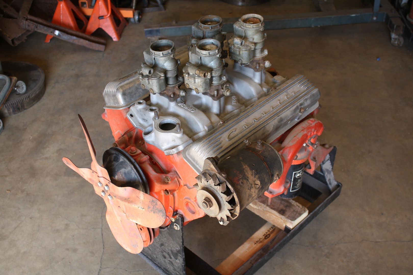

    In compensation, I'll leave you with a picture of the engine with the Weiand on it. At least it's nice to look at. :)

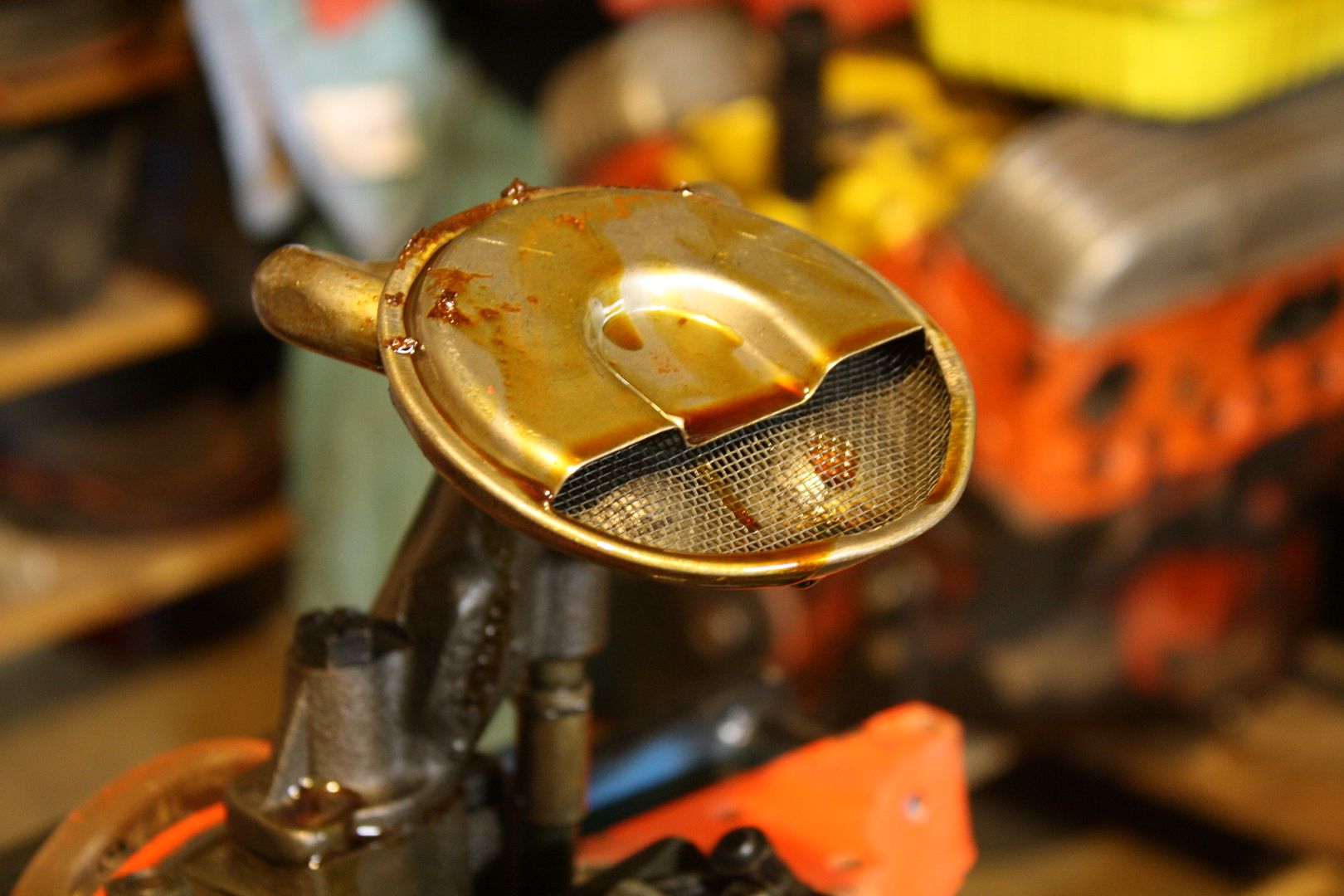

    I took all the rockers off, rods, then flipped the engine over and took the oil pan off. It looks pretty good on the bottom end. Peering past the crank and rods, it looks like there's rust on the cam, but the rods, pistons, crank, and oil pan bottom were covered in some dark red-orange oil. I guess he coated the inside with oil and let it sit.
    It does look like it's been sitting for a while. But I have hope that it's just the top end that needs cleaning.
    The pistons don't look factory however.. At least not from what I've seen. Did early Chevys have pistons that were particular to them other than size?
    (Forgive the iPhone picture)

    Do it right. It'll never be cheaper and easier then now. That chain does look a bit sloppy, but it's had to tell.

    Thanks! Yeah, I'm very well aware that the 283 isn't a Corvette engine. Seems like out of all the 283s in the world, I get the one that isn't. :p I'm perfectly happy that I got an early Chevy engine to use, and a complete one at that. From the start, I wanted a vintage engine, something from the period, to use. I would have not been happy with using an engine from outside the period.
    The covers say "Corvette", but that's the only part of the engine that's Corvette. The covers aren't staying either.. A pair of chromed "Chevrolet" script covers will take their place in the future.
    I thought about using the '64 283 I have sitting in the corner of the garage, but that wouldn't have been right. This car deserves an early Chevy.
