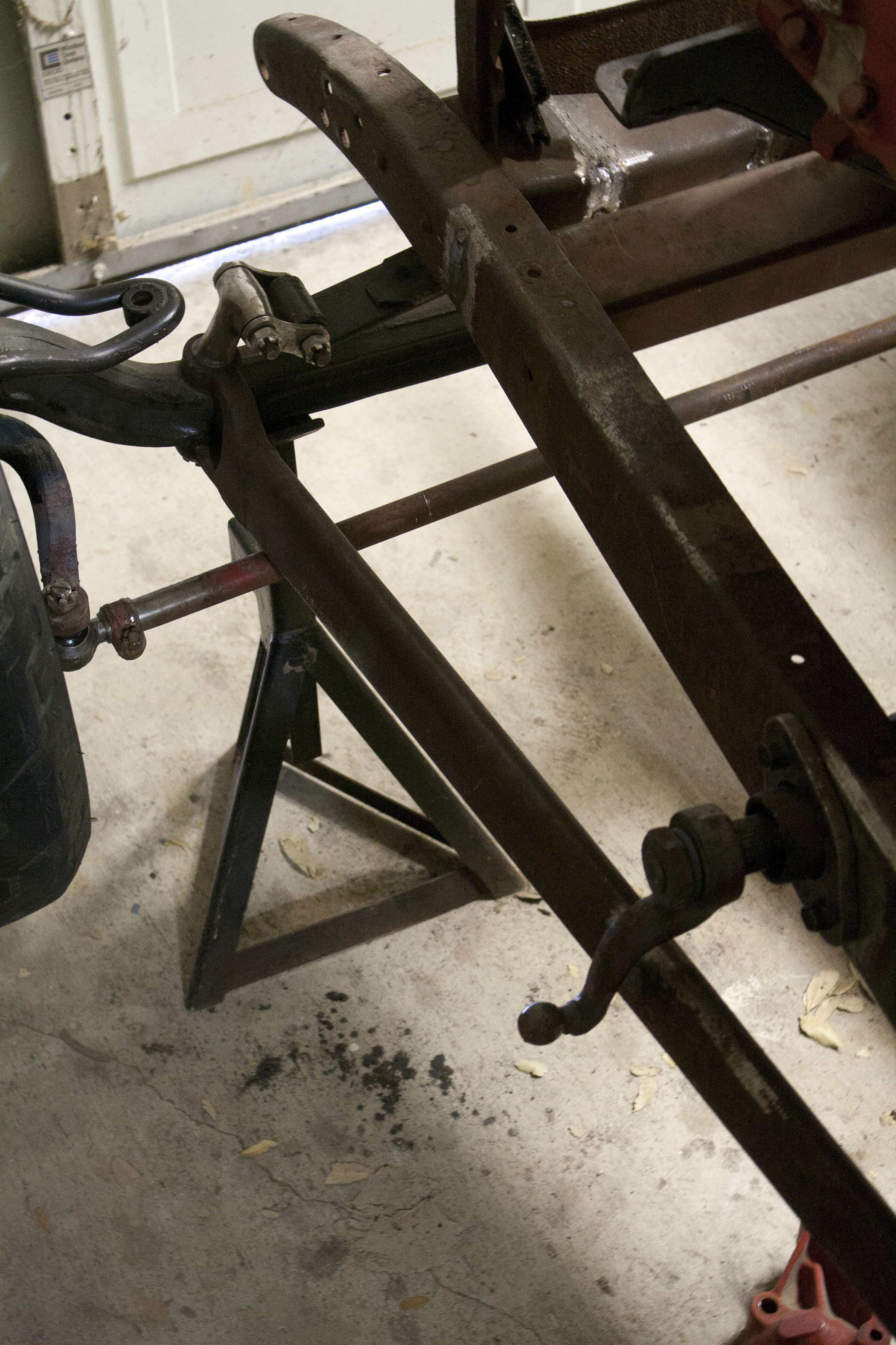

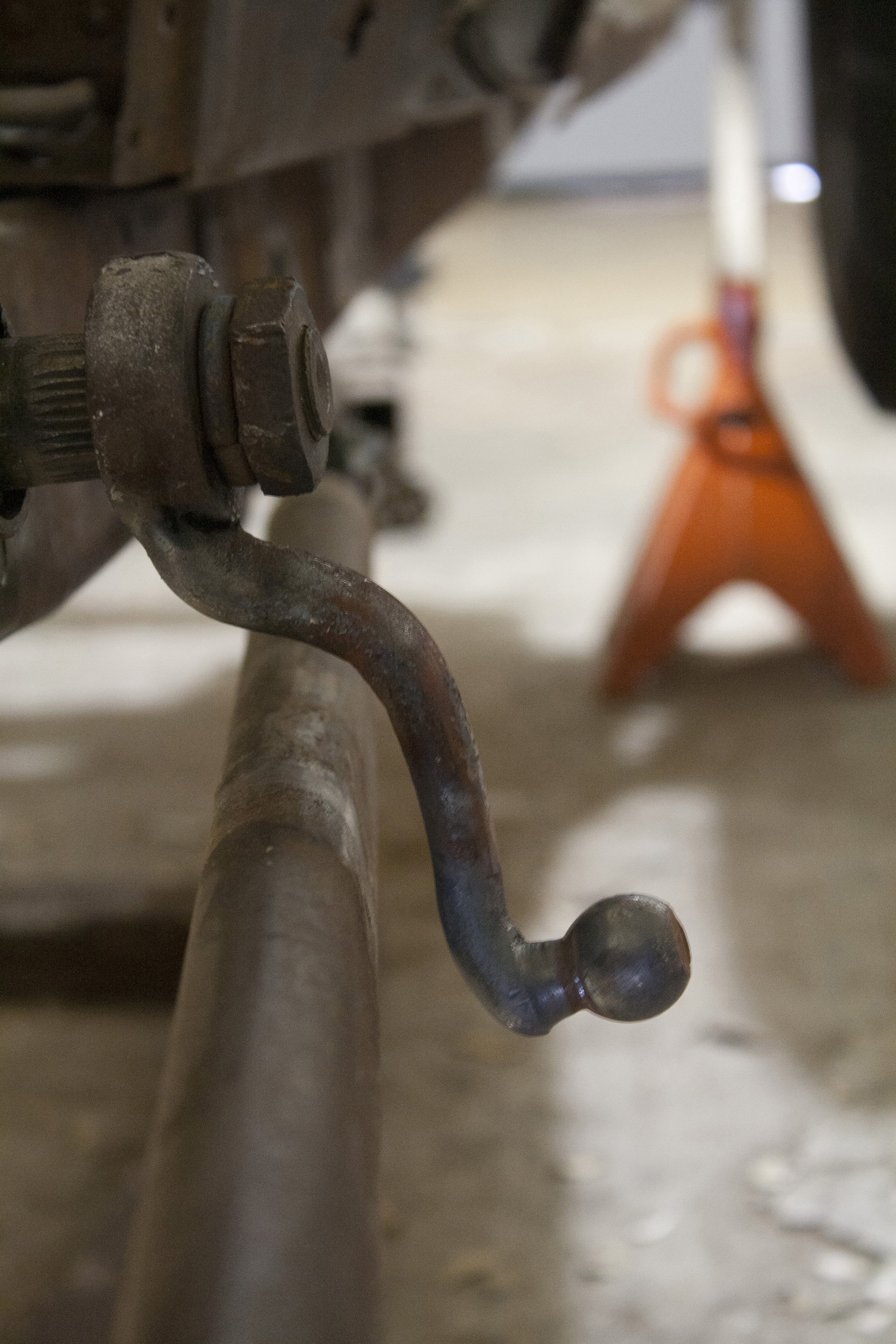

    Soon, the frame will be getting sandblasted then I can box it and get to work on making the engine mounts, finish welding the frame, then the rest of it is smaller things like shock mounts and panhard bar mounts. The steering linkage is almost done too. I'm using a left over tie rod and drag link from a couple of the complete early Ford front suspension set-ups I parted out years ago. I've been kind of stuck with making the pitman linkage and splicing the Packard shaft onto the Ford shaft. A shout-out to Flat-Top Bob for hooking me up with the splined Packard steering shaft for my steering wheel. I'm really going to enjoy glancing at that wheel. :) A lathe would make quick work of these, but I don't have access to one, and the chuck in my drill is too small to serve as a makeshift lathe. No worries, I'll figure out a way..
    I did heat and bend the steering hoop so that the tie rod clears everything lock-to-lock. I'll have to notch the bottom of the frame so the spring doesn't bang against it, but I'll add one more leaf and see what kind of improvement it has. The pitman arm clears the bone but only because the spring prevents the arm from hitting. I suppose a notch was inevitable with flattening the crossmember. Right now, the bottom of the frame rail at the front of the cowl is 7.5" off the ground. It looks great and I would love to keep it down there, but if it compromises drivability too much, then I suppose it could come up a little.

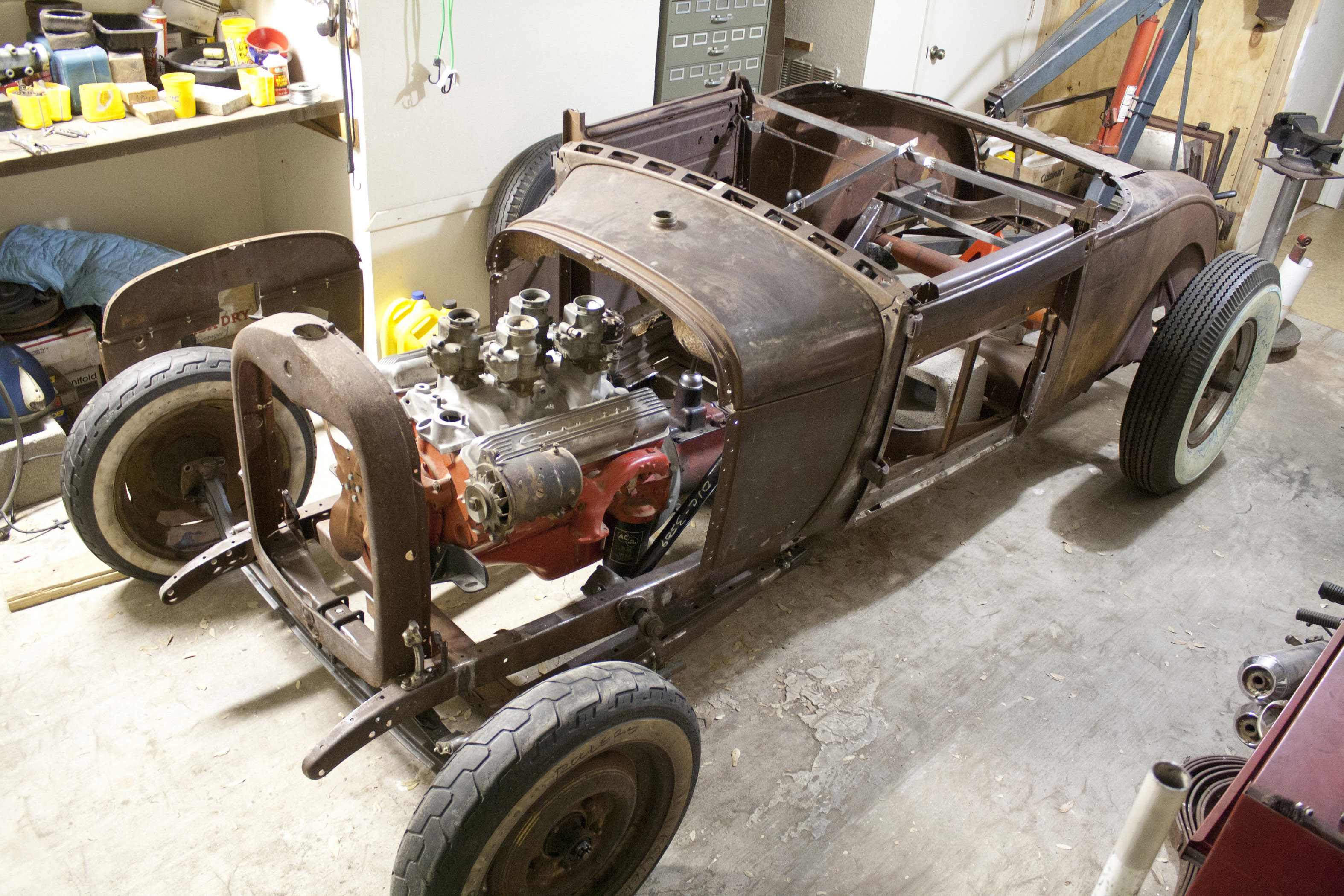

    In between everything that's going on outside of cars, I've been slowly boxing the frame. I'm taking my time with this stage to avoid warping the frame. (Okay.. maybe I've been procrastinating a little). At some point this week, I should be flipping the frame over to weld up the bottom side. I also scored some old Hedman headers for the 283 from a local HAMBer. Other than that.. Just work, work, work. There's no deadline in sight, but as long as progress is made, then that's good.

    Those headers are a great compliment to the Man-a-fre. Looking good Matt!
