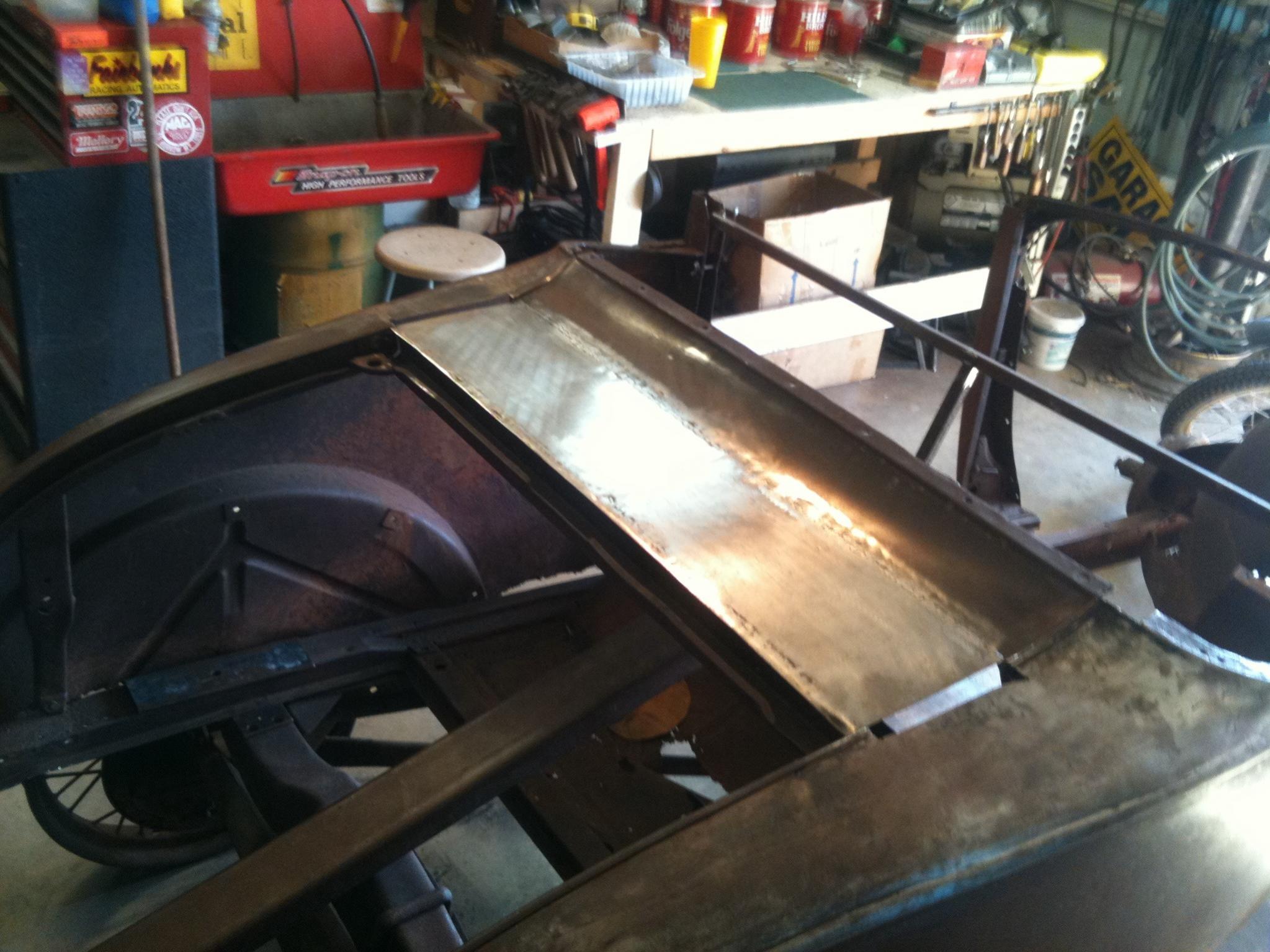

    Sorry about that. I was in Jamaica all of last week on a mission trip so I couldn't catch y'all up to where I'm at right now. So here goes..
    Here I had cut some bad metal out from when I tried my hand at metal working. Thank God I'm young and have plenty of time to learn from my mistakes. Here's how I fixed this problem.
    It's not perfectly straight but with minimal filler work, it'll look good. If I can't get the body as perfect as I want it to be, then minimal filler will be used as conservatively as possible.
    I'll talk about the center gap in between the quarters on the next update.

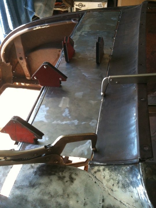

    Also, excuse the ghetto bracing. I tacked that in last summer on the lower rear subrail and the top of the brace that runs along the top of the gas tank. I cut it off to section the gas tank brace but before then, I welded the square tubing securing the door jambs to it..
    Oh the things you can get away with being the new guy.

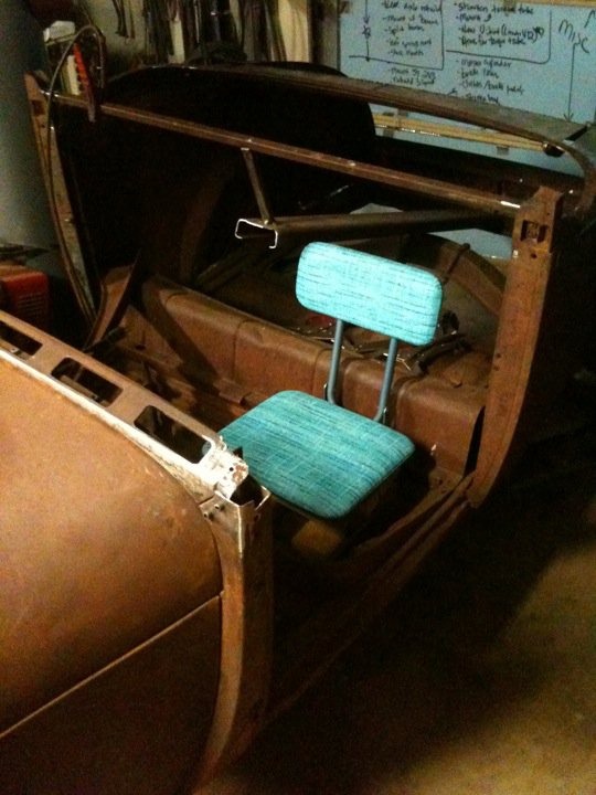

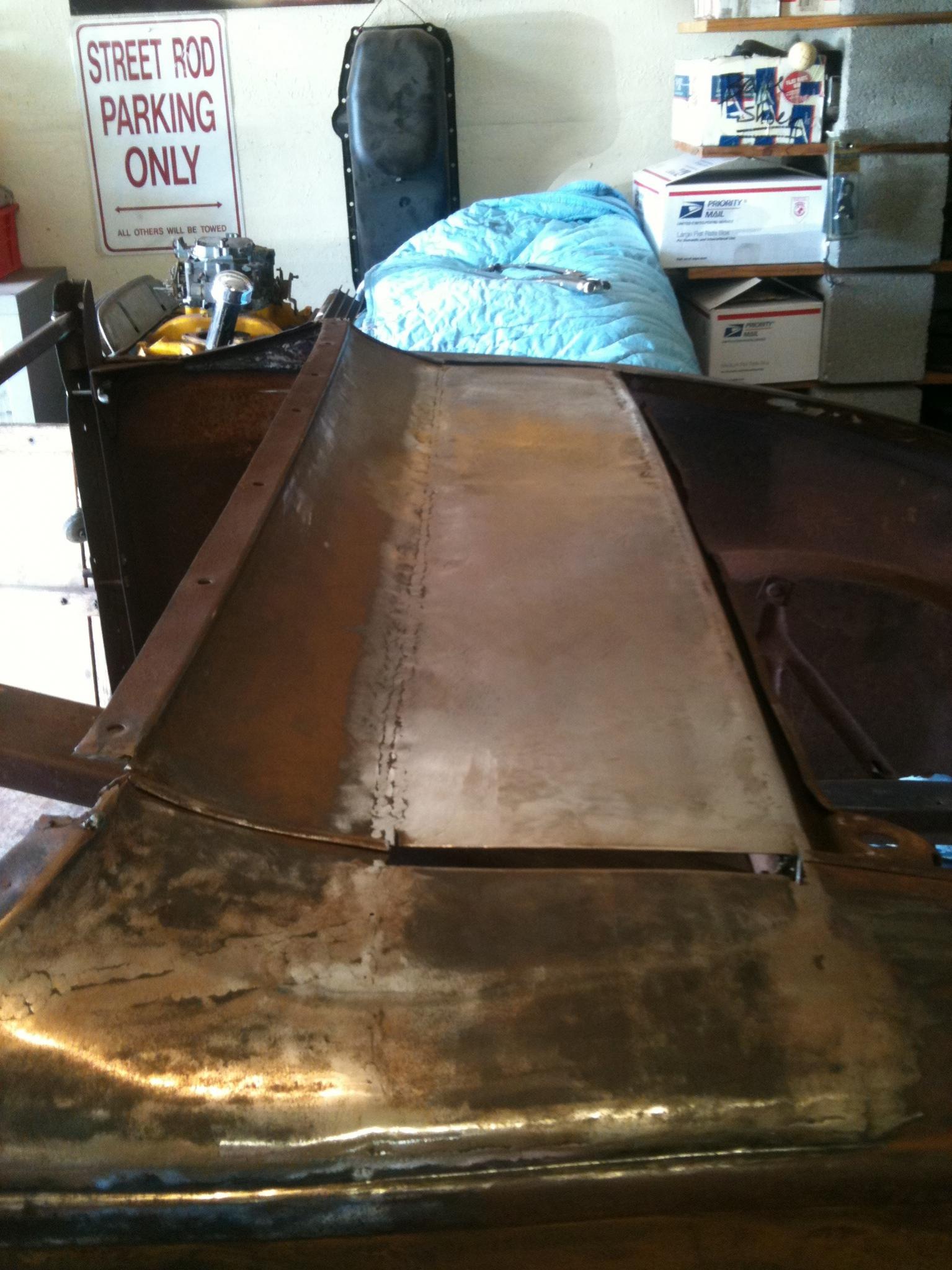

    Here's somewhat of an update..
    I decided to just go ahead and use my welder as it is for now then replace the plug later when I can. So I used the welder to finally finish up the rear panel which I started on months ago. I'm pleased with how it turned out. It has a little dive, some very minor waves so it needs some grinding, shrinking, body hammer and dollying to be finished. But it's much better than I expected. I'm no Bobby Walden but here you go.
    I also included some pictures from when I dragged it out in the sun on the frame I borrowed from my brother-in-law. These are from in between starting and finishing the rear panel.
    Oh. And the seat I sit in to make vroom vroom noises might not be traditional but it sure seems to be from the same period (late '50's) I'm shooting for. :D
