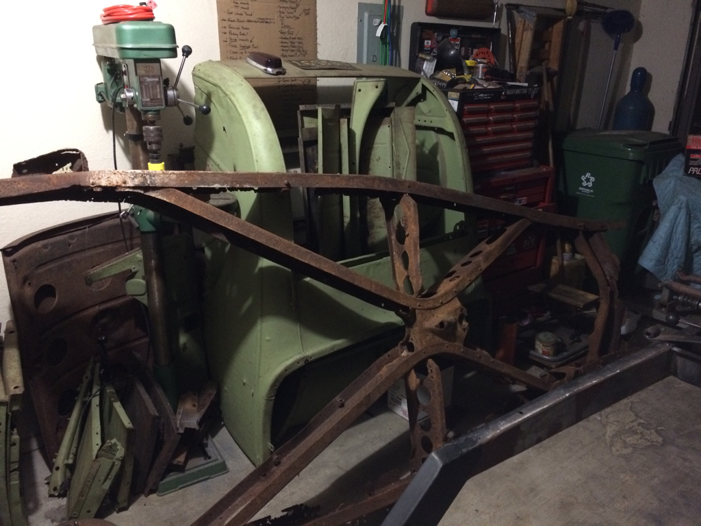

    I've always felt like my roadster is making all the decisions. Whenever I think of something I'd like to change or do, the stars align and parts become readily available. In this case, a '37 Ford frame I found at the Decatur swap meet for dirt cheap. Well, it was literally dirt. And cheap. The outer rails are roast, but the center X member is pretty nice compared to the outers.
    I had grown to hate the little "backyard made" K-member I made over a year ago and couldn't bring myself to just roll with it. It also made brainstorming up pedals a nightmare. With the X-member, the frame will be stronger, prettier, and come with floor pedals that will put a "late model" Mustang dual MC under the floor out of sight to boot. So, hopefully this is only a minor detour.

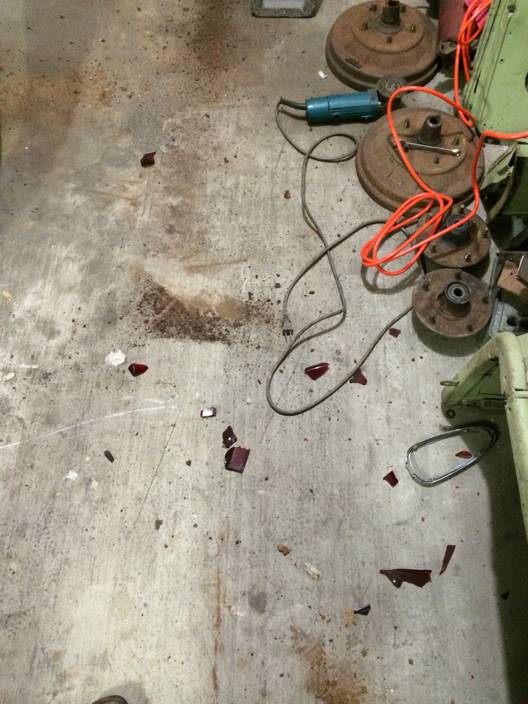

    So I was moving it around to get to some of the rivets and my roadster "spoke" again. This time, it knocked over the taillight lens to one of my Hudson lights.

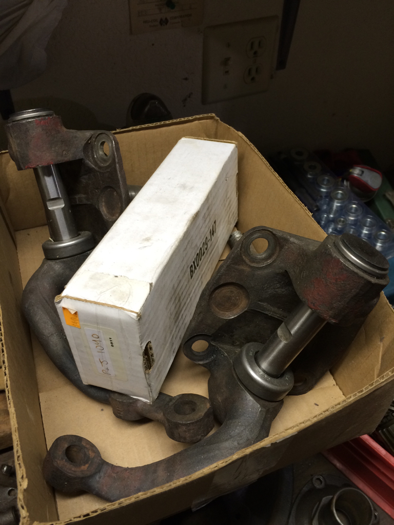

    I guess it's safe to say my roadster is not a fan of the gl*** lenses. Perhaps the buck/plastic idea may come to fruition. We'll see.. In the meantime, I got my spindles back from B***, honed and rebushed. Thanks again, Brian!

    I just now noticed that the X member is 5" thick while the A rails are 4" thick.. It'll take a little more work blending them to the A rails. But if building a hot rod was easy, everyone would be doing it, right?
