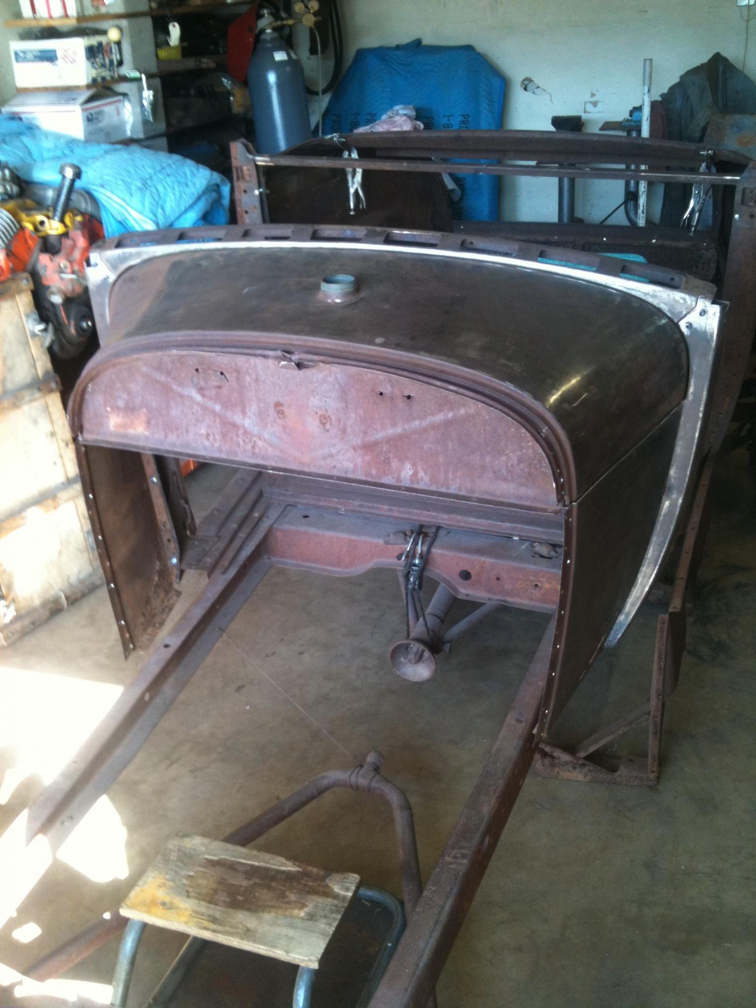

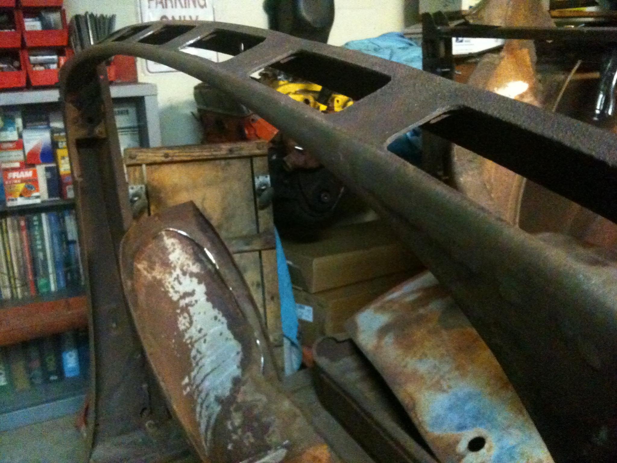

    I decided to head into the garage and do something minor, even if it was clean and move something, so I could feel like I had at least been productive today. Well, that snowballed.
    A while back, I started hand filing the cowl brace, hitting all the high spots and it came out smooth aside from one low spot which I'll get back to later.
    I had started drilling out rivets and spot welds on the side of the cowl so I could just use the cowl side instead of moving around both cowls, firewall, and front subrails which was still one unit.. Which was getting old quickly. I got pretty excited that I was able to get the cowl side separated from the unit without hacking it and bending it out of recognition. Now I know how Tom Hanks felt in "Castaway" when he created fire for the first time. But as a guy new to building such an old car, it certainly provided inspiration to keep going.
    The subrails seem to be in the expected "usual" conditions based on what I've seen on here. Still, I'd feel better replacing those.. The devil is in the details.
    You can see why I wanted the cowl side separate so I can contemplate narrowing the A-post. One of the challenge is how the top of the A-post is thick and then downward it tapers inward. This sure is making me think a lot and brainstorm but I feel confident I'll be able to pull it off. Time will tell.
    Thanks to everyone who's been reading and giving feedback.

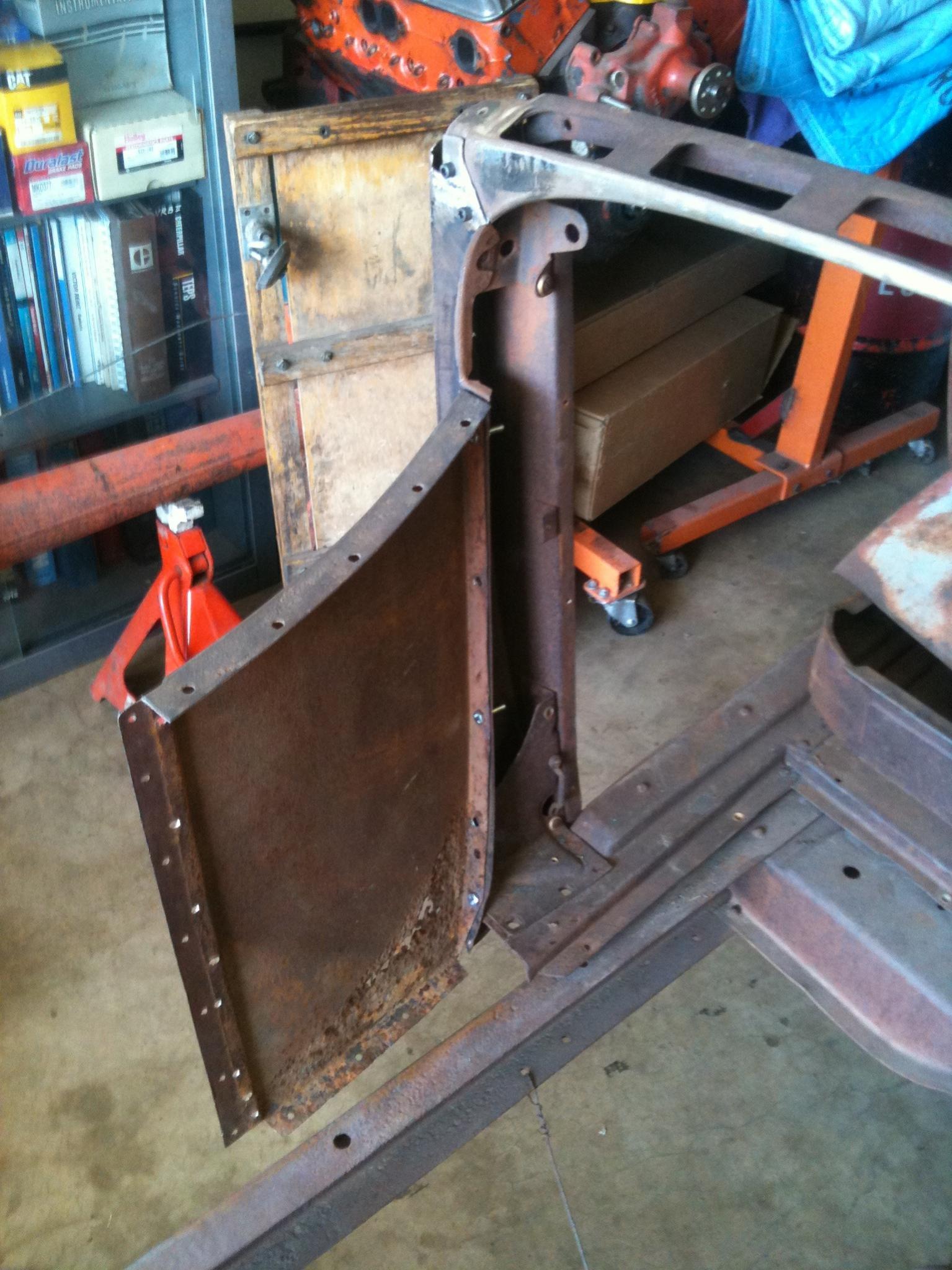

    Mini-update: I got the p***enger side cowl side off and bolted onto the A-post and started drilling out the spot welds on the gas tank so I can get the firewall off.
    Dang! Henry sure liked spot welds. Those are a PITA to find if you can't see the little "dip" where they usually are. I haven't gotten the firewall off yet but I got plenty of good drilling practice. My fingers are sore from changing drill bits so much.. That chuck key rod is ******** thin.

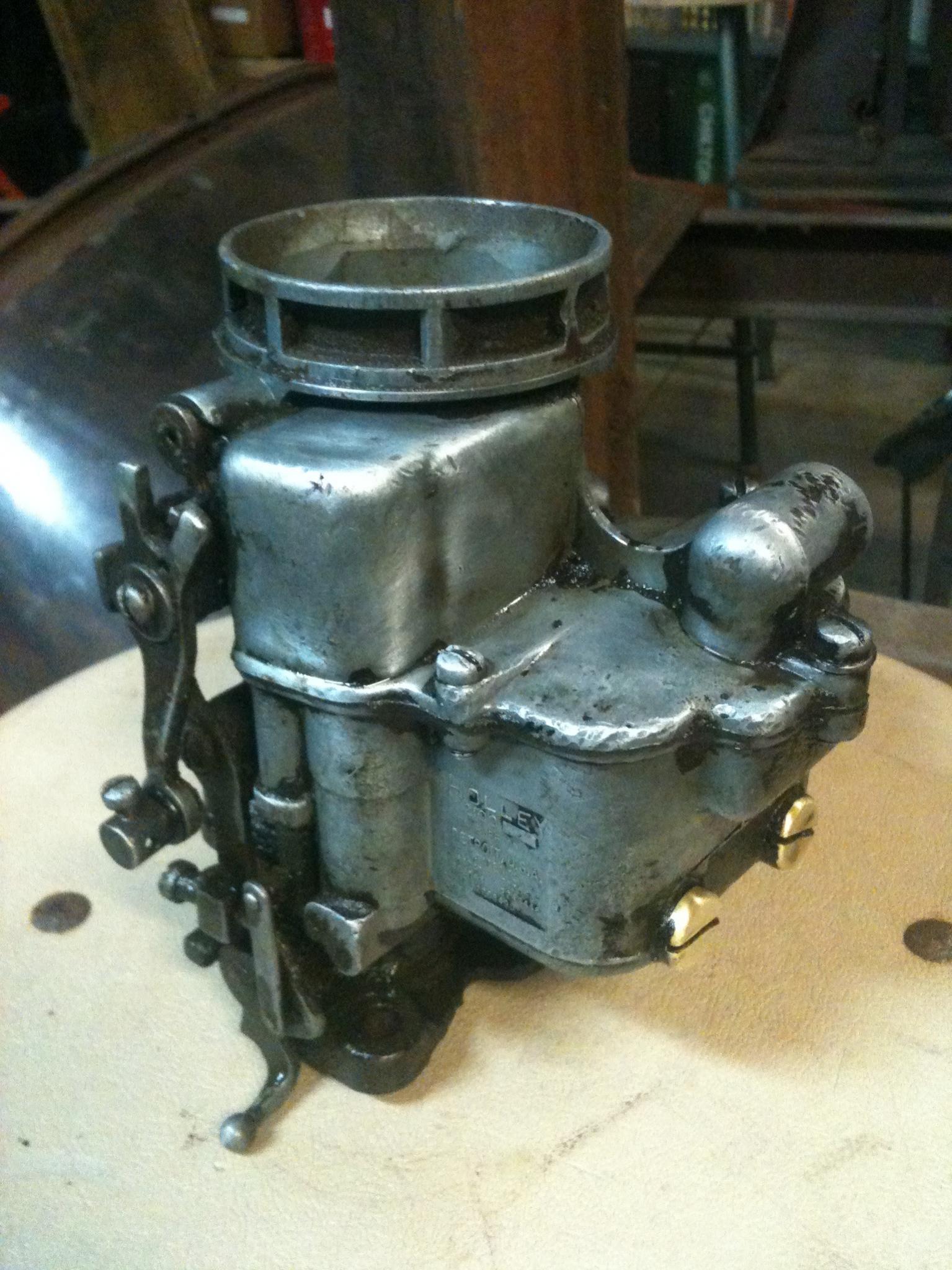

    Is the Holley carburetor I have a 94? I don't see the number stamped on it, although I do see the stamp on the side of the float bowl that says "Holley 2100 Carburetor
    Detriot, USA." The circle on the other side doesn't appear to have any markings inside it. There is a circle stamped onto the back of the carburetor (opposite from the float bowl) but it doesn't have any insignia on it.
    I'm sure this is period correct and a 94 but I just want experienced eyes to confirm that this is a 94. There was also a Holley next to it with smaller ****erflies in the bottom so I compared the two. This is the one with the bigger ****erfly opening in the bottom.
    iPhone - TJJ App
  21. chaddilac
    Joined: Mar 21, 2006
    Posts: 14,093
    chaddilac
    Yep that's a 94.... but there are a ton of variations on the 94!

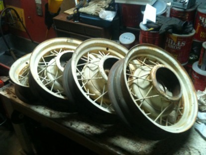

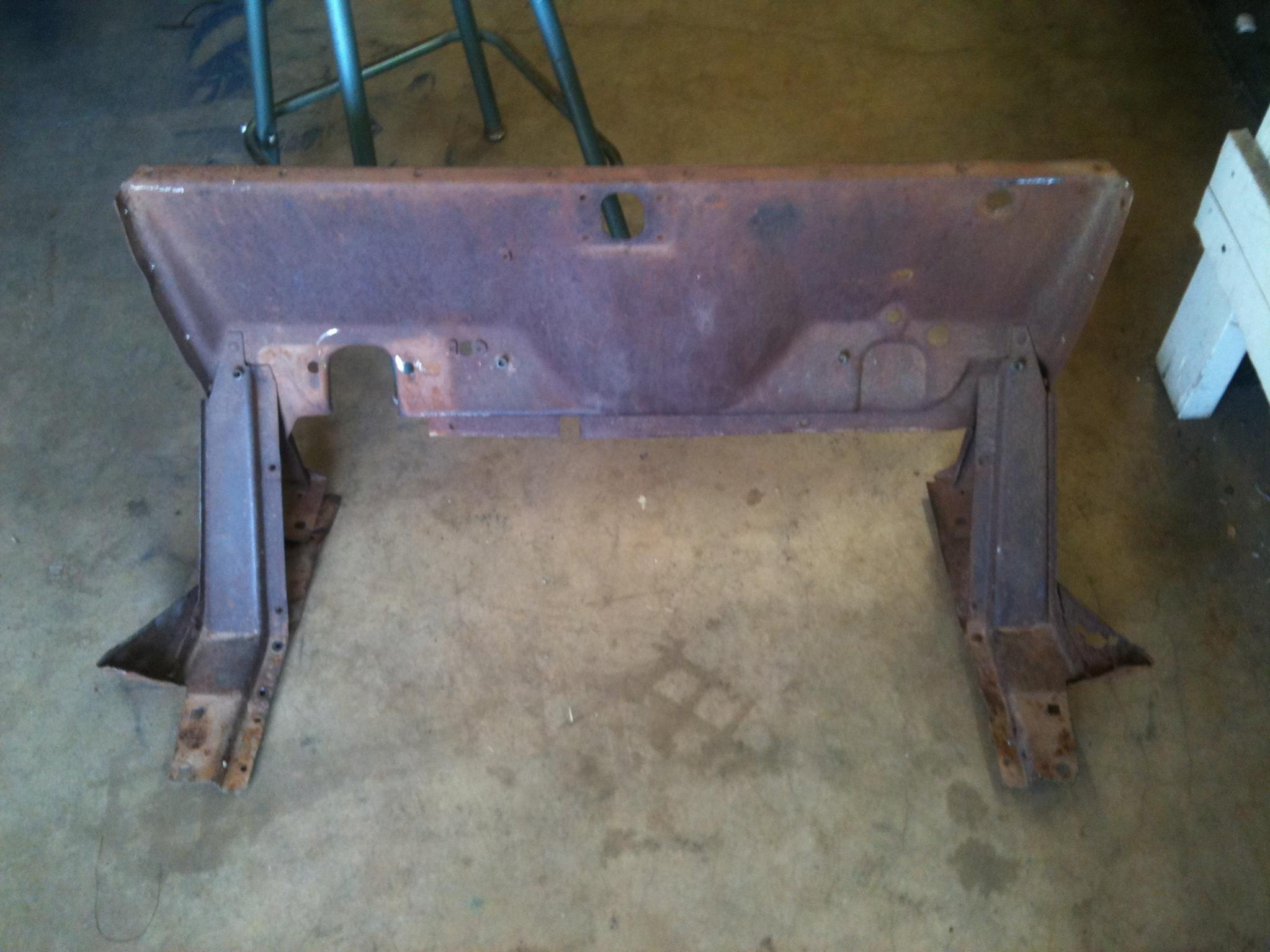

    These are most of the parts I got in the deal with my brother in law.. I got all these patch panels, all the subrails needed to replace my old one completely, cowl sides, 2 sets of door skins (entire door from body line down and the bottom 4-ish inches), rear quarter corner patches, wheel wells, patch panels for the front part of the quarters, rumble deck brace, some more inner braces, a F-100 (correct?) box and column (I turned the steering shaft and the pitman rod spun easily), 2 grille shells (one is beat up pretty bad, the other is just pitted), A-post to A-post brace for the front of the roof, the upper panel between the deck lid and roof, lower panel between deck lid and subrail, some miscellaneous braces in the tote box, deck lid (minor damage, not much rust) with the inner rails, a set of wire wheels and the '57 Chevy 283 you can see above Chaddillac's comment.
    The story on the 283 is that the previous owner rebuilt it and put it on the stand then p***ed away before sticking it in a car. It was sold at an auction to my brother-in-law and he looked inside the valve cover and says it looks fresh.. I also got the frame in the previous pictures you can see with 2 Model A wheels.
    What isn't pictured is 2 sets of cowls and doors, 3 complete sets of A-pillars from a Sports coupe, rear quarters, hacked up sub-rails, repop visor, 3 or 4 axles (one is late model.. first to go), a banjo rear for sure, and what appears to be mid-'40's Ford front suspension, axle, brakes, spring, wishbones. I might be missing a couple other items but that's the majority of the parts I got in the deal.
    What would you price the entire bundle of patch panels, Model A Sports coupe body, frame, body parts, axles, and motor for? I want to see if I came ahead or if my brother-in-law came ahead in the deal.. I'm almost confident it's me. :)
    What do y'all think?

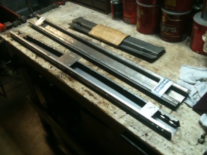

    Mini-update: I separated the front and rear axles on the Model A frame. The nuts just spun clean off after having to break the rust just a little. The front axle looks straight and nice. The rear axle is locked up but complete.. But that won't be going back in.
    I also stuck the dummy door in place just to picture it closer to done. Now that I have a couple of sets of doors in better shape, I'll pick the better ones of the pair and modify them soon, then I can get rolling on doing the A-posts, door hinges, rust repair, the body line around the ****pit, then whatever else comes up. Oh.. I do have to fix this annoying oil-canning problem on the driver's quarter. If that won't work, I'll use one of the other quarters but let's hope I don't have to.

    Looking good! You're all set with all that metal, let me know if you want to part with those wheels.
  27. TexasSpeed
    Joined: Nov 2, 2009
    Posts: 4,638
    TexasSpeed
    from Texas
    Thank you! I actually do want to part with these. I'd even trade them for something I need for this project.. I don't really plan on running wires anyways. Do you have anything you think I might be interested in? PM me if you do.

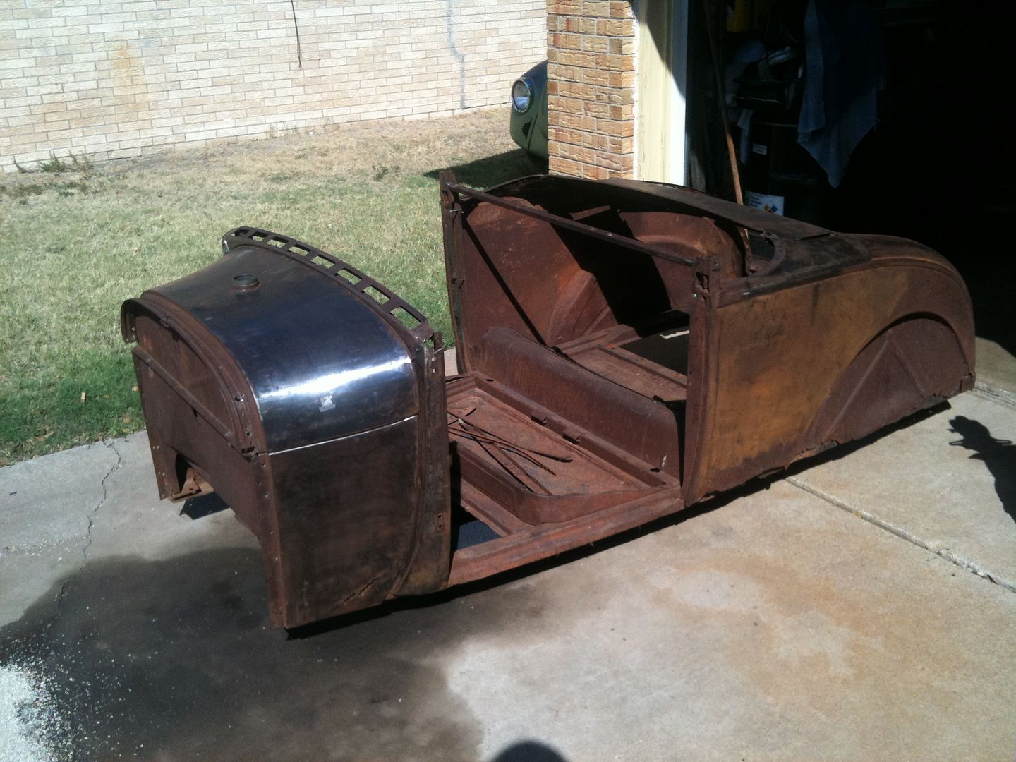

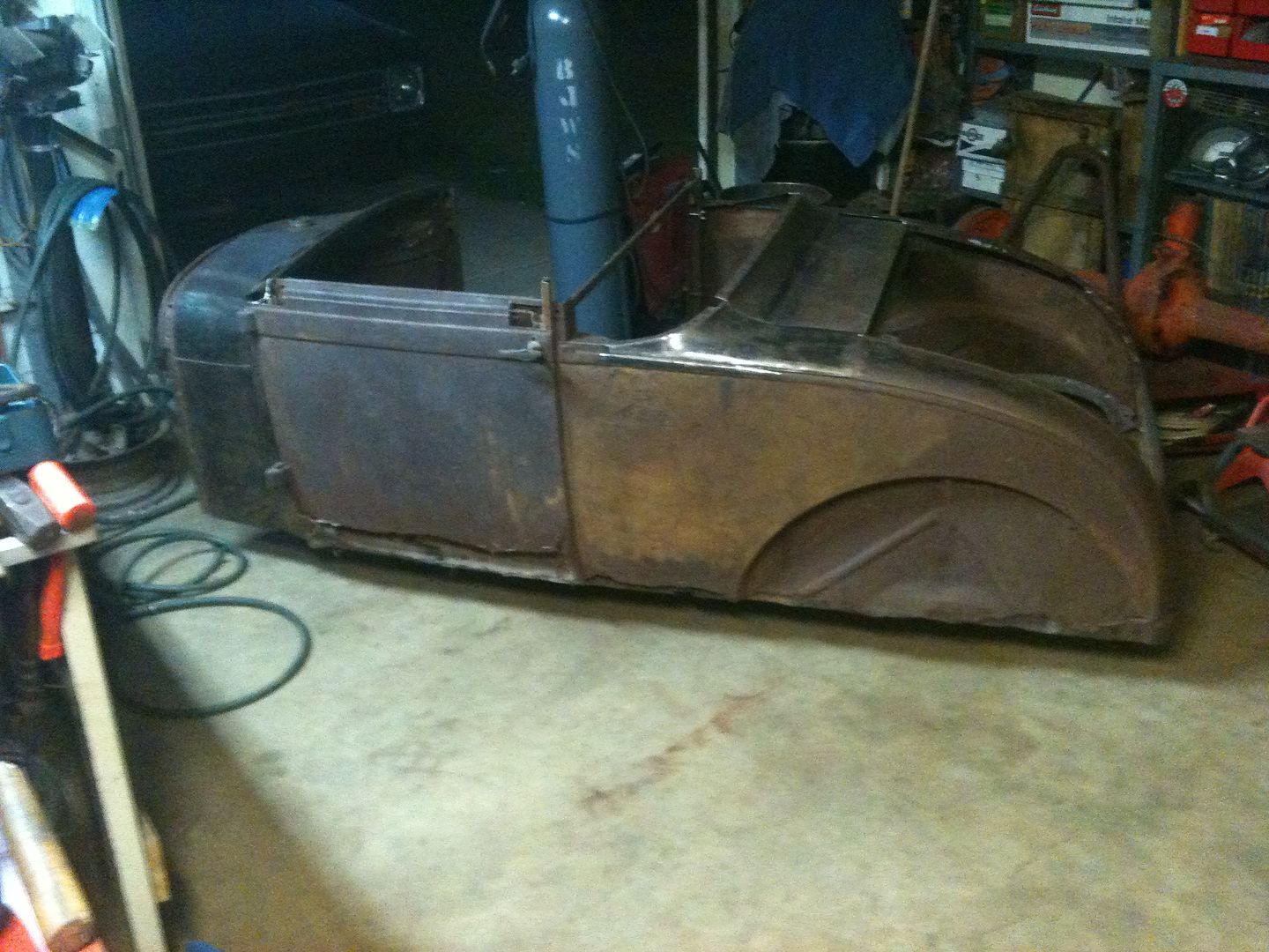

    Mini-update: I got home from school today and right after the Rangers game, went straight to work. I just fiddled around with the doors and took some pictures.. I went to Harbor Freight and got some supplies so there will be progress this weekend. First, I put my body on its new dolly to roll around and moved it outside for an outside shot the other day and realized a side profile shot would help so I took another one today.
    In the photo below, you can see the proportions much better although the sun in the back doesn't help any. I'll take another picture tomorrow with the door on it as it was too dark to take one outside. But, here's some slight progress..
    Expect more tomorrow. (sorry about the bad cell phone shots)
