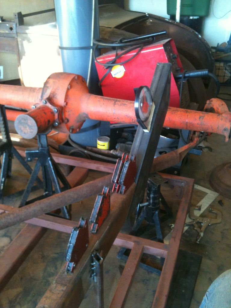

    I've been slowly chipping away at the rear Z, learning as I go.. I had really been struggling with deciding on the suspension aspect as well as the spring location. I decided on putting the spring behind the axle but didn't know about how to attach the spring to the axle. In other words, the art of Z'ing a frame which is an everyday thing to some, is black magic to me. Even though this is my first build and it seems too much for a newcomer, I'm determined to see this thing through. I'm not worried about not finishing this at all because I just have way too much desire to finish this (and more importantly.. Drive it). Granted, it would be much easier if my dad was here but I'm not the kind to sit around and wait for someone to teach me. I did learn a lot today mocking stuff up and wanted to post this up and get your input on my ideas.
    I had been brainstorming on how to attach the tube steel to the A frame in a way that doesn't compromise safety. I began by cutting the back end of the frame off, getting that out of the way but not before marking the center of the rear crossmember on the frame jig using this pointed weight attached to a string which is a "plump bob," right?
    Then I cut out the end at a 45 degree angle in relation to the ground and left the bottom part for the tube steel to sit on, bent the bottom part to 0 degrees flat and cut out the tube steel with 45 degrees on both ends.
    I bolted on the wishbone and quickly realized that the arms would hit the tube steel where I planned to Z it. I was also concerned with how far down the frame the Z would have to be to clear the wishbone arm.
    Then I realized what If I took the wishbone off and did the Z there and relocated the end of the wishbone arm inward and downward just a tad more. I could cut the end of the arm off, fabricate a bracket to weld around the axle and bolt the wishbone arm to it and get the clearance it needs while keeping the Z right where I want it.
    I would like to know whether it would be best to bolt the wishbones back to the torque tube or to just bolt them to the frame besides where the clamshell is? If I do go with the later route, then would I have to just go ahead and fabricate a new set of arms to use as using split wishbones in the rear in this manner is seemingly frowned upon?
    Oh, and I was worried about the width of the rear axle so I put one of the drums back on and a wheel to see how far out the wheel would be. With the body back on and the bulge of the tire, I'm guessing roughly 55 inches wouldn't be too wide?
    Just a heads-up; the axle is not in its final spot driveshaft/torque tube wise. The frame is at the desired ride height on the frame jig as is the rear axle. This axle is just being used to mock up the Z and suspension. I plan to rebuild the banjo axle along with 3.54 gears before burning any brackets to it. I plan to leave a little excess tube steel out past the rear axle so when I mount the body back on I can ensure the wheel is centered in the wheel well.
    After I finish the Z, I'll mount the motor and transmission in then finish the suspension and weld the brackets to it so the angle of the driveshaft is in its sweet spot.

    That's what I believe too. I think I'll probably keep the wishbones attached to the torque tube and run a panhard bar on the Banjo.
    I'll be relocating the ends of the wishbones inward from the ends of the axles to clear the Z but I'll do that after I get the front end done, the drivetrain set in, and rebuild the banjo.
    I just need to know if that will be sufficient.

    I think as long as you don't move them inboard too far you should be fine, but it will probably push your axle back the same distance they are moved inboard, just something to account for when you get to that point. Keep at it you'll figure it all out, great job!
    Murch.

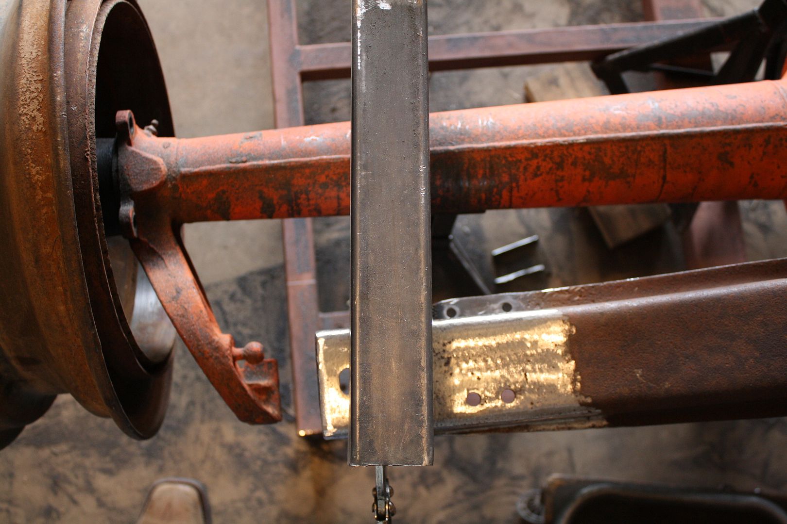

    In the pictures above, you can just make out where they would be. It's just mocked up but you can get the general idea in where they will be in relation to the frame and on the axle.
    They'll only be moved inward and downward a minimal distance so the arms clear the frame as they ride up and down. There will still be a lot of triangulation in the wishbone. I plan to cut the ends of the wishbone off and fabricate some brackets to weld around the axle and the ends of the wishbones so they bolt together. I think I can probably get the torque tube ends of the 'bones hot enough to move a little more so I don't end up cutting them off and welding them back on. I definitely think I'm up for that challenge. This will take care of the moving the axle back dilemma as well.
    Thanks for the input.. It's making me think that the way I have typed down here will work out just fine.

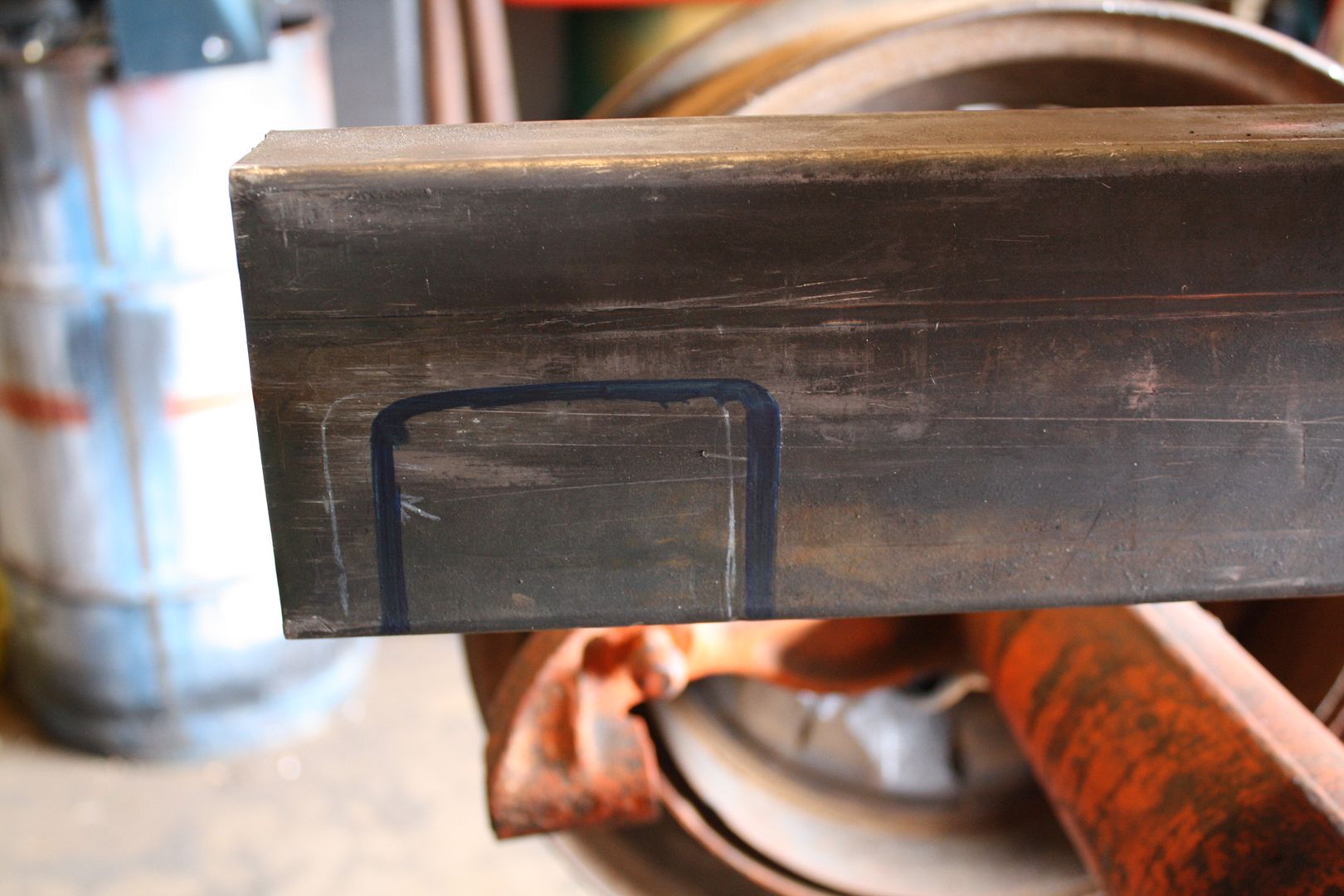

    Today after doing some business, I took a little time to sit down and contemplate how to tackle the rear crossmember. You guys know that I decided on a spring-behind set up to save room in the trunk. (well, hopefully) I cleaned up the rear crossmember by taking out all the rivets and grinding the top and sides down to bare metal. I made a template of the crossmember using a small piece of cardboard cut out and used that to mark my frame rails. You'll also notice, I tacked together a couple tube steel pieces to make a brace for the top of the Z.
    I measured and remeasured the frame rails, crossing from one rail to the other to make sure it was all square. So far, I'm gold. I marked onto the frame rail using my template and an old marker. Again, I measured and remeasured to make sure that the marks were square and even.
    I then cut those out, stopping at the bottom of the tube steel. The plan is to clamp the crossmember and use it to mark the bottom as well as line up the outside of the tube steel where the crossmember should come through. I lined up the rear axle to the frame but I won't be burning the crossmember in just yet.
    The plan is to cut the rear subrails out of the body and slide the body over the frame and cut out where the axle will come through the wheel-wells on the quarters. Those wheel wells will get cut out and replaced with new patch panels that I have so I'll be using these old ones to make the template for the new ones. With the body on it, I'll center the rear axle in the wheel-well and square it up with the frame then tack the crossmember in after I'm sure it's in the right spot.
    While mocking up the crossmember, I noticed that the spring perches on the stock Ford axle lined up with where I wanted the crossmember to be and thought that I could run the shackles off those perches onto the A spring. I'll have to do some more research on that.
    In the above pictures, the axle is lined up and should be where it's supposed to be. Putting the body on will ensure it is. The crossmember is just clamped on and hasn't been aligned or anything so don't freak out over that just yet.
    I'm thinking after I get the rear axle bolted on with the spring, I can tack the torque tube back to the flange (after cutting it, of course) and tie it to the A crossmember for now. That will then make the back end a roller. I need to ship the front axle off to 296 V8 to get a 3 inch drop. That should get it low enough and if not, then I'll tweak the spring some, then pie cut and flatten the front crossmember some, notch the frame so the spring has some clearance if it has to come to that. The front frame horns are staying.
