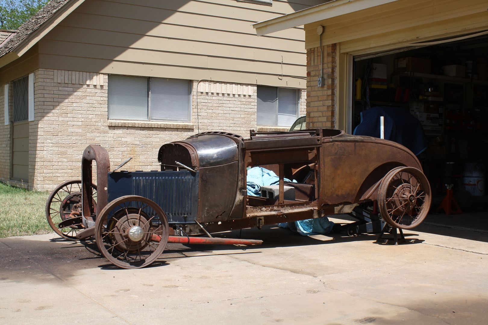

    Today, I didn't get much done other than snap some pictures of the car outside at the stance I'm wanting it to be at. Yes, the frame is only sitting on the front axle without a spring. I also drilled out some s**** steel to make some temporary shackles for the rear so I could mount the rear axle then I bolted on some old wire wheels..
    I have to say, I'm pretty happy with the stance this will have. Now I'm starting to think I shouldn't channel the body because it looks pretty good on there as is. Most of my friends think I don't need to and I'm starting to agree with them. I bought a bunch of parts to help get started on the suspension and ordered the rear tires. I still need to find one more 16x4.5 so I can mount the 7.50's on them and bolt them up to the car.
    As soon as the frame is done, I'll be back onto the body, getting everything done. Hopefully I'll be done with the frame for good by the end of the year.
    Starting to look more and more like a car! :D:D

    wow! seeing it all thrown together and in the driveway is so much different then in pieces in the shop, the proportions are looking great. id have to lean towards the non channeled camp myself, but get the ch***is done and roll it out again for another look before you go one way or another. im sure rubber will make a difference.
    looks amazing either way, im sure id be standing in the garage at 3 am staring at it :)

    Yeah, I think get those tires and see what everything is really at. Or get the dimensions and cut some "wheels" out of 1/2" plywood until you can get the money. The good thing about channeling it is that you'll be able to achieve that same stance but with more suspension travel because you'll be able to load that axle with a decent spring and such.
    However, a good ol' drop axle will keep you where want to be I think. Love the tire size, that's what I've got on my '35 with 3.5" wheels up front and 4" out back.
    planning on running a hood? That'll get a little tricky if you channel it but it's doable. On my '32 I think I'm gonna run just the hood sides but it'll be channeled too so I have to figure out a few things before that can be done.....actually I have to figure out a LOT of things before that can be done.
    Ya know, that damn 28-29 grille would look killer painted with some drawer pulls in it for that circa '59 show car look.
    What color are you thinking? I think it should be something with pearl in it. :D

    I'll be running 4" wheels up front and 4.5" out back. Just need to find one more nice 4.5" wheel.
    The colors will be a light metallic green with cream white flames and firewall. Gold wheels, motor, etc. I may chrome a few pieces here and there if the funds allow it. I had an idea for the interior but now I'm not so sure if it'll match the '50's vibe I'm going for with this thing. It was going to be a simple bench seat with a leather outer half and a dark plaid material for the inner halves. Not too sure about that now. :confused:
    I'll be running just the hood sides. No top. Just like that killer black A sedan on here with the wide fives. The hood sides will need some work anyways as I upswept the frame so it doesn't align with the frame rails anymore. I'll have to notch the bottom of the grille shell to fit better as well. The drawer pulls.. Eeh.. :) That might be a tad bit much for me.

    I gotta say I really like that super low stance and I LOVE the 19" wires! That really makes a killer and unique look with either a level stance or a slight rake.
    With the 19" wires, a full hood, a good 40's color and chopped windshield....Hot as HELL! :D
