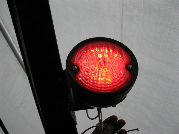

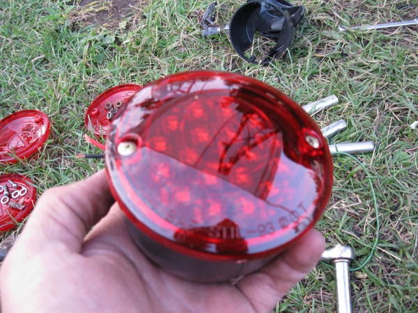

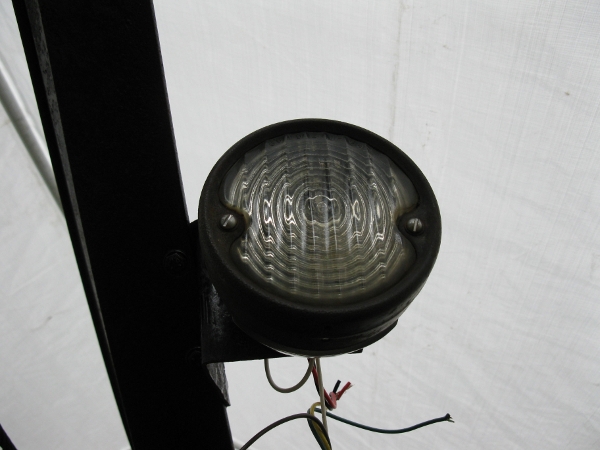

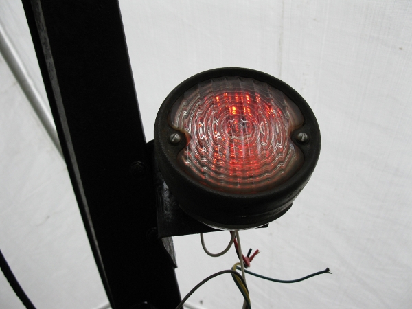

    Those LED conversion bulbs only work with clear lenses, and I discovered they work best with clear gl*** lenses.
    I built LED tail lights for my 36 GMC in my avatar using vintage Guide clear utility lights and I found some cheap but nice LED boat lights (non sealed beam style) and I gutted them and fit the insides into my vintage housings, they are incredibly bright and look great going from clear to red!
    I uploaded some photos of my conversion, the last one is of one of the LED conversion bulbs like you got with the extra diodes in a 1940 Chevrolet parklight I use as a marker, looks decent, very bright, but the ones I modified to fit are nicer and more even looking.
    With the right lens they don't show up as dots either, and with no warm up or cool down (seen as a fade in and out) they really stand out.
    EDIT: the images uploaded in a random order... but the 40 chev one is in there, (36 GMC LED Conversion (15).JPG)

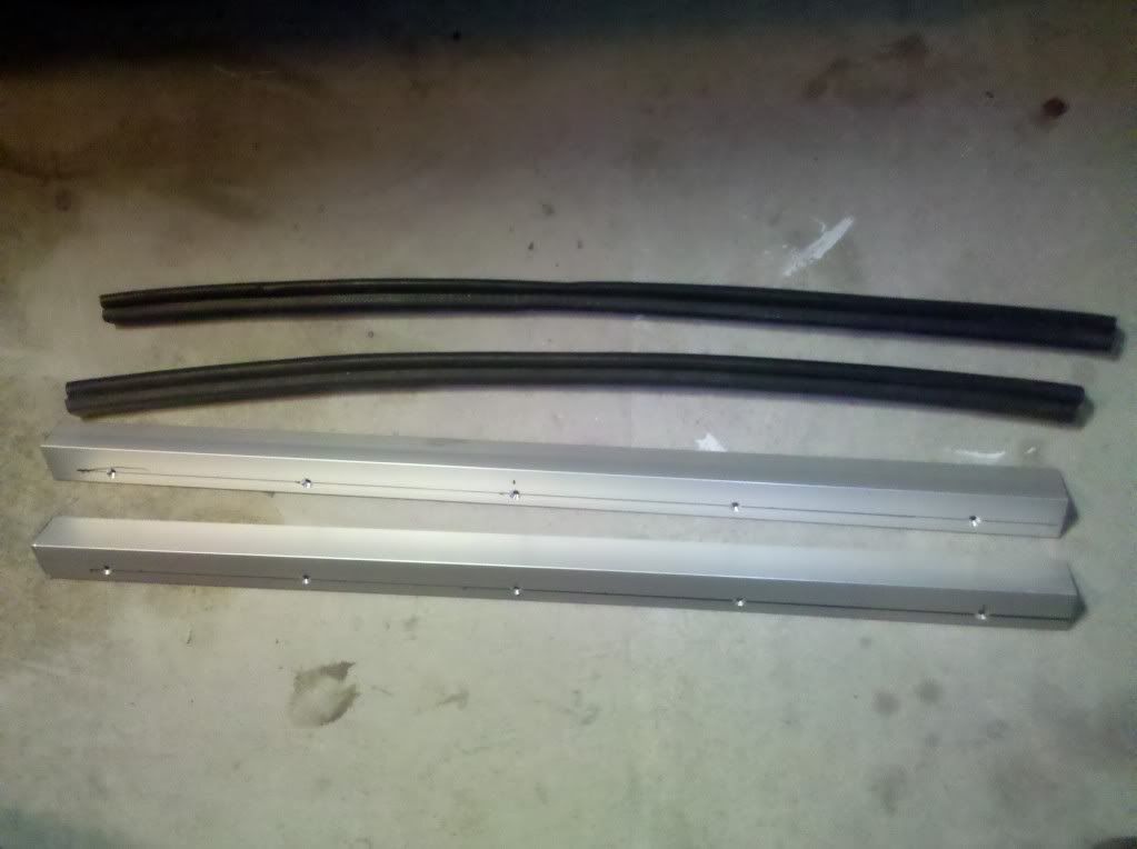

    This is another one of those I’m real cheap deals! Instead of just buying the lower door seal, I figured I’d build my own and use it to hold my carpet down at the same time. I went and picked up a piece of 1 ½” x 1/8” aluminum angle and cut them to the length of the door opening. The rubber is from the back doors of a ‘79 Suburban (practically free at any wrecking yard!) and it slides onto the bottom of the aluminum.[​IMG] I squirted some weather strip adhesive in the pinch area and slid the rubber in place. [​IMG] I used a black sharpie to mark (I hadn’t removed the line yet) where my holes needed to be drilled, then countersunk them. I used some stainless oval head screws to hold it in place. The rubber seals up right below the door panel and it keeps out what air was sneaking around into the cab! [​IMG]

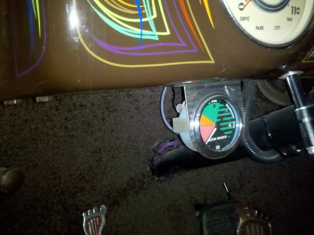

    I forgot to show this awhile back. I found this in an old motorhome and thought it would be cool in the truck. An SW Motor Minder vacuum gauge! It's kinda cool watching how it works while cruising! [​IMG]

    Those Motor Minders are great aren't they? Cool accessory to a cool truck!
    I have one just like that and was too stupid to step up to the earlier decade version when given the chance three times....
    Funny how they "dance" when you peg the throttle!

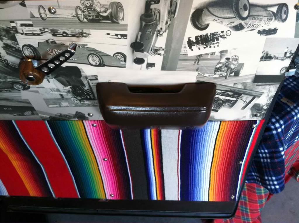

    Trying to finish up some little details and one was the door armrests. New they cost between $30-35 per side and with as little as I've spent I couldn't justify it. I took a measurement of the door screw spacing and figured I'd do a little research. One thing I love about the Chevy R&D guys is they used a lot of the same things and measurements on LOTS of their stuff! Makes it nice when you want to be creative. So I'm walking around the boneyards looking for something that would work and noticed the 70's Chevy vans had the same screw spacing as the early truck! DON'T use the later ones because the holes go at an upward angle and won't work. Alex found 2 perfect ones out of a '77 (Ice Cream van!) with no windows, so they didn't get rotted out. 8 bucks for the pair, cleaned them up, sprayed the same vinyl dye I used on the other plastic in the truck and I have my low-buck arm rests! [​IMG] [​IMG]
