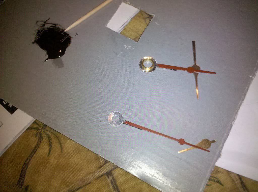

    Now on to what I think is the cool stuff. Everyone knows I always try to do things cheap, or shall I say inexpensively. It doesn't always work out that way, but I try my best. After aquiring these gauges, I sat down and did a little thinking. How much do I feel like spending on gauges that are part of a low budget, do-it-yourself build? Very little! So here we go. First thing I did was take the gauges apart. Pretty simple, just take your time, take pictures and put EVERYTHING in ziplock bags! Took the face plates off and cleaned them up with some warm water and detergent. Other than some 70+ year old stains, they look like new! [​IMG] I looked into the 12 volt quartz clock adapters (starting at around $85 just for the clock) and decided I could do better. I went down to our local Michaels Art & Crafts store and bought a AA battery quartz clock kit for $8 bucks! If those can keep time for a couple years on a little battery, then who am I to argue?! [​IMG] Took the factory clock back and marked where I'd have to cut it to fit the box. [​IMG] [​IMG] Here are the original needles on the left and new ones on the right [​IMG] So I cut the original ones to where they widen out and cut the new ones to about 1/2" from the base. I mixed up some 4 minute epoxy and glued the old on top of the new [​IMG] I then carefully ground down the backside of the machined top and glued the serrated nut to screw down the new/old clock hands [​IMG] [​IMG] Now I just need to clean up the glue, mix up some maroon/red and they'll look like new!

    After blasting all the rust off both speedo and clock backing plates (and finishing up all the rough edges on my cuts) I sprayed them both in aluminum Rustoleum. I set the cardboard insert back in place [​IMG] and set it aside. I took the original clock [​IMG] took apart the guts and with my diegrinder, cut everything off flush. Now all that remained was the flat piece and the stands that the face screws onto. I drilled a bigger hole into the center of the plate and slid in on the clock, which was then tightened down. [​IMG] I screwed the faceplate onto the clock with the little factory screws [​IMG] put the clock arms on on set it back in the base! [​IMG] I already found and ordered 2 pieces of convex gl*** on Ebay for $20 for the pair. I need to go to Radio Shack and find an AA battery holder with some wires and solder those to the clock, to make it easier to change out. Need 2 5" square edge O-rings to put between the tapered piece on the gl*** that rests on the gauge face itself. When finished, I'll have about $25 and a few hours time for a perfectly running clock. I rebuilt the speedo guts myself and everything purrs smoothly and a total of about $15 into it. I'll put pics up shortly once they are back together completely.
